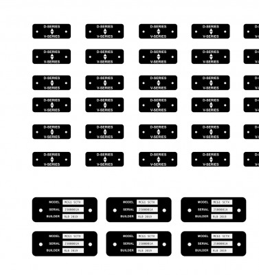

The best way I’ve found is to print several decals on same clear vinyl. Stick all of them onto your silver in one piece.
Then you can spray clear lacquer over the sheet. Wait at least 2 hours then cut out your decal. If you mess up the cut you have several to practice with.
Like this
