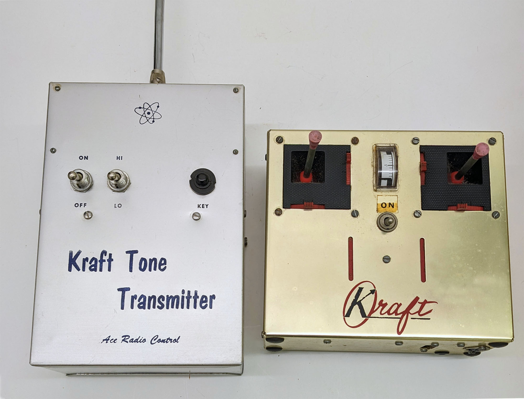

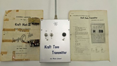

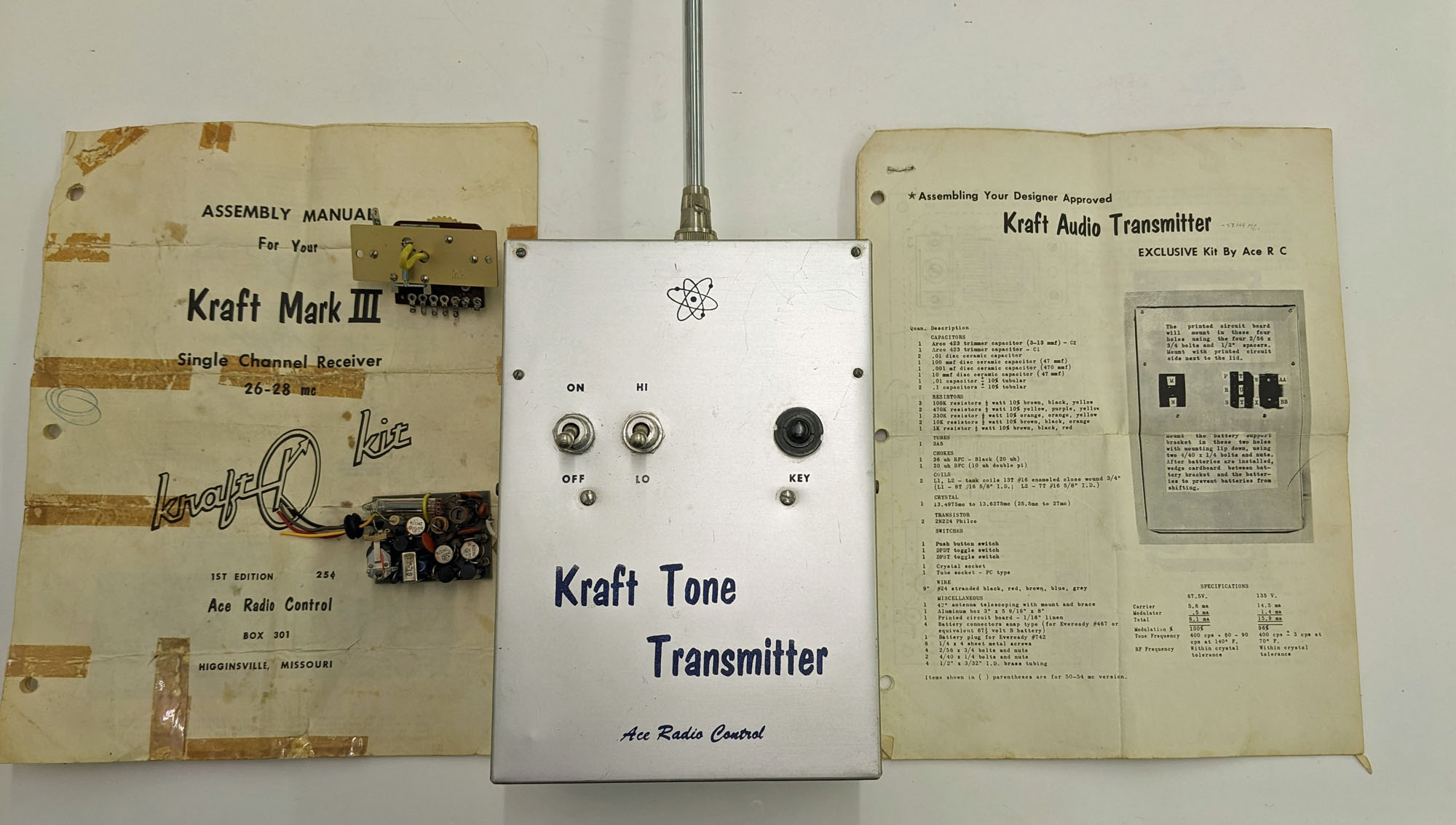

I'm lucky to have most Kraft transmitter models in my collection, including a couple of Kraft s/c sets, the Ecktronics Kraft Tone Transmitter and a gold anodised Kraft Custom s/c, but I've now managed to get an Kraft Tone set, sold as a kit by Ace Radio Control, complete with Rx and assembly instructions. The first thing that surprised me was its size but then I realised this was required as it's a valve set (vacuum tube set for our American friends) powered by two 67.5V batteries and the 1.5V heater battery takes up most of the space in the case. As a size comparison, I took a photo with it next to a Kraft KP-4B.
It's been very neatly built for a kit, in fact, neater than the Ecktronics Kraft Tone Transmitter which was commercially pre-assembled.

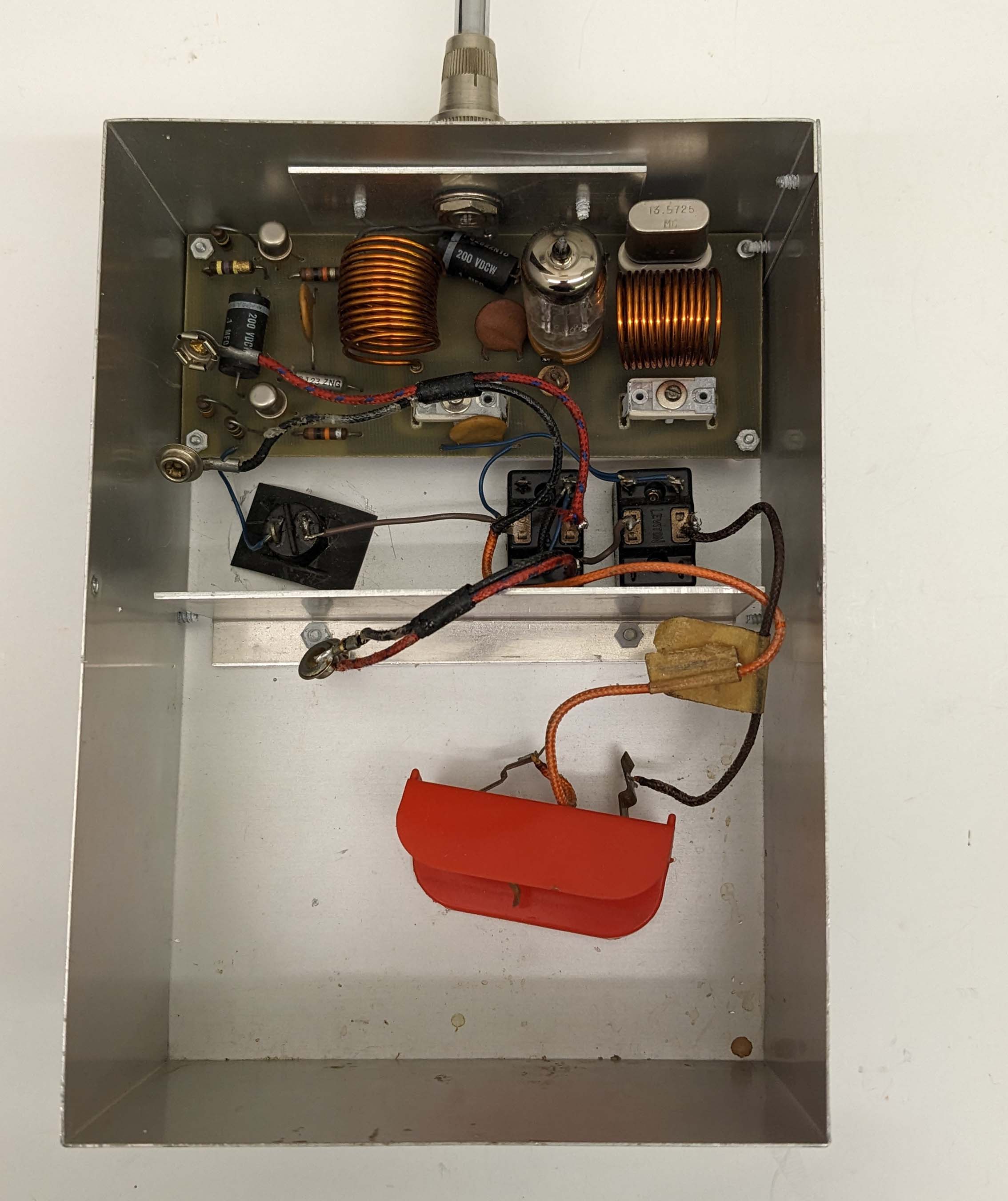

There's nothing stopping me from trying to see if this still works, but I guess the electrolytic capacitors have probably dried out and need replacing. Hopefully, everything else will be OK, but that's probably wishful thinking! The transmitter has a fairly standard 3A5 in the rf section and a pair of 2N224 germanium transistors for the tone oscillator, which I think I have spares for if they are faulty. The receiver has a small wire-ended 6007 valve/vacuum tube in the rf detector stage that I'm not so familiar with and have no spares for, but I've checked on ebay.com and new-old-stock ones do occasionally come up for sale, so I'll bid on the next one I see. It also has two 2N1370 in the amplifier stage and another to switch the relay, all pretty standard.

That's a great find Mike
For the uninitiated "youngsters"(?) amongst us, what did a tx such as this weigh when stuffed with batteries and ready to go? It looks like you would end up at the end of the flying season with arms like Popeye

Tobe is correct, it's heavy with the batteries! There are two 67.5V B101 batteries that weigh 12oz (0.34Kg) each, so that's 1½ lb + 2x "D" cell in parallel that weighs just under 5oz (140g) each, so that's 2lb 2oz (0.96Kg) of batteries. The Tx with aerial weighs 1lb 9oz (0.7Kg) so total 3lb 11oz (1.67Kg). You can see why R/C Tx from the early 1950s were floor mounted with the bleep switch on a fly lead! One common modification for Tx from the late 50s and early 60s was to put the batteries in a small satchel type shoulder bag with an extension lead, to make the weight of the Tx manageable, but still hand held.
It was only a few years later when really small and light weight Tx appeared on the market, such as the OS Pixie and Futaba FT-3A, you realise the rapid rate of progress in the 60s
