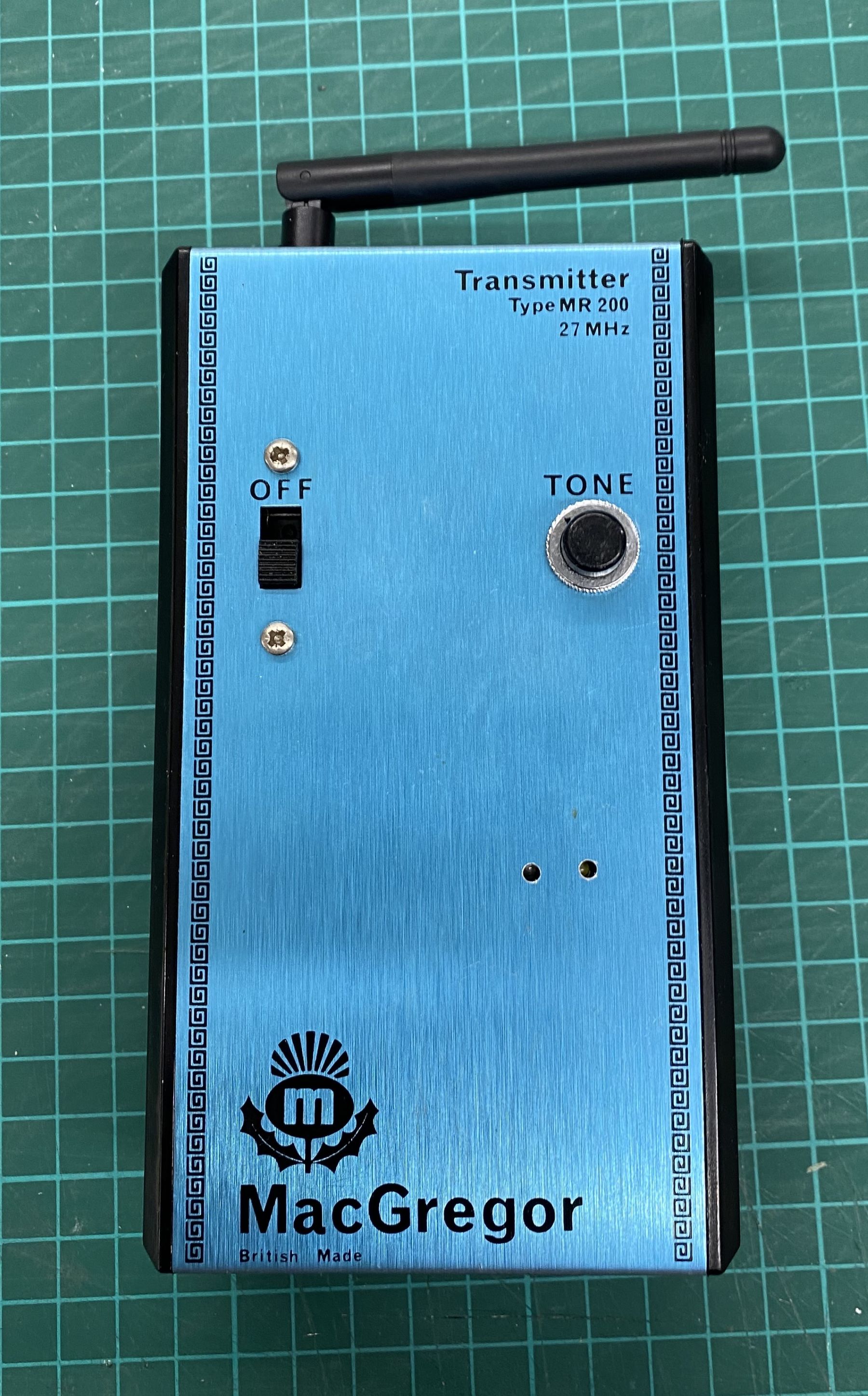

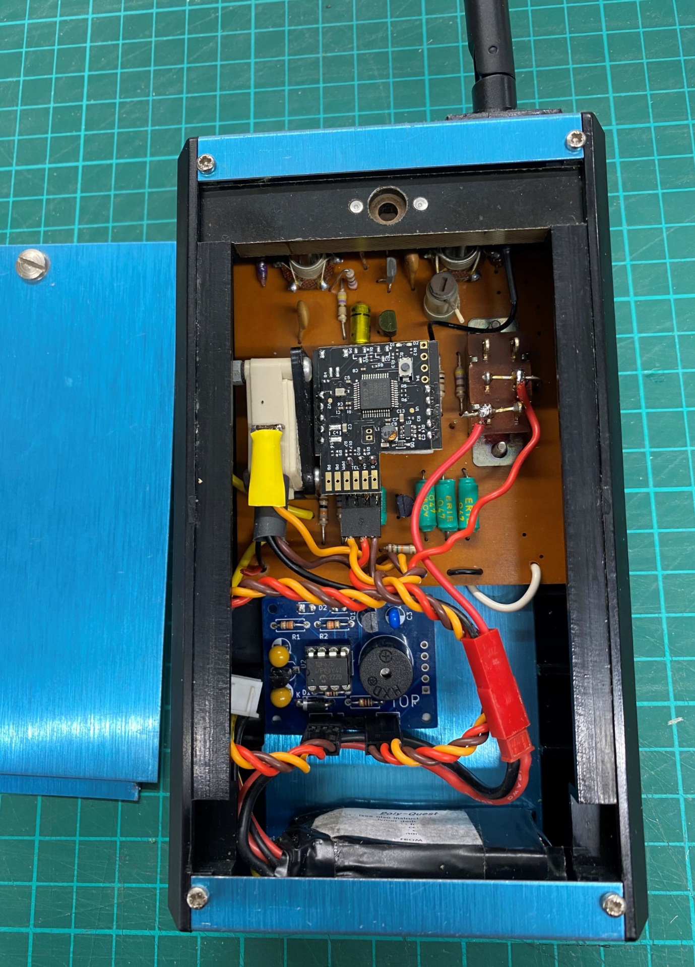

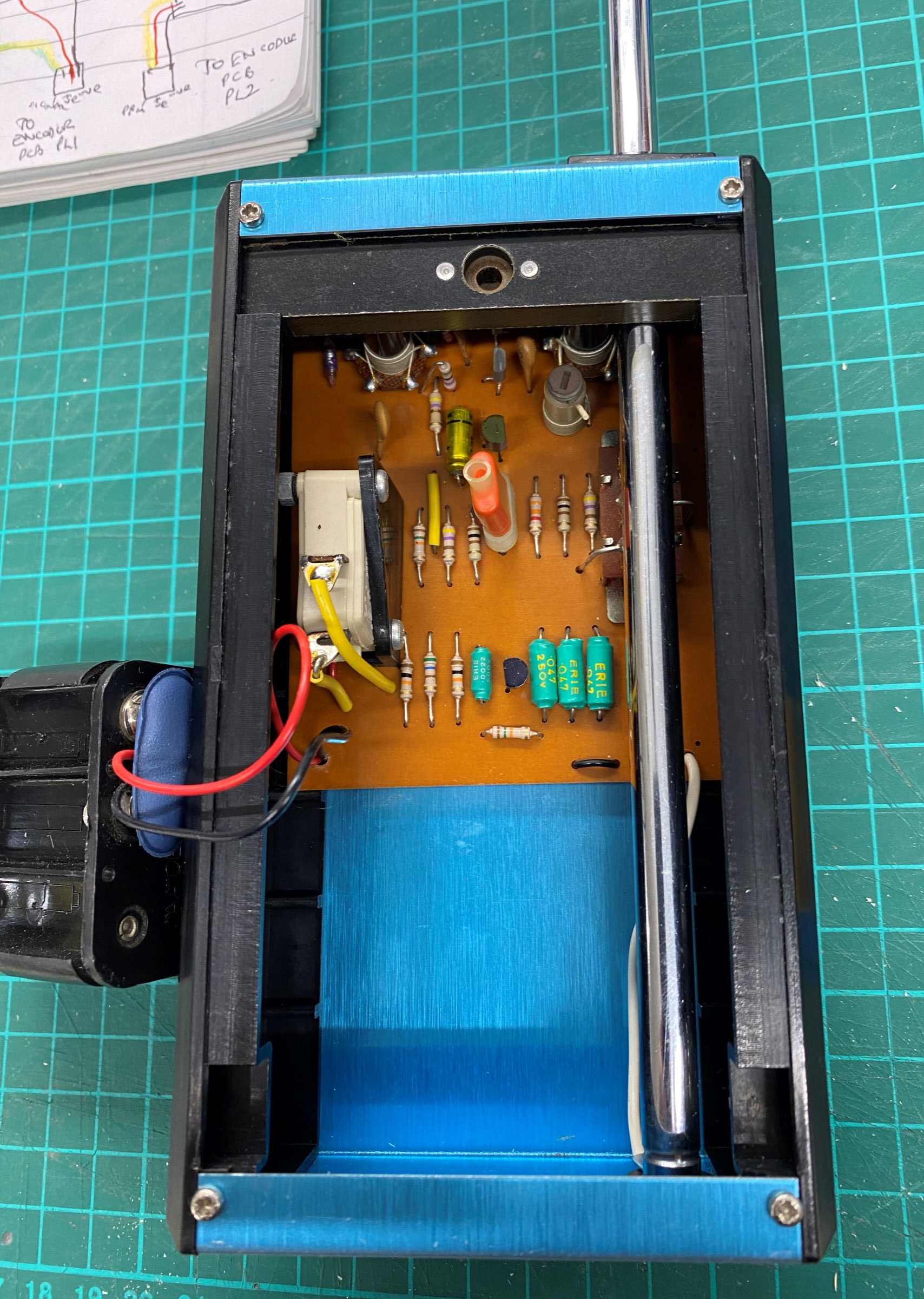

Just finished converting my Macgregor MR200 transmitter to 2.4ghz, using one of Phil's single channel encoders and a Lemon 2.4ghz module. Just a morning's work, as I left the internals as is just disconnected the various leads and added the encoder, module and a 2s1p 450mah Lipo as power. Even easier than the Digimac 1+1 that I finished yesterday.
Ideally I'd have liked to not have to drill the two wee spyholes in the front of the transmitter to see the LEDs, I guess with a bit of extra work I could have worked it so that they were on the top of the transmitter case, but I hope that they don't jar too much and it's handy to have them visible.
