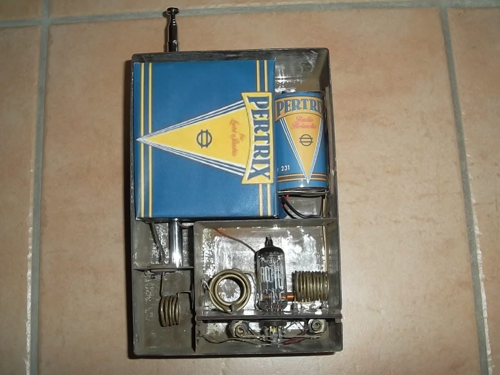

Here's a few images of some old school single channel kits...
If you couldn't solder back in the day then unless you were minted, you basically didn't fly RC. Actually If you knew a Phil, Frank, Martin, Mike,Tobe, Ron etc then maybe you had another option - let them build it for you.
Kits from MacG

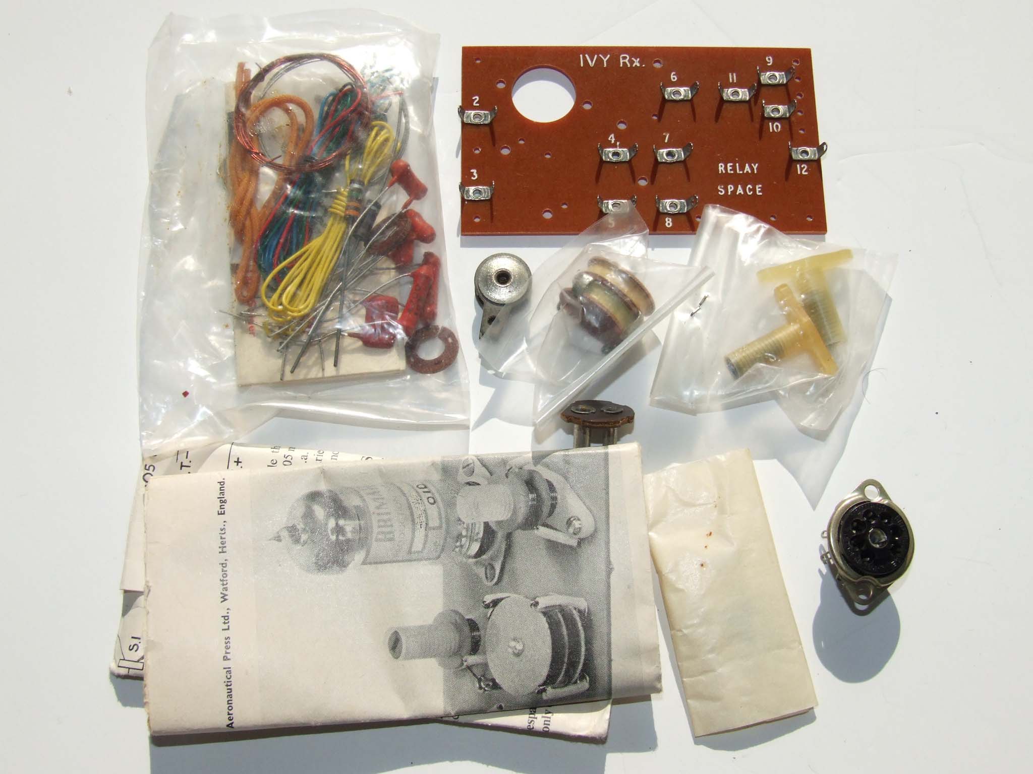

The Ivy valve Rx ( it had pre wound coils to make things a little easier)

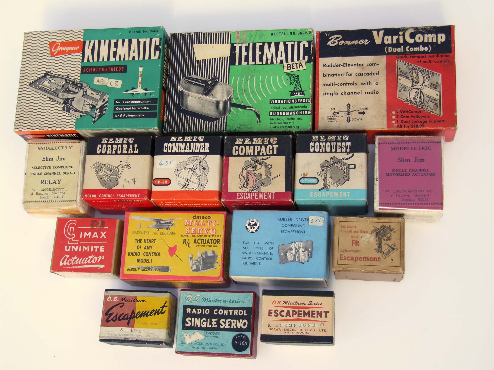

And a few escapements etc
Early DIY s/c radio

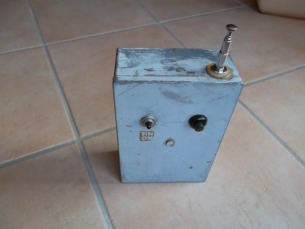

A few weeks ago, one of my elder clubmates gave me some old R/C parts designated for the trash can, to salvage some parts. Among those parts, I found the front part of a Graupner transmitter case, an old Telematic Servo, a partly salvaged Graupner valve receiver, a Metz Mecatron S/C transmitter etc. Here you see the Graupner transmitter which I cleaned up as good as possible and repaired it to full funtion again. It still looks very old and worn and the back cover is still missing, but it works.
I found out, that it is an old Graupner Standard 30 valve transmitter. In spring it will get a new paint job and the proper decals and a new back cover. In the anode-battery dummy are 8 x 9V battery blocks for the required 75V. The 1.4V filament battery is a standard D size NiMH battery with a "new" cover.
By the way, the Telematic servo and the Mecatron transmitter are also repaired to full function.

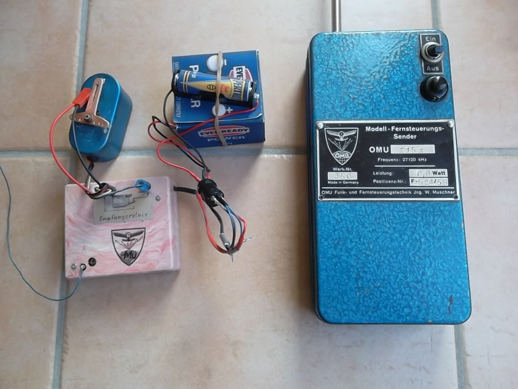

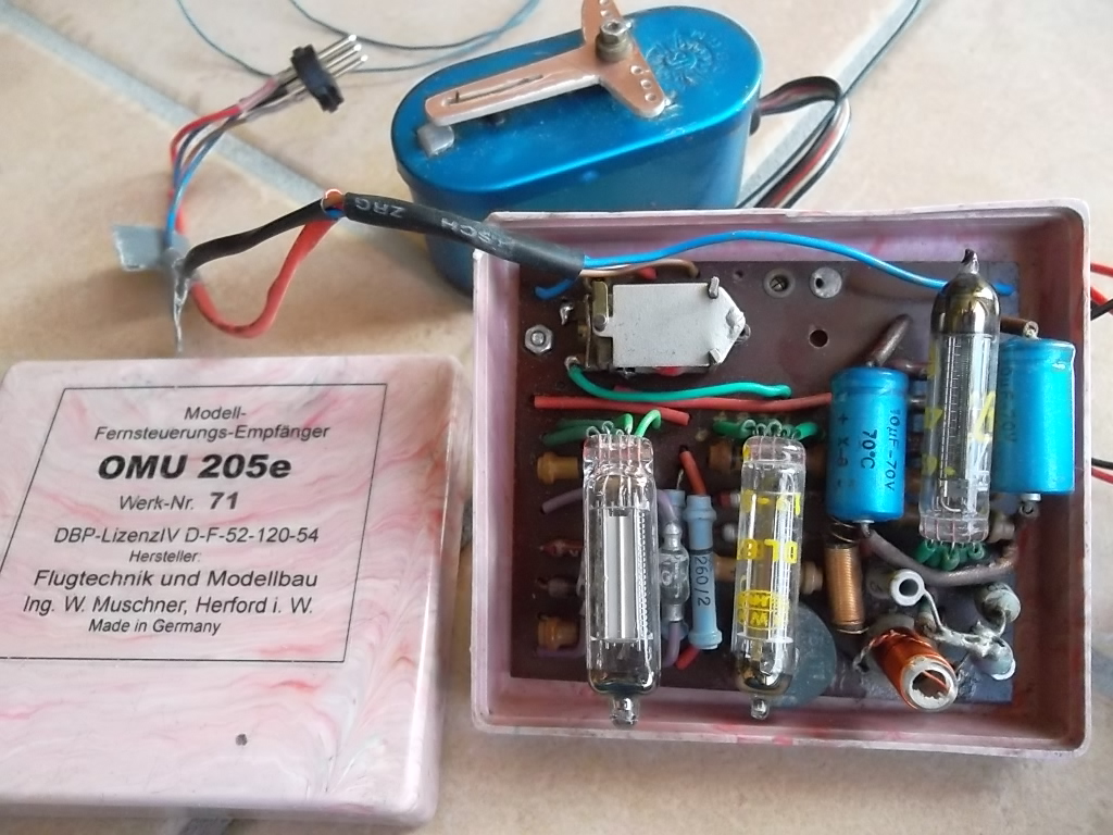

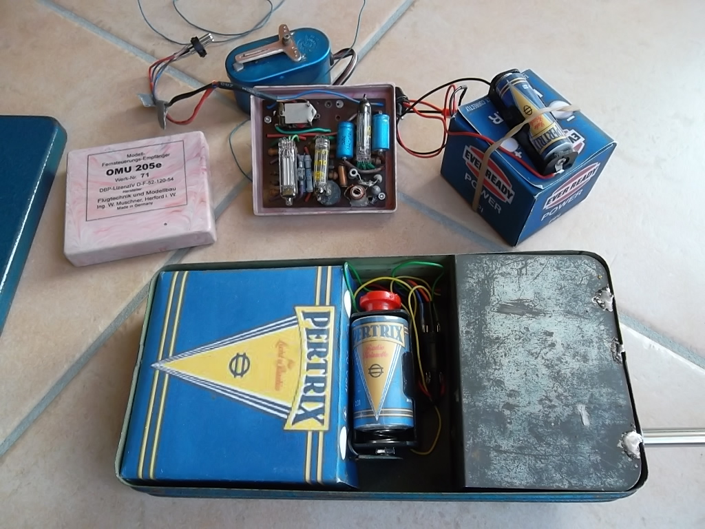

Here you see a very old German S/C set. It is an OMU 215S transmitter with an OMU 205 receiver, both with electron tubes and in full working condition.
The transmitter has one valve and requires a 90V anode-battery (10x 9V block) and 1.4V fillament battery (1 C size NiMH).
The receiver has three valves and needs 45V anode-battery (5x9V) and 1 AA size Eneloop for fillament.
The Telematic S/C actuator works in compound mode and is very interesting, because it is full mecanic and is driven by a magnet which makes a lot of noise. (Sorry, my english is not good enough to explain, what is going on inside). It is the repaired Telematic, I got from my clubmate. It requires a 4-6V battery for operation. Cheers

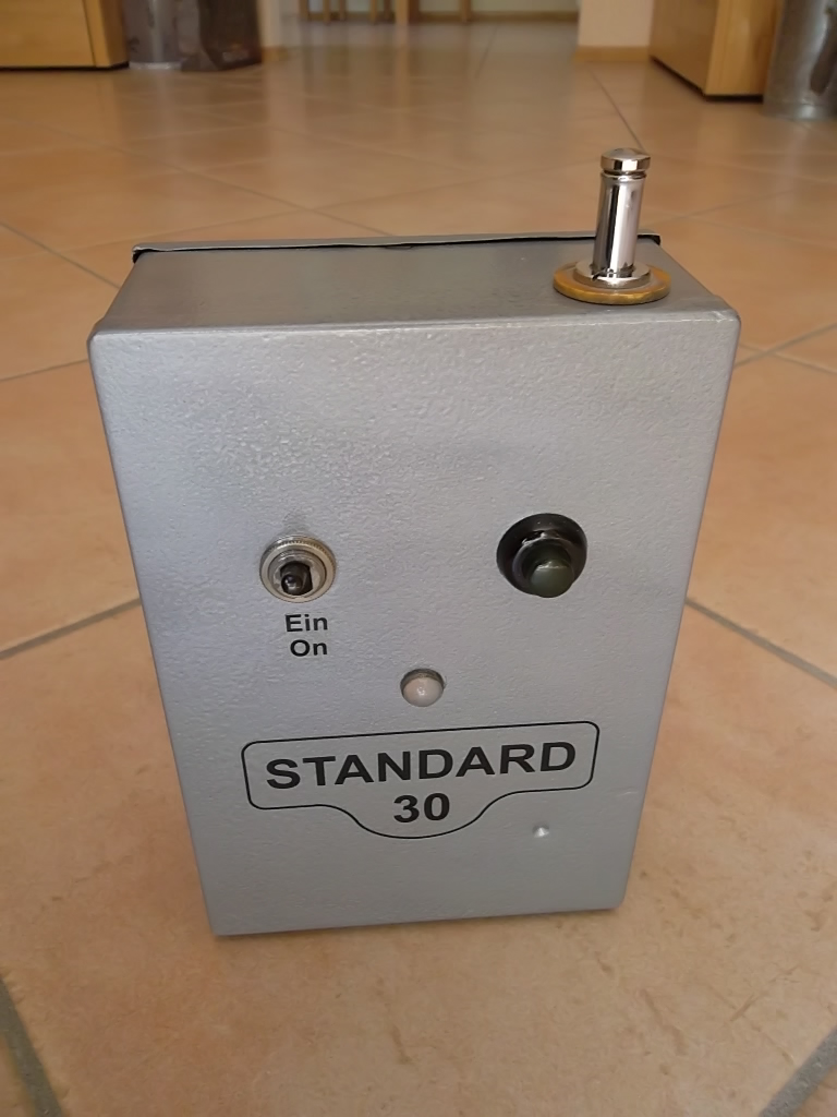

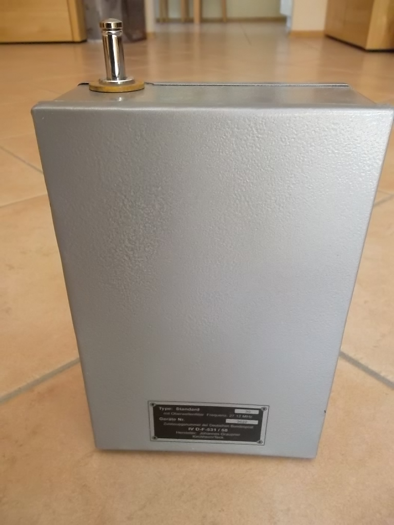

Here is a picture of the finished Graupner Standard 30 valve transmitter. It got a new paint job, new decals and the missing back cover was replaced by a homebrew one from a metal chocolate box.
Frank-
- Posts: 745
Re: Early DIY s/c radio
Fantastic restoration Frank! It looks as good as new.
