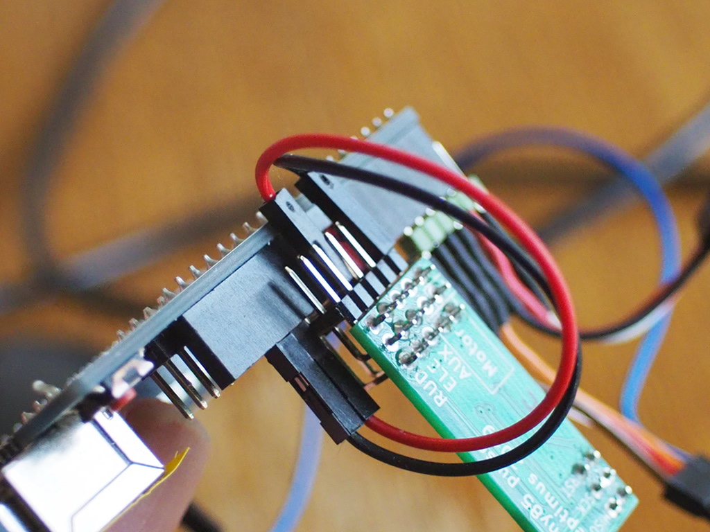

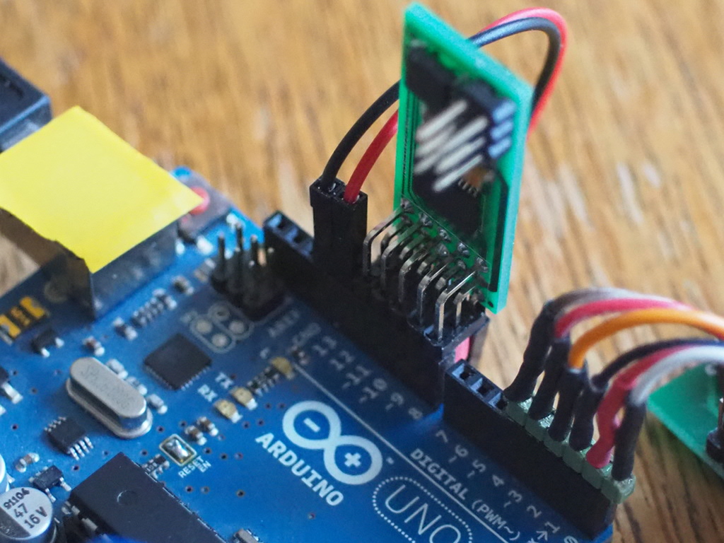

For speed calibration, I just plug the boards into a UNO.
The pulser board is powered by the UNO for calibration - via its Pin 13. As Pin 13 has an on-board LED, this lets you see when the board is powered up. You can see I used a red wire into Pin 13 and a black wire to the adjacent GND terminal - and these connect to the pulser board where you'd expect.
The UNO also has three push-buttons attached to its Pins 2, 3, 4. These are just momentary buttons that connect to GND when pressed.
Run the sketch on the UNO, switch to the console (monitor) view in the Arduino IDE (Ctrl-Shift-M). Set the monitor speed to 115200 baud. Once the UNO has powered up the pulser you should see a measured frequency and an OSCCAL value scrolling up the screen.
The pulser tries to send out a frequency of exactly 1000 Hz, but of course if its clock is running too fast or too slow the frequency will be a little away from 1000. Press the button on pin 2 (+) to increase the value of OSCCAL and therefore the frequency, and similarly the button on pin 3 (-) to reduce the speed. When you've got it as close as possible to 1000 Hz, press the button on pin 4 (W) to write the OSCCAL value to the EEPROM.
Note that there is a discontinuity in the OSCCAL response at the 7F to 80 position. The frequencies increase from 00 to 7F and increase again from 80 to FE, but there is a backwards jump in speed as the 7F to 80 boundary is crossed. The two regions overlap so you may find pairs of OSCCAL values that give the same frequencies in roughly the 70 to 90 region.
