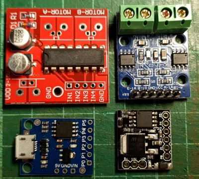

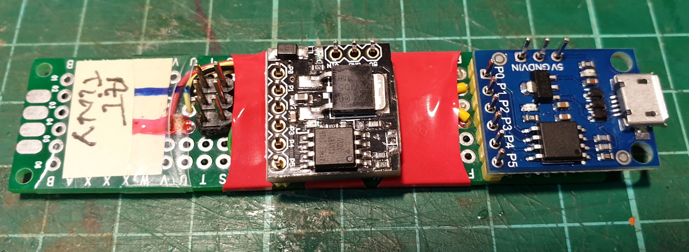

I managed to 'borrow' a few hours during the week to do some experiments with the DIY sketch and 2 different ATtiny85 boards and 2 cheap H-Bridge boards off the Bay. These are the boards: One ATtiny board is the DigiSpark with the USB tab removed (as per Phil's post) & the other is a slightly different configuration with a micro-USB socket fitted. I had an oops moment when sawing off the USB tab - the saw slipped & knicked the board cutting a track but fortunately I was able to repair it. Note that the spacing between the power pins & the P0-P5 pins is different between these 2 boards - this prompted me to modify my ATtiny85 ICSP programming board to accommodate both types, thus: The two H-Bridge boards have similar specs, the blue board is smaller & costs a few more cents, but neither is expensive! The physical configuration is different and the labeling is subtly different too, as evident in the pictures.

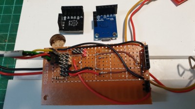

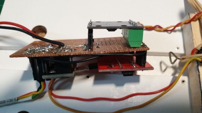

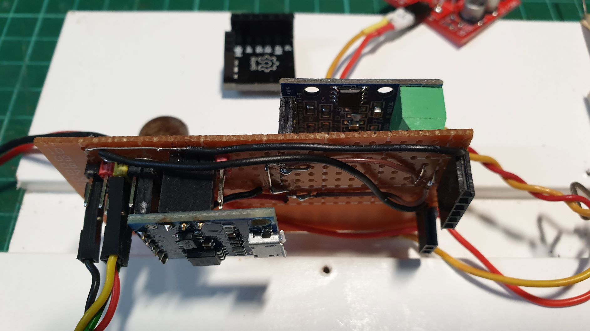

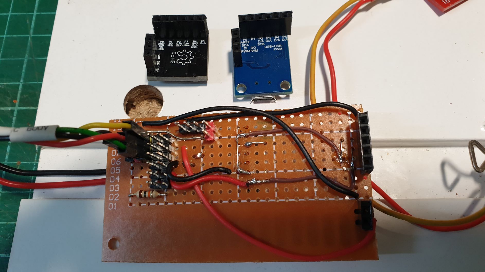

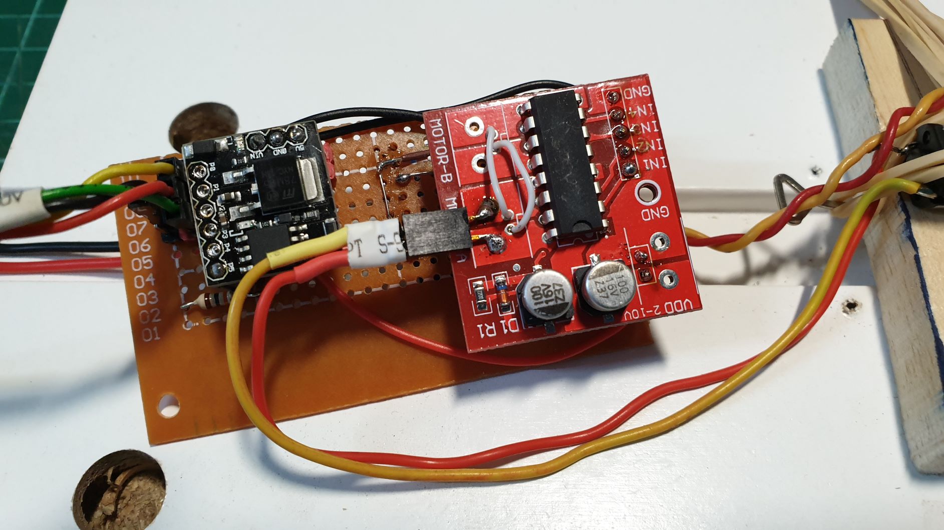

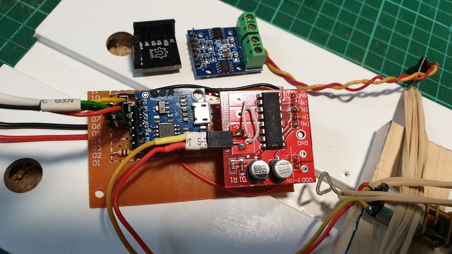

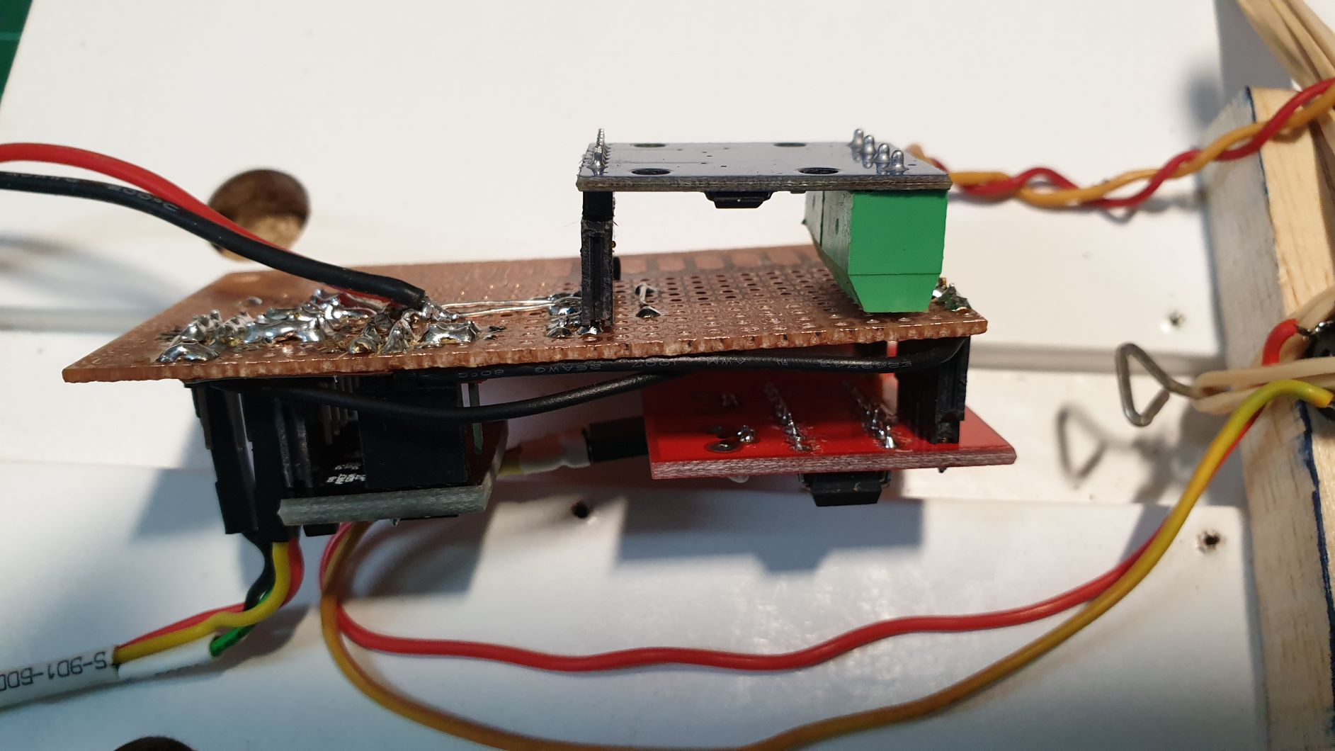

For my experiments, I made up a board with sockets & pin headers, so all 4 boards could be easily inserted/removed to test all combinations.

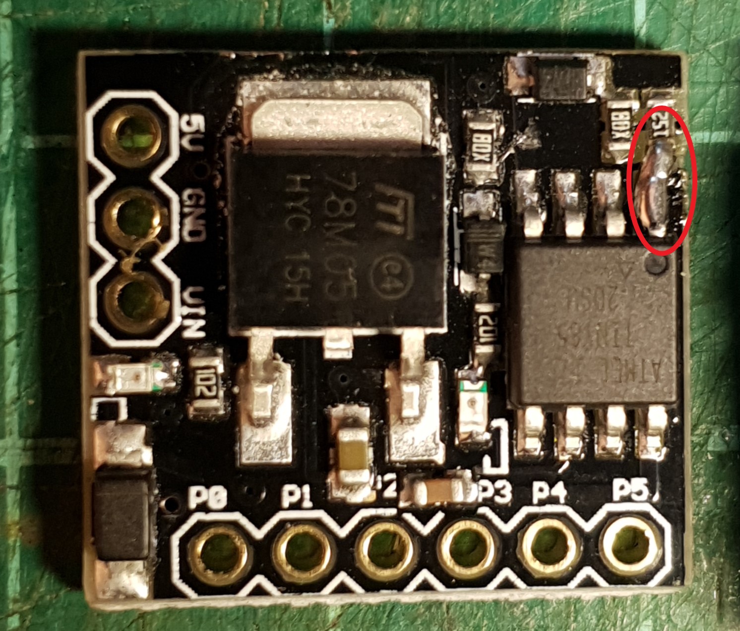

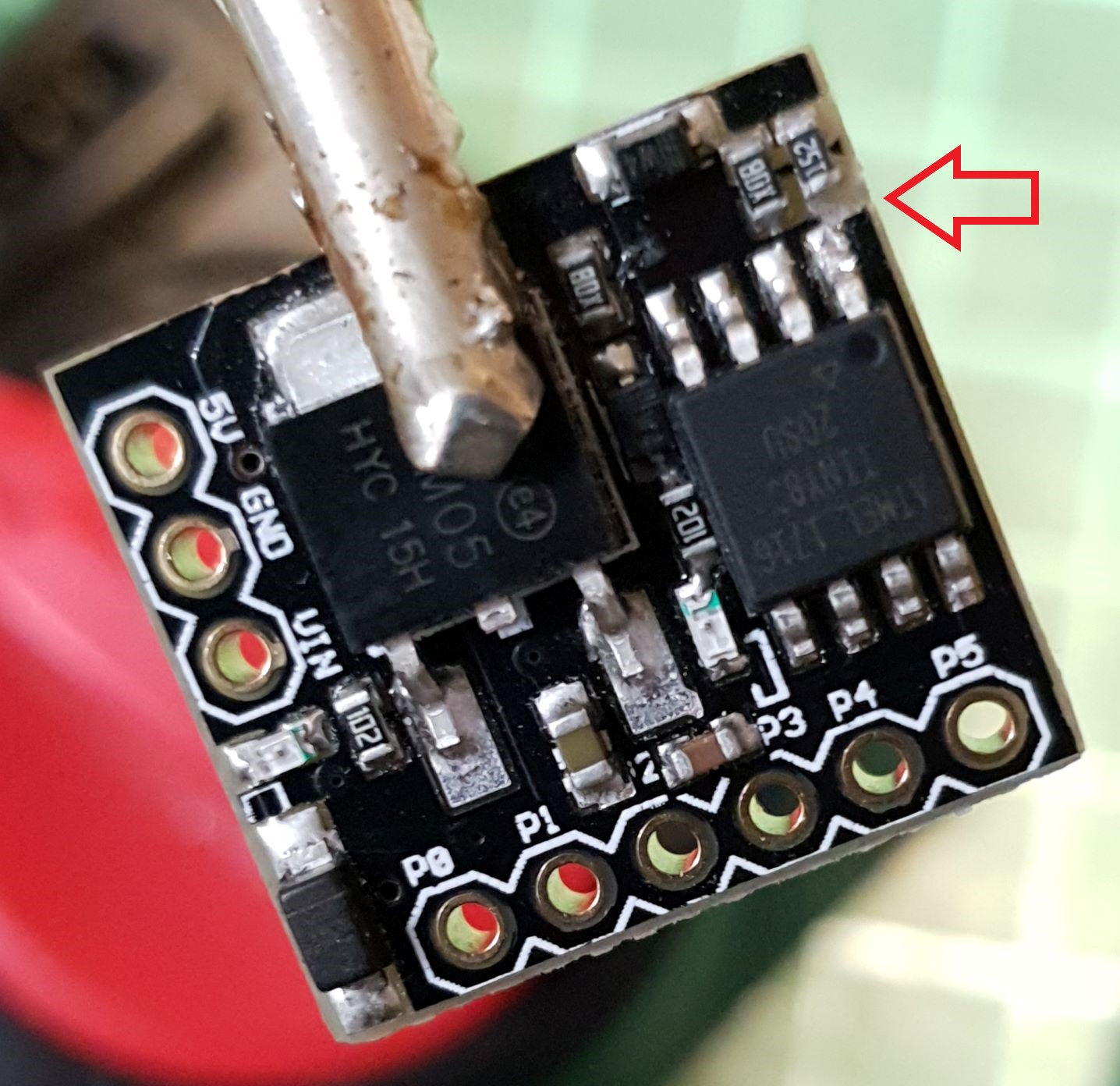

The ATtiny boards had sockets fitted so that I could plug them onto my ICSP programming board if code changes were needed. Once I found the one (of course ) bridged solder joint (suitably & colourfully cursed, of course ) all worked as it should, on 3 different motor+g/box combinations.
