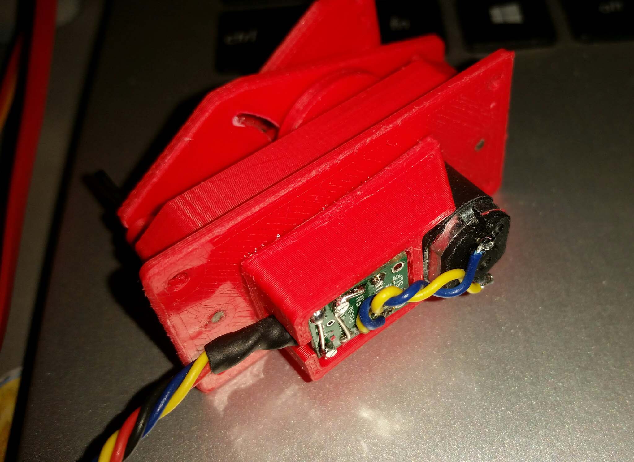

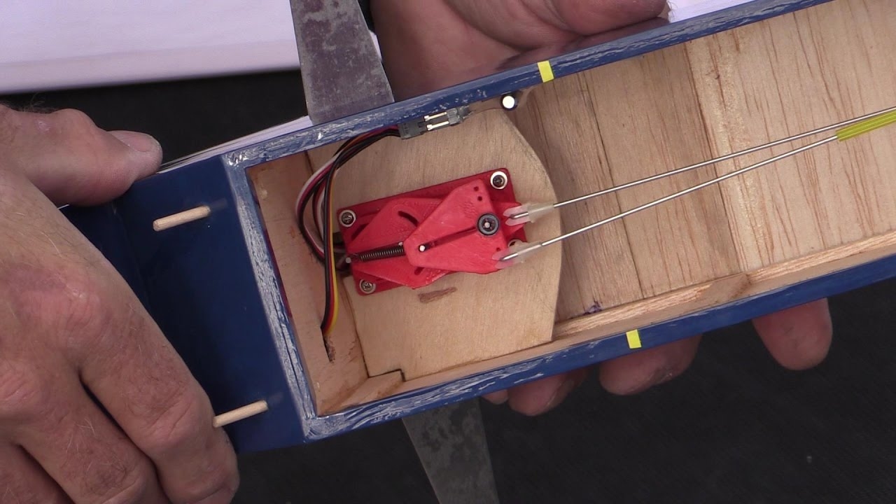

It consists of a "Rand clone" actuator, designed, 3D printed and assembled by Tobe, driven by PIC re-coder electronics which convert conventional rudder & elevator channels into a variable mark/space and rate pulser with a high current FET bridge to drive the actuator. Tobes "Rand clone" is superb and emulates the original in every way other than it has no throttle mechanism - that comes direct from the receiver throttle channel.

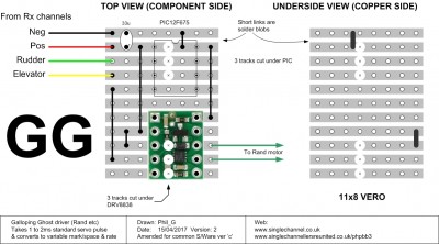

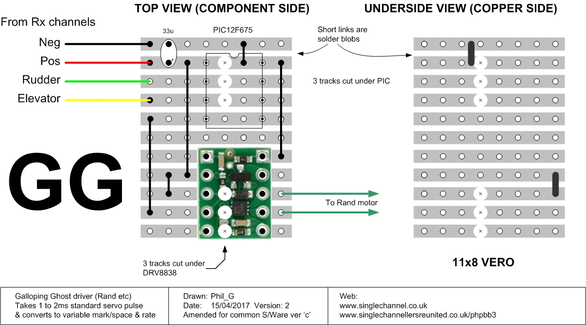

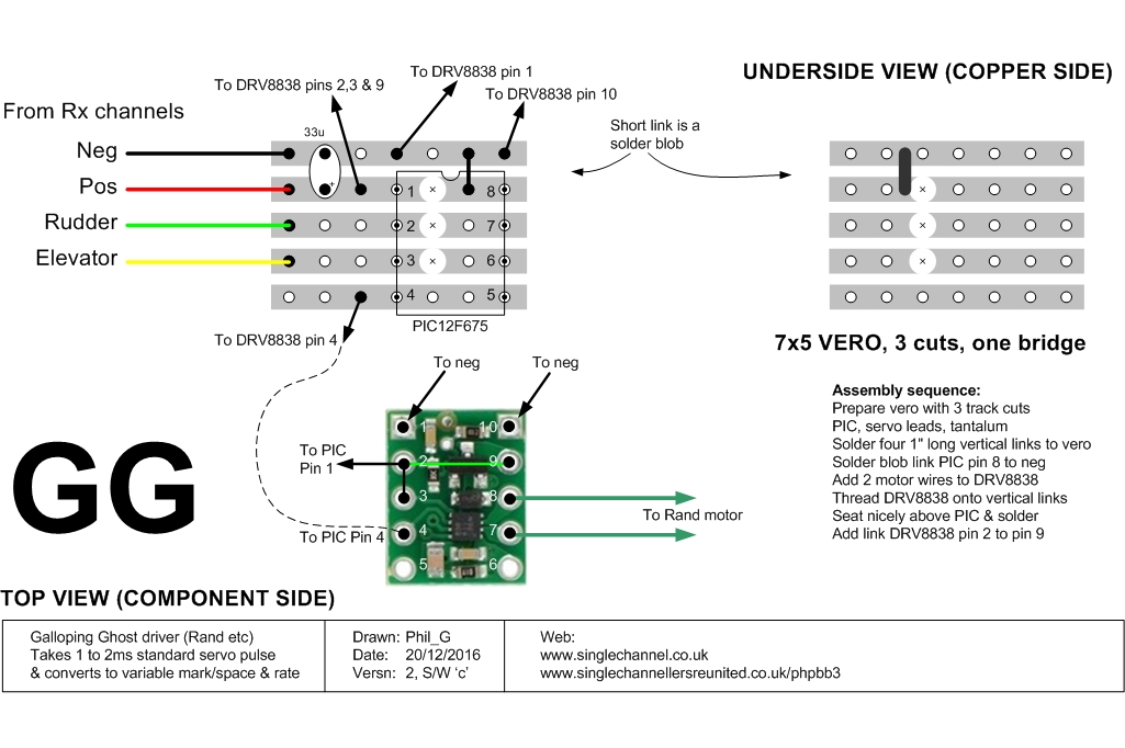

For those who wish to DIY, maybe with an original Rand, a bare Tobe-GG or a Mighty-Midget/birdcage arrangement (as perfected for the second time in history by a member of the Lovegrove family!) then here is a vero recoder layout, actually two, a flat, easy one and a piggy-backed compact one thats a bit harder to make.

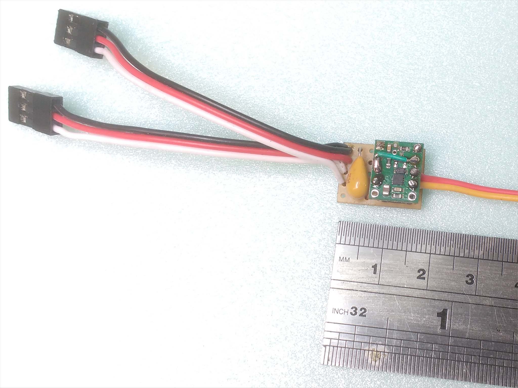

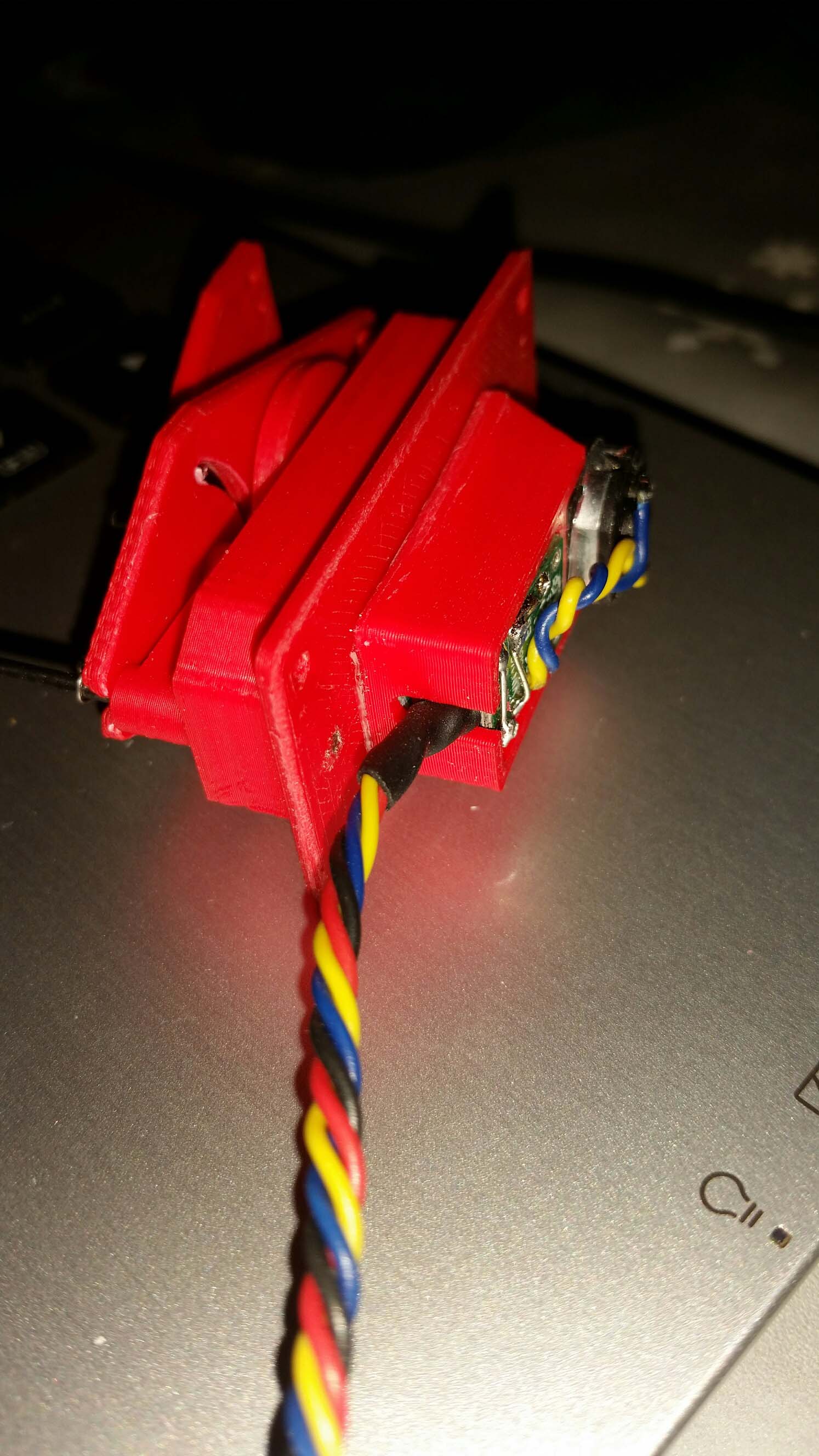

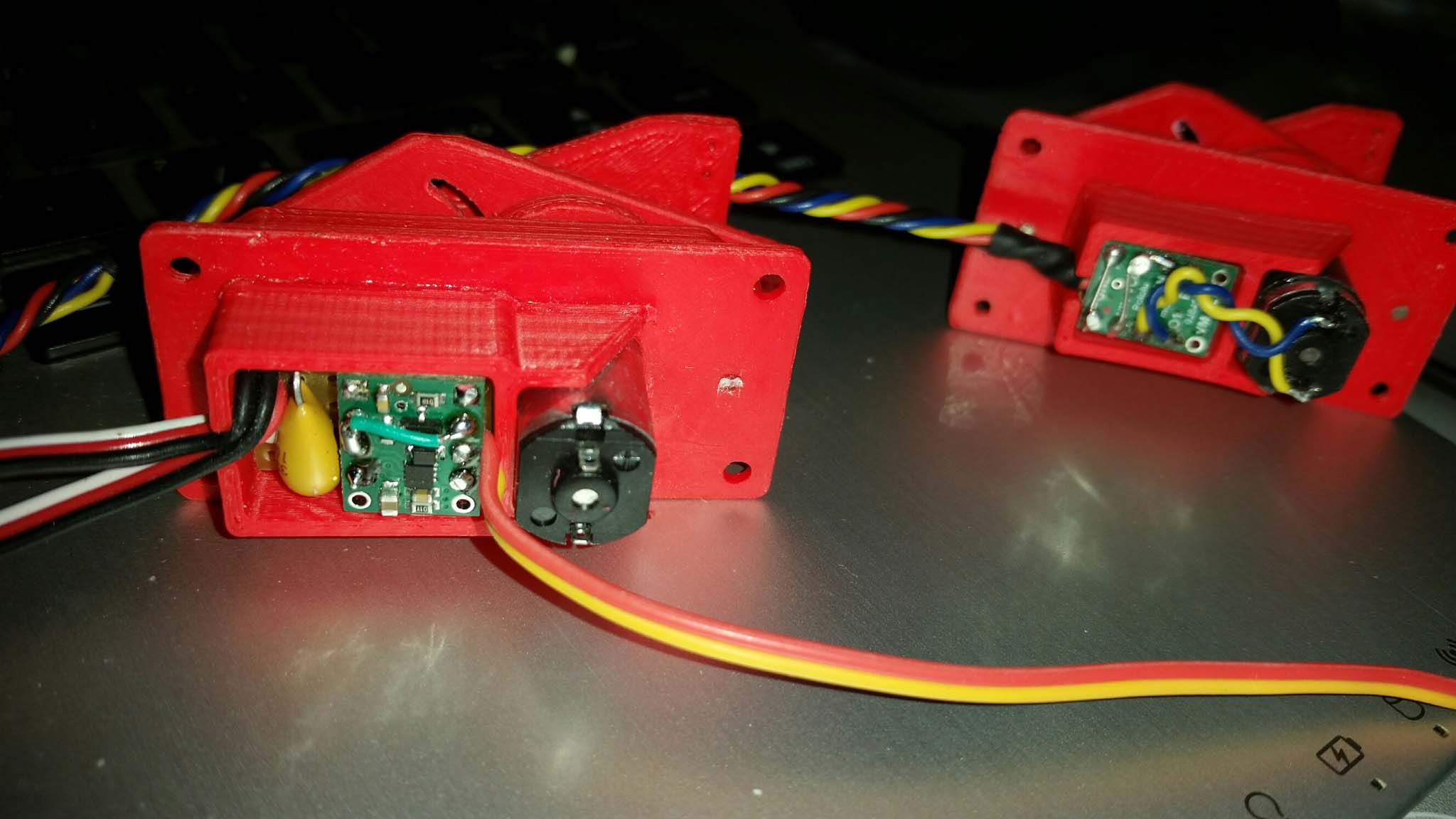

Tobes version which he supplies with the plug-&-play version is even smaller, barely larger than the PIC chip, and is neatly integrated into the actuator moulding. Whilst Tobe's P&P actuators are complete and ready to fly, the recoder PIC chip itself is available for DIY fans, email me, and the DRV8838 bridge comes from Technobots or Hobbytronics in the UK. US members try Mouser, Digikey or Pololu.

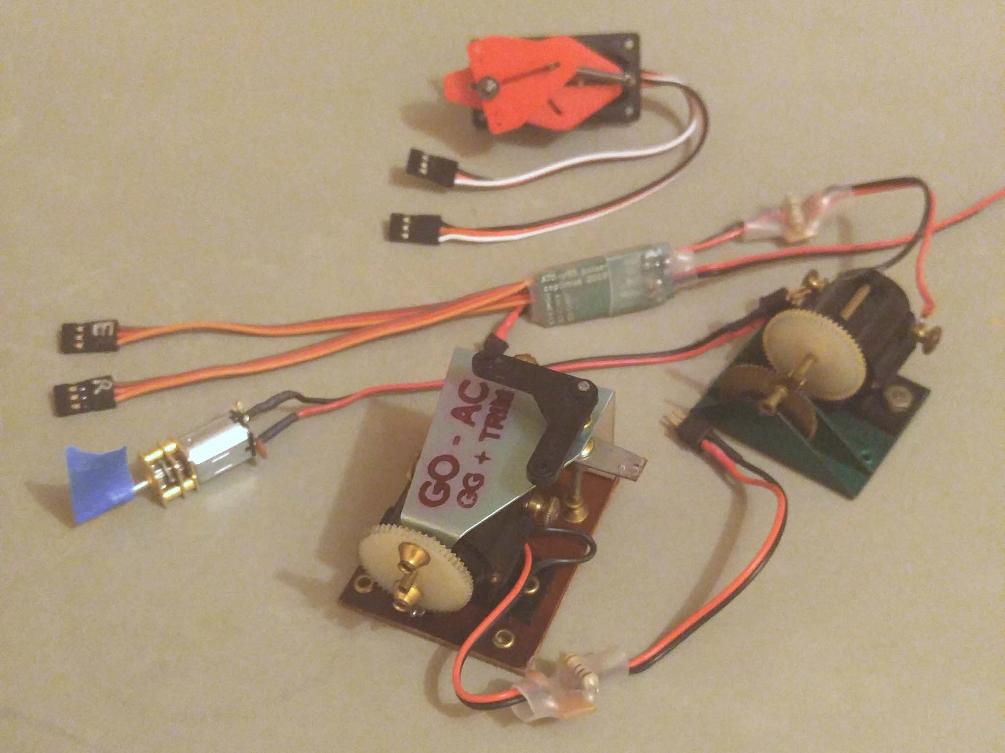

Baby-brother to the GG actuator is Tobe's rudder-only Adams replacement, not a clone as it works on a different principle using a geared motor - so whilst its far more powerful than any Adams, in practise it works in exactly the same way as its ancestor. It uses a similar PIC recoder circuit (but with different firmware) to provide the necessary pulsing, driven by the rudder (ie aileron) channel of any conventional propo radio.
The end product is a totally convincing Adams installation, just like the old Ace sets!

.... and the Tobe GG actuator itself:
Please note that when the piggy-back layout was devised, I had to slightly change the PIC pin assignments used in the original 'flat vero' layout, so although software 'b' and 'c' are identical in function, the PIC pinout is different. Having two versions is a pain, so I've changed the 'flat' layout so both 'flat' and 'piggyback' layouts use the same pinouts and therefore the same software version. Bear this in mind if you're comparing last-years 'flat' layout with the 'new' diagram:
Here's the preferred 'piggyback' layout. Both function the same - whilst the 'flat' layout is easier to make, the piggyback layout is much smaller & neater:

Since this was posted we now have a choice of Re-coders - the original PIC version,
Martins GG Recoder for ATTiny85 &
Phils GG Recoder using the DigiSpark

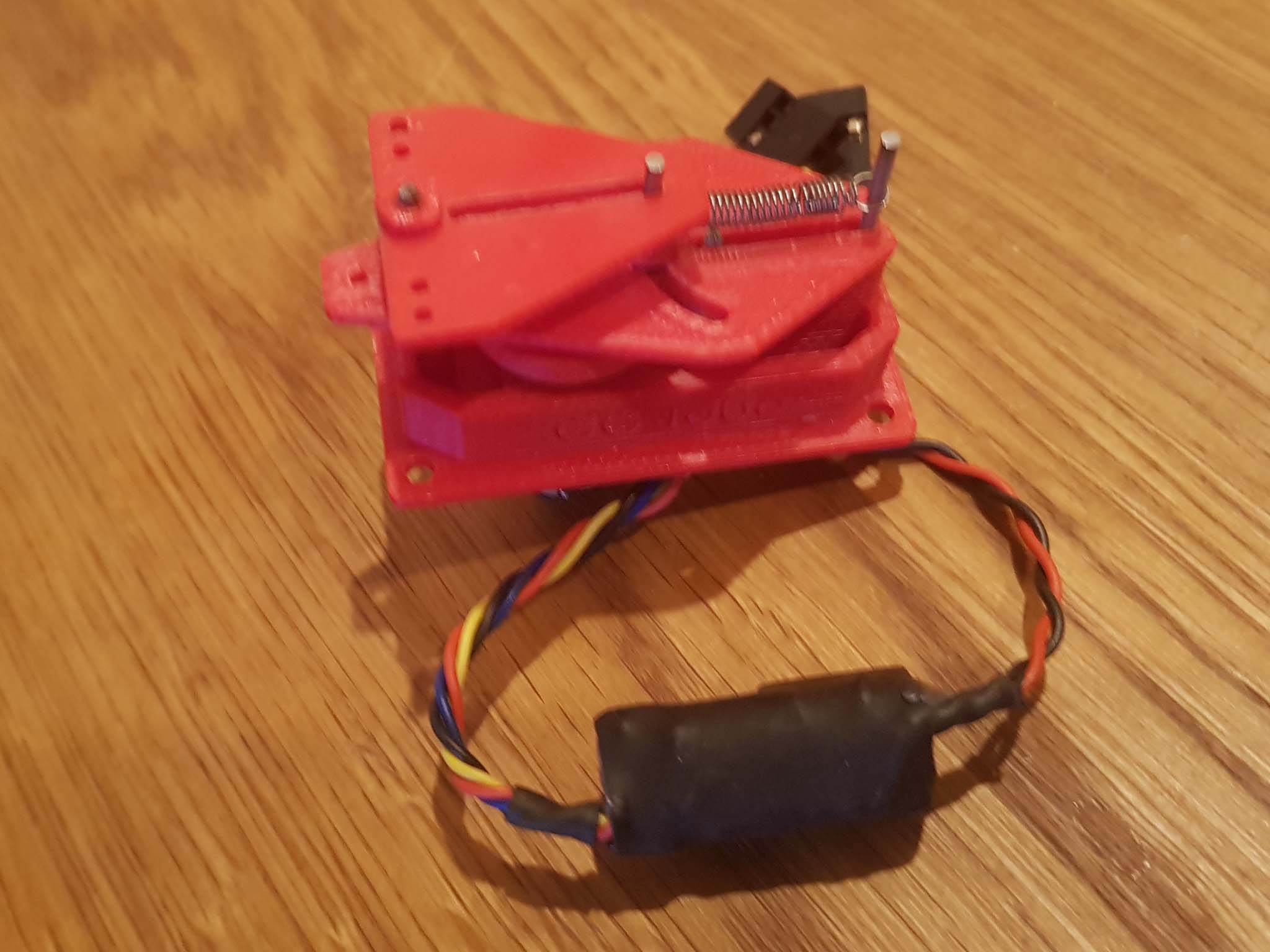

.....just checked my quasi records and found out that I must have built in the range of 225 actuators of all kinds included all try and error in development/blue smoke phase. I would guess that of them about 125 of GG-Tobe and 30 Adams clones are out there of which about 2/3 have been PnP, the first out were in March 2016 but the project started almost 2 years earlier. The recoders were built up separately utilizing an IC-socket as base.

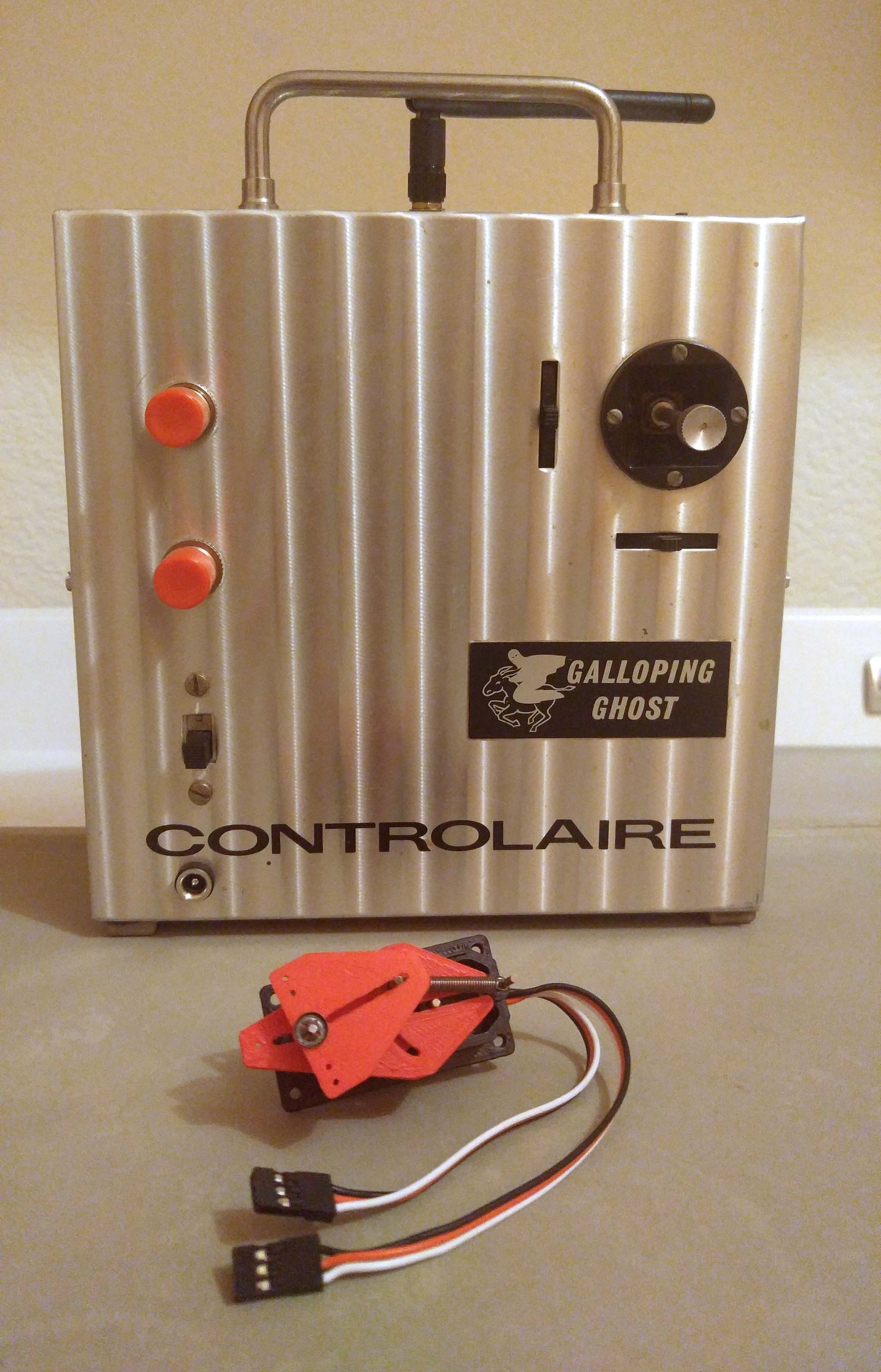

Hey all. First off a big thank you to Phil, Shaun, Jay, Martin and all the other folks in making vintage R/C fun and reliable! Thought it was time share some of my projects. In the GG category this time is a Controlaire GG transmitter converted with a Phil G GG board and DHT diy transmitter with a Tobe two function actuator. Is was a fun project and everything works well. Still need to put it in a plane. A TF Schoolgirl of School Master perhaps. Also have a few GG actuators to test. Will update soon.

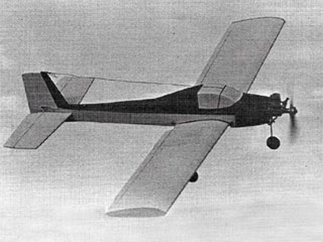

Some weeks before that, following a disappointment with the performance of another GG project, I looked around for something new that would be suitable and lit on the Titewad by L.F. "Randy" Randolph. I think I might have built this model many years ago - it seemed very familiar - anyway, it's a simple build. It has a somewhat quirky look to it but with generous areas and a decent moment arm, it looked a good bet. And it's on Outerzone.
At 48" w/s the original size was a bit bigger than I wanted, so I reduced it to 30". Also, as the original had ailerons, I simply omitted them and increased the dihedral to about 14 degrees. Powered by a 2S LiPo driving a 2805 EMax motor, it flies very well indeed; smooth, responsive and stable in all axes. Success! Highly recommended.
I should add that I used one of my homemade actuators which employs the 100:1 cheepo Ebay gearbox (like the one in the photo above) mounted on a vertical sub-former so that it is aligned fore and aft. This makes connection to a torque rod easy. The "birdcage" at the back end was also straightforward and the whole set-up is more than adequately powerful. It would comfortably fly a much bigger model.
