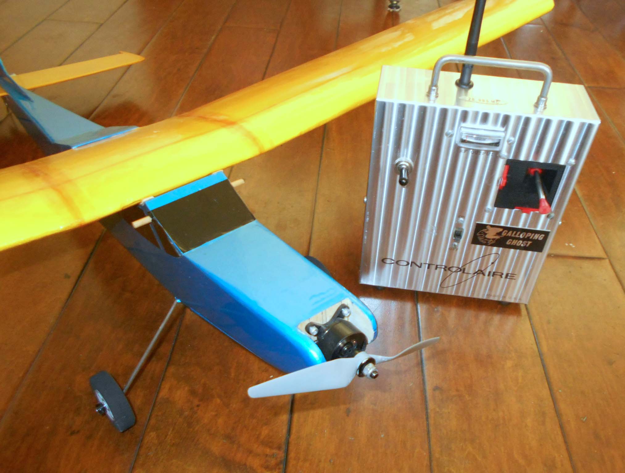

Controlaire GG conversion with positionable throttle
Post by jmendoza »

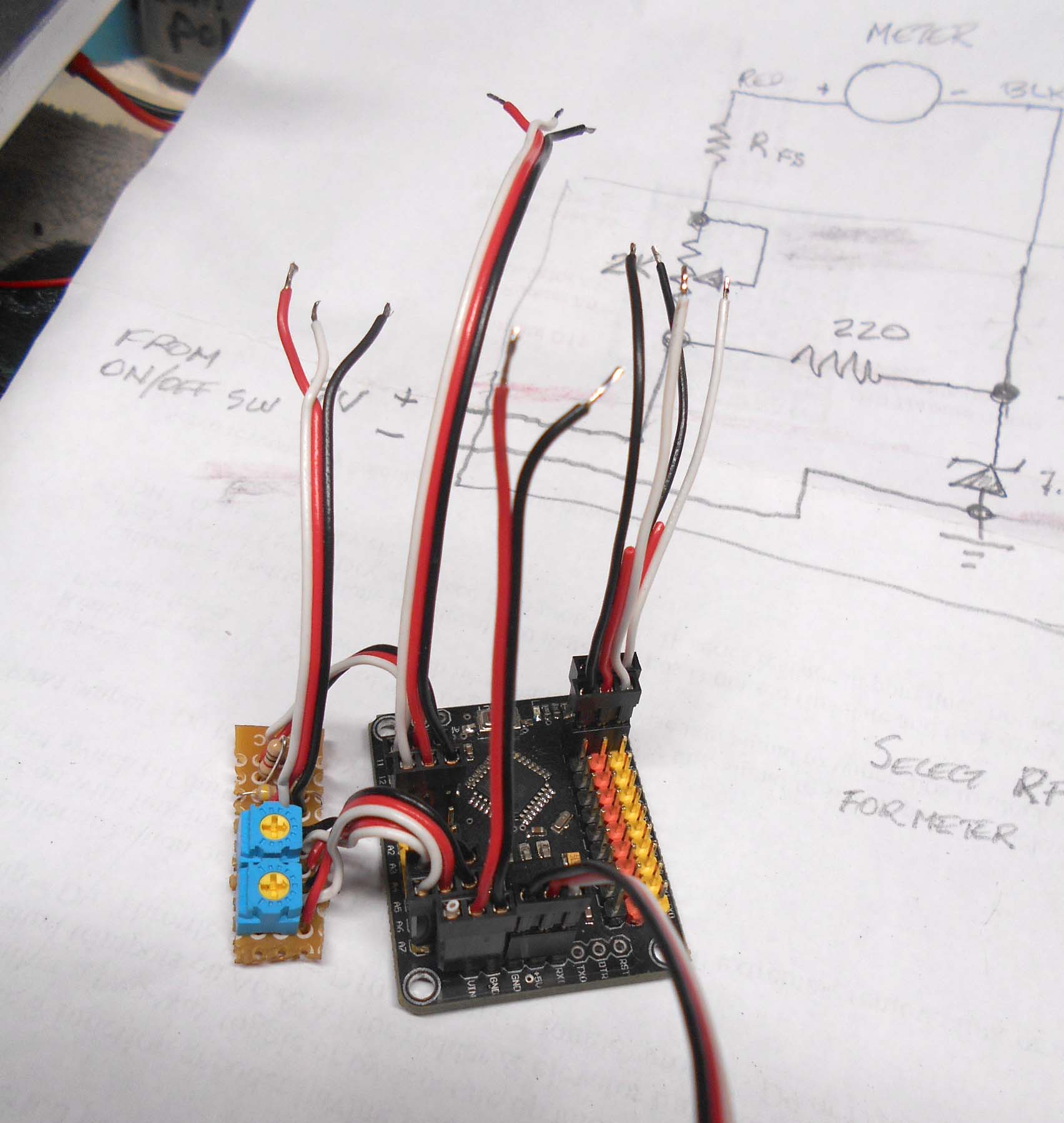

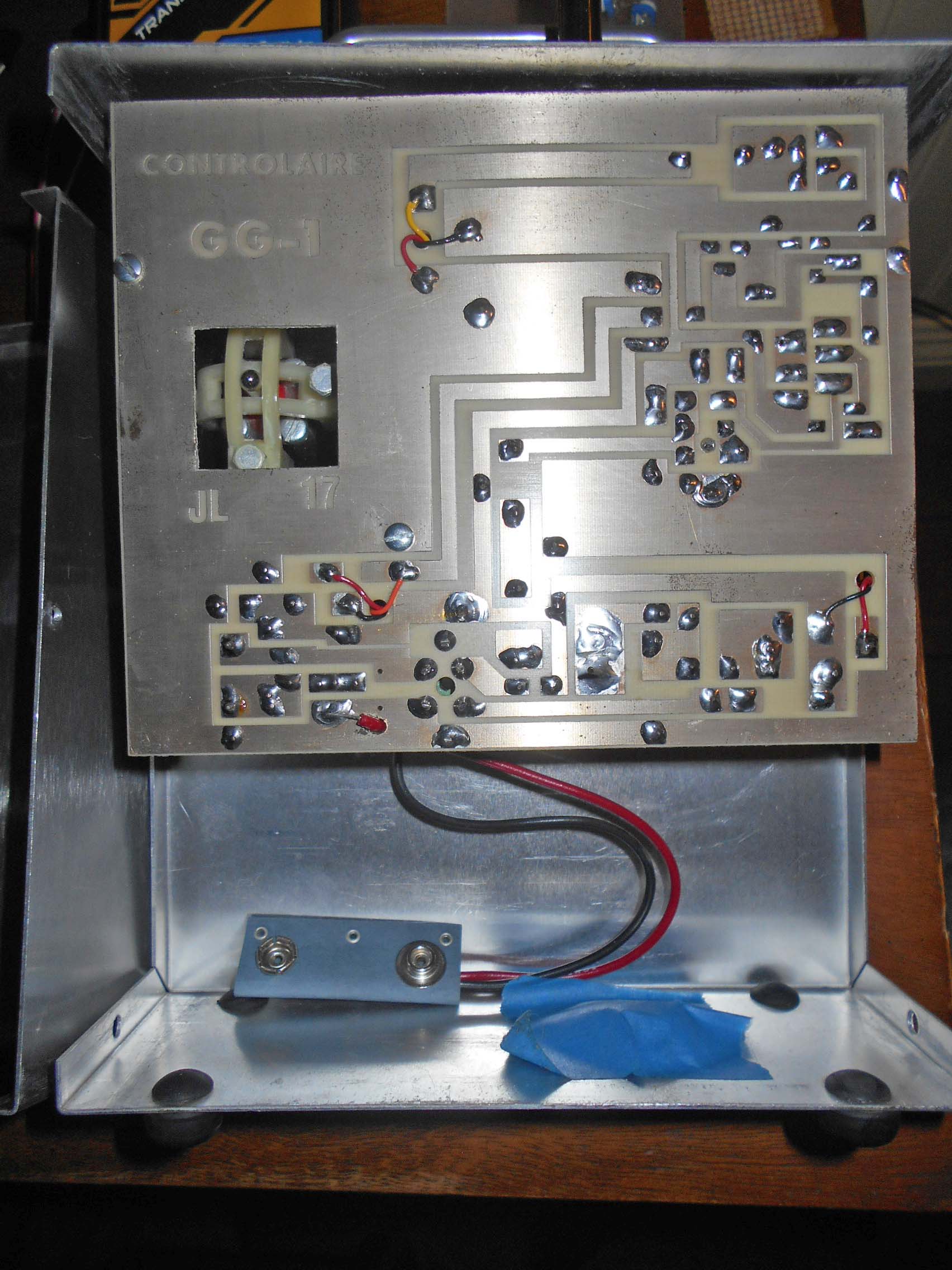

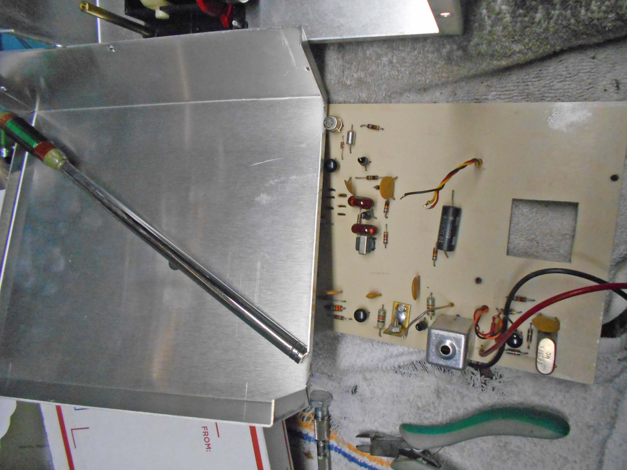

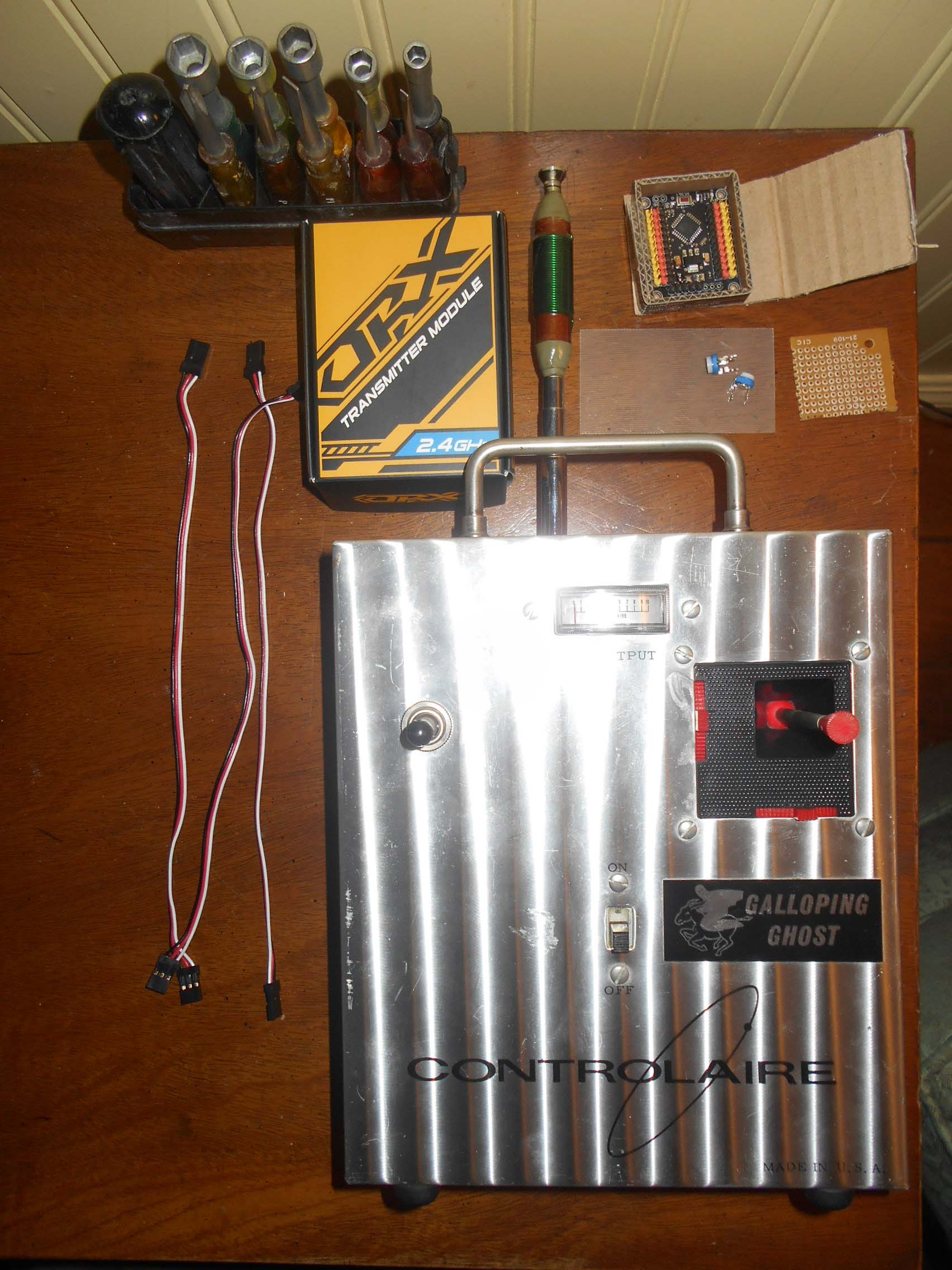

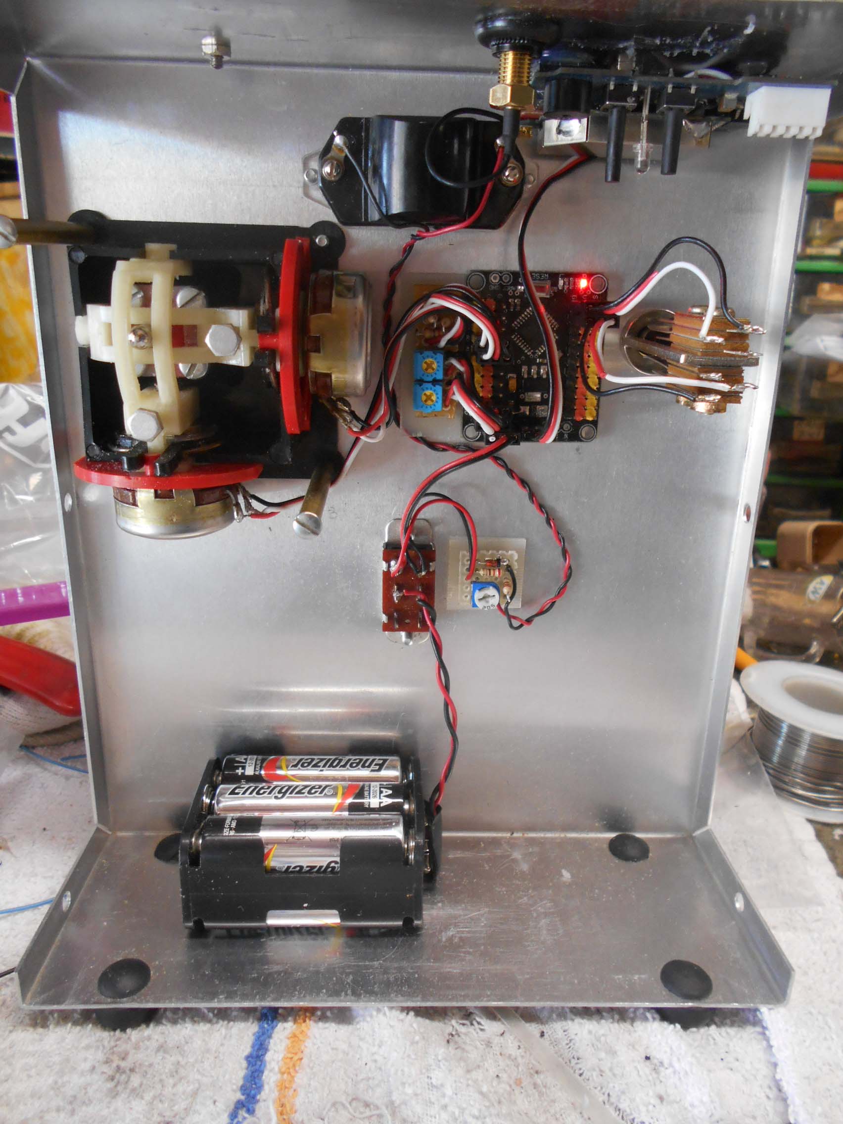

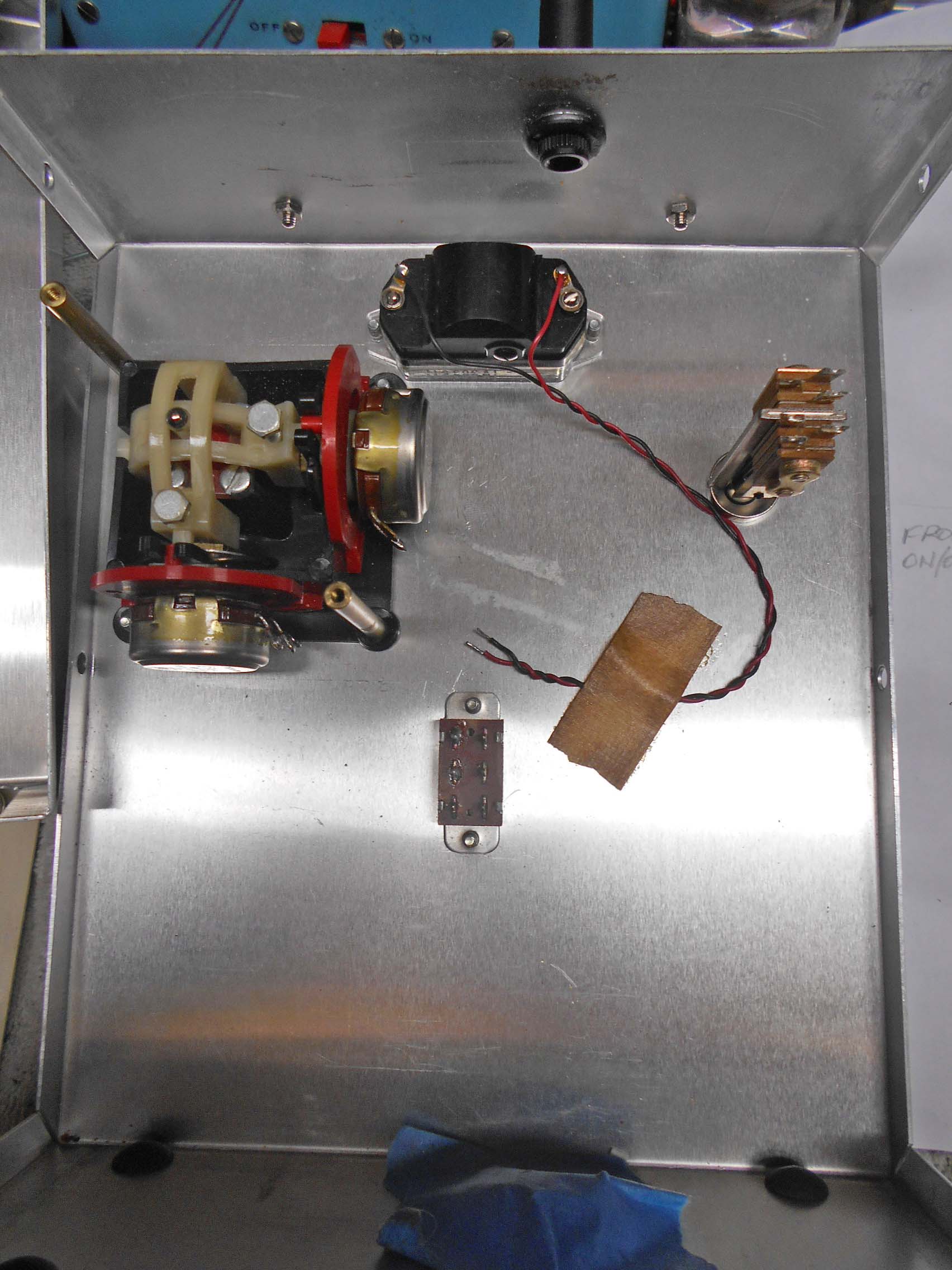

This is my dream come true, thanks to Phil. I received this transmitter for Xmas 1969 from my grandpa. Never was able to get the system to fly in my Jr. Falcon, as the 4 AA cells, F&M Vanguard receiver, and Rand GG-Pak
was too much weight for the Cox Golden Bee .049 to lug into the air (airborne alone weighed 7 ounces). If it had flown, it would have been a bomb. Well the dream is now reality, I have flown a Jr. Falcon using the transmitter and a Tobe GG actuator both equipped with Phil G electronics. I'm using Orange Rx module, DSM2, and Lemon RC , Spektrum, and Orange RX receivers. The conversion is relatively easy if you have good soldering skills and electronics experience. Feel free to contact me with questions or assistance with your conversions.
