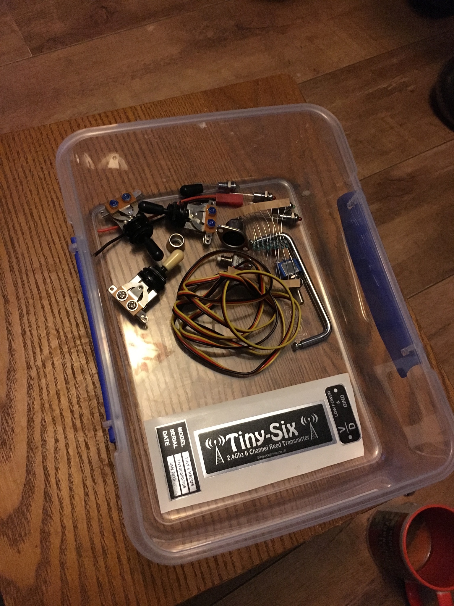

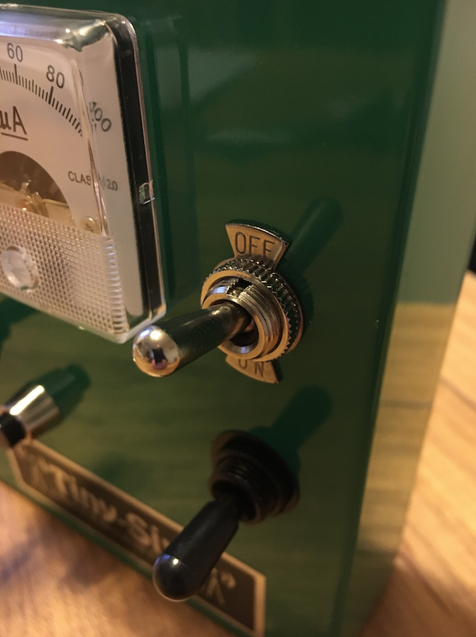

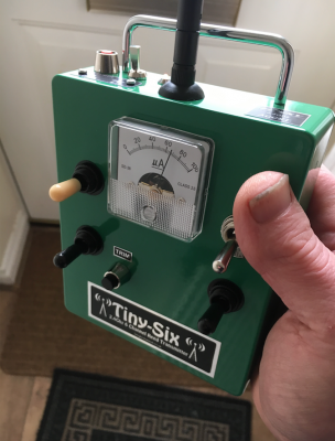

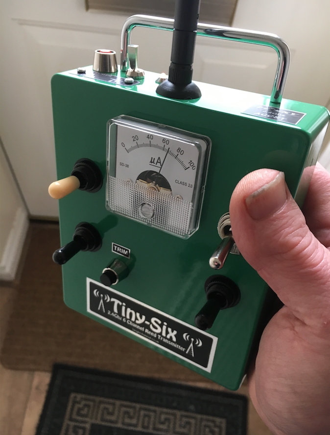

Some photos of my latest project, My new Tiny6 HQ reeds transmitter
I just fancied something with a nice big meter, just to give it that retro look.
Used Phil's original tiny 6 encoder and a D series FRsky RF module.
The case is a powder coated off the shelf Hammond 1590XXGR type available from Farnell. The decal is my usual type, laser printed on clear vinyl then stuck onto some chrome self adhesive vinyl, finished off with a spray of clear lacquer.
