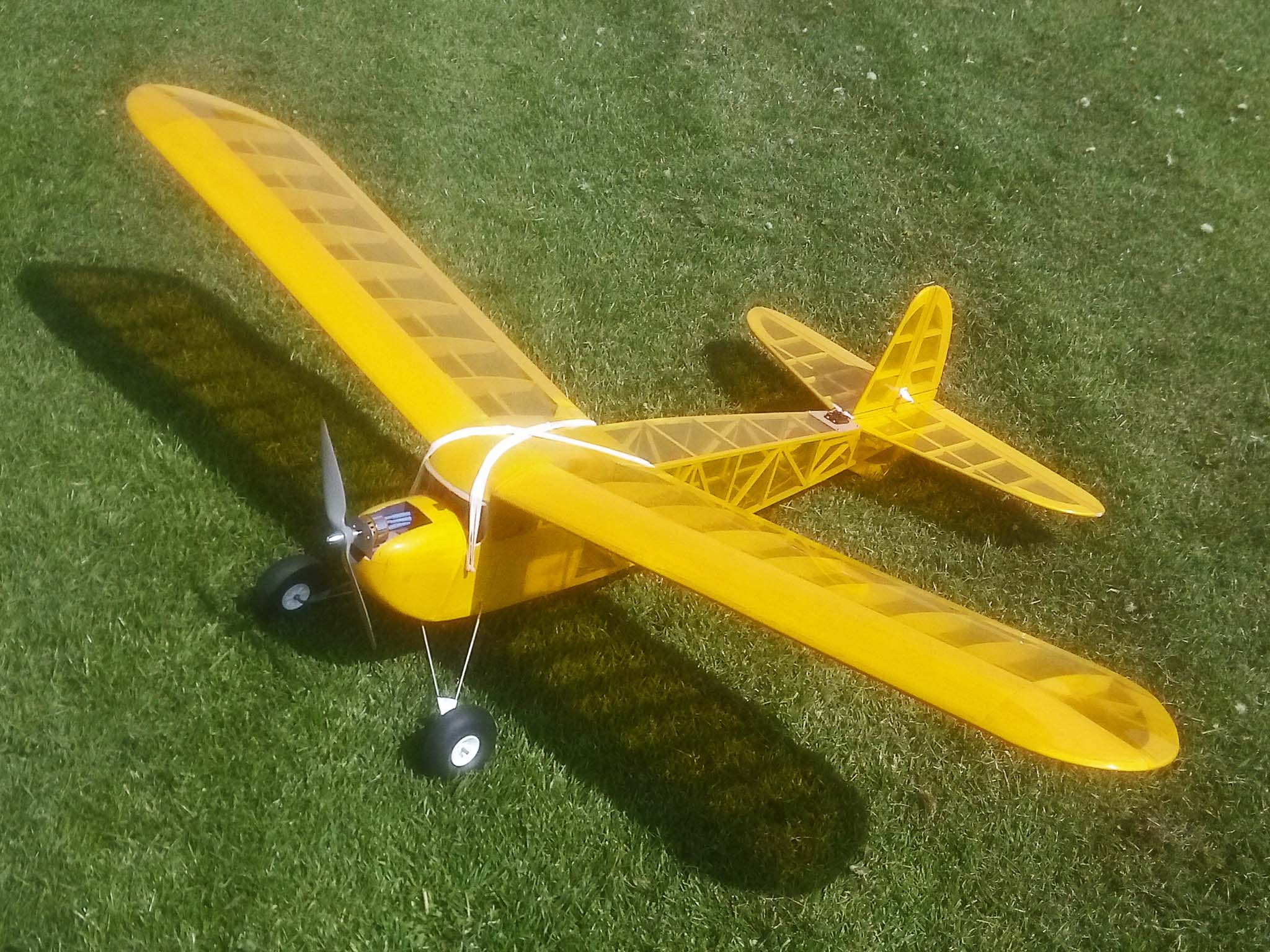

Heres my latest J60, bought at the Nats bring-&-buy and hurriedly fitted out for Ponty. I made a sheet steel motor mount and its not good, getting noisy vibrations & drumming with anything over half throttle. Needs a proper firewall fitting but it'll do for Ponty next week! Note the wing held on by joined bands....

I don't see why it should vibrate above 1/2 throttle...... Have you checked the balance of the prop?

Shaft may also be bent. If prop balancing off the motor fails to cure it, try moving the prop round in 60° steps relative to the shaft, looking for improvement each time.

The moving around trick works well for IC motors especially single cylinder spark ignition ones.
I doubt it would be effective on electric motors though.
You would see any bend in the shaft by looking at the prop driver / Hub...
