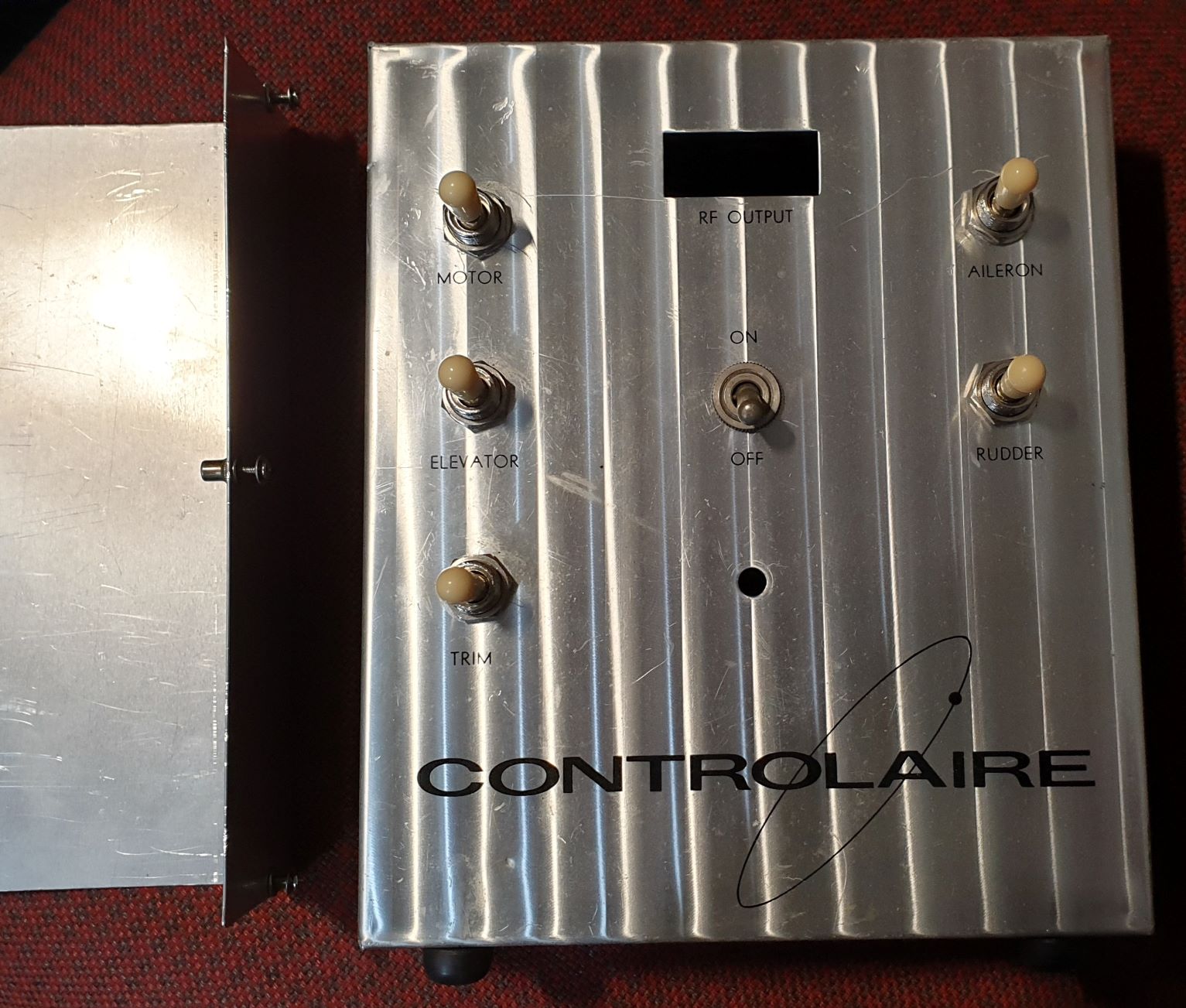

When the case arrived in the mail, upon actual physical examination (rather than examination of the pictures Dave had posted on the forum) I believe it fair to say that Dave was "polite" when he described the damage. I don't think it was just dropped or maybe sat on, rather it had been walked on or some other horrible mistreatment visited upon it :cry: . It has also at some dark stage in it's life, been attacked with needle-nose pliers :x .Regardless, a strategy eventually surfaced in the grey matter to re-birth the Tx and eventually return it to service.

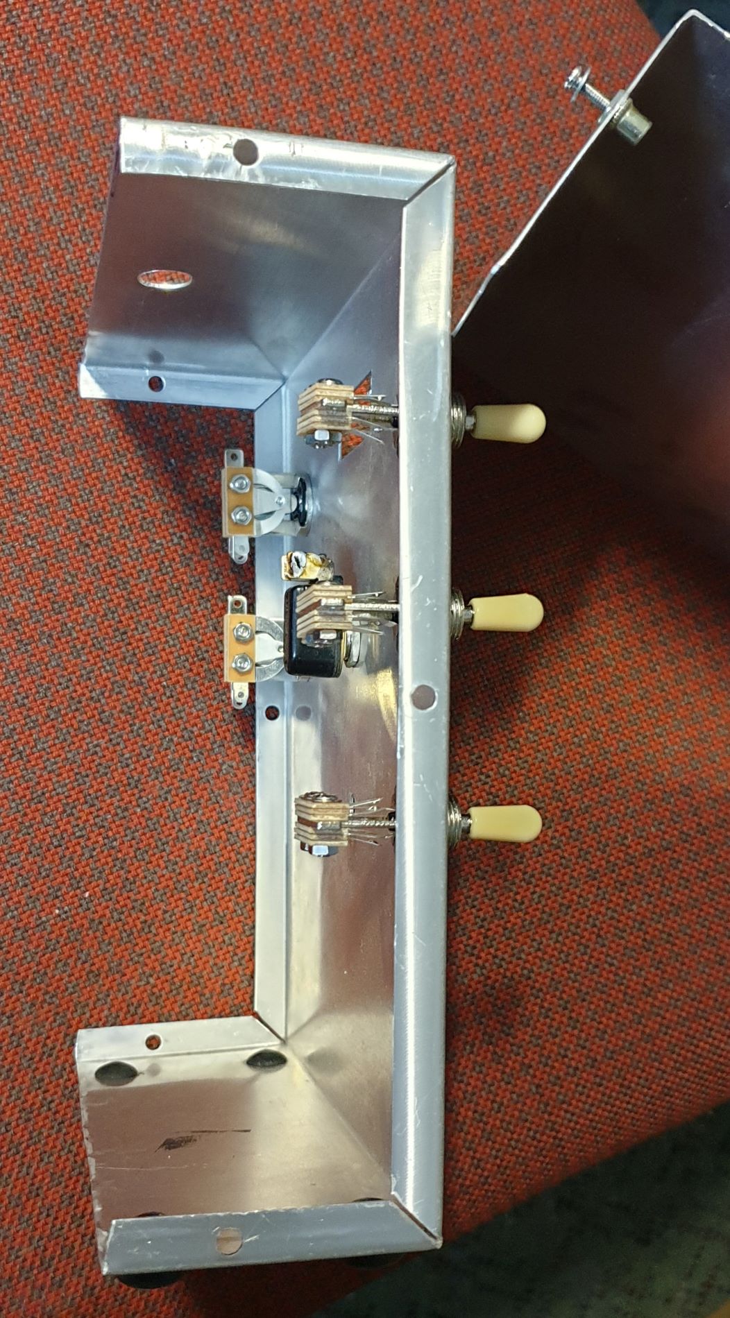

All the panel beating work has been done to the front half of the case. I reduced the depth of the Tx by about 1cm which had a double benefit:
  • 1) it removed the most damaged part of the case front &
  • 2) most importantly, it then enabled me to then use the A4 size sheet of aluminium I had to bend up a case back, which I fitted blind rivets to rather than rely on self-tappers into the soft ali.
I've modified some guitar switches and fitted them and the original power switch to the case.

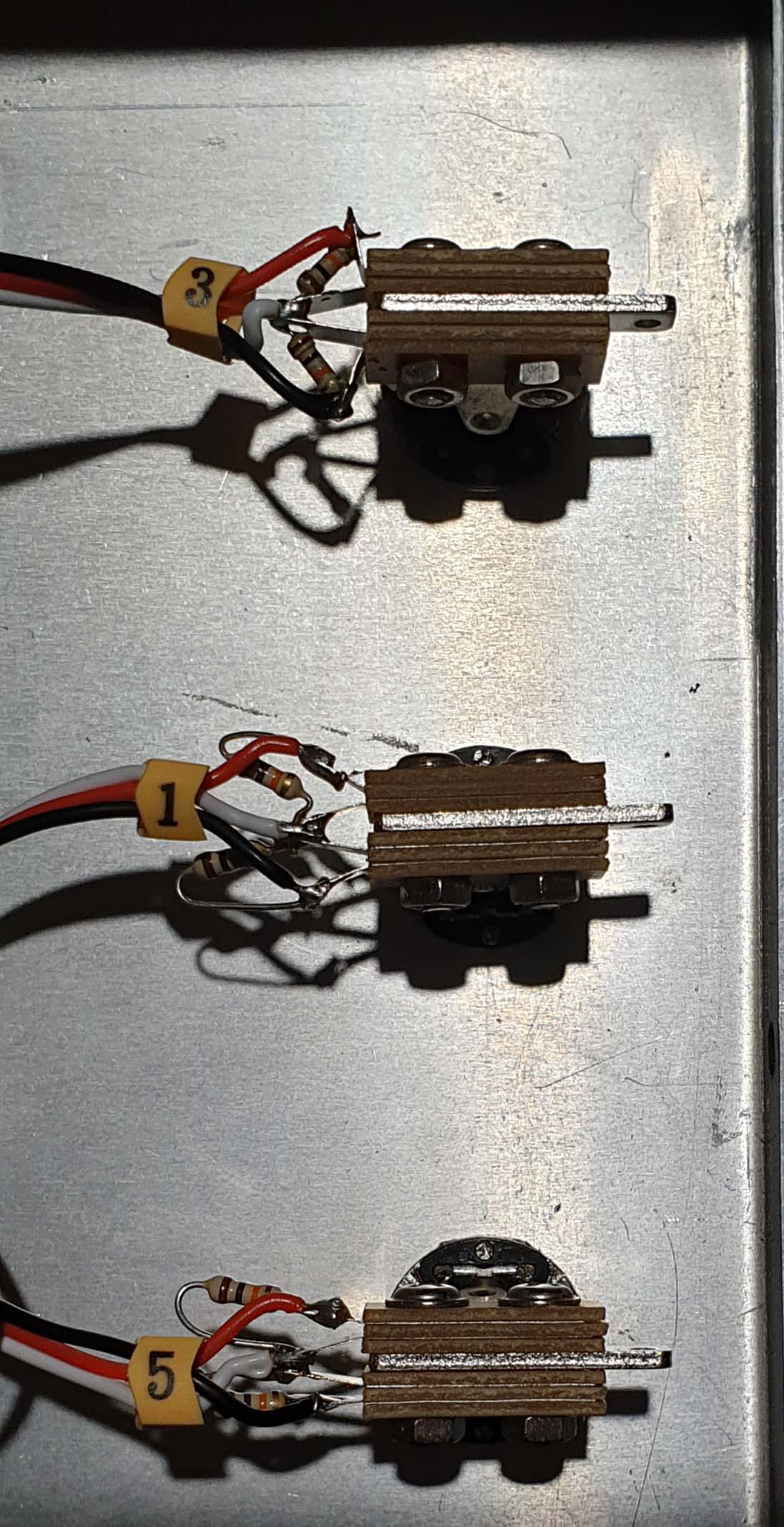

the scratches around the reed switches are from being attacked with needle-nose pliers by an owner prior to Dave. To paraphrase Carl, I now see them as adding to the patina.....
I have both a Reeduino and Reedy 10 encoder ready to go, but I'm still undecided as to which to use. Seeing as the original is a 12ch and I can utilise the original meter to remain "true to form" I'm leaning towards the Reeduino. But (there's always a but :oops: ) the Reedy 10 with OLED display would match the Mule conversion. Regardless of which encoder I settle on, the Controlaire will have both 36MHz and 2.4Ghz RF, switchable just like I did in the Mule.

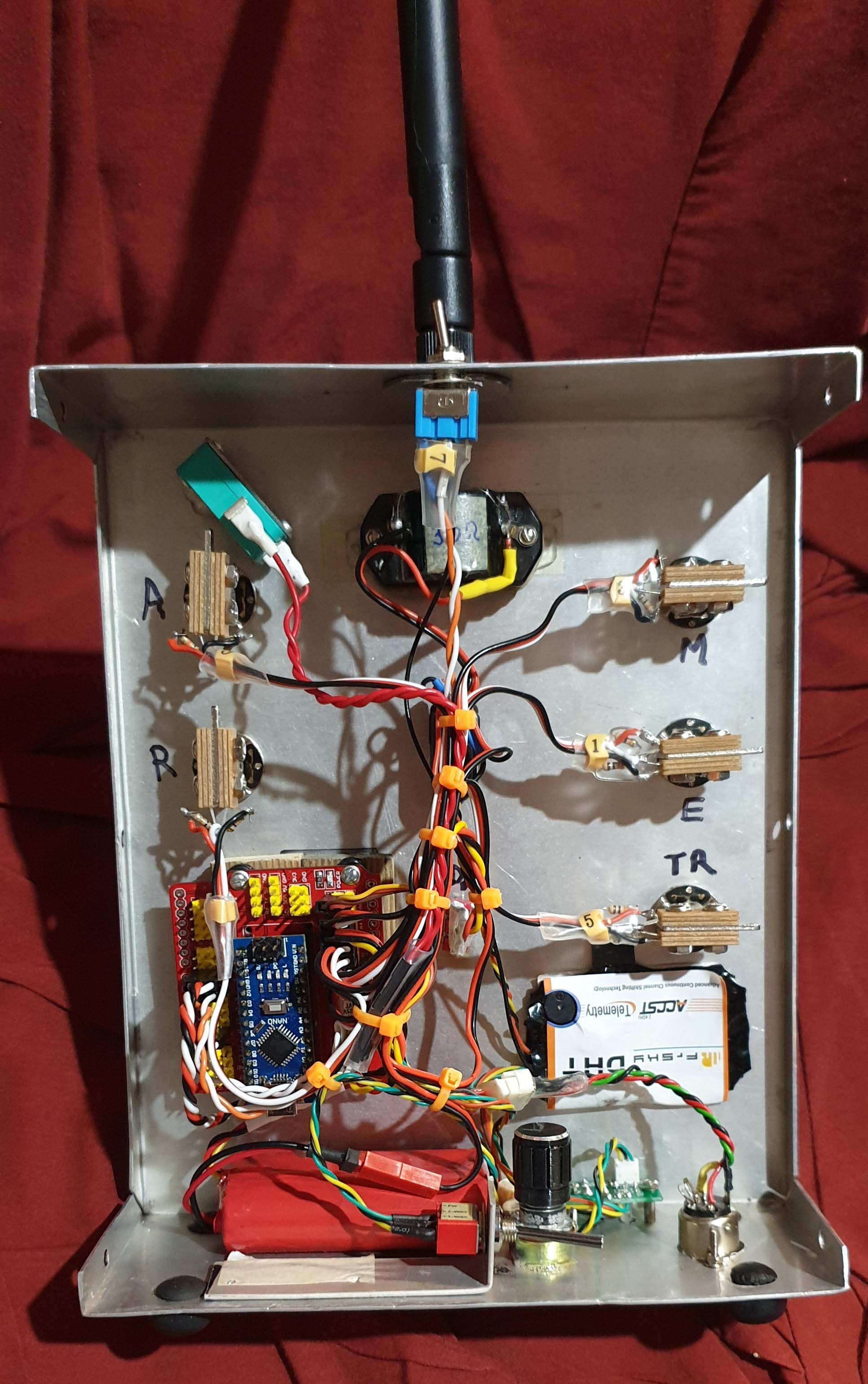

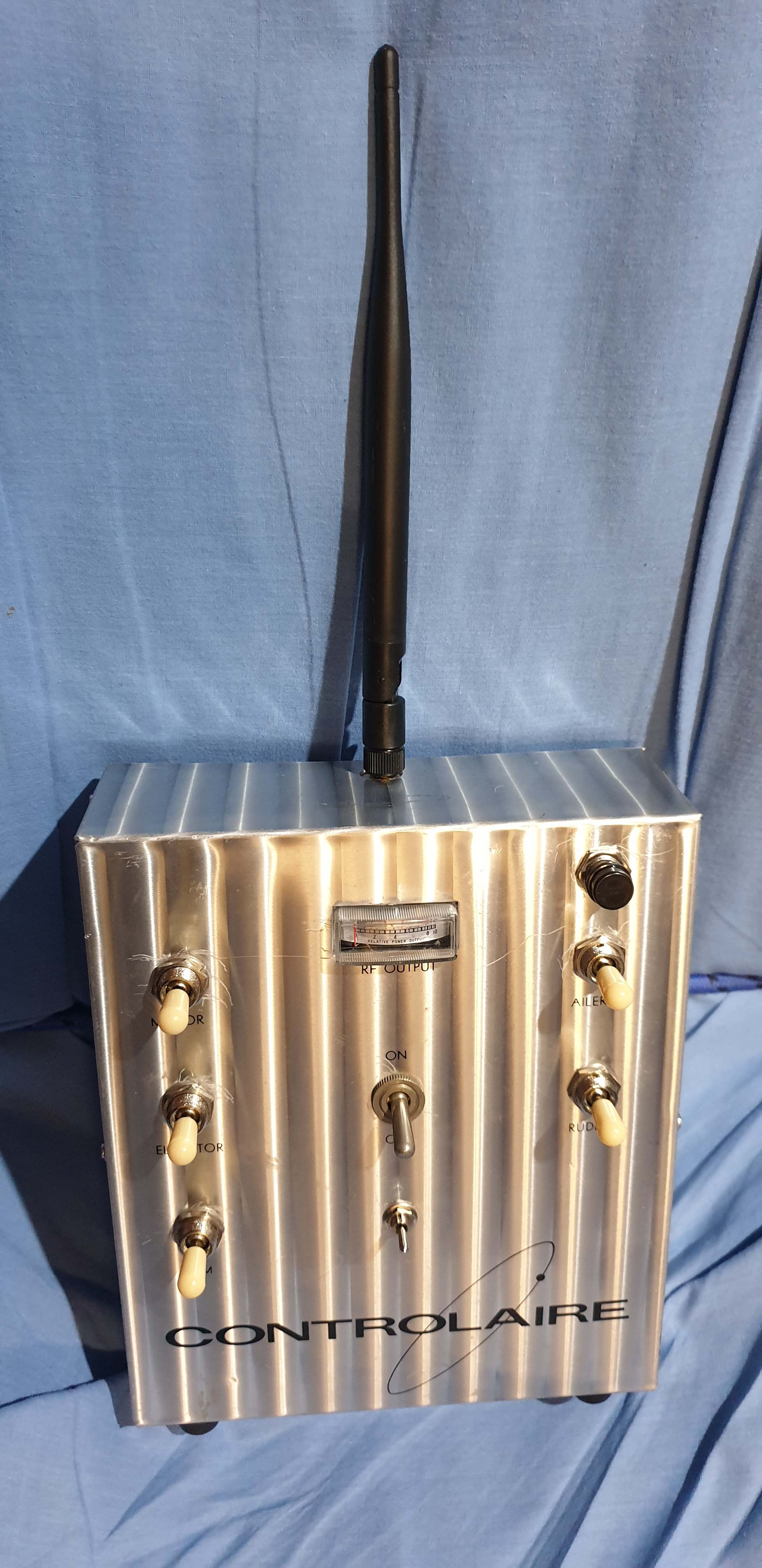

While I was on a roll after finishing the MAN 2-3-2.4 tx, I decided to get some more work done on the Controlaire reed tx.
After several work sessions in fits 'n starts, I finished the job today:
  • All the leaf switches wired up
each switch was labelled with it's Arduino pin number
  • encoder board mounted on a timber stand off
  • Frsky DHT diy module installed. Rather than use the supplied short antenna, I opted for a longer, higher gain antenna, not because I needed the higher radiated signal strength but because the longer version looks better installed on the (relatively) large tx case
  • mounted the bind board on the case bottom. It's recessed so the button can't be bumped inadvertently

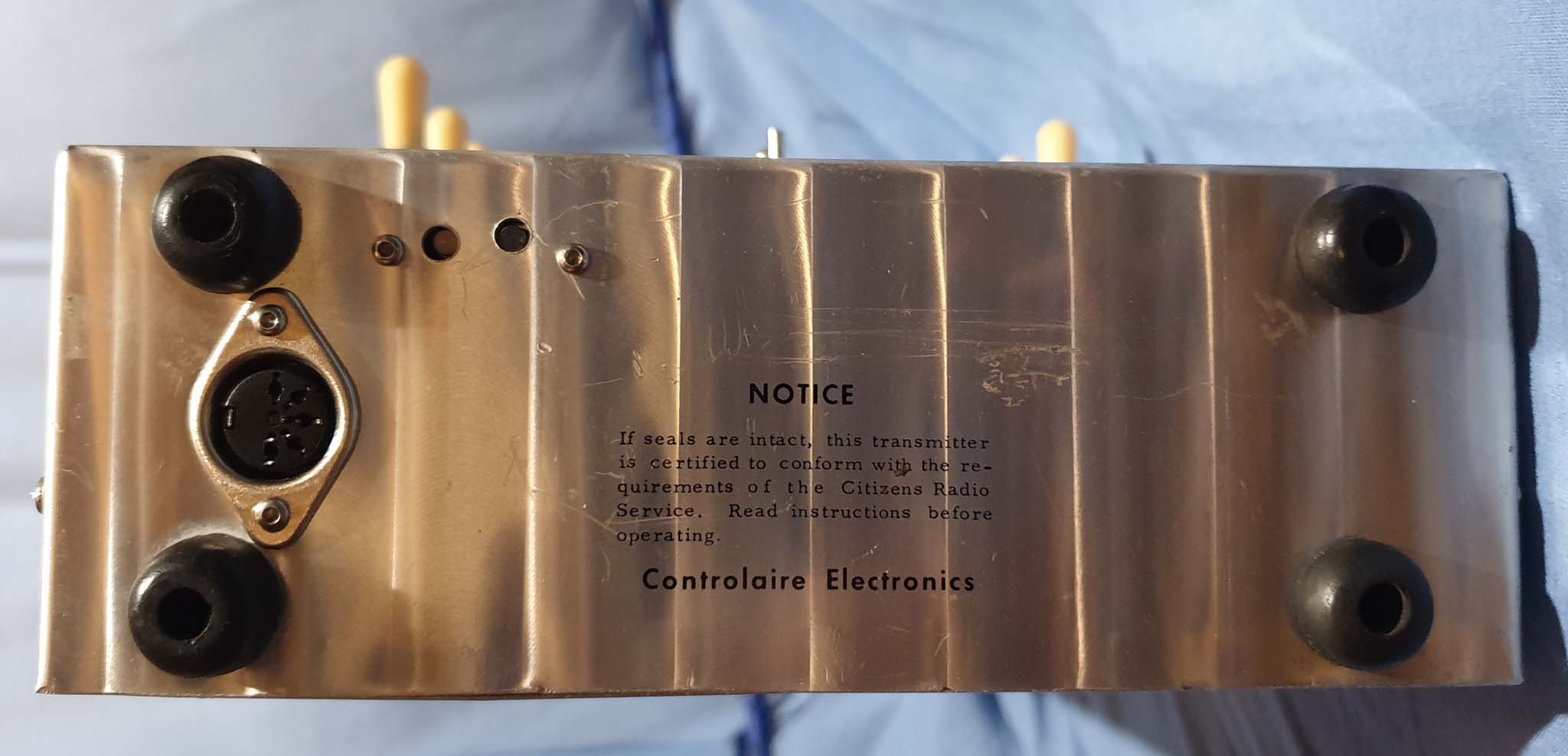

Bind board access & DIN charge receptacle
  • mounted a DIN socket on the case bottom for charging the Tx battery.
  • added a switch for the V-tail mixer, discretely hidden behind the antenna
  • added another switch for the auxiliary channel, utilising an existing hole on the case front
  • installed the S/C button
  • removed the 36Mhz RF board & antenna. I may reinstall it at some later date.
  • Bound the Tx to an old 8 ch. Frsky Rx

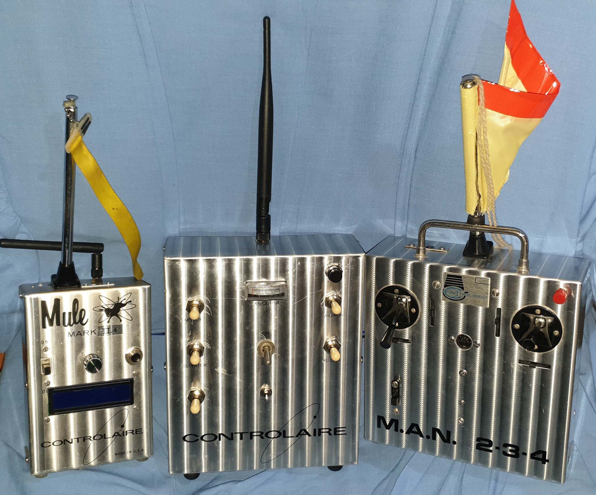

It works!! Most chuffed 'cause that is the Shiny Boxes trio finished :D
The Shiny Box Trio
The Shiny Box Trio
