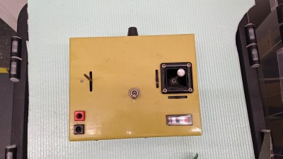

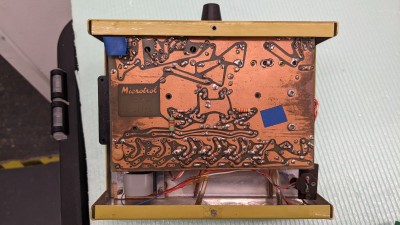

I've been tidying the workshop up last night and found this. Rather than trying to make a new pcb, would you like this instead? It's obviously very home made, but it's a Microtrol.

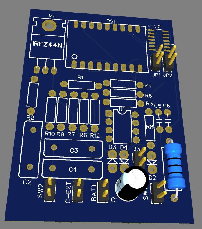

........And yet another pcb ordered today.
Took maybe 3 hours designing from scratch and getting it all correct in EasyEda.
These days I don't even think about getting the etchant out of the cupboard...and why would one.
5 boards at a discount price currently for Aus $3.12....add another Aud$2.24 for postage (maybe take 2 weeks) and 78c for Paypal.
Now of the 5 boards, I panelized the design to get 2 out of each panel, so 10 pcb's in all.
Cheap as chips, and professional finish as well. I could never get within a mile of what they produce.
Anyone need some etchant...only bought 2 litres of the stuff 2 or 3 years ago. (free to a good home...Ferric Chloride)

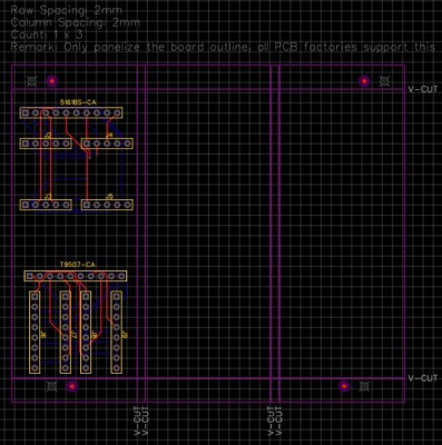

Did a quick design with two different boards in the one "border"......could get the EasyEda to cut it out with Vee cuts as a complete board and then have 3 columns of the same per pcb (then x 5) but it would not go beyond that to make a vee cut between the two designs.Flynn wrote: 27 Sep 2023, 08:28 (and I can't find a way of doing it without the router trying to fit the two designs together)
Not a real problem as one can make a simple vee cutter from tool steel with a handle and use a steel rule as a guide to make ones own cut.
Assuming one has allowed sufficient spacing to do so, as I did in the design below.

Whenever I try to add a circuit design to an existing circuit the autorouter treats the nets with the same name as the same net ( not unreasonably I guess) so all the Gnd and Vcc and suchlike get routed together, your example does not have common nets, just individual ones. If you manually route the design you end up with multiple problems in the DRC (again, not unreasonably) and so could well have show stopping errors that JLCPCB would reject the design for.

Nope...did a design check and all came up good to go.
