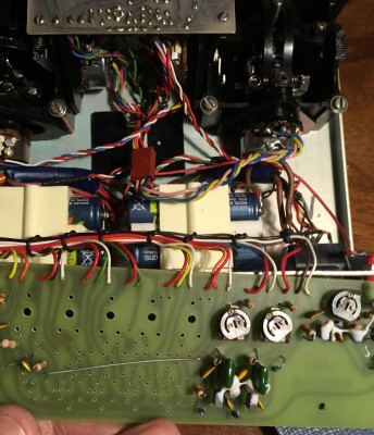

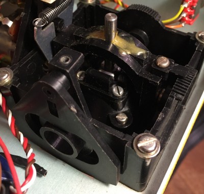

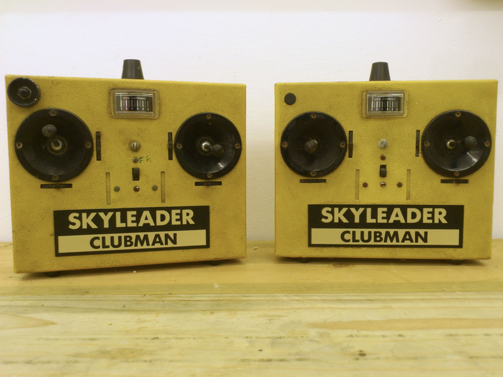

Well I have just bought another transmitter from our dear friend EBay! This time a lovely Skyleader Clubman Super. It was pretty clean but A bit more scrubbing and it’s come up lovely. As soon as I opened the box I had a twiddle of the sticks as you do. I noticed immediately that they were stuck on one axis. Now usually this usually signifies bad internal corrosion, however opening the back it’s beautifully clean but the stick units have been glued up and pots removed so they only operate on one axis each. The right-hand stick left and right and the left hand stick up and down. I fully expected to see it made off as if it had been done by a previous owner but now I’m completely confused because the encoder board only has two channels and the receiver a blanked off section for the remaining channels - In Other words two channel only. It’s a late date version of the club man super with an FM 35 MHz board. I want to run this at least four channel so I’m going to have to add one of Phil's encoder boards or Rob another encoder board from something else less desirable ! Has anyone seen the like before? :? Jonathan
Re: Skyleader ODDITY!
Postby Mike_K » Mon Dec 04, 2017 6:26 pm

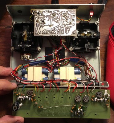

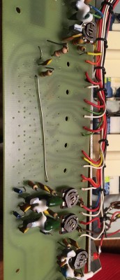

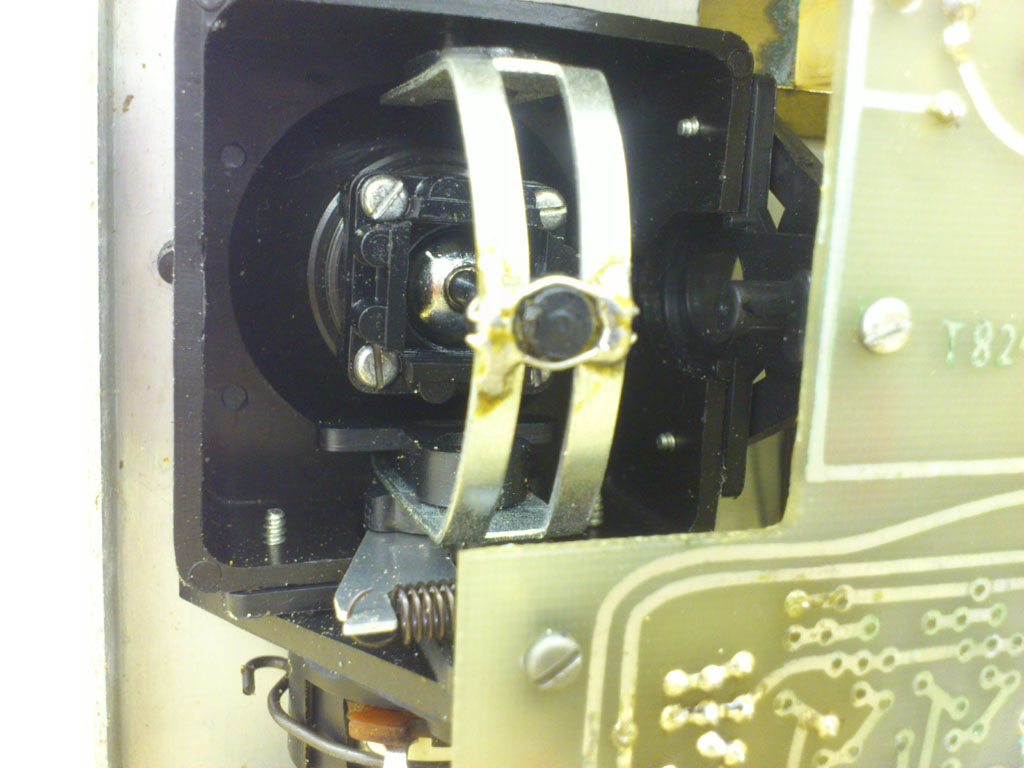

Hi Jonathan. I don't think it is an oddity at all, you've bought yourself a Skyleader 2 channel set and it is how it came out of the factory. I've got a 2 channel Skyleader CS AM set in my collection and it's Tx encoder board is similarly only populated with components for 2 channels, the joysticks have been glued into the centre and no pots were fitted for the unused channels. Oh and the trims have been cut off flush for the unused channels. What confirms you have a 2 channel set is that the RX is 2 channels as well. Skyleader made a big thing about buying 2, 3 or 4 channel sets and being able to upgrade them to 7 channels, but in practice most people bought 4 channel sets unless they flew gliders. But sets only used for gliders tend to be cleaner than those covered in glow fuel.
Without new joysticks I think you'll struggle to modify it to 4 channels or more. Maybe somebody on the forum has some spare Skyleader joysticks? If not you often see Fleet Custom 2 FM sets (the black ones) and they use Skyleader (SRC) sticks. They come up on eBay far more frequently and are usually cheaper than Skyleader CS sets too. The other advantage of using Fleet sticks is that the Skyleader CS sticks had really strong centring springs, that make them feel really heavy if you normally fly with more modern sets. The Fleet sets used the same weaker springs that the Skyleader TSX used. I fly with a 2.4GHz converted Skyleader SLX as my everyday transmitter and I quickly fitted some spare TSX springs that made a big difference. I also shortened the sticks by about 15mm in length, to make them similar in length to a modern set such as a Spektrum, Futaba or JR.

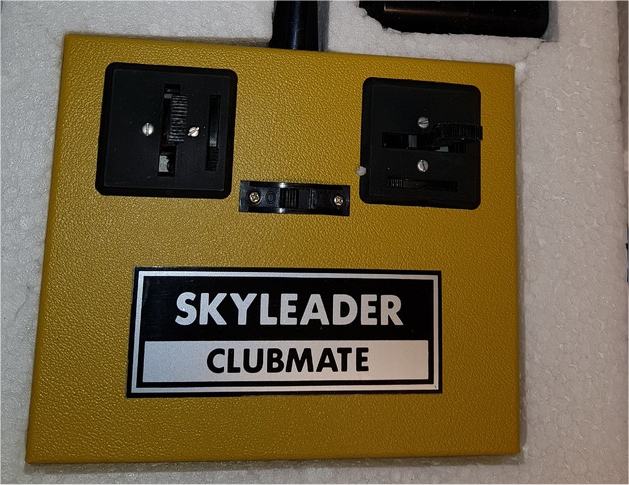

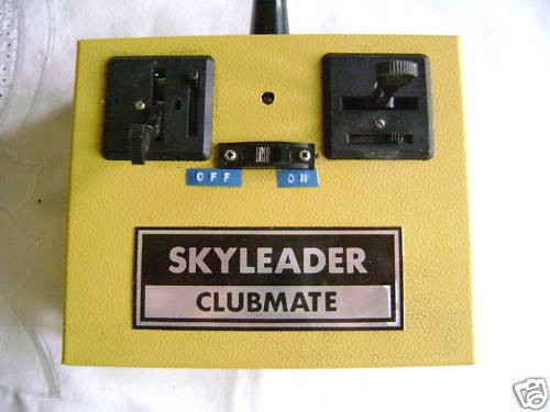

Postby Phil_G » Mon Dec 04, 2017 7:59 pm
As well as the Clubman they also did a 'Clubmate' which was a 2ch budget set using those horrid single axis sticks that look like they're stamped from 3mm sheet:

Postby Mike_K » Mon Dec 04, 2017 11:42 pm
Beside the 2 channel CS, I also have a 2 channel Clubman with the Kraft Hayes joysticks (the one on the right in the photo). Rather than gluing the joysticks in the centre, they soldered them up with wire to the metal yokes! They didn't bother to fit a buddy box switch or circuitry either, it was a definite budget model.
The most unusual/oddity Skyleader I have is the blue cased 3 channel 3S and no it isn't a 3 cell lipo before you ask! It was sold in two versions, one with a throttle but no rudder (AET) and one for slope soarers with AER, but no throttle, which is what I have. The "throttle" is wired up and soldered into the centre in the same was as on the Clubman.
I think the Clubmate was the lowest quality set Skyleader ever made. Phil is 100% correct when he says that the sticks felt like they were made from sheets of cheap 3mm plastic. Did anybody actually fly with the Clubmate? I never saw anybody flying with a one, but saw them being used in boats and cars. I now have two complete sets but have never bothered to try to get either of them working.

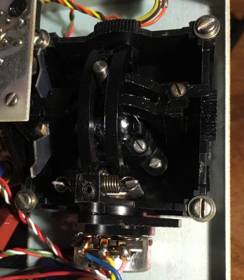

Thank you thats MOST interesting! Mike you are right on the money Its a set out of a glider and flown twin stick. I just couldnt see the economics of making a two channel set in a 4 channel box.
I have already converted it to the full dual axis sticks - Right again Mike I used surplus Fleet spares and noticed along the way the softer springs - Another tick Mike!
It now has the smoothest sticks of all three of my Skyleader outfits. :geek:
I have a spare Futaba challenger encoder board but its near impossible to fit into the Skyleader case. So i am most likely to use Phil's 7 channel propo board which I already have in my possesion. All I need now from you guys is pointing in the right direction to find the right circuit diagram to hook it up. I am assuming Phil has already pre-programmed the board??

Phil thanks a lot will take a look shortly. The old Challenger encoder board is just too big I’ve had another look this eve. It will foil the stick gimbals. So it’s use your board (most likely) or appeal to anyone on here to sell me a Skyleader encoded board they have removed.

Here is photo of the completed sticks with Fleet bits added so I now have two dual axis joysticks

Jonathan. I've probably got enough spare components to populate your existing encoder board to 4 channels if you want to keep things as original as possible, but you would have to set up the timing for the half shots for the new channels.
I've also got an untested encoder board from a Skyleader TSX, taken out when I fitted one of my encoders a while back. It would fit straight in, but would need some re-wiring as it had the dreaded "black wire".
I've got a spare 7 channel Skyleader 35MHz FM Rx if you need, though you should find the other channels are in your Rx, except that the servo connectors are not fitted. I'd be a bit cautious of using old SRC-1 servos as some of mine have the output arms getting quite brittle.
