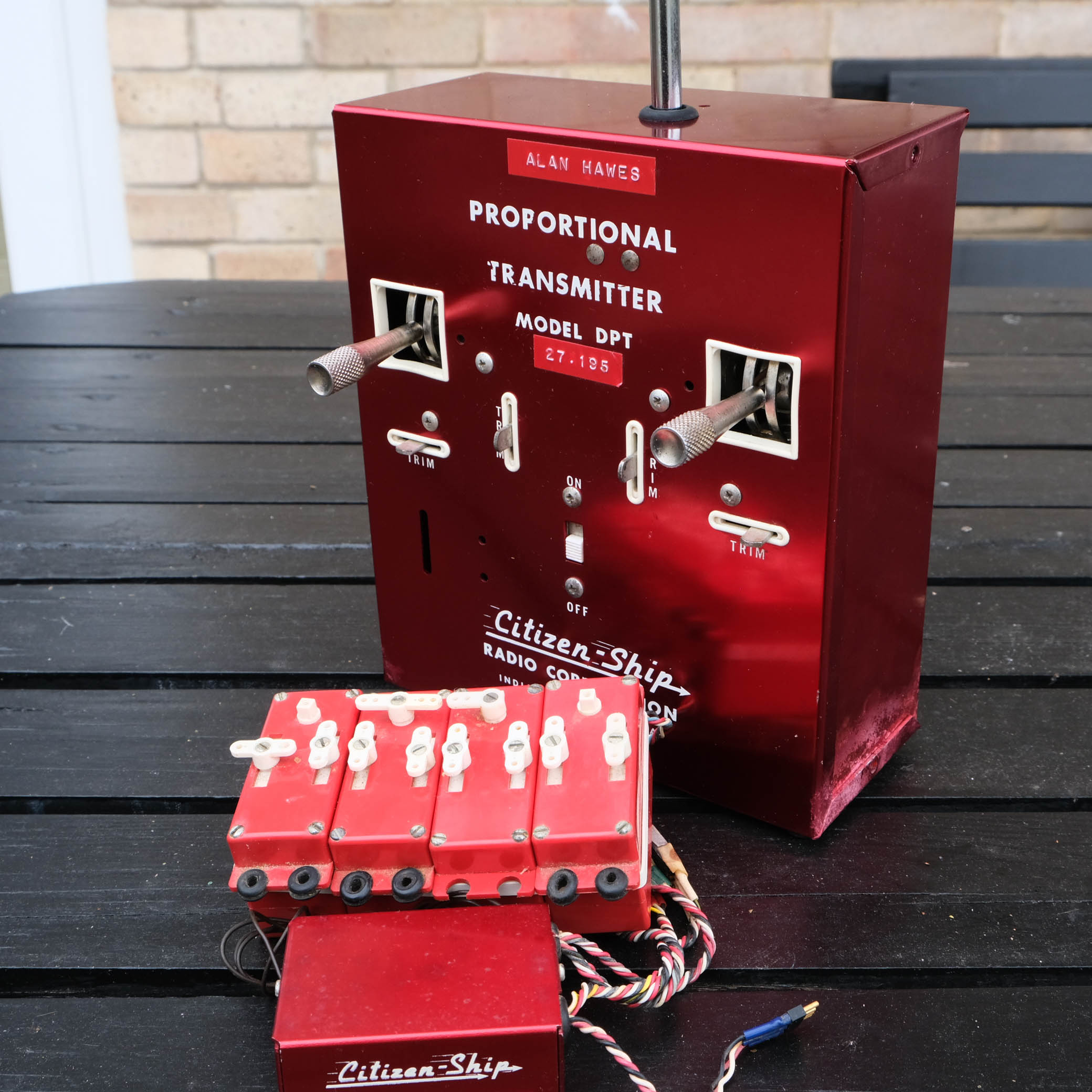

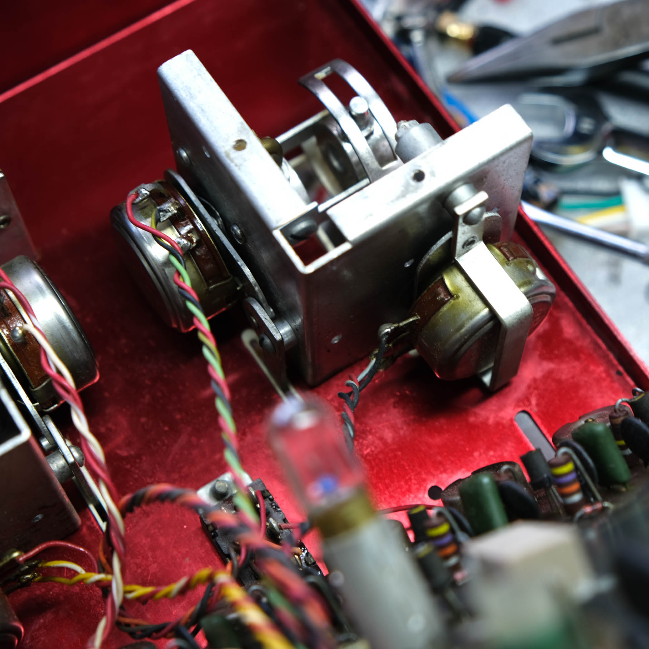

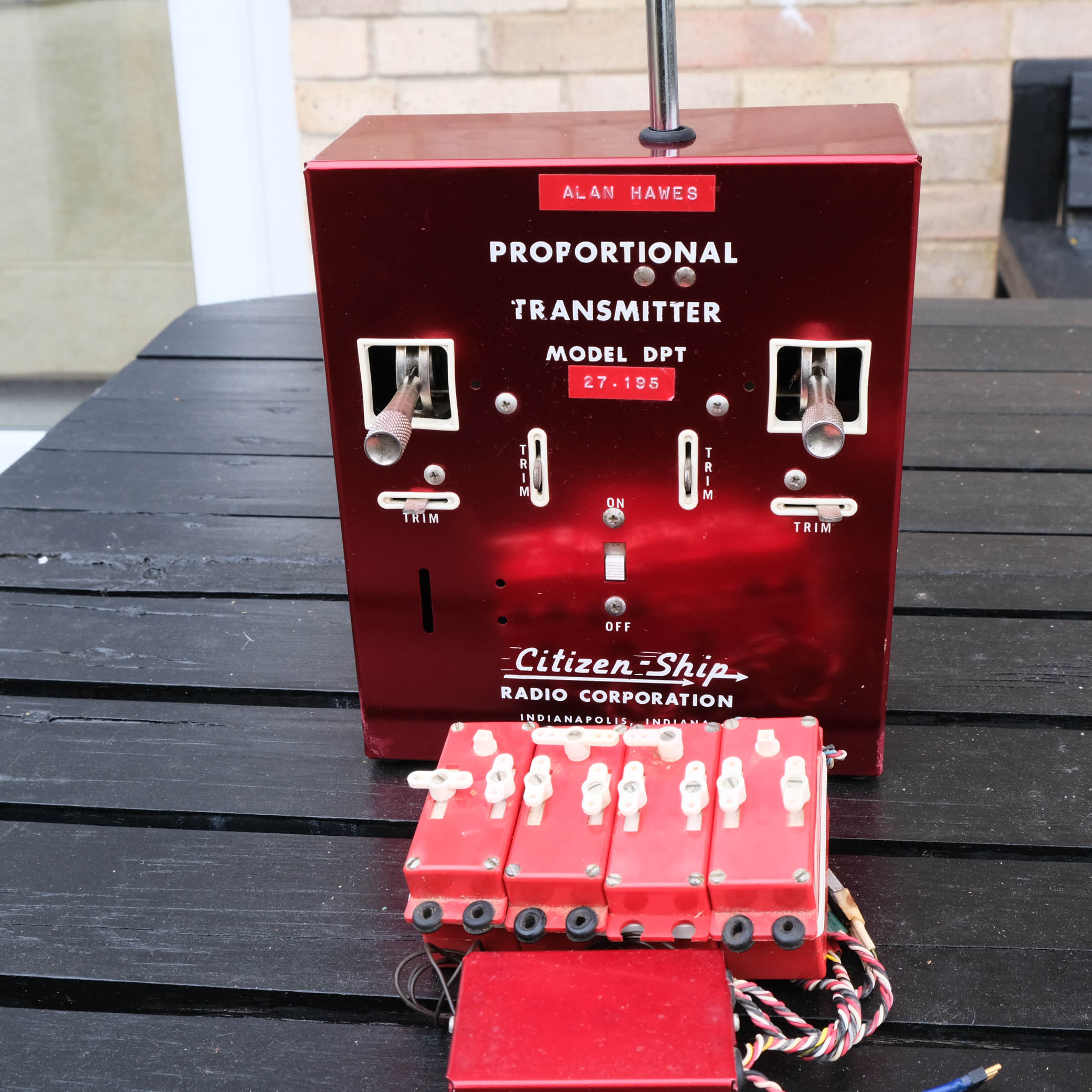

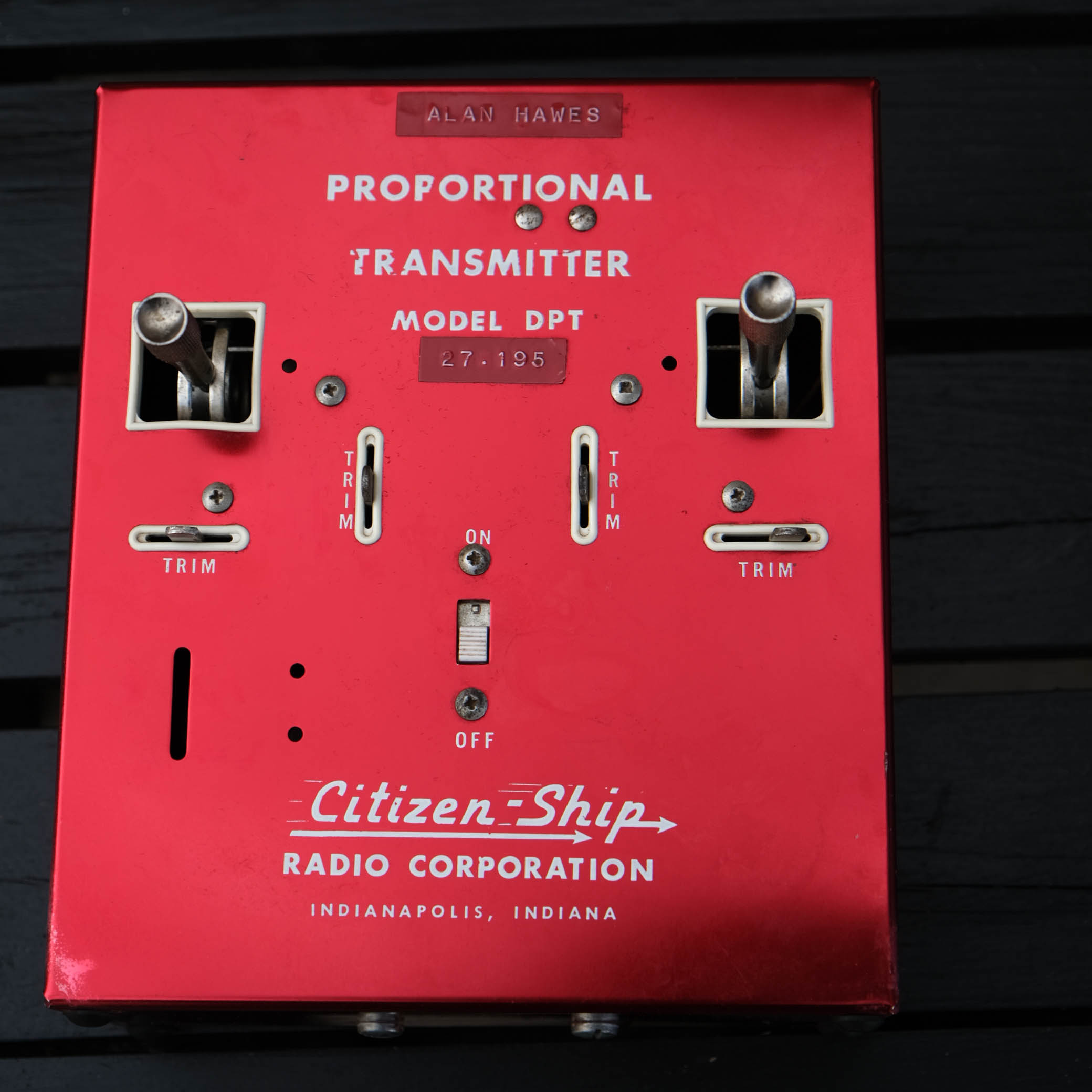

Thought I would share some pics with you of this mid sixties Citizen-Ship DPT 4 channel Digital Proportional that belonged to an old friend of mine, Alan Hawes of AH Designs (famous for their pilot figures)
I dont know too much about it's history, but know that Alan worked for a while in the States and presumably brought this back with him when He returned to Blighty.
There are two airborne packs with a total of ten servos.
Have spent an afternoon cleaning up the set and recharged the Tx Nicad which seems to be showing about 12V!

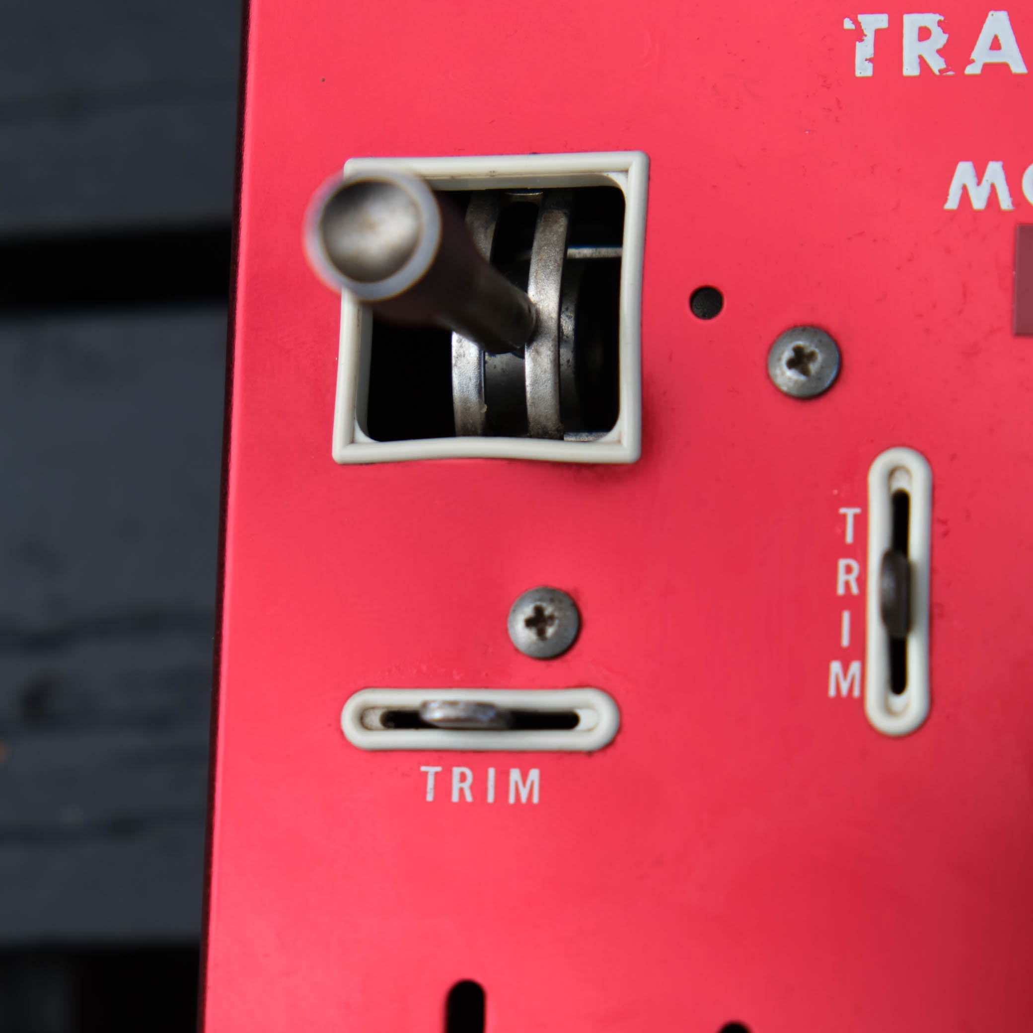

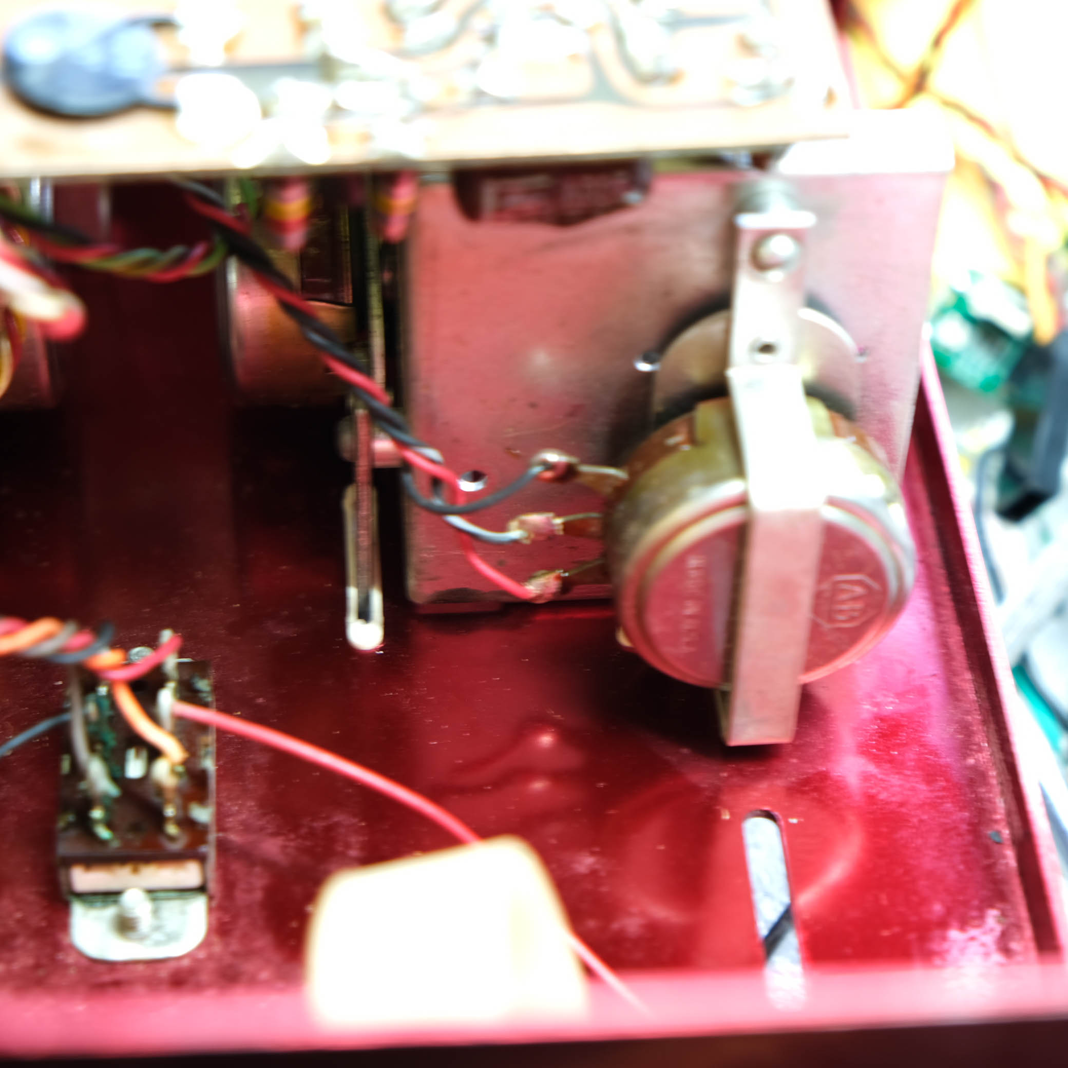

The Tx looks lovely in its anodised red finish (the Receiver also is anodised) and the sticks are wonderfully engineered open gimbal affairs with mechanical trims on the Allen-Bradley 5k pots.

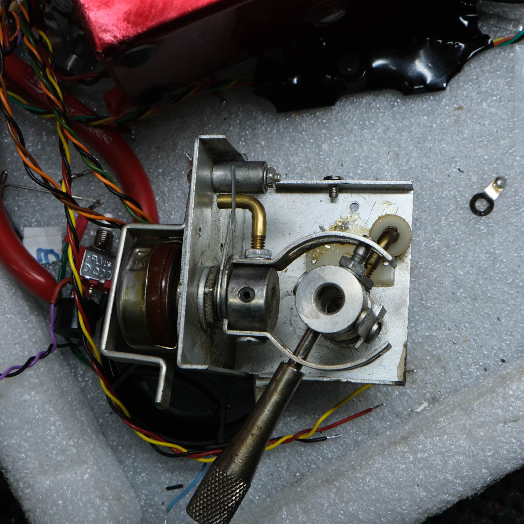

The throttle stick is interesting as it it has a rack and pinion to create friction (see pic below)
It is a 27Meg set.

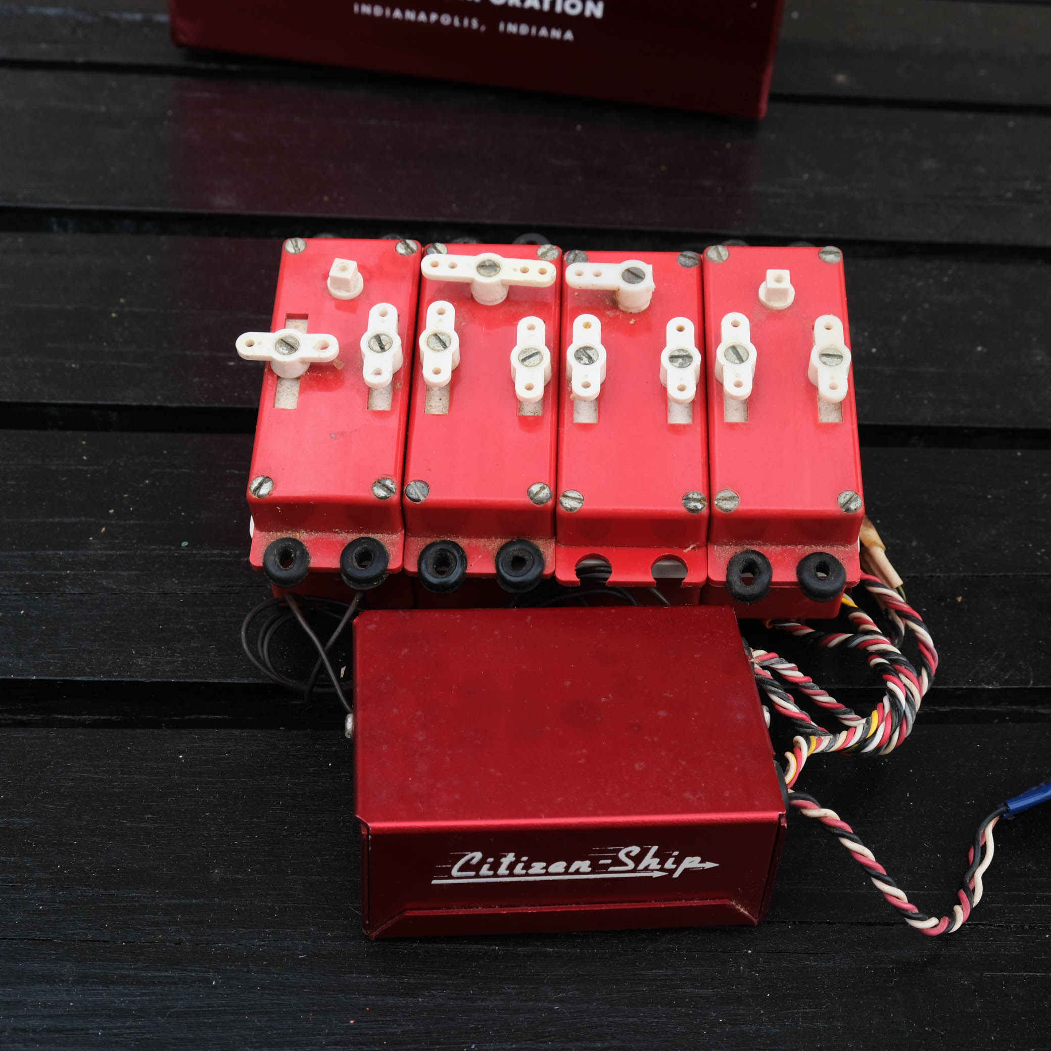

The servos are 5 wire plastic cased affairs with linear racks and rotary outputs which you can mix and match. Am unsure if these are Citizen-Ship own brand or from a third party?
If anyone has more technical details and info then please share if you have info as I know precious little about it!

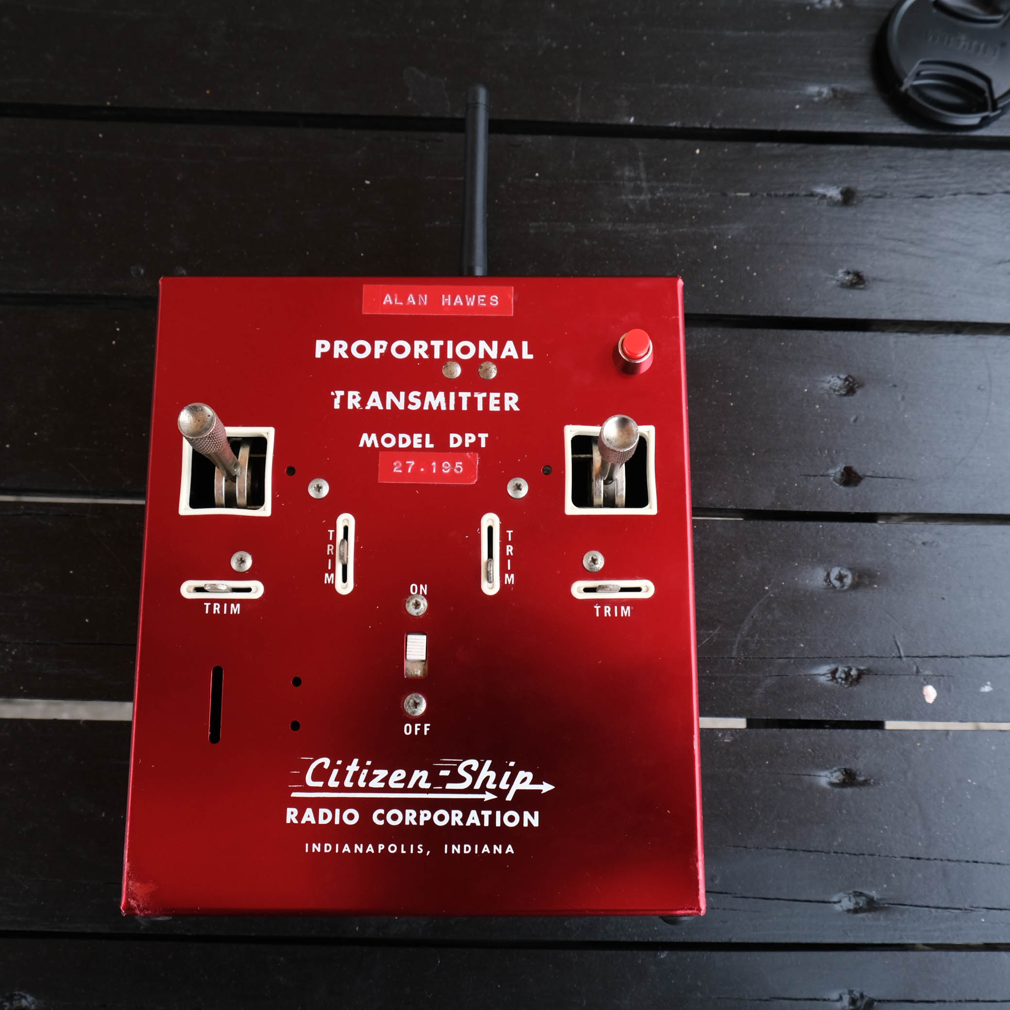

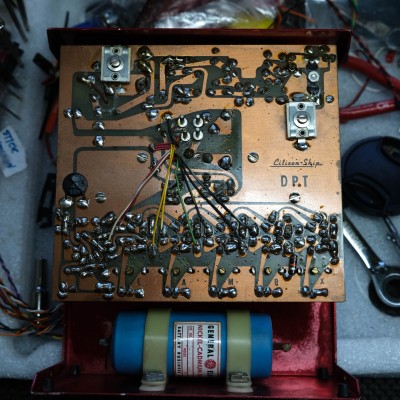

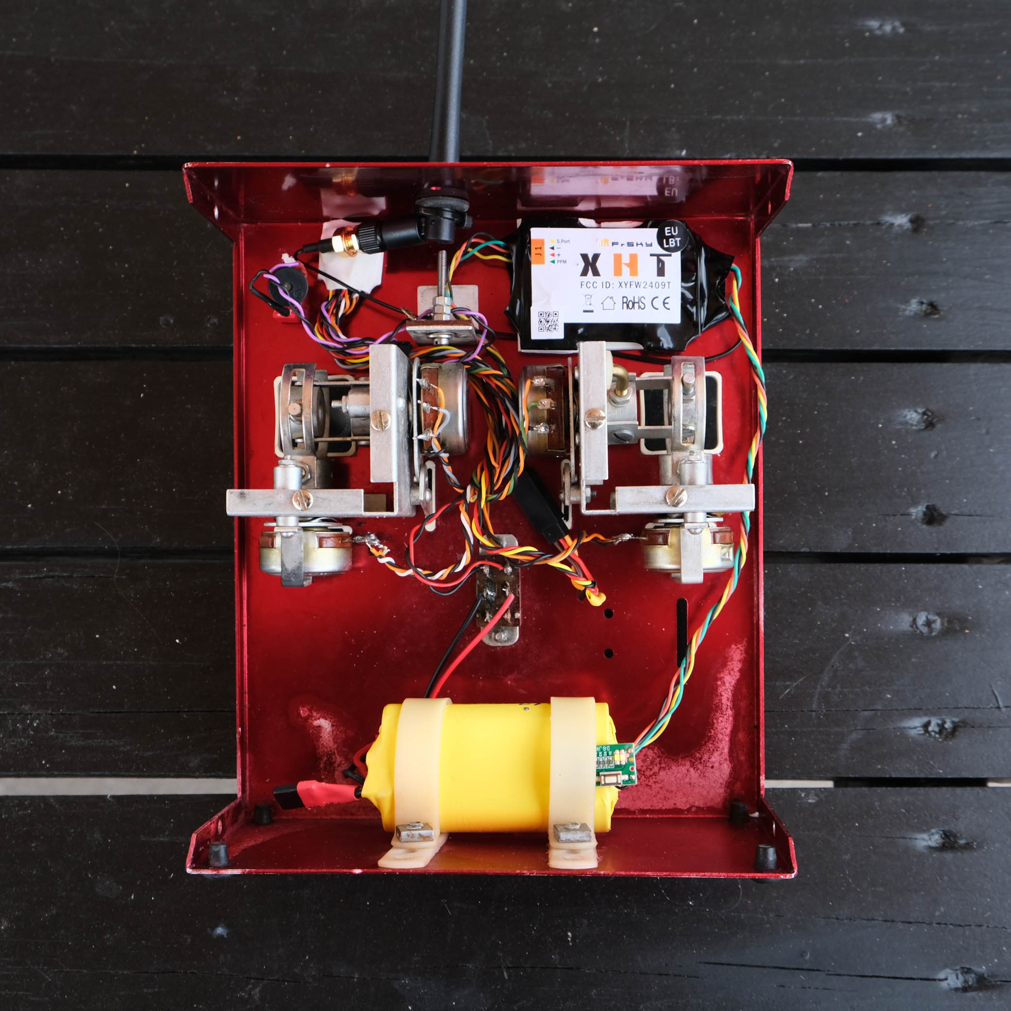

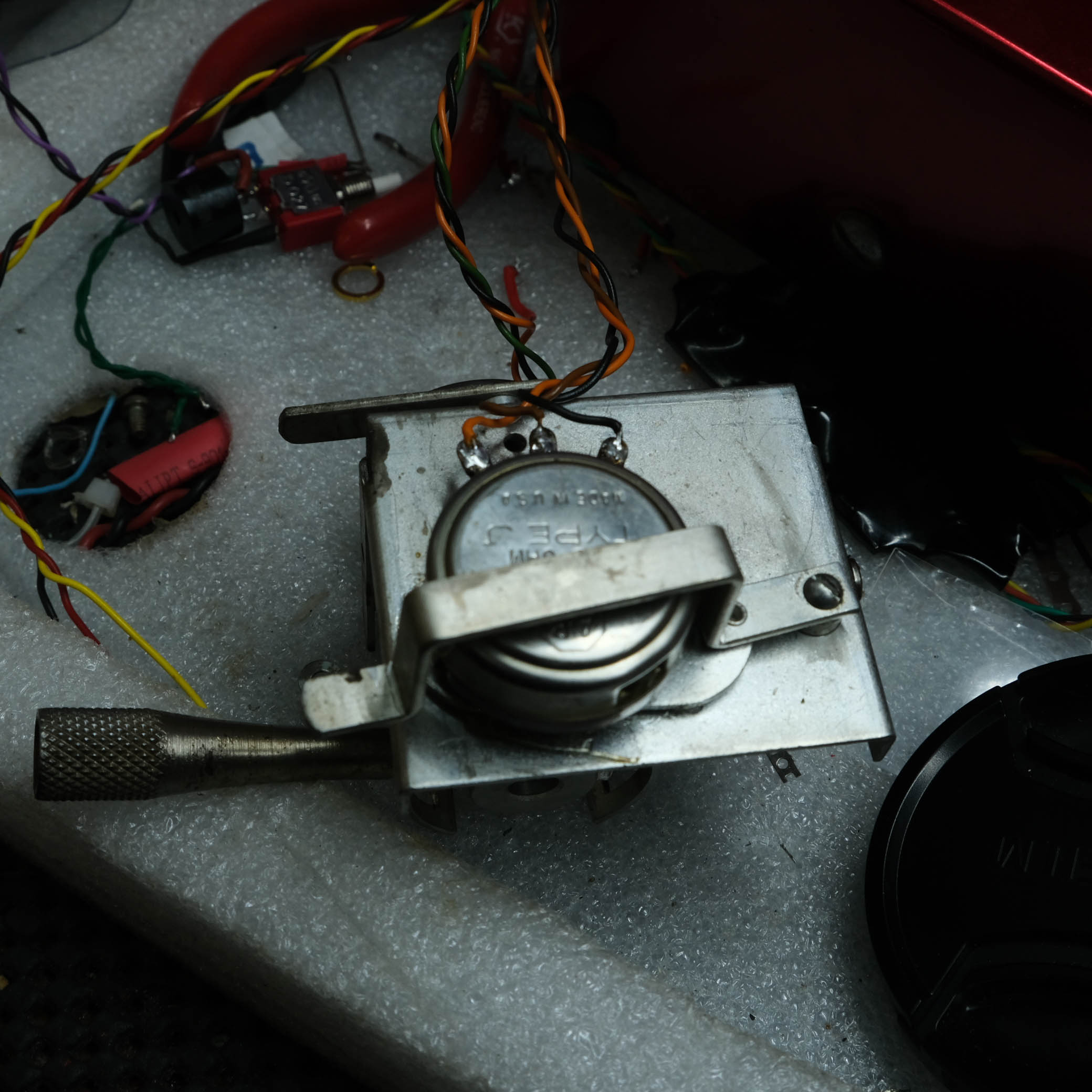

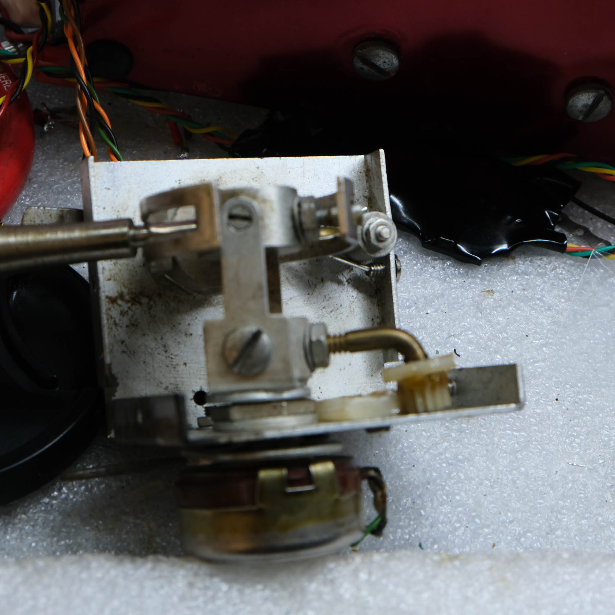

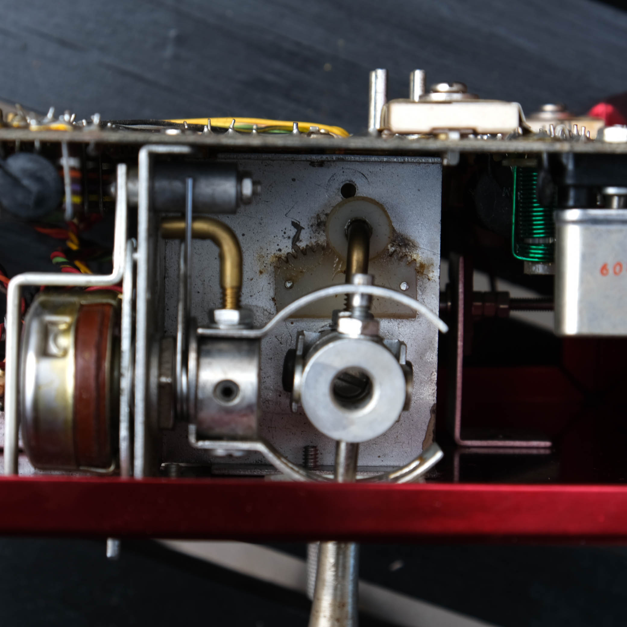

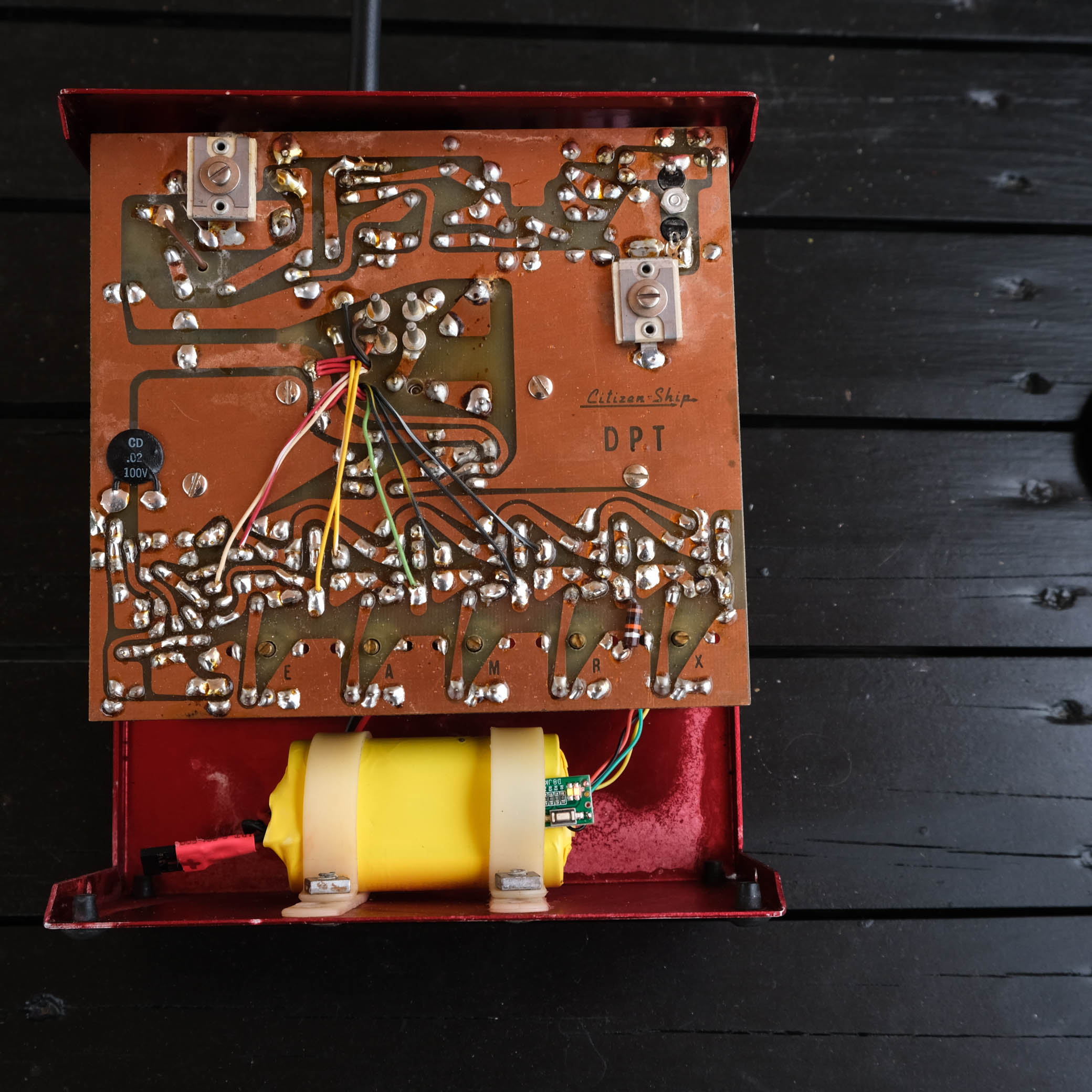

Evening Tobe, have just finished converting to 2.4 using Phil's 4 channel Digispark and one of the new FrSKY XHT modules. All works at first switch on which is really satisfying.

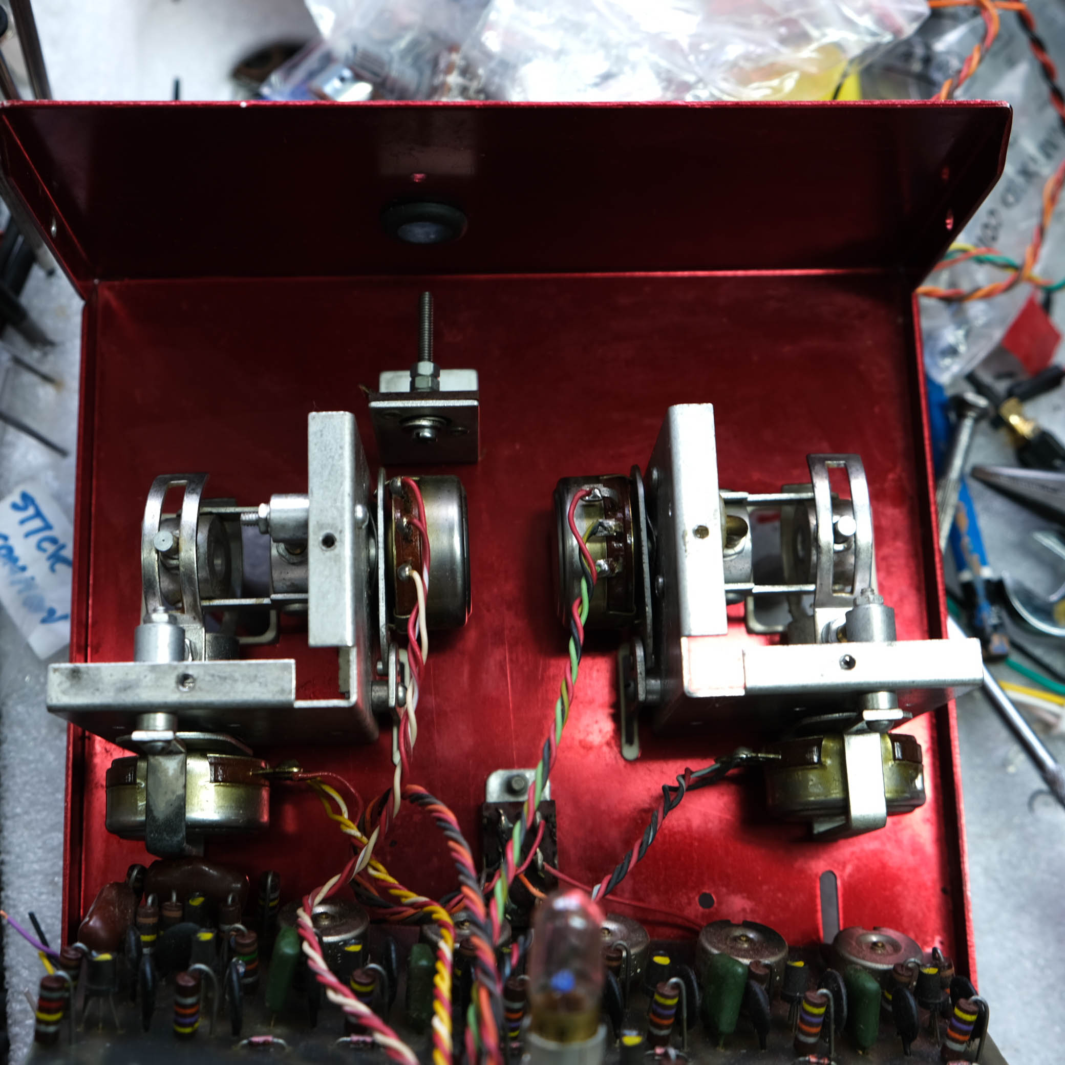

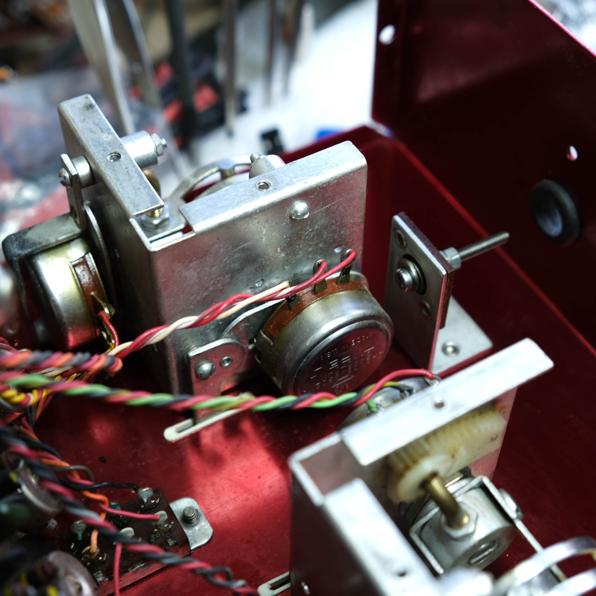

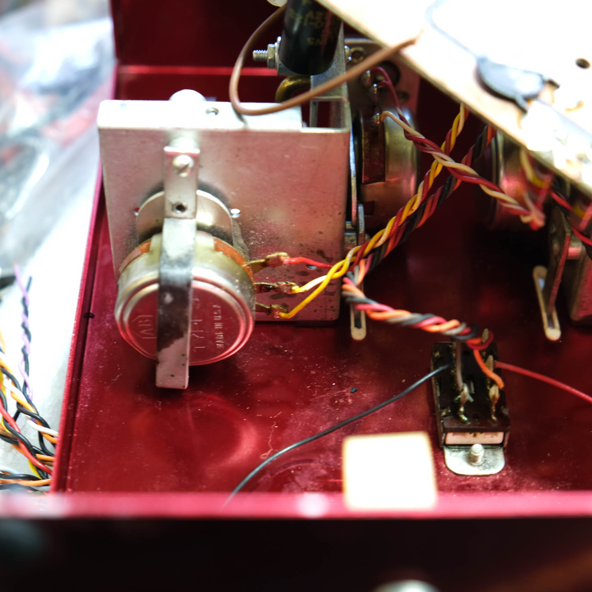

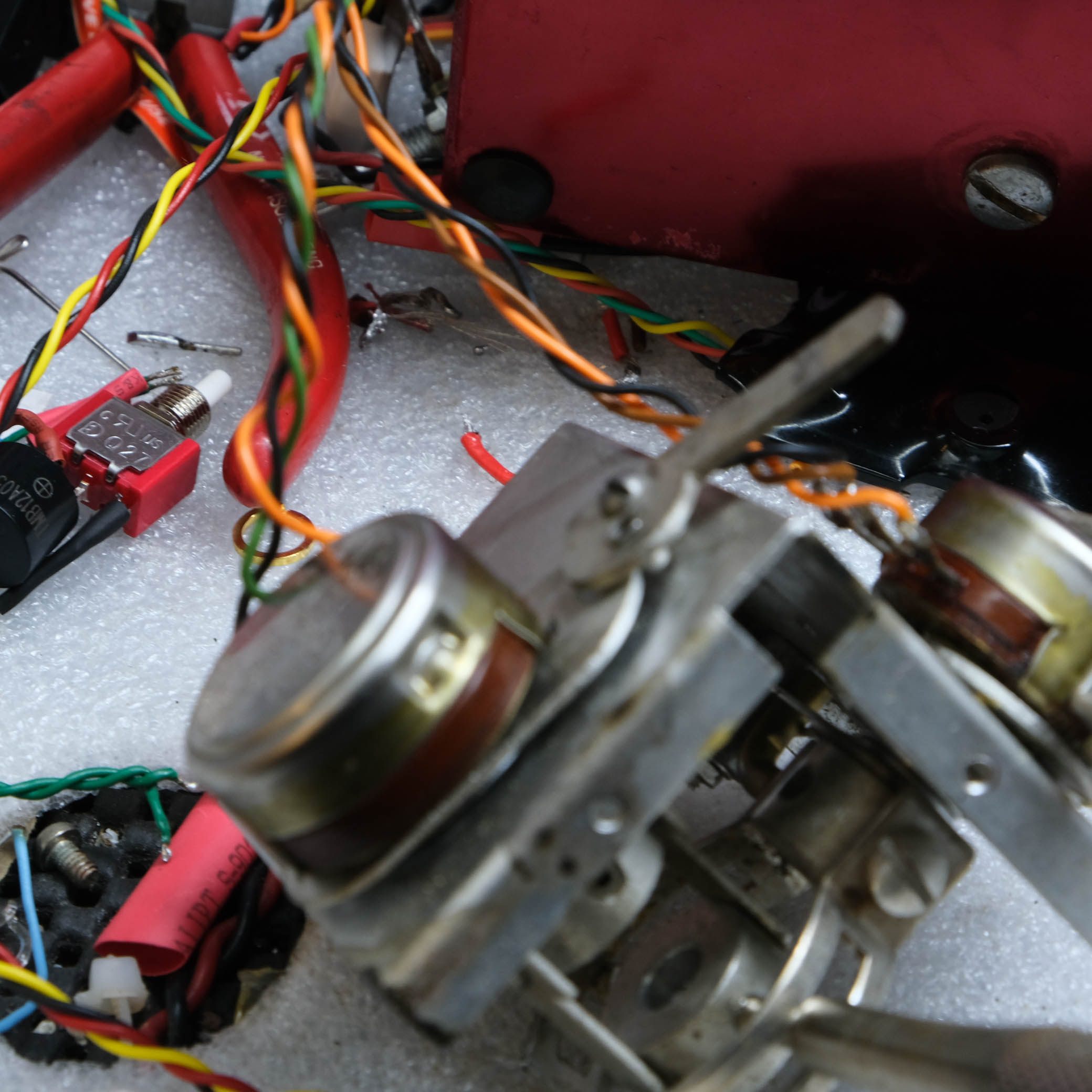

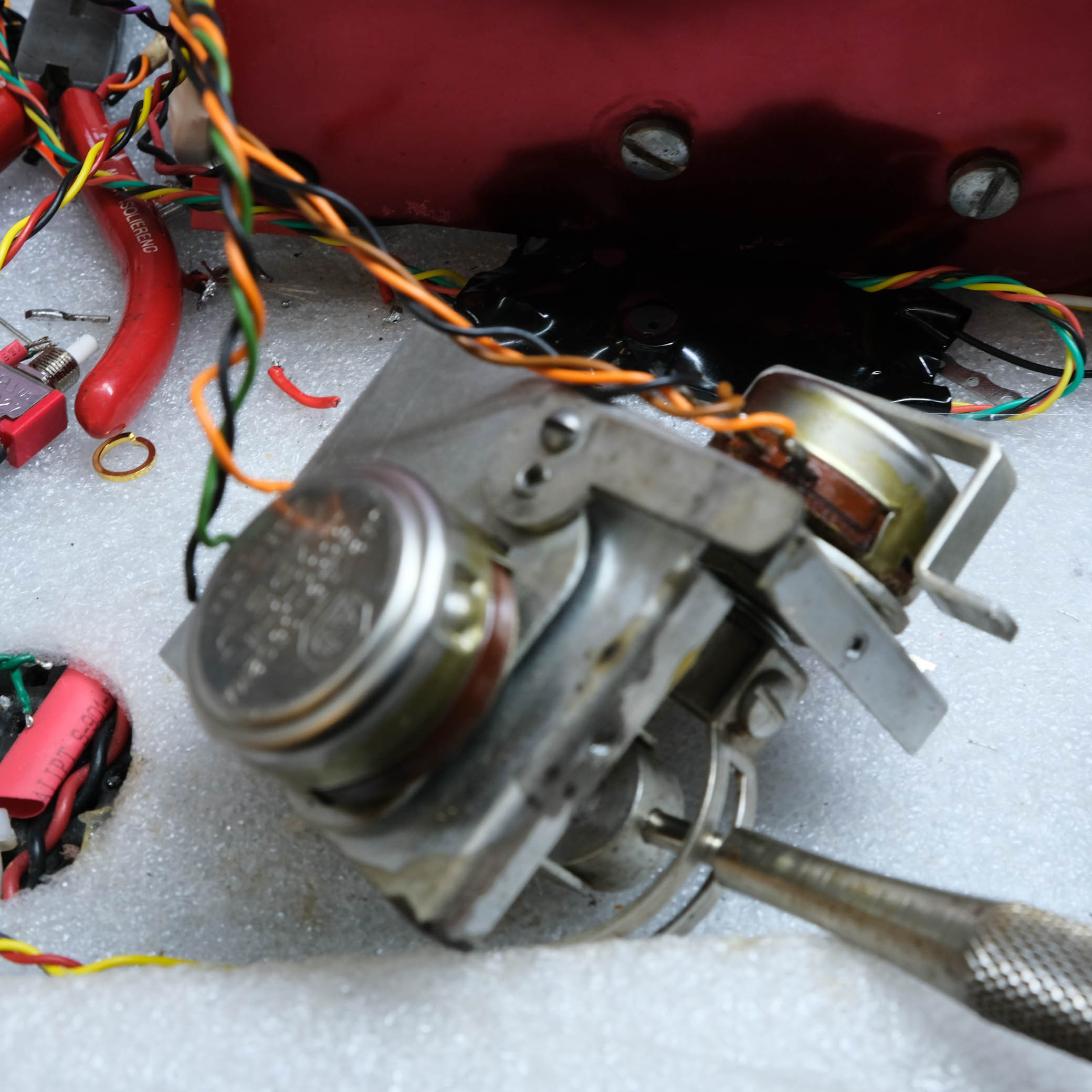

Whilst doing the conversion, I had the stick units out, I took some pics to show the mechanical and production engineering that has gone into their manufacture, are they Flight Link quality, well not far off in my opinion, and they have mechanical trim swinging the pots instead of electrical trims, so quite a complex mechanism!
Now the subjective bit, I havent measured the spring tension but the spring centring doesnt feel overly strong, clearly not as soft as modern sticks, but they have a solid feel to them and the servo resolution seems smooth in operation.

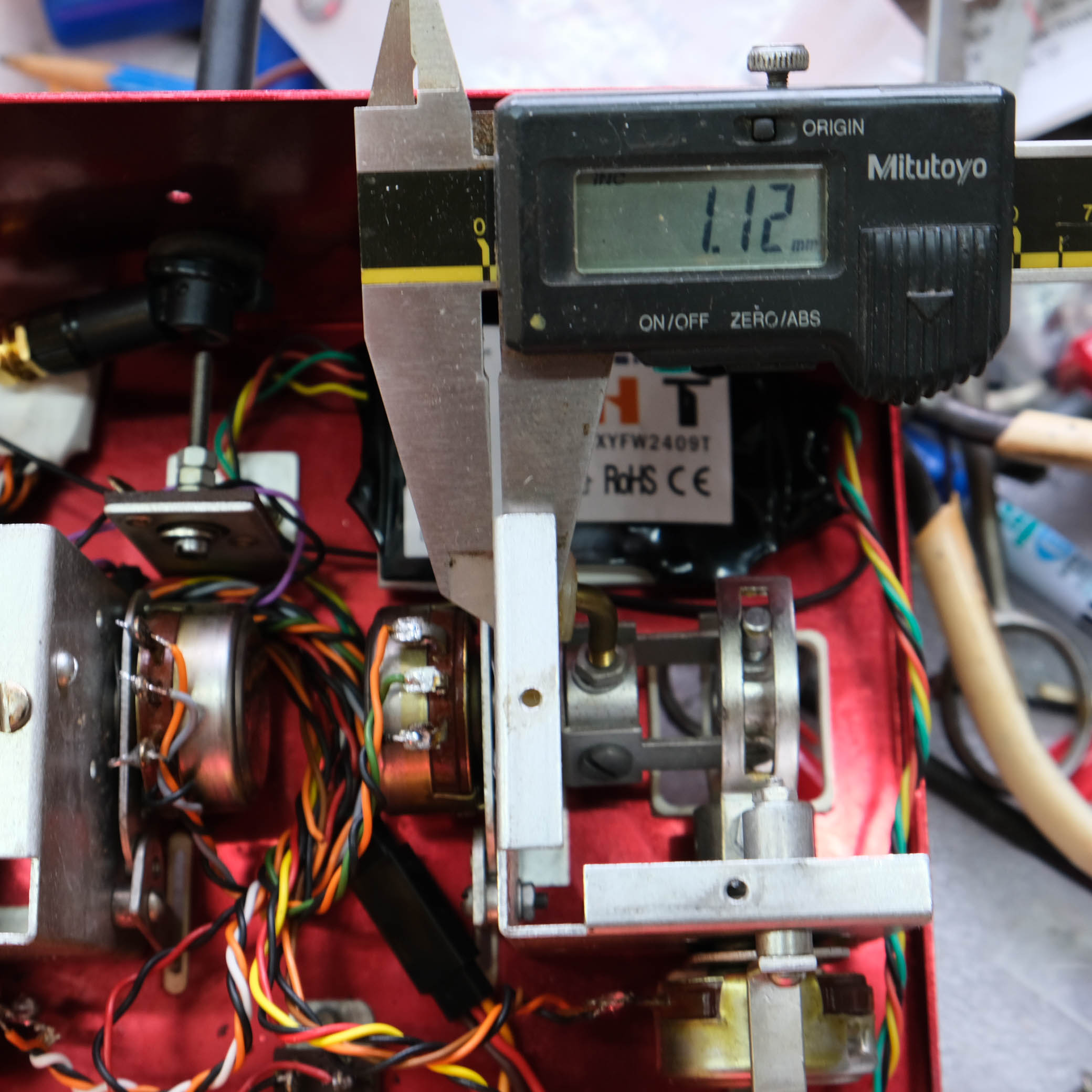

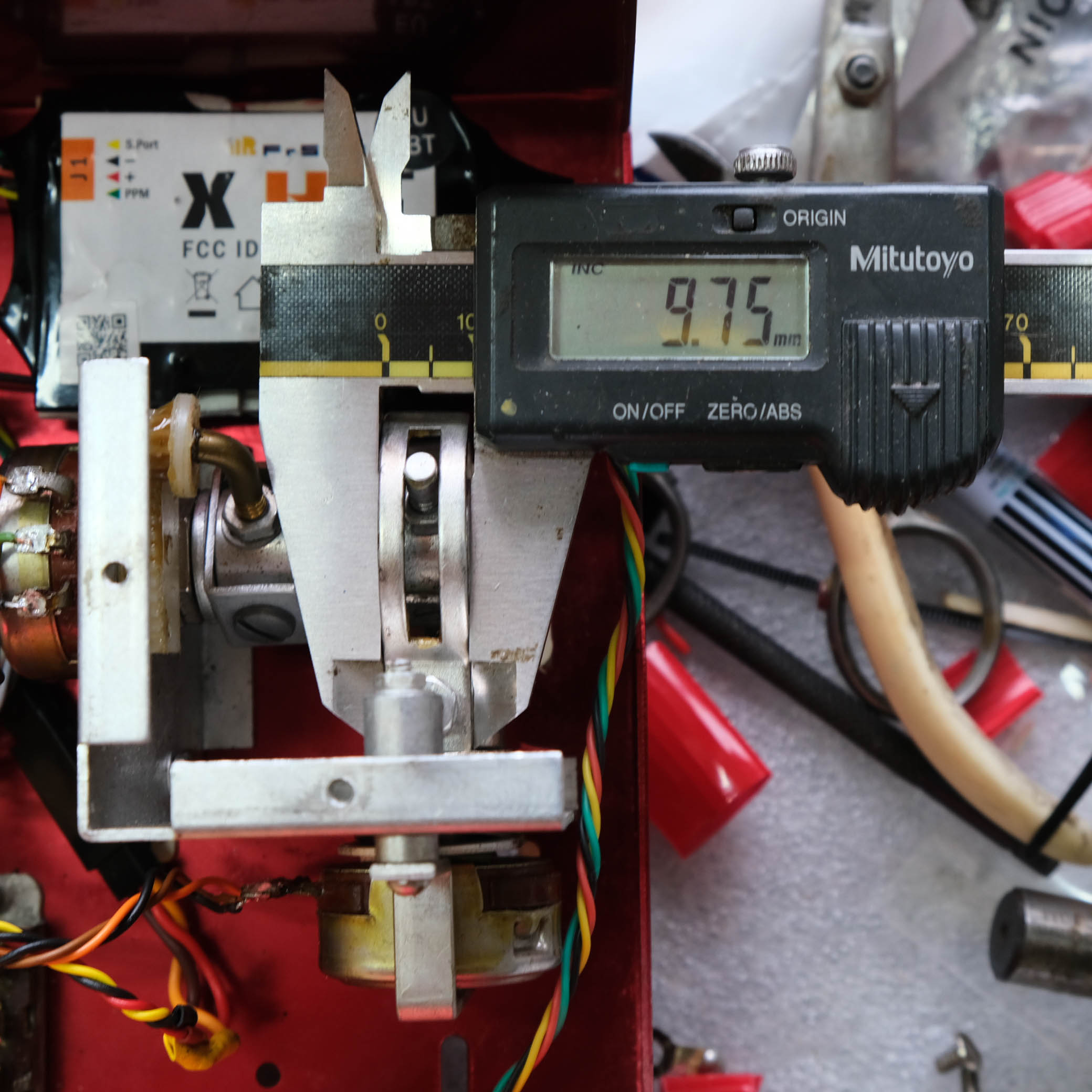

Thank you and sure appreciate you took the time, it sure would be a challenging and fun project so it's in my bucket list. Just one question, what's the thickness of the aluminum? 1/32" - 0.8 mm?
I think I can extrapolate the other measurements from the pot as reference.

Tobe wrote: 28 Jun 2020, 05:56 Thank you and sure appreciate you took the time, it sure would be a challenging and fun project so it's in my bucket list. Just one question, what's the thickness of the aluminum? 1/32" - 0.8 mm?
Cheers & Thanks
Tobe
Here ya go Tobe!

Had a chat with Mike K about drilling holes in a somewhat rare (to the UK at least) Tx case.
But wanted the single channel facility easily accessible as it will probably be used with a period aircraft such as a RudderBug or an early "Multi", so bit the bullet and drilled a 6.2mm hole on the top right and and found a suitable button.
Managed to position the "modern" electronics out of teh way which allowed the re-use of the original PCB to cover everything up.
I still haven't decided what to do regarding the final positioning of teh 2.4 aerial so have temporarily mounted into the existing aerial hole.

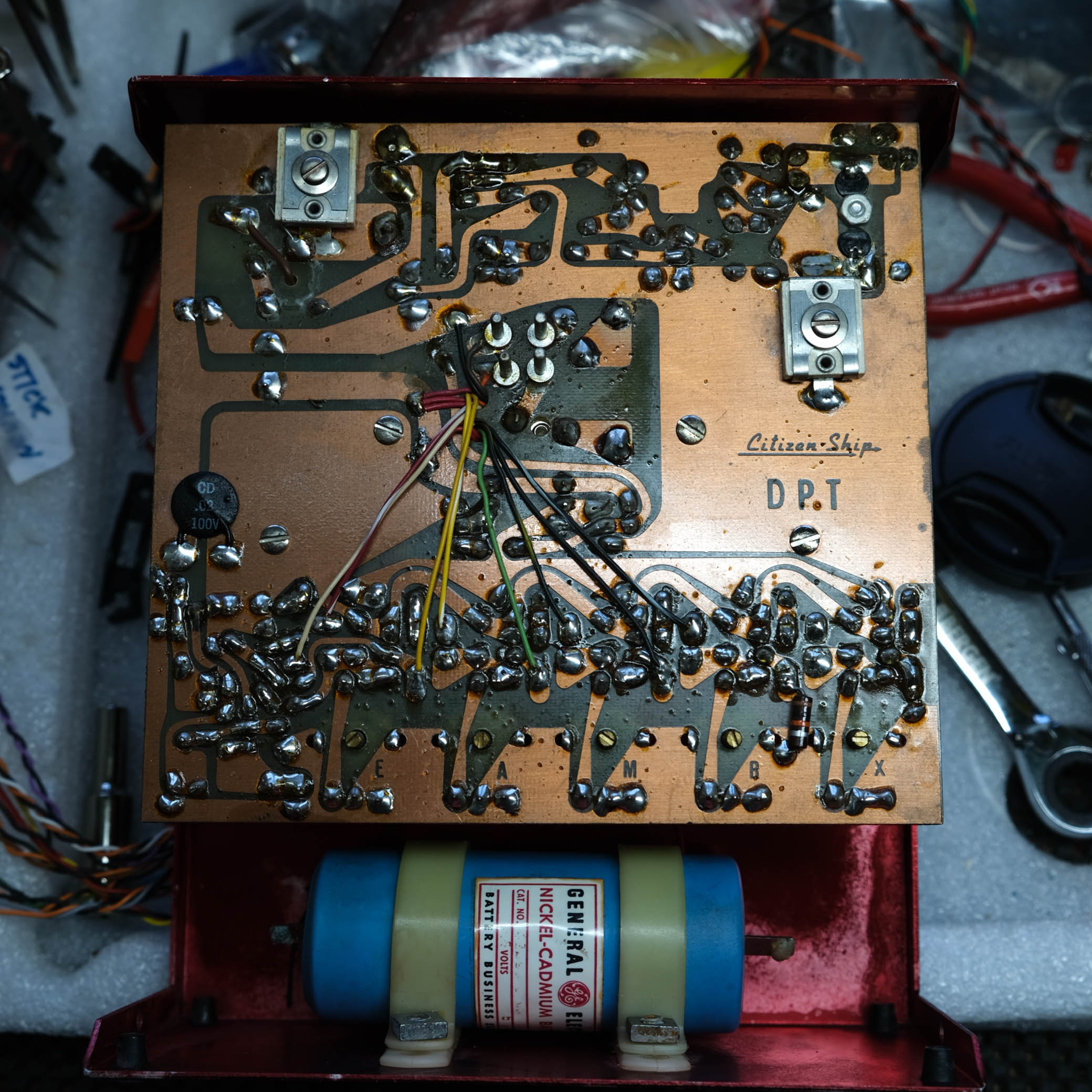

Phil_G wrote: 28 Jun 2020, 20:17 "Spot the encoder" :D :lol: :D
Magnifying glass required Phil!

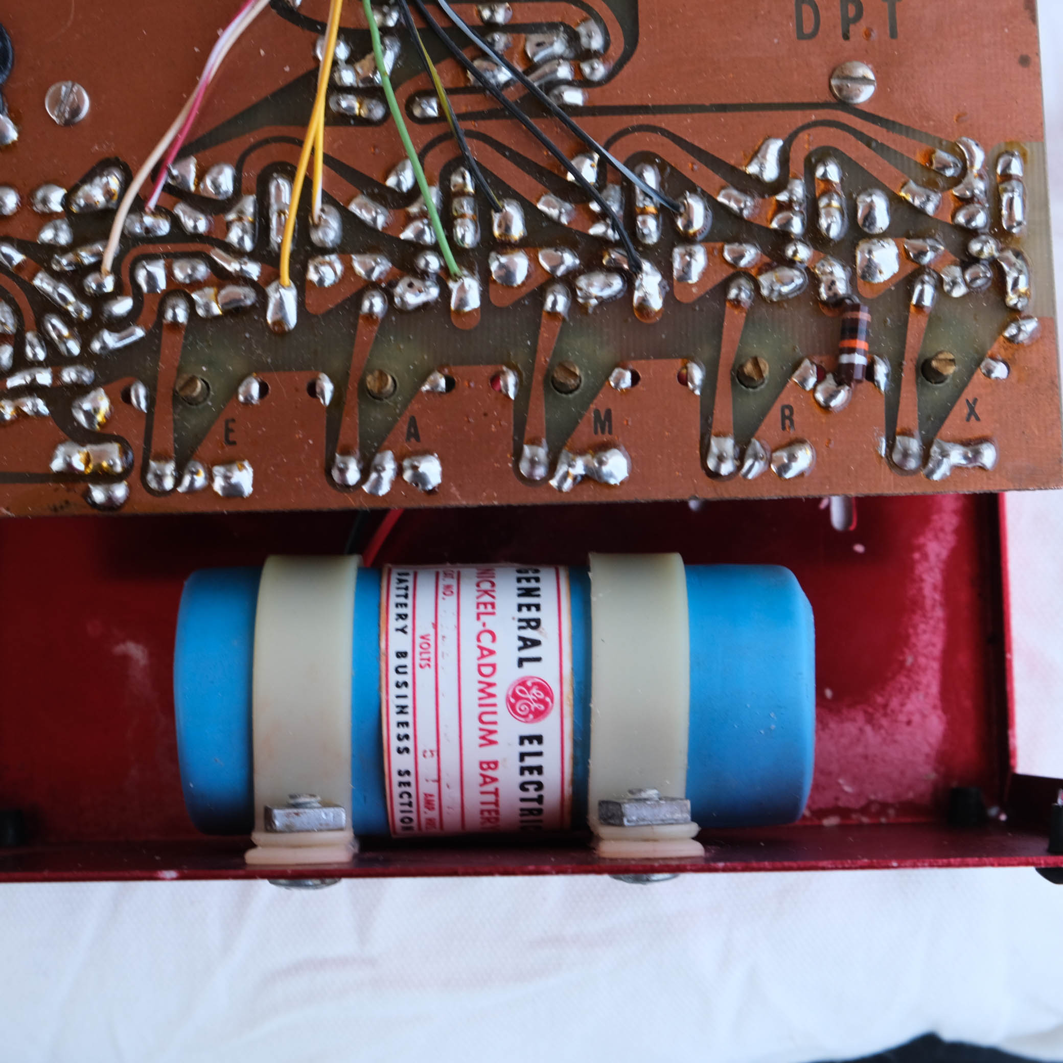

Here is a scan of the GE battery label if anyone needs to make a replica.
Spot the hidden 18650 cells?
