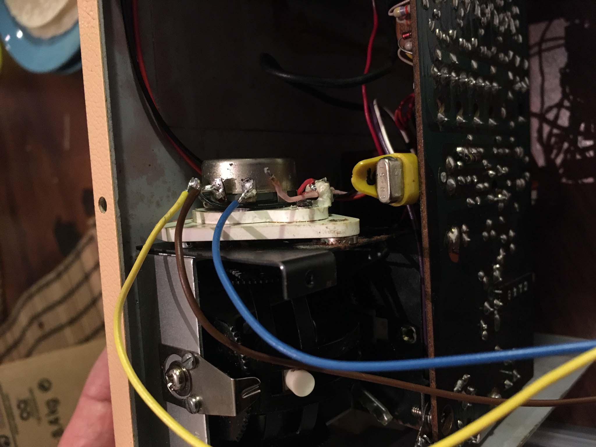

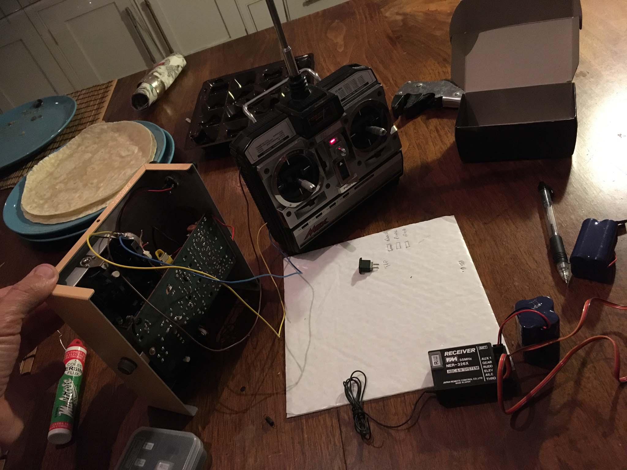

Okay so I probably deserve a big smack on the wrist because at this moment I’m thinking of transferring all of the innards out of the JR transmitter to the OSCougar mark one. This will give me a basic 4 channel proportional set up with servo reverse. I ought really be using the digi spark Or other such postage stamp encoder. In the photo you will see I have spliced in one of the pots in the OS transmitter into the JR. It all works however the movement on the servo is small. The equivalent of a trim pot. The JR has four pots Per stick, And the OS only two of course. Can this fault be rectified? Is it something to do with the pot values or is it the wiring involving the trim pot in the JR transmitter and if so could this be bypassed? Your help as always is much appreciated. (maybe I should just buy a bunch of DIgi spark encoders! )

I think you will find the JR pot works over 60 degrees not the usual 270 degrees.
