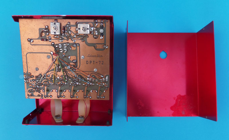

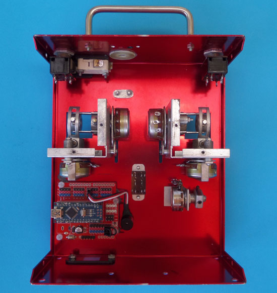

original internals:

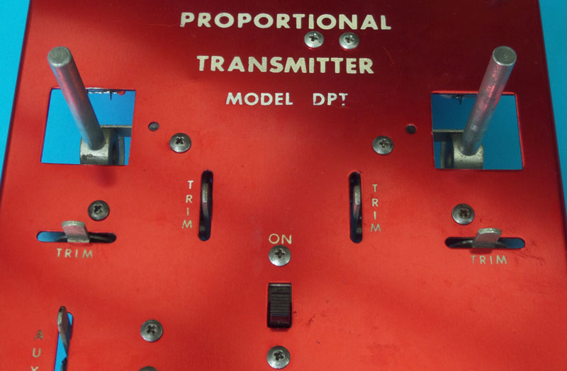

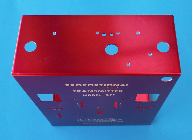

case cleaned, holes drilled for bind board and switches. Ready for conversion:

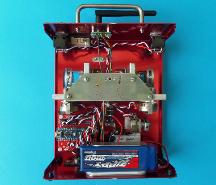

Phil's encoder mounted:

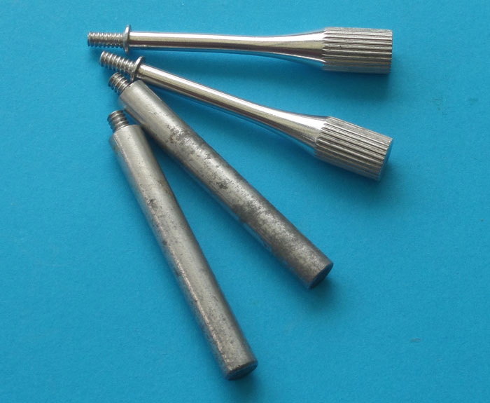

The originals sticks were fairly agricultural: however better sticks were available as aftermarket upgrades for the CitizenShip sets at the time - I found some OS sticks that were similar to the upgrades and cut a thread on these to fit the gimbals:

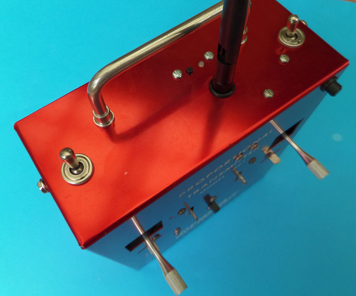

top view showing the bind board and additional toggles for on/off functions using 'period' switches (the set is now the full 7 channels):

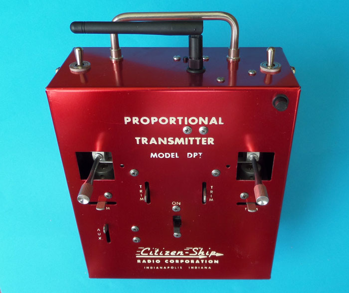

Finished TX - note the single channel button on the top right. This is a micro switch with a great 'feel' that I have been saving for a project like this.
Again, I need to thank Phil for his great encoder!
An early CitizenShip 5 channel analogue TX converted to 2.4ghz

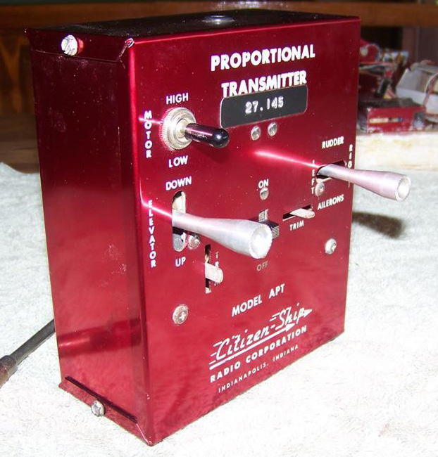

this pic (found online) shows the actual aftermarket sticks which were available for the set:

Nice conversion! Looks great!

Awesome job! I have been on the lookout for one of those or the anodized EK to convert. That red anodized is just beautiful
