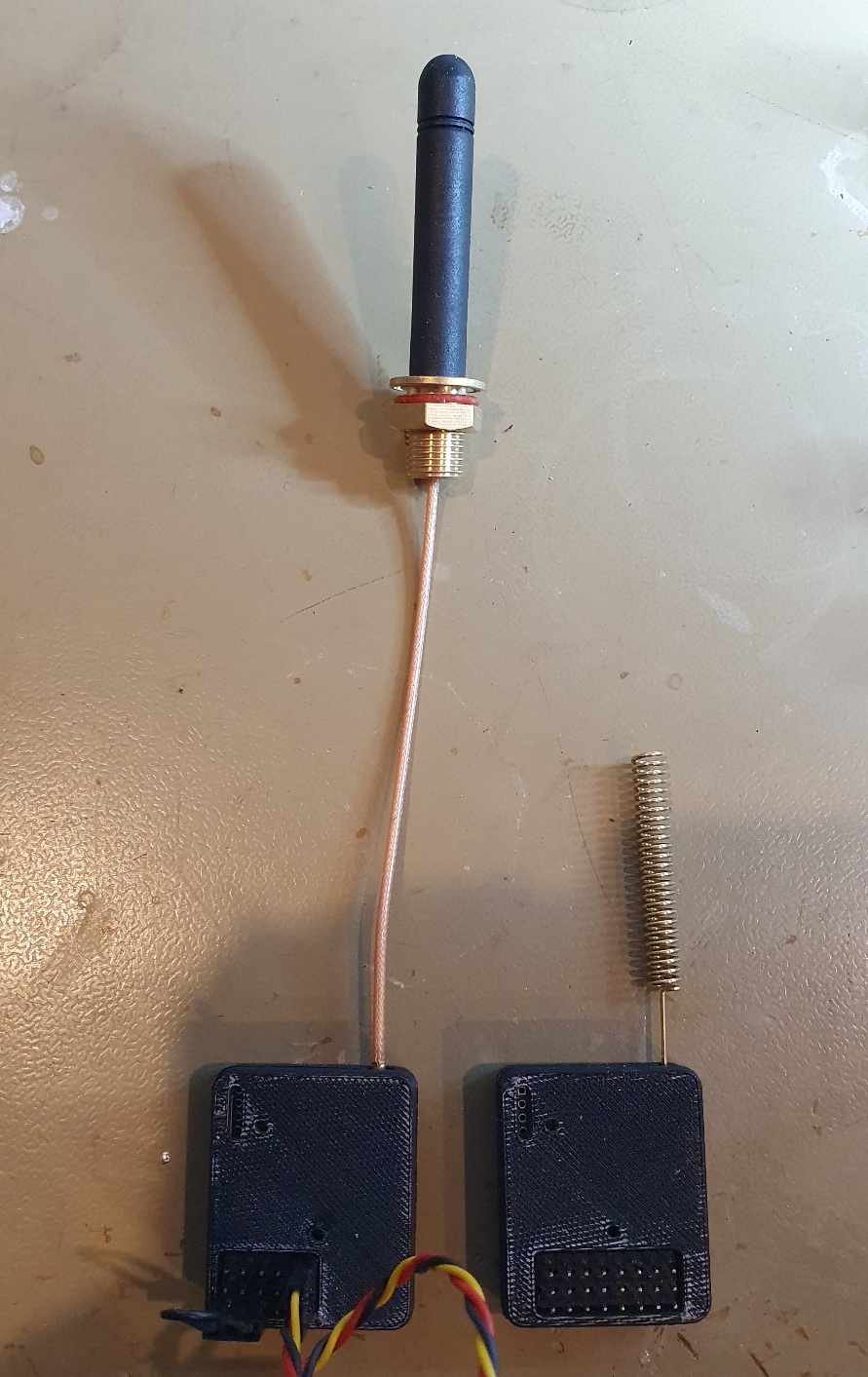

Here comes a picture of my LoRa set up.
The set up is 8 channels.
I will post whenever the weather gets more decent video and more info of the progress. At the moment I'm running in the 868mhz section of LoRa with an output of 25 mW e.i.r.p in accordance with CE regulations and it's what Jeti specify for their dualband system. The Rx has an LED that shows if the Rx has been in F/S mode under a session and for the moment I have only seen it when I turn the Tx off & on.
To the left the Tx module which connects to encoders ppm output and to the right the Rx which works like any standard ones.The set up is 8 channels.
