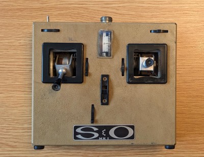

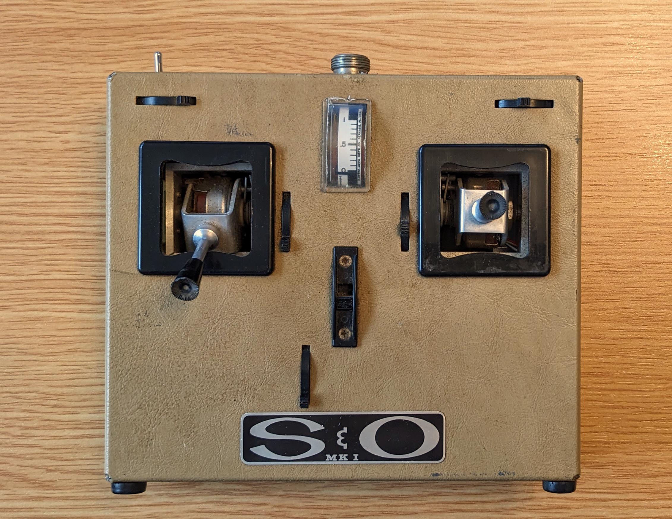

The S&O set had been on my "bucket list" to add to my collection for years, but I had little hope of ever finding one as they had been hand built in the USA in very small numbers from 1971 to 1973. Then this one appeared on eBay.de and I managed to get it, another crossed off the bucket list!
What is so special about S&O? Well the joysticks. If you think Pro Line joysticks are good, the S&O are better. In fact, they would give any modern top-of-the-range Jeti, Futaba or Spektrum a run for their money. The electronics were also exceptional, very stable with changes in voltage and temperature, it was a set truly ahead of its time. But it was so expensive and difficult to build that they couldn't continue and Pro Line took the top spot again.

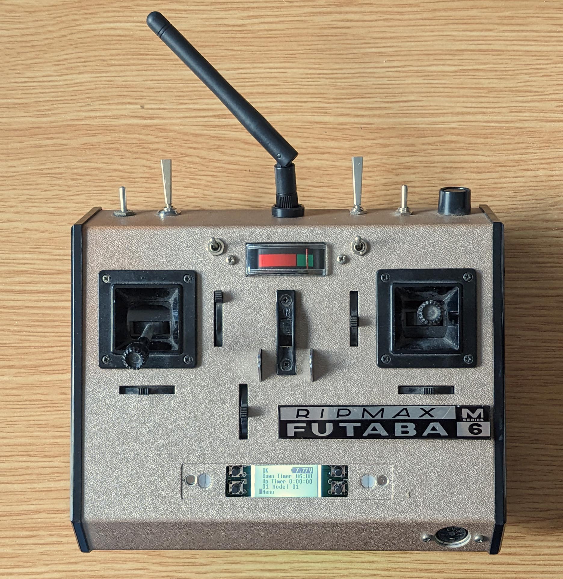

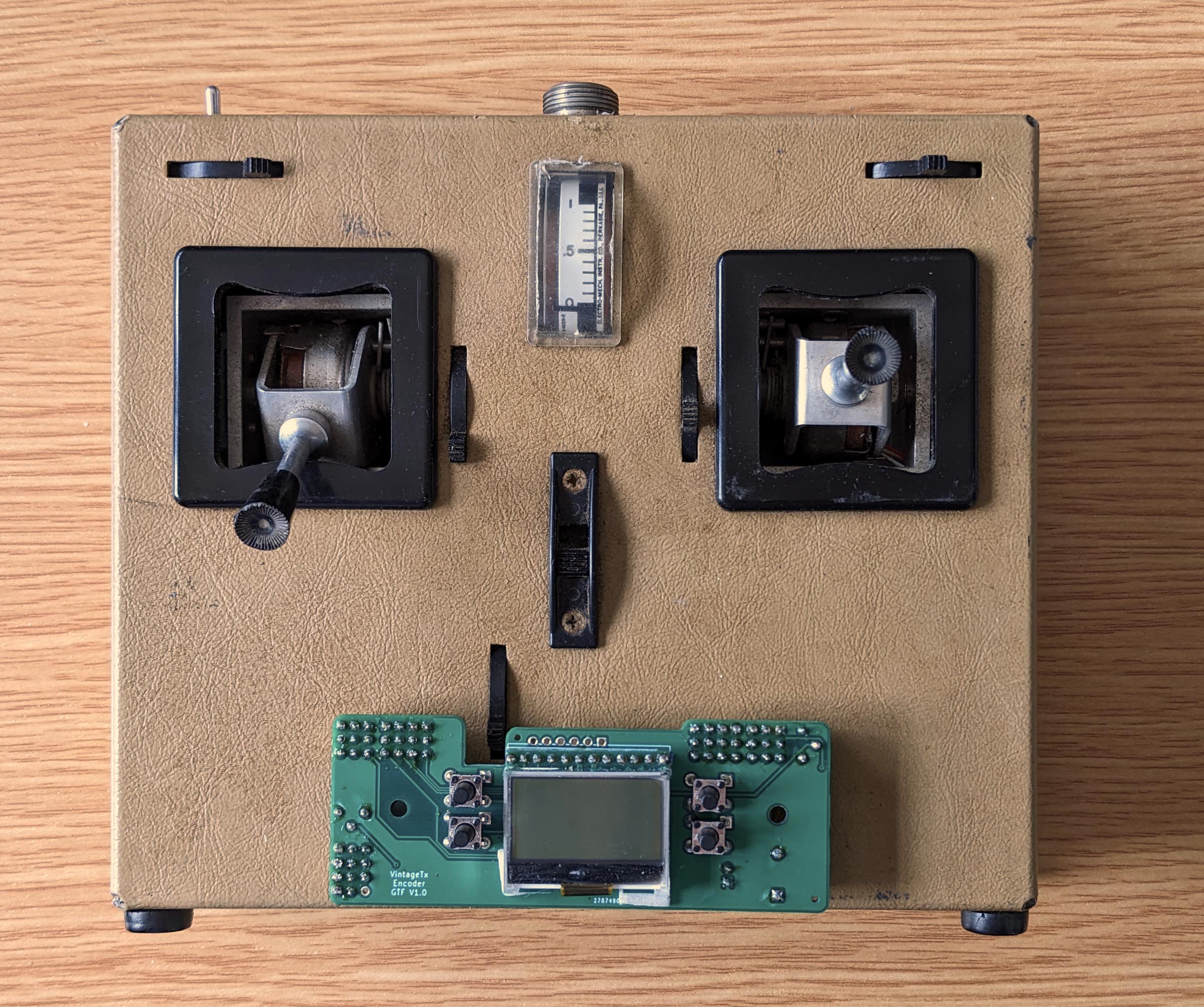

I've designed a dedicated encoder board for the Futaba M6 (FP-T6FN elsewhere in the world) that nearly fits the S&O, the auxiliary lever just fouls the "slot" in the pcb. I'm going to see if I can file away the bit of the PCB that would foul the auxiliary lever (I don't know how bad an idea it is to file away a bit of a multi-layer PCB, but I know there are no tracks in that area) and then have one of my standard conversions with the encoder LCD and menu switches hidden behind the S&O badge. The worse that happen is that I mess up a circuit board, but I've around 20 left, so it wouldn't be a disaster.
And the encoder board in its intended transmitter

I know there are a few S&O in the USA, it isn't unique, so I have no reservations about converting it. It seems the perfect candidate, it has a label in the correct location to hide the LCD and menu switches behind and it has such lovely joysticks that I fancy it as an everyday transmitter. The only downside is I will need to design a new circuit board to fit. Or rather I'll modify the design of the encoder board I did for the Futaba M6, so that it will fit both an S&O or a Futaba M6, there is a minimum order to have circuit boards manufactured and doing a "one-off" isn't cost-effective, but getting 20x boards is.
