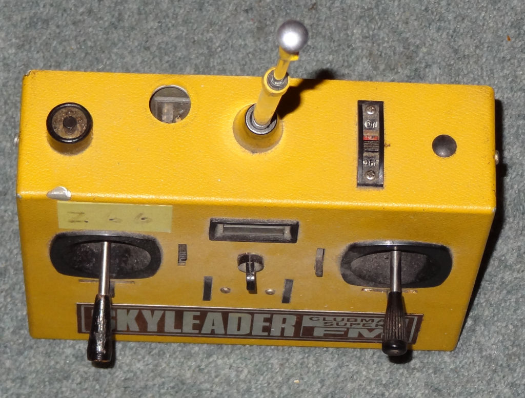

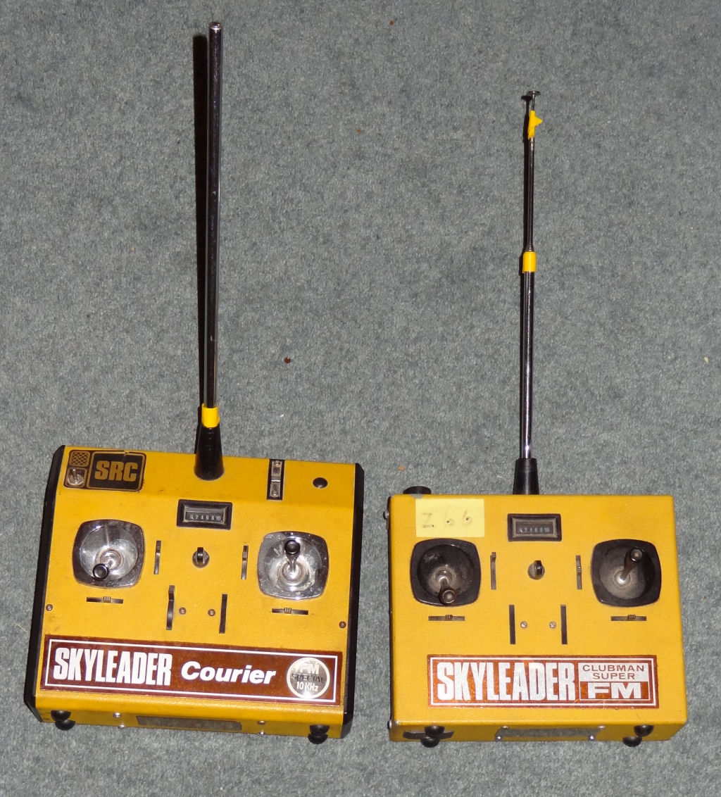

These two have just been donated to me by "Old Bill" (who is 98 years old, and now flies using more modern equipment). I've not cleaned them up or inspected them yet. I don't know anything about them really.
The Clubman has a small push button on the top left of its case, and a hole next to that. Is the push button a standard thing, and what might have been in the hole? Maybe I can restore whatever it used to be?

From memory the hole was for the xtal and the button for using in teacher /pupil mode but I may have it wrong.
- Posts: 603
Re: More Skyleaders
I can confirm what Shaun has said...... The hole was for access to the crystal and originally had a rubber blanking plug to seal it. The button was for Teacher/Pupil and in my own conversion of a Clubman I kept this button in place and used it as the Binding button.
- Posts: 745
Re: More Skyleaders
Thanks. Now I've looked I can see the crystal connector underneath the hole, and the Courier has a similar hole/missing crystal on its back surface. No obvious buddy box button on the Courier, though it does have a similar DIN socket which I guess was a combined buddy-box and charger connector.

Thanks guys. I'm probably not going to get around to this any time soon as I have several other projects on the go already!
The Courier does have plastic sides, so I guess that's the one to use.

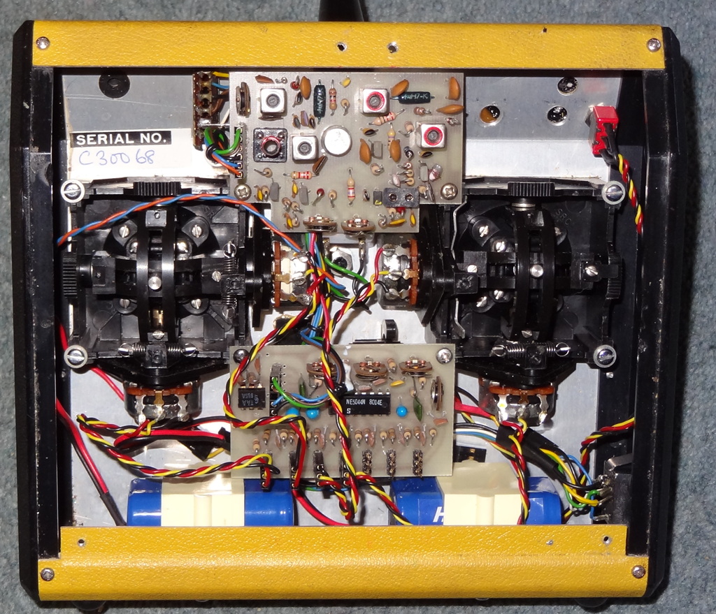

An option would be to retain the Skyleader encoder board, (which as you can see in the photo looks in great condition and appears to have headers for seven separate pots/switches) and read the resulting CPPM signal into the ESP chip - that way I'd only be using one digital input to read the position of all the sticks / pots / switches so maybe I could use an ESP8266 - even just the ESP01 (though I'd probably change the flash chip to something bigger than standard).
But I suppose if other people want to build one, it would be best to use analogue inputs - so as Mike says, may be better to use an Arduino or some other separate multi-channel analogue input board.

Using the existing encoder with an Arduino as a "post encoder processor" is a great idea, you don't then need to use any analogue inputs. And yes the Skyleader Courier has plastic sides so should be good for Wi-Fi as would a Futaba M series, Micron PL7D, later Fleets and Sprengbrooks and others.
