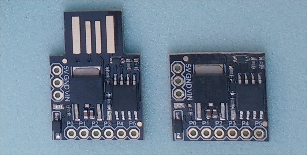

Me and Frank both love the DigiSpark ATtiny85 boards, they're so neat and tiny!
The 1+1 encoder has been quite popular, with maybe 30 units sent out, and since I've been looking
at smaller trim-less stick units, adding a propo elevator to make a DigiSpark 2+1 seemed a good idea

The DigiSpark board is only about 3/4" square so with a small stick unit is ideal for a miniature
2 channel or 2+1 tranny. Its not fiddly though as the connections are the usual 1/10" spacing.
You can safely saw off the USB connector which we dont use. Pull off the schottkys and program
it directly with a USBASP, dont use the bootloader as the Digispark one has a full 5 second startup
delay

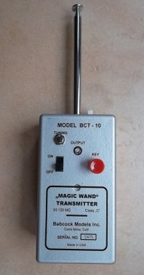

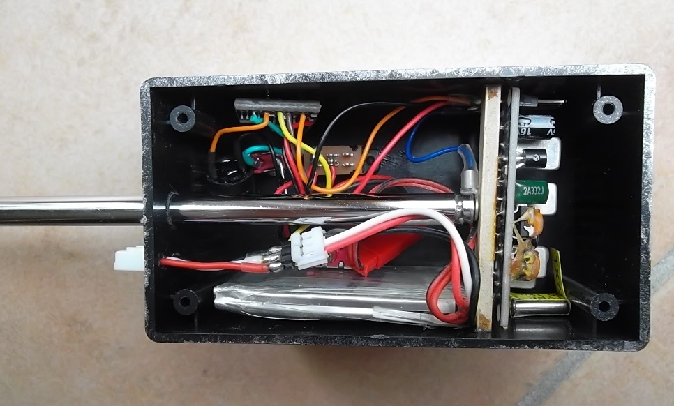

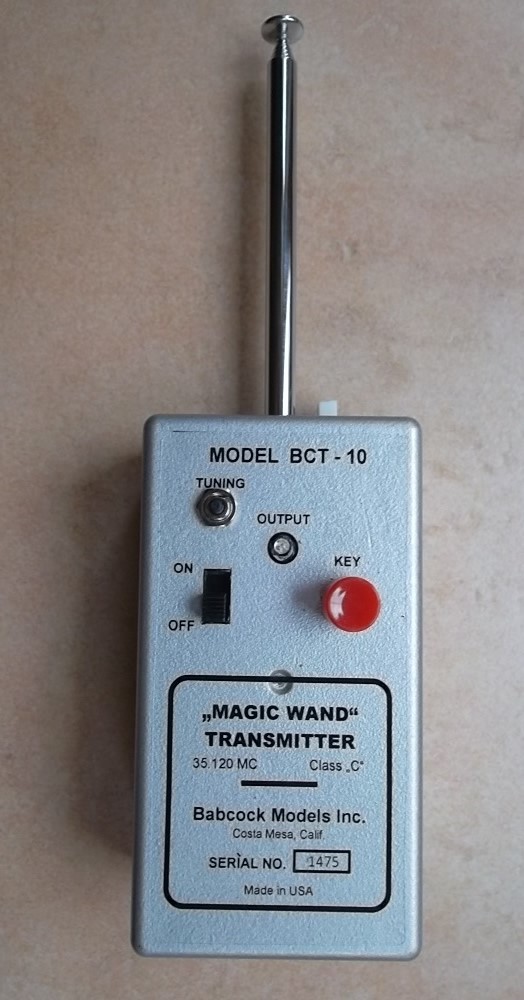

The second one is a Babcock Magic Wand replica. Both are working great. I used the Leonardo Beetle, because it is so tiny, it has more possiblities than an Attiny85 and I wanted to try them out.
However they are a kind of tricky to program.

No problem Phil, I read over a lot of things also without really noticing what´s going on.
The beetle is a nice little board with a lot of functions, but I still have to find an easy way to program them.
I am not a programming specialist and I needed some time until I found out, how to use it.
Mine did not program using USBASP, I had to do it via the onboard USB and the parallel programmer. After starting the upload, I had to manualy reset it by shorting ground to RST with a short wire for a moment. Then the upload started.
Not a comfortable way of programming, but it works.
Maybe one of you guys find a better way.
