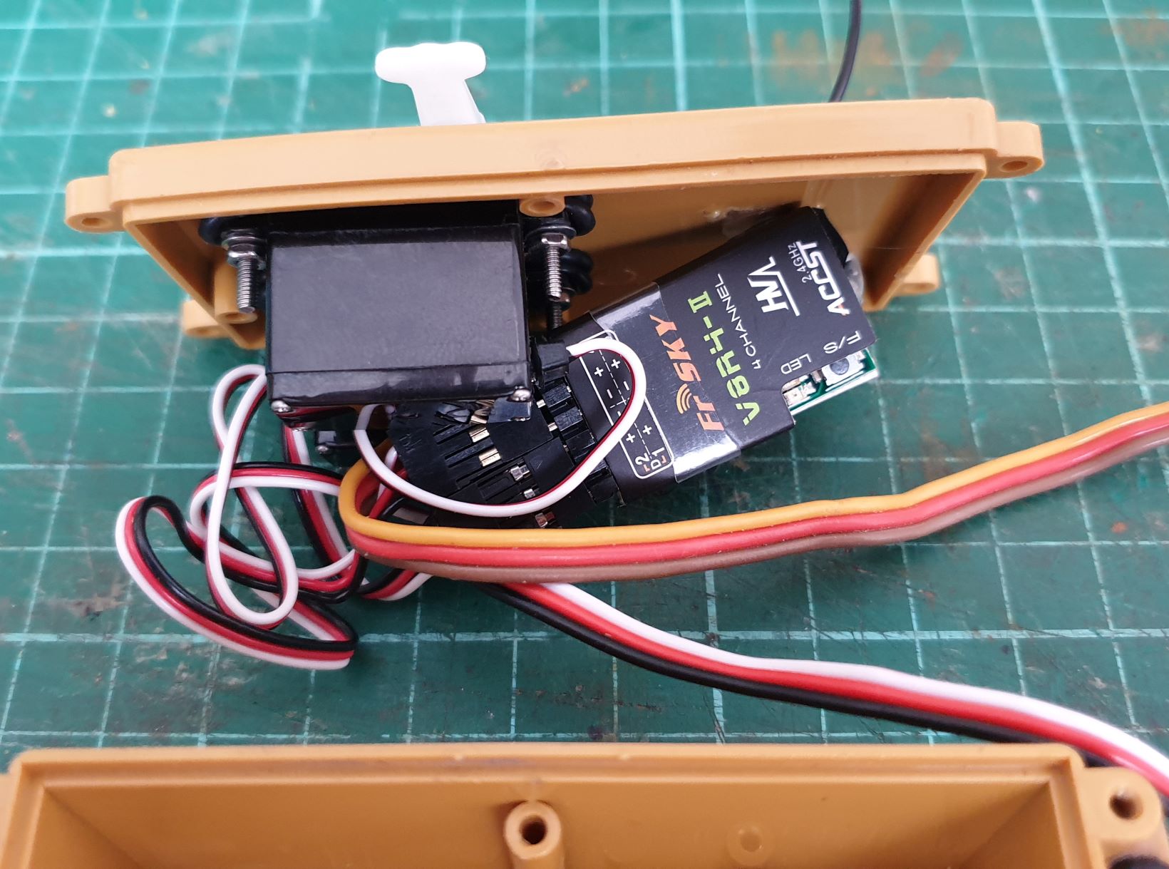

Originally, I had hopes of 3d printing a new 'brick', containing a FrSky Rx & 2 x 9-12g servos. My own brick had died a natural death long ago :shock: . However recently born-again Pom, GaryNB, graciously sent me an empty brick & matching battery box when he was rationalising(?) his collection in Oz before regressing back to Blighty - thanks Mate ;) . Consequently, I was able to easily retro-fit 2 E-Sky 9gm servos and the afor mentioned Frsky Rx, creating a "brick" to complete the set.

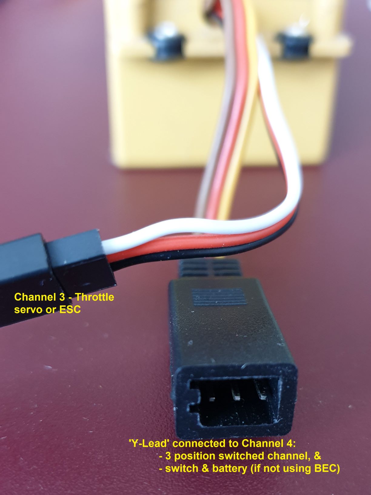

Two fly leads exit the "brick":
  • one for the throttle servo or ESC
  • a 'Y lead', connected to channel 4. This allows both a servo & a battery & switch harness to be connected if not flying electric using an ESC with BEC

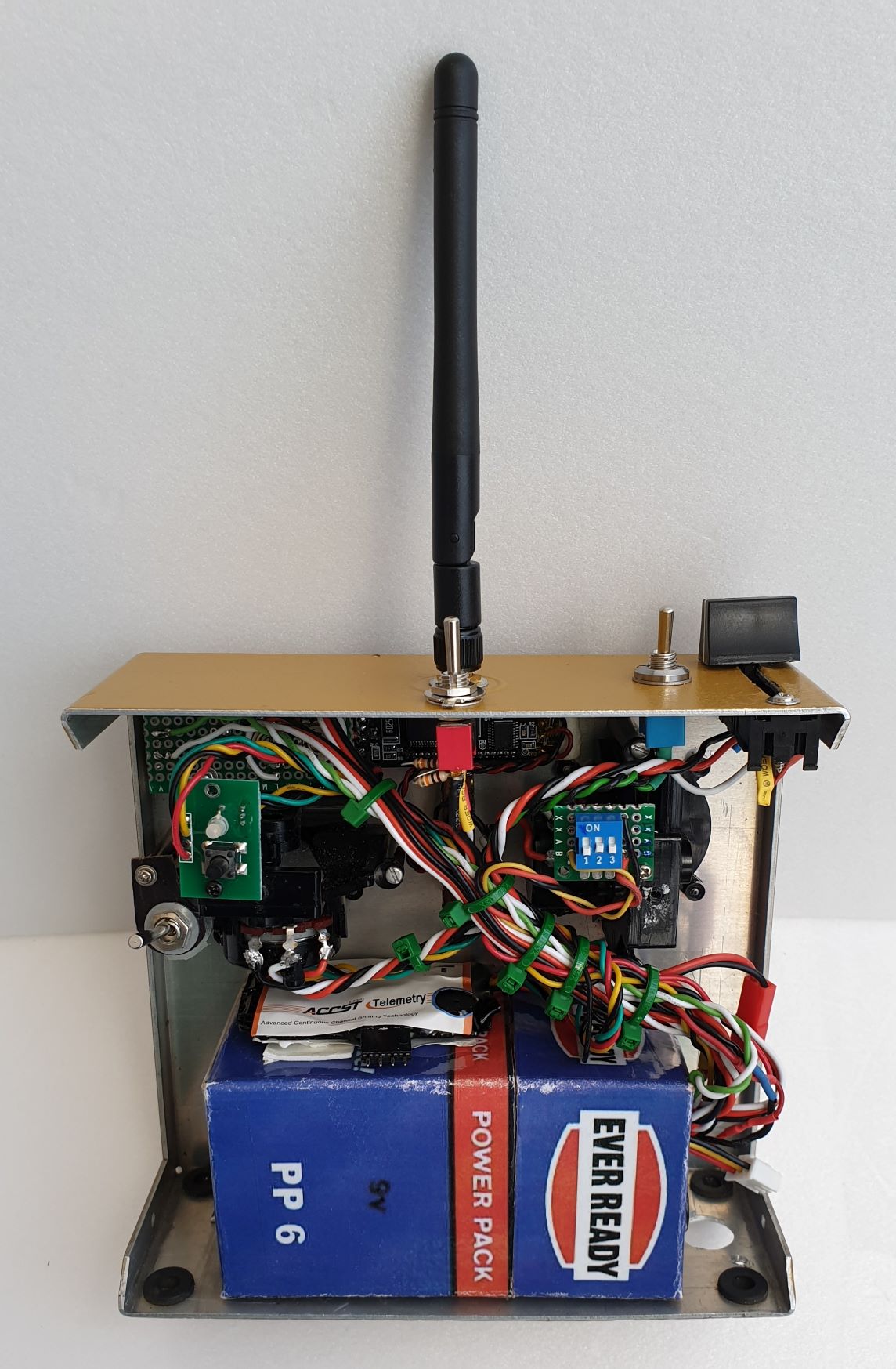

The bind board, Frsky 3 position switch, rate pots & switches are all internal. A slide pot from a box of old Multiplex bits was added for throttle with the throttle kill switch mounted next to it, mounted to operate in the same sense. A 3-position switch is plugged into channel 4 of the encoder & mounted unobtrusively behind the antenna.

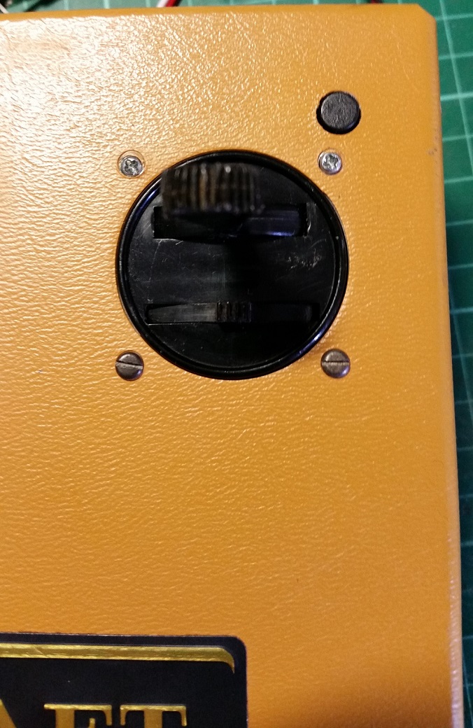

The single channel push button is mounted on a piece of board along with the rates & expo pots, internally above the rudder stick.
The encoder & a 2S Tx battery are mounted inside the fake 9v battery.

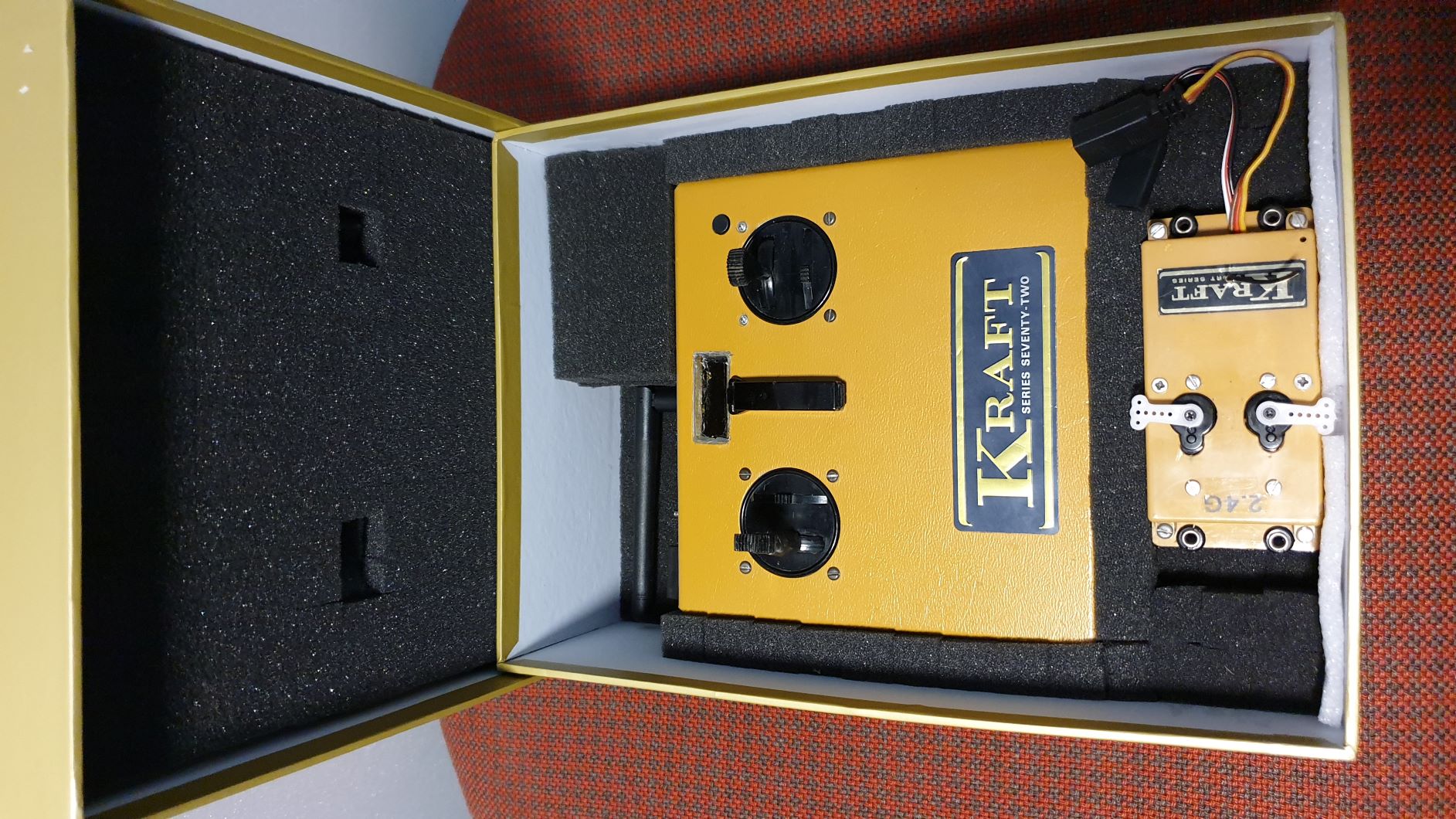

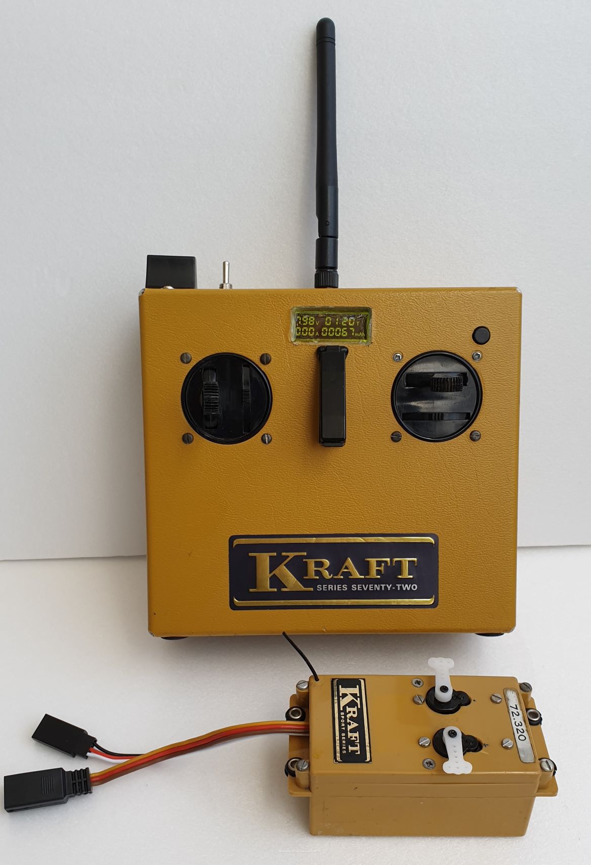

I took a leaf out of Ron's book & made up a box for the TX + 'brick'. The gold coloured box (of course :P ) is a gift box purchased at a $2 shop for a few bucks.
