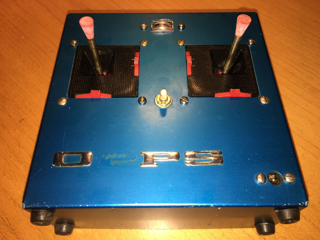

The external condition on TX is great but I will need to have one P letter made in the OPPS name on the TX front. It is some rased and sligtly rounded letters that seems to be crome.

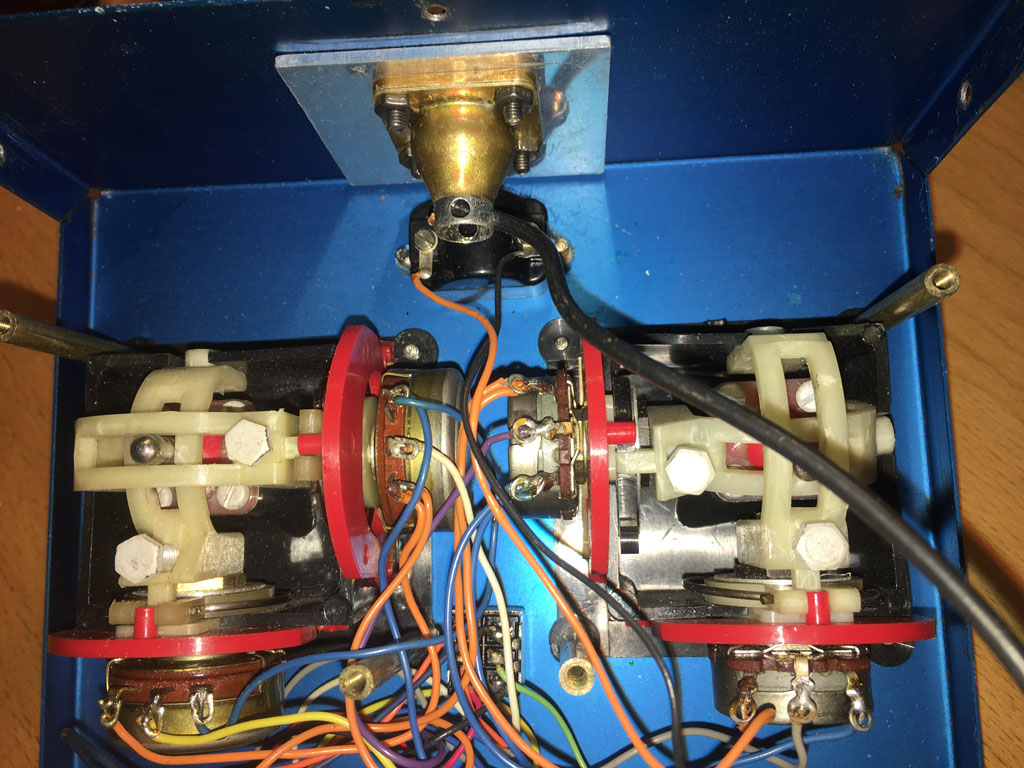

The Bonner sticks are very stiff, even stiffer then Orbit 7-14D Proportional sticks and they are really stiff. I do not understand how they could fly with such hard springs in the Bonner sticks. It seems not possible to replace with lighter tensions spring in the sticks as far as I can see.
Maybe I will change the potentiometers in the Bonner sticks, not sure how much duty time this TX had back in the days.

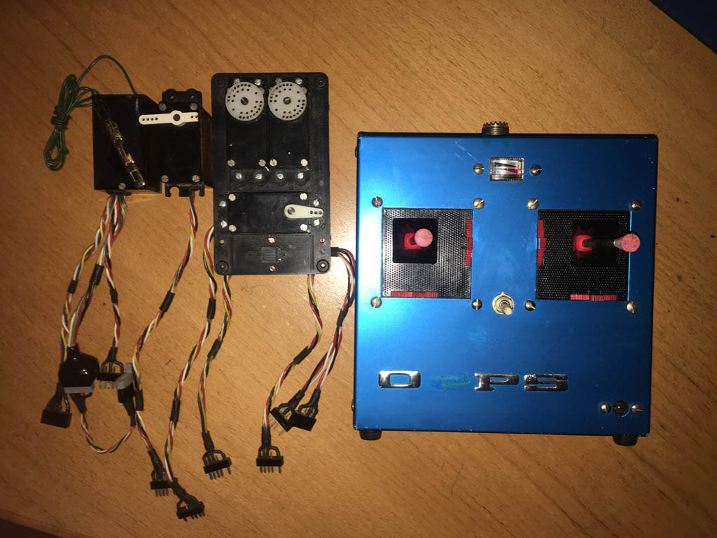

OPPS 4ch transmitter, receiver and 4 Multiplex servos that was used back in the days (1964):

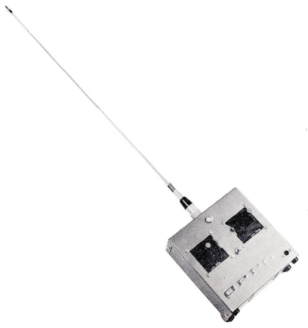

OPPS (in 1969) shown with the short one piece steel antenna:

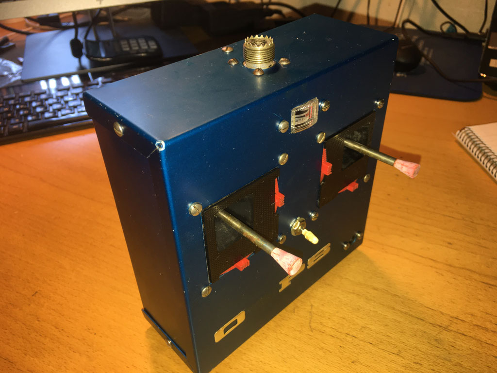

Transmitter front:

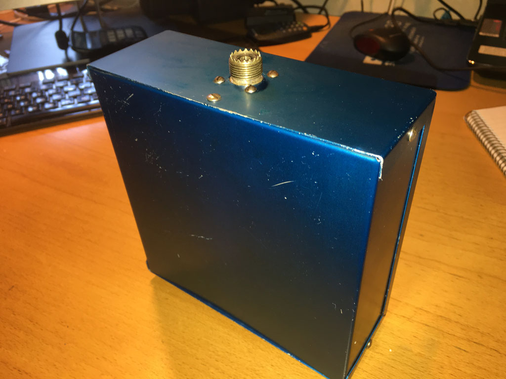

Closer view of transmitter blue anodized aluminium case:

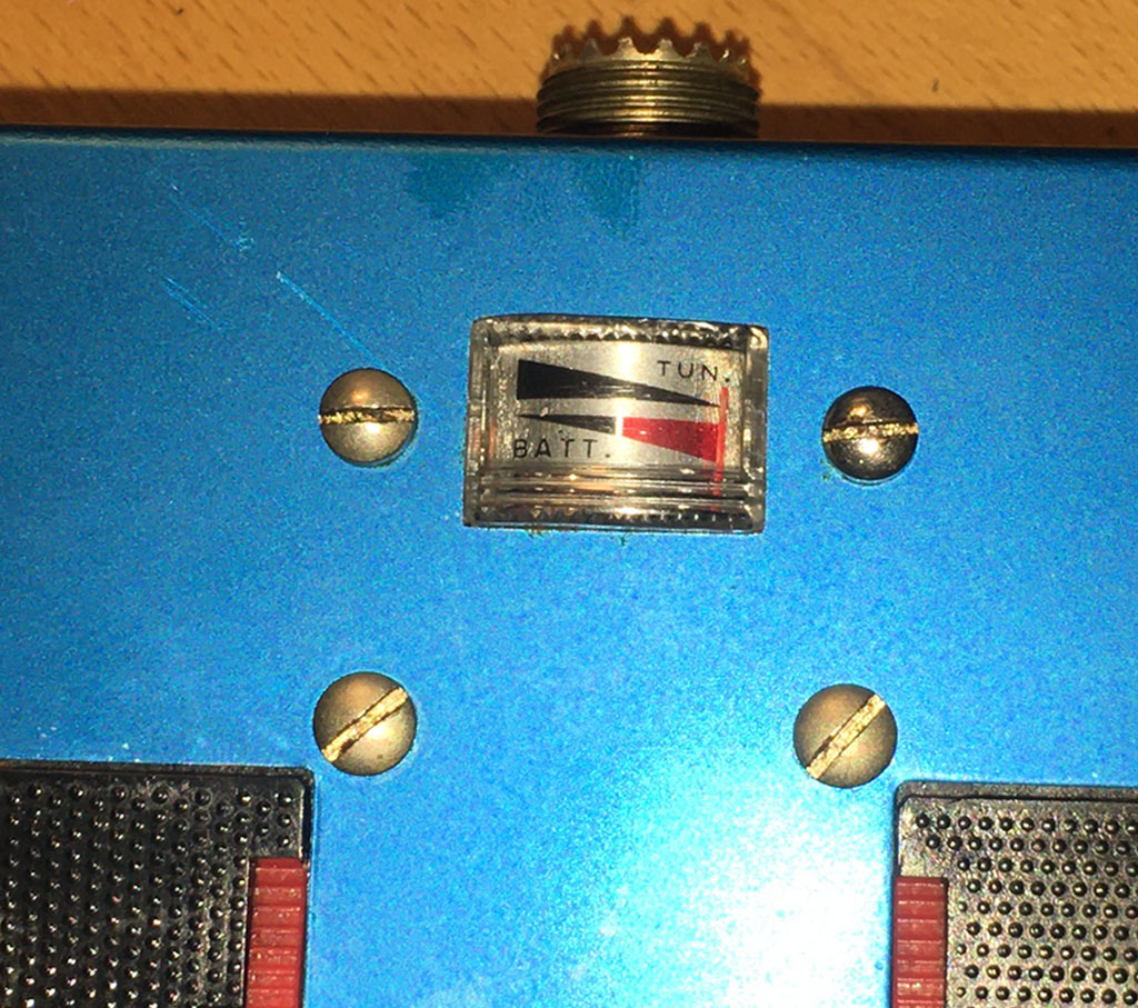

TX combined meter for battery voltage and "tuner":

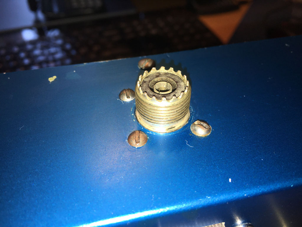

TX antenna mounting, the antenna was an Allgon 50 Ohm with extension coil, fixed lenght 625 mm of steel:
Antenna mounting inside TX case:

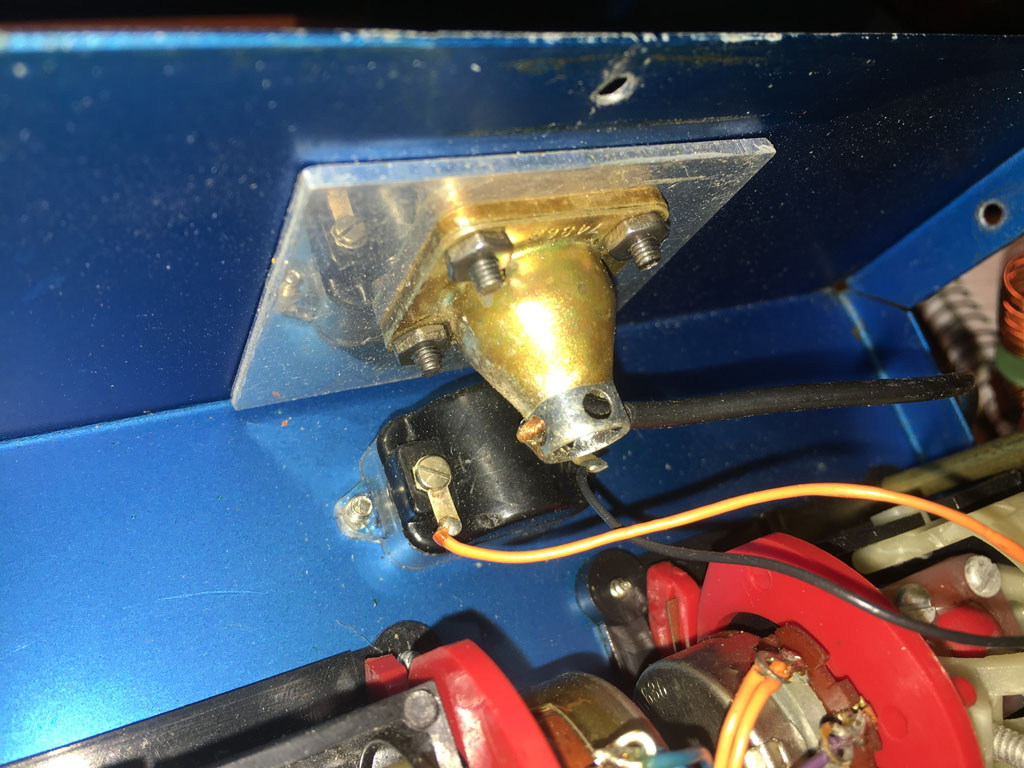

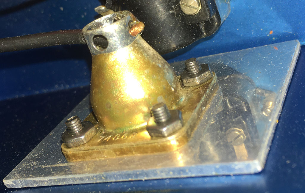

Closer view of antenna mounting, marked 74868:

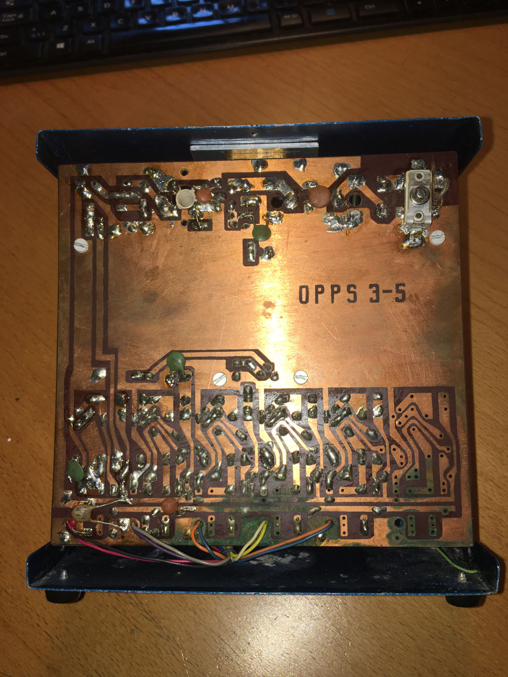

Main board inside TX (marked OPPS 3-5" that is proof of early production, since later it was OPPS 3-6). As far as I know the radio was handmade and assembled by the desiger himself:

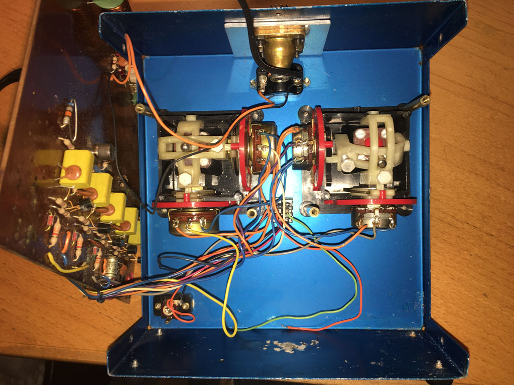

Inside TX. NiCad was mounted at TX buttom (now removed), it was DEAC 500 MAh, 9.6 volt, that gave about 4 hour usage:

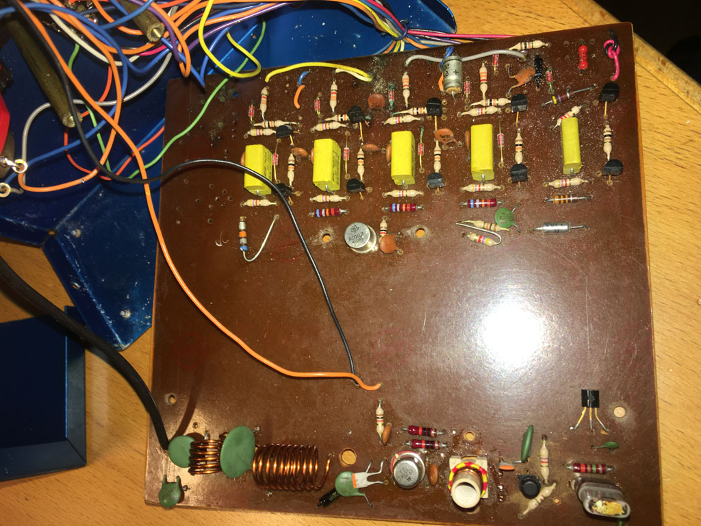

Component side of main board, notice it is already prepared for 5 ch (max):
Bonner sticks, notice different seize of potetiometers:

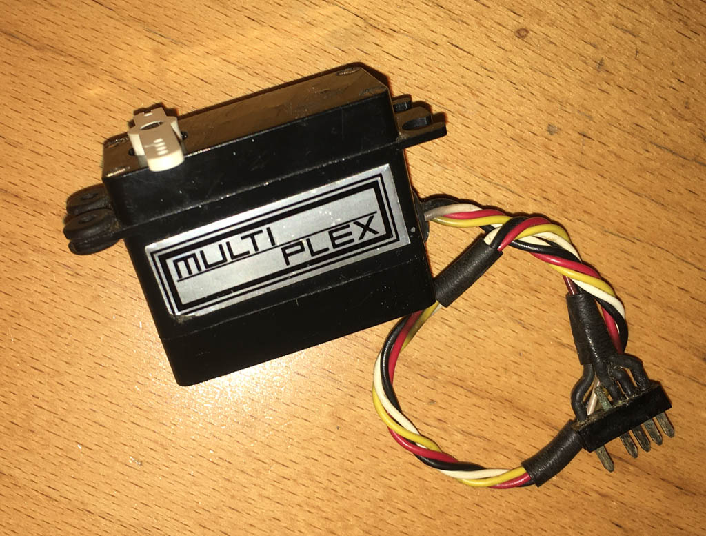

One of the 4 Multiplex servos used in my OPPS radio:

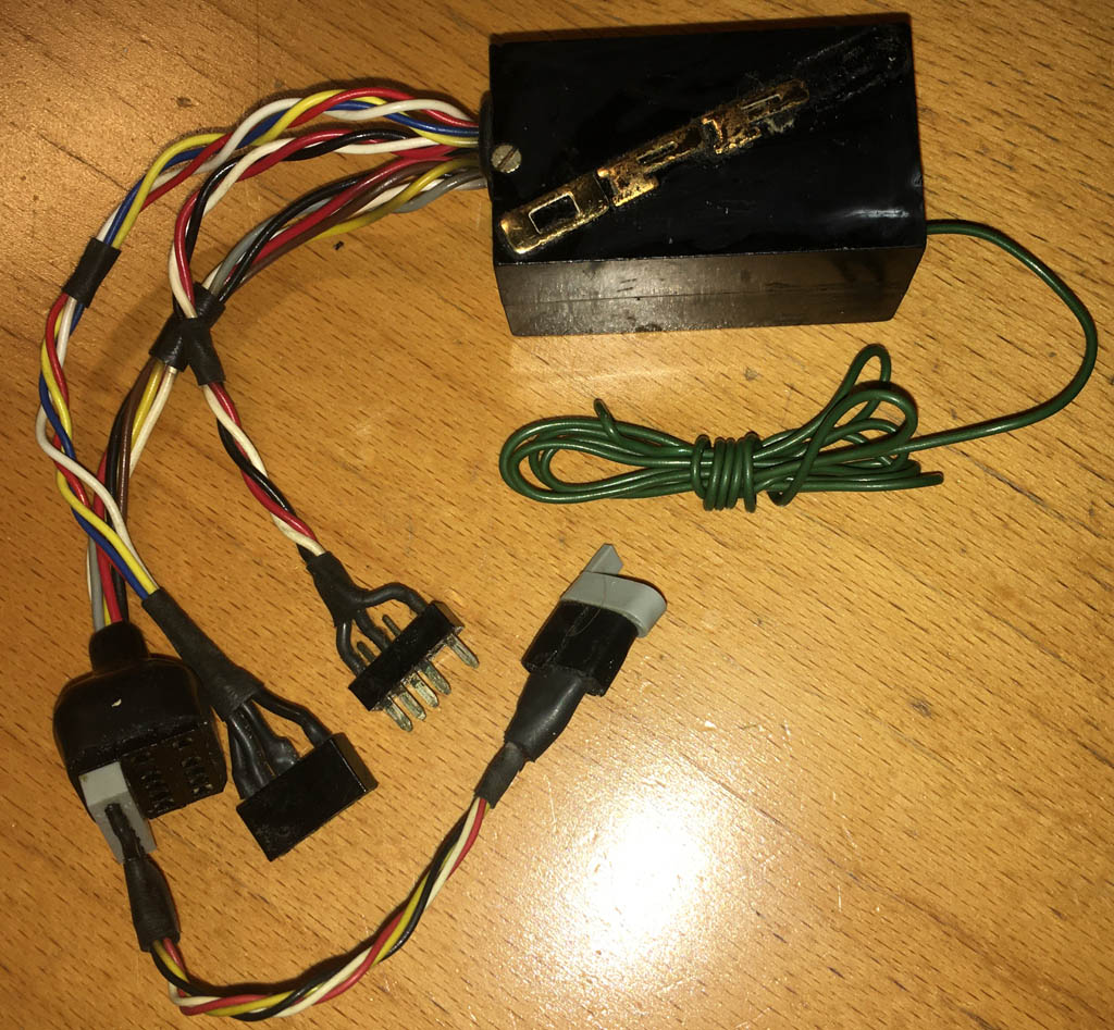

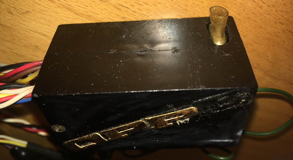

The Multiplex-OPPS 4 ch receiver, it is plastic material, weight about 70 gram:

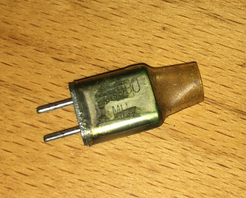

The crystal is accessible from outside receiver:
Crystal used back in the days is marked 26.590 Mhz:

Concerning the Bonner stick the spring is a horse shoe one and can be replaced with one of softer material not hard to make with a little practice however get 3 all the same might be harder. If you change the pots in the stick be careful with the screw that tightens the control arch to the pot shaft as that plastic is often bridle and cracks easily if over tighten.

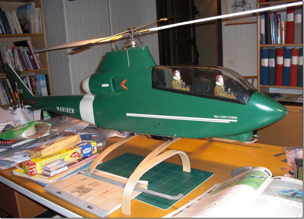

On the bench:

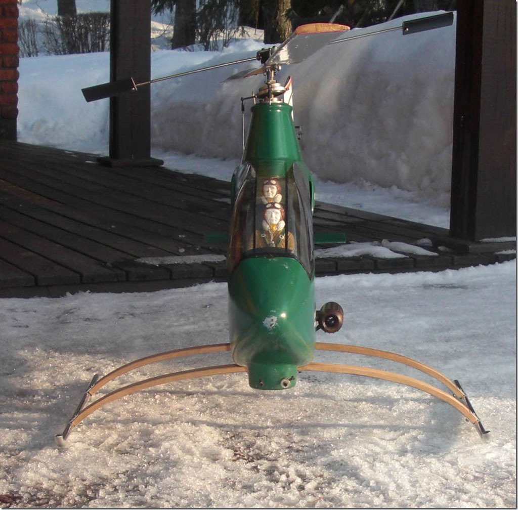

Sleek fuselage:
