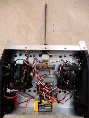

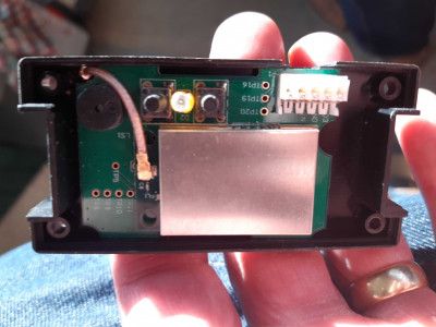

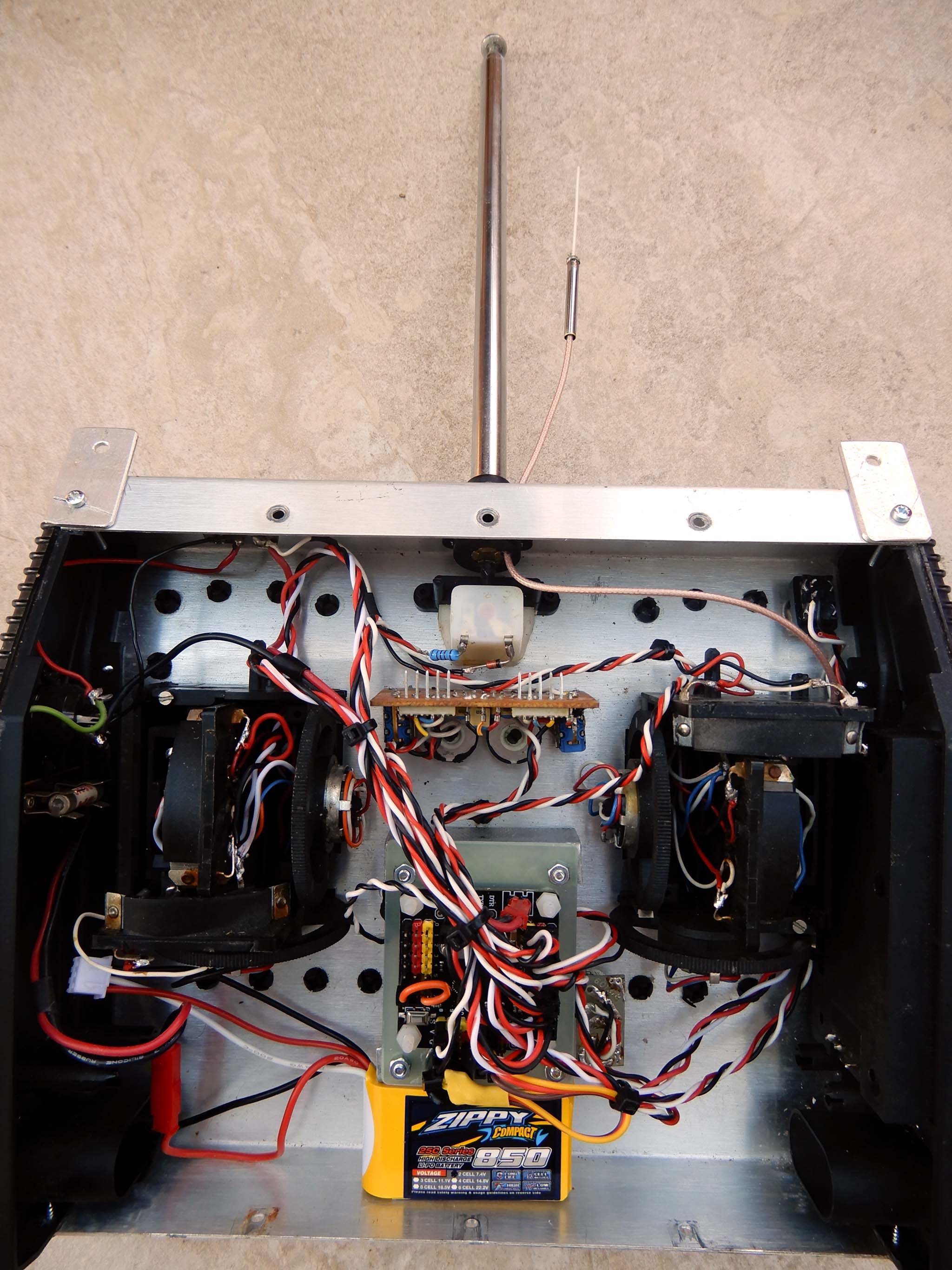

Stuart, I have done mine somewhat differently to yours. There was corrosion on some of the module boards so I haven't used them, other than the switches and pots on the Rate/Expo board. All my other stuff is DSMX/DSM2 so I took the innards out of an Orange module and installed it in the Simprop module case.... I like to make my own antenna and disguise it in a dummy frequency pennant.....
I have used Phil's latest 7 channel encoder. I haven't used the mixers but have used the Rates and Expo facility, using the pot and switches from the old Simprop module.

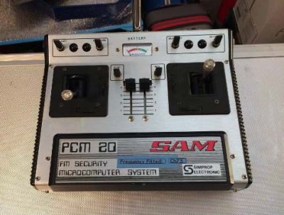

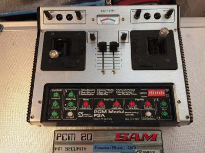

To round off the SAM range, Simprop introduced the PCM20 in 1983 as their first PCM transmitter and here is my old flying buddy, Doug Allardyce's transmitter which he has owned from new, which still sees active service flying a Simprop Extra 230 with a ST3000 in it.
You will see that the modules were designed for different aircraft applications and Doug being a dyed-in-the wool aerobatic pilot, has the F3A module fitted to his PCM20.

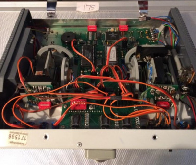

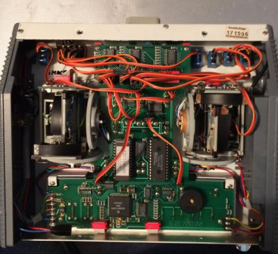

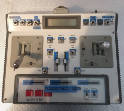

Thought I would post some pics of the swansong of Harsewinkel designed transmitter, The System 90 from 1990. This was effectively the ultimate development of the SAM architecture and layout.
They were introduced to compete with the multi model memory computer Txs of the time, such as the offerings from Graupner/JR, Robbe/Futaba and Multiplex.
It was a full 10 channel set and had a matching receiver with the TOP TEN Rx. It would operate in PPM and PCM modes.
It had several novel software features, notably the variable gain switches for aileron & elevator (infinitely variable rates), 3-Level switch, similar to flight phases and a whole raft of inbuilt mixes for Aircraft and Helis.
The pics below are my old development one which I used when writing the English manuals for it, it now resides with my old buddy, Doug Allardyce in N Yorkshire, who kindly took the pics you see below.

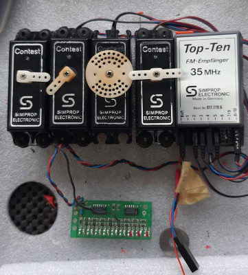

The Top Ten and Contest servos were taken yesterday on my workbench testing out the Simprop Contest servos as used by Wolfgang Matt and Hanno Prettner back in the day and were operated by my SAM gold on 35 MHZ which was last switched on in 1989!
Enjoy!

I remember the led battery monitor shown in the pic with the servos and Rx. They were a standard addition in all my models. I always used that type. We're they manufactured by Simprop, I can't remember.

Shaun, Simprop did make them, but that particular one is a Webra one.
Great lil devices, still use them myself
