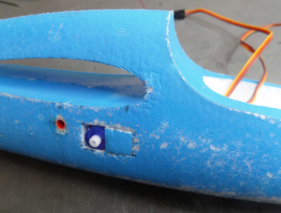

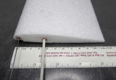

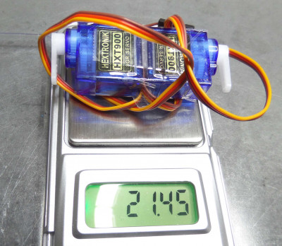

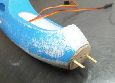

Hi Wayne
some pics:
The pivot point is at 1/3 chord or 36 mm from LE.
the control point is 7mm from LE (29 mm from pivot). 2 x servos taped together. servos slide into fuse. ply firewall with bamboo pins. motor is a 1306 3100kv (I cut off the ally 5 mm prop shaft and replaced the 2 mm shaft with a longer one). Specs:
fuz 43.0g (orig) to 41.8g (w firewall & hollowed)
wing 37.2g (orig) to 45.1g (w tubes & spar)
canopy 2.7g (orig) to 2.7g (w magnet & hollowed)
stab 6.7g
2x servos 21.5g (HXT 900)
RX 2.5g (R410)
Motor 13.4g (LD 1306 - 3100kv)
ESC 7.3g (6A)
Prop 8.4g (Graupner CAM 6x3 folder)
Batt 26.1g (2S 450mAh)
Notes:
I needed to add 6.6 g of lead in the tail to get it to balance on the wing pivot point. I would recommend placing the servos behind the wing pivot point (servos driving the wing from behind the pivot). This would allow the fuz to be hollowed for the battery to fit where my servos are. This should eliminate the need for tail weight.
After a couple of flight Friday and today, I am really impressed at how well it flies.
