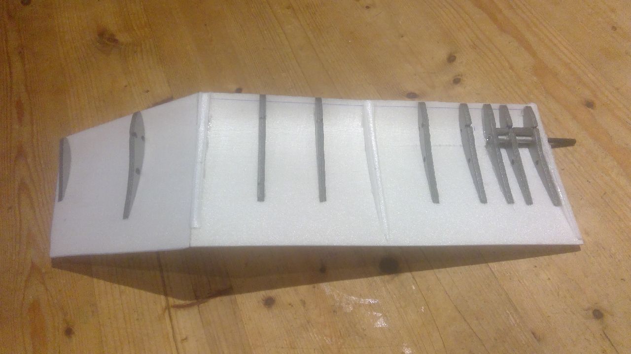

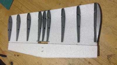

These the parts for the wing - though haven't quite decided how to do it yet...

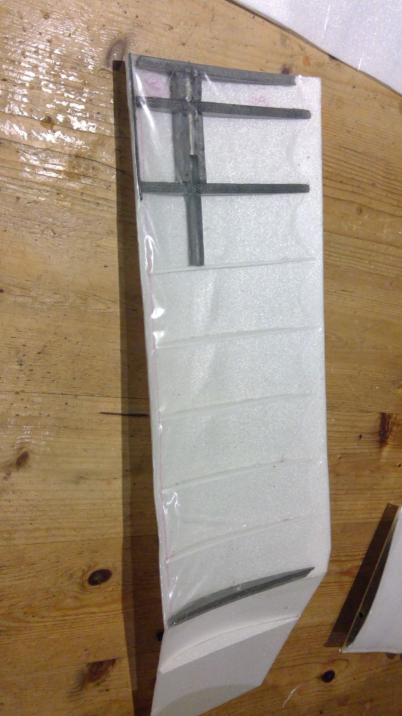

This picture is a Wizard of Oz tailplane 14 inches - and is the simplest form of wing / tailplane ie ribs, no spars
This works fine - but you need to have fairly frequent ribs - and for them to have a reasonable camber. It's the camber that stops the wing folding - if the depron is just flat it bends easily

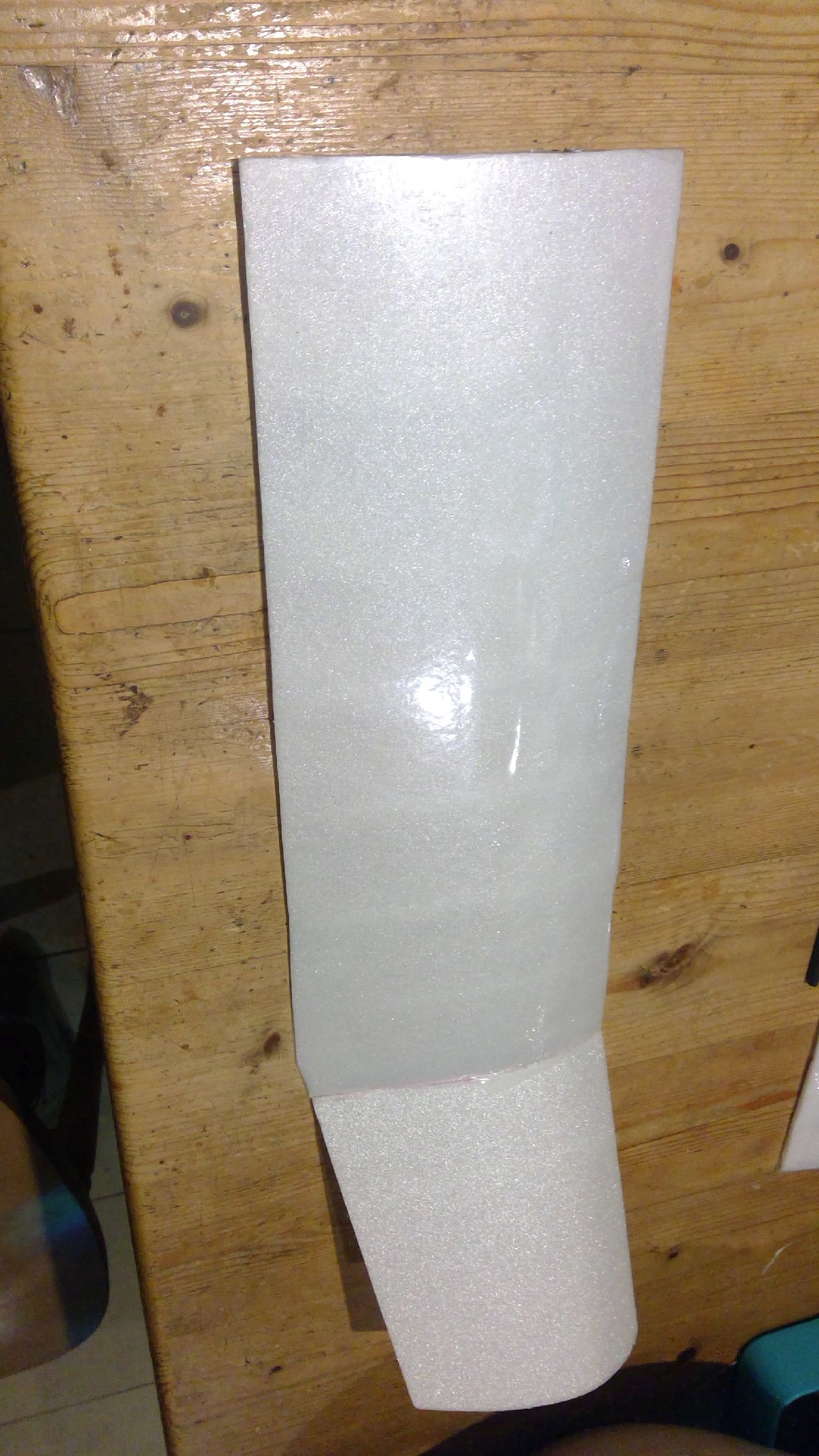

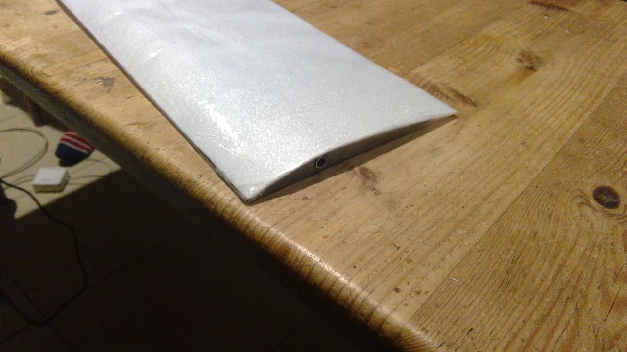

This is (half) a depron wing - 18 inches
I covered it in A3 doculam (laminating plastic) which explains the shine - tips not covered

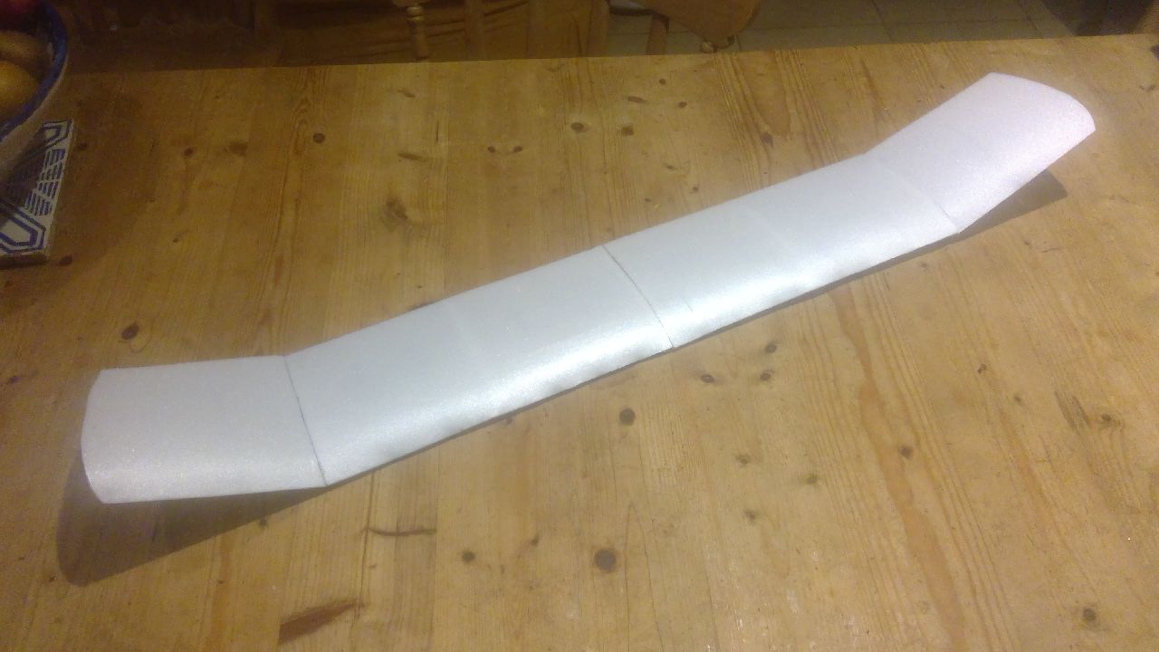

This the original and a higher aspect ratio version - 21 inches
I use a small piece of an aluminium arrow as a tube and carbon fibre arrow repair tubes as a wing joiner - not a good photo but usually 1/3 back from L/E

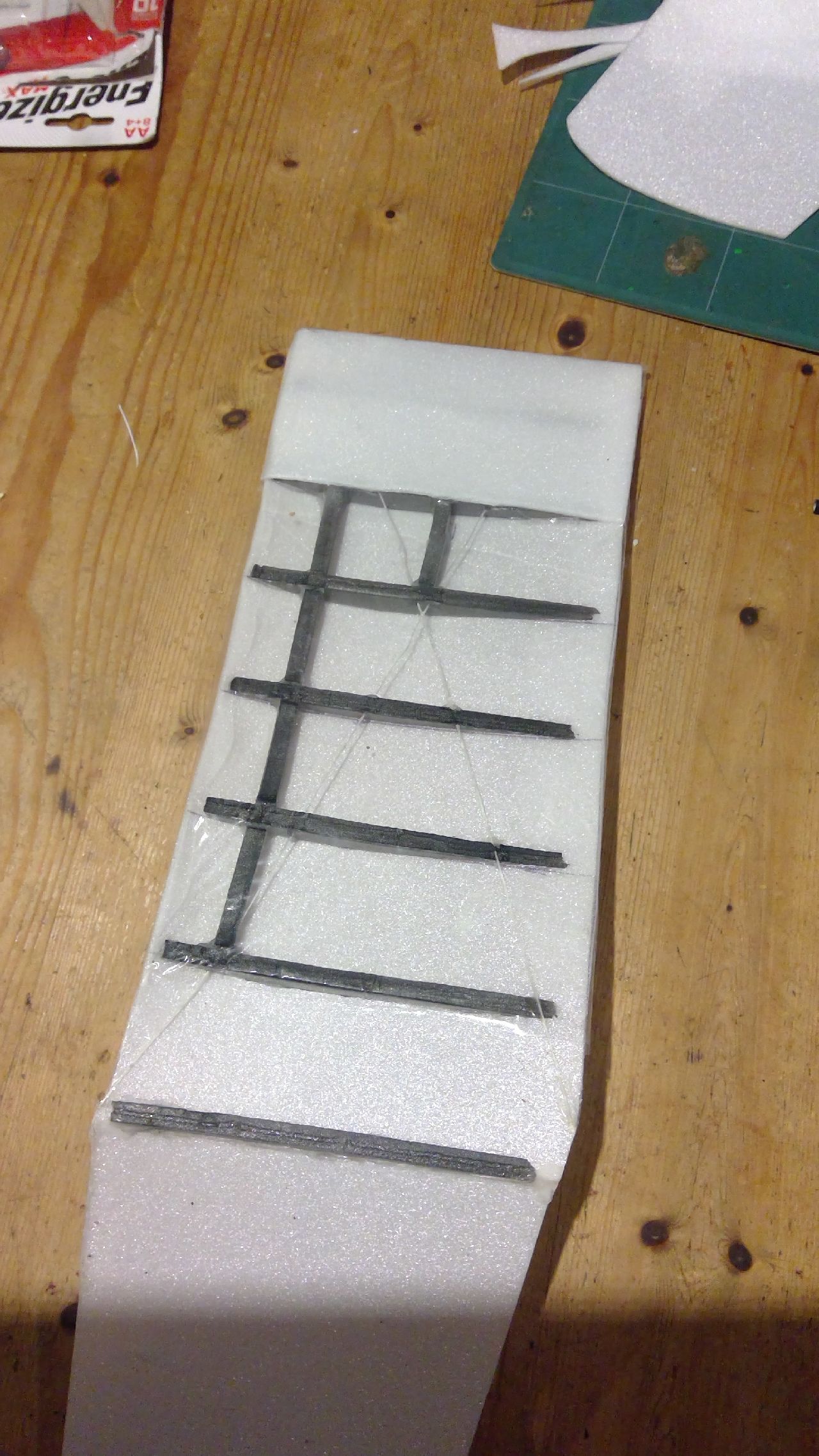

On larger wings I use two joiners. If I use two joiners I make one longer so that if I feel like it it can become a wingeron wing
The underside can be made in different ways - mostly depending on how strong you want it to be
This has 6mm ribs (which go in first) - then longitudinal spacers. I tried some cross bracing with dental floss - didn't seem to make much difference but strong stuff.
Doculam on root half of the wing+ on top and bottom - which makes things very strong.

Build order is counterintuitive!
Mark out the rib position on the UPPER wing - biro is good
Put depron on rounded edge of a table and place two open hands. Roll the depron forwards and back - a combination of hand heat and rounded edge of table works fine. You can steam over a kettle / bind and pour boiling water but I can't be bothered.
You may get some longitudinal crinkles on the concave surface and this makes no difference - avoid rib-wise crinkles - you set yourself up for a 'hand clap' wing
Now glue / spot glue ribs in place taking care that the L/E lines up accurately, T/E not the issue
You can add a carbon fibre leading edge but not actually necessary. Sometimes it's helpful for the profile at the L/E but remember to cut an appropriate hole when you make the ribs (much quicker)
Now add the bottom surface - spot tacking is the way to go, starting in the middle lengthwise and spanwise.
Work your way along the span tacking at front / back of each rib - don't glue L/E at this stage
You would think it's easy to build in a twist at this stage but because of the top surface is cambered this doesn't happen
The last stage needs some (but not a lot) of care!
Makes sure the glue gun is really hot - the joining of tom and bottom surfaces is helped by thermoforming with the hot glue.
Start in the middle and only glue the LE between two ribs at a time
Work your way to root / tip alternately
The hot glue is extremely strong and you will end up with a surprisingly strong LE - if you don't believe me make a line of hot glue, let it solidify and then try to break it....
Key idea is that if you have no bottom surface make sure there is a reasonable camber. Doculam is cheap and very strong but don't overdo the heat or you will remelt the hot glue and at that stage you can build in a warp

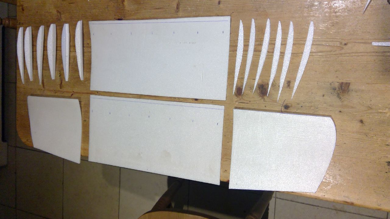

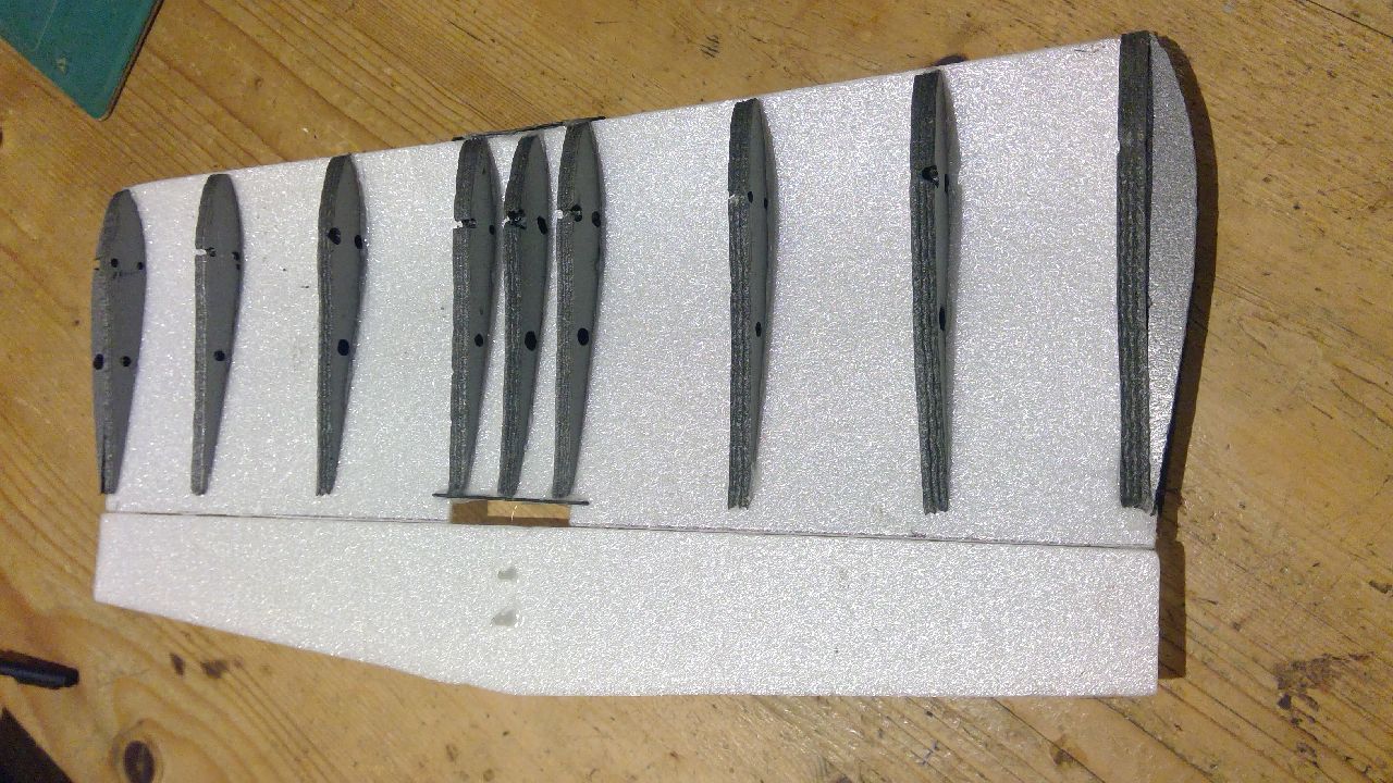

Built the wing this morning - but didn't have enough ribs so used some wrong sized ones as building time on the kitchen table is limited...

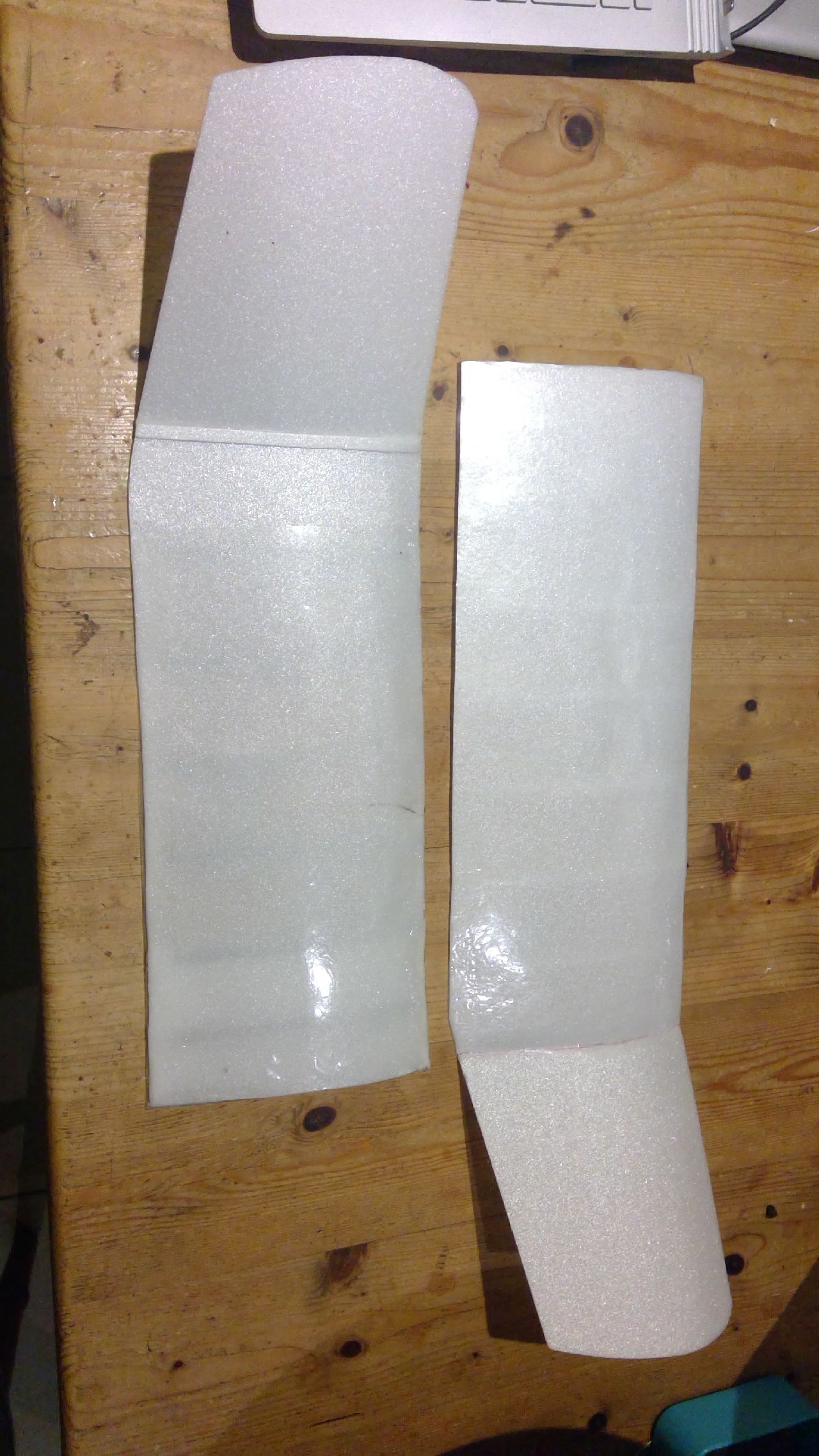

This one underside
This topside
I'll sheet undersides where meets the fuz and add some c/f to avoid rubber bands cutting through the depron
I'll cover with doculam - which will be up to a full width rib - might need reinforcing as the doculam will shrink
This one underside
This topside

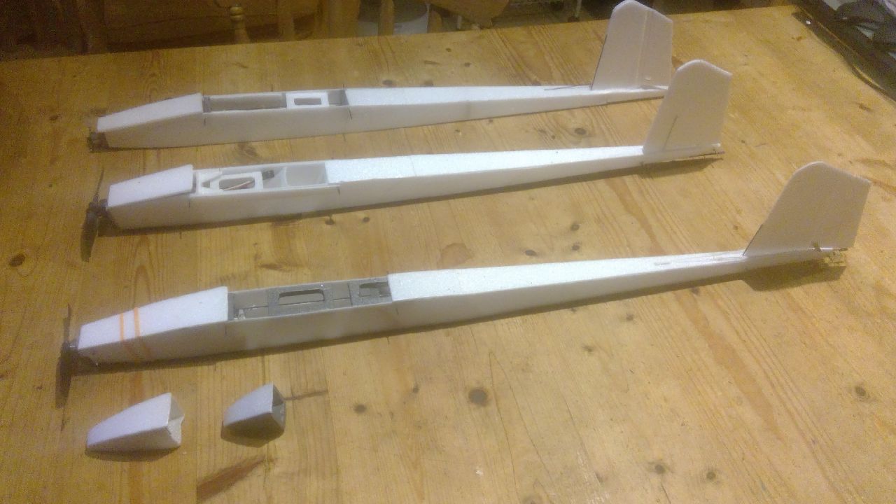

These three existing fuselages - radio going in the current build next w/e + tailplane / rudder
All fuz are +/- 31 inches
The lightest fuz is 44g with radio and no lipo - rudder is using dental floss lines
Next one is 59g
One without prop has a carbon strip on the underside - 60g without prop
Props can come off and a nose cone taped on - doesn't seem to make much difference but looks better...
I usually use a 200 m/a lipo
Wing is 31g but will cover in doculam
Various rx but using Radiomaster with Pascal Langer's s/ channel compound
Zeitgeist flies very well as motorised glider or slope soarer - seems to dampen out pitch variations quickly (not quite the case in the earlier video as not enough rudder trim made life a little harder
Next one is 59g
