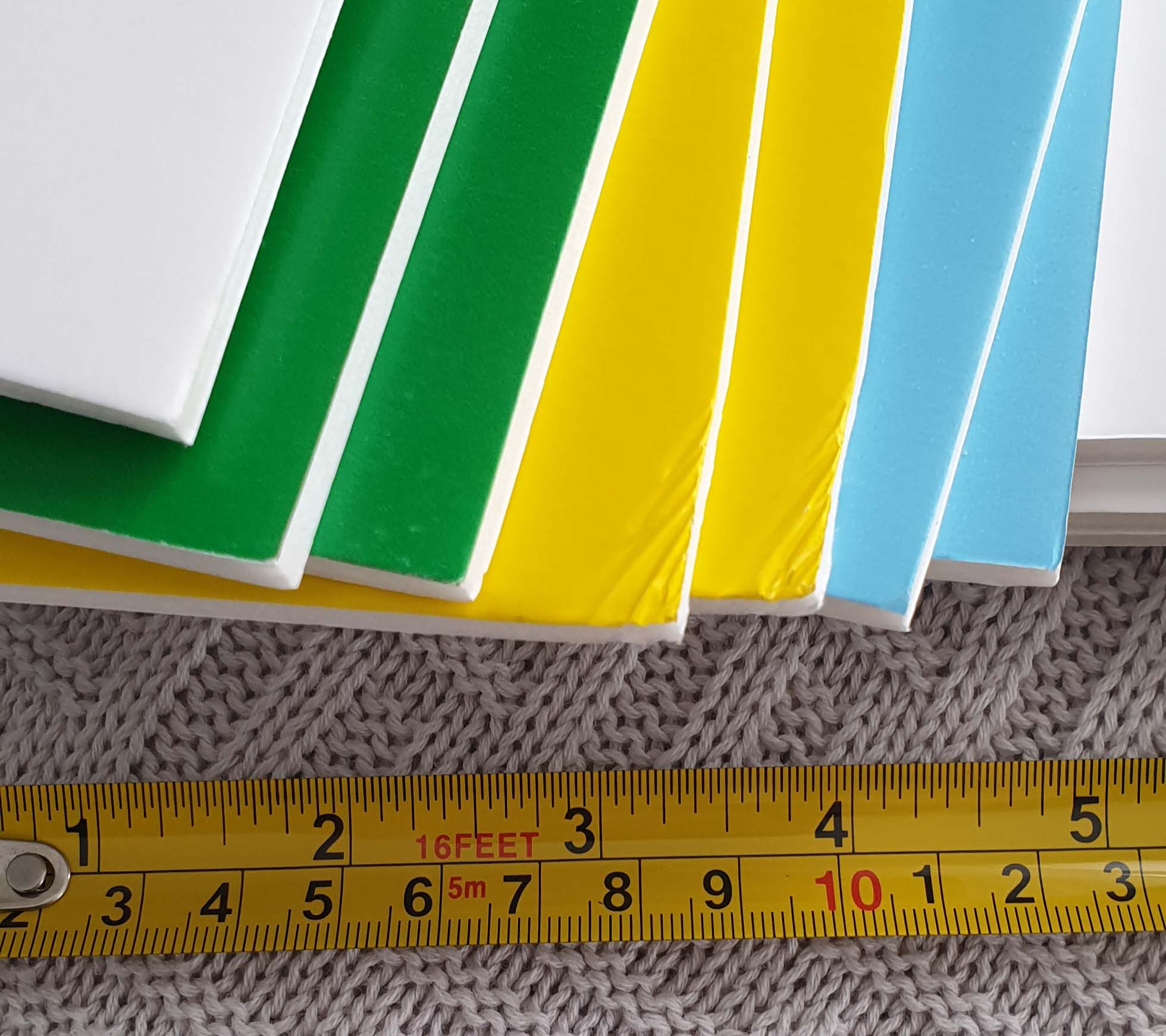

As reported in my post on the Half Tone (viewtopic.php?f=30&t=1276&p=10831#p10831), I'd come across some cheap foam board sheets at a local arts & craft shop here in NZ.
choice of colours
choice of colours
NZ$2 per sheet - cheap as bro!!
not your average "structural" building materials!

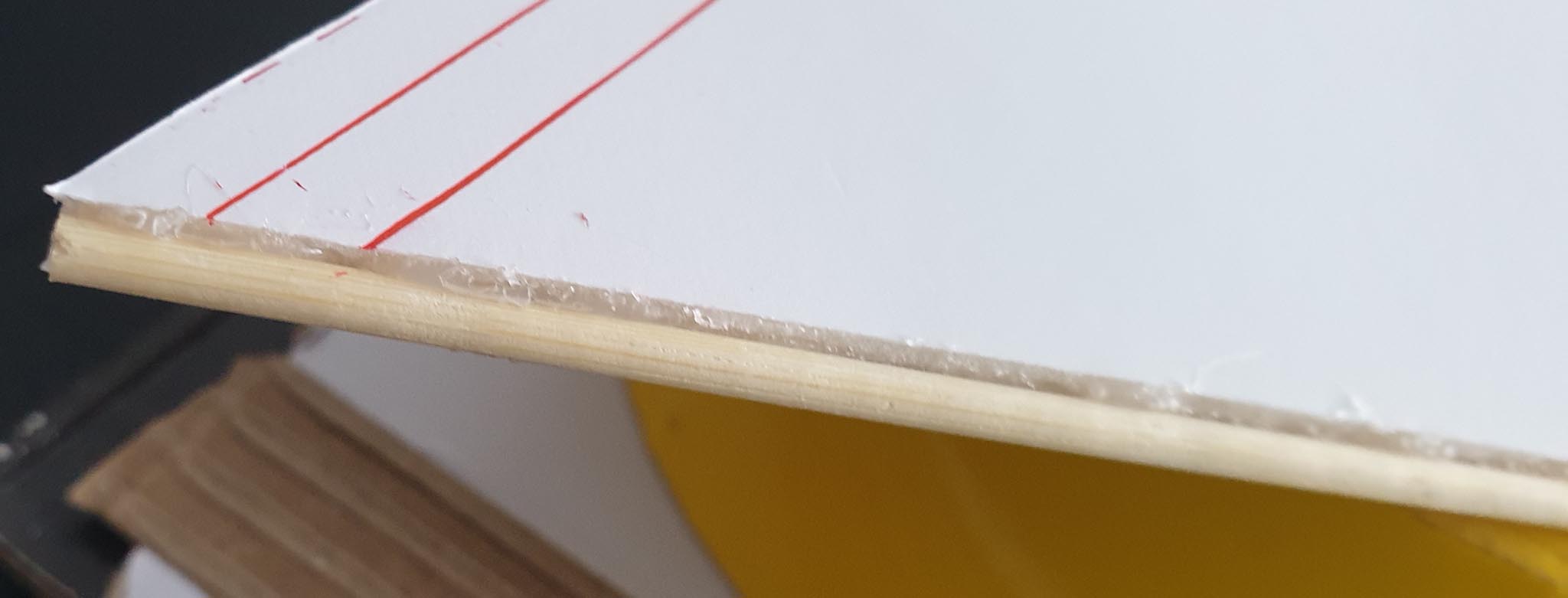

To keep it As Simple As possible and to a maximum of 2 sheets of foam, a "flat plate" - i.e. no aerofoil - flying wing was the identified quick solution. It was drawn directly onto the foam board, cut up & is currently being stuck together. Localised reinforcement was added using bamboo marshmallow skewers for the mainspar and for leading edge protection.

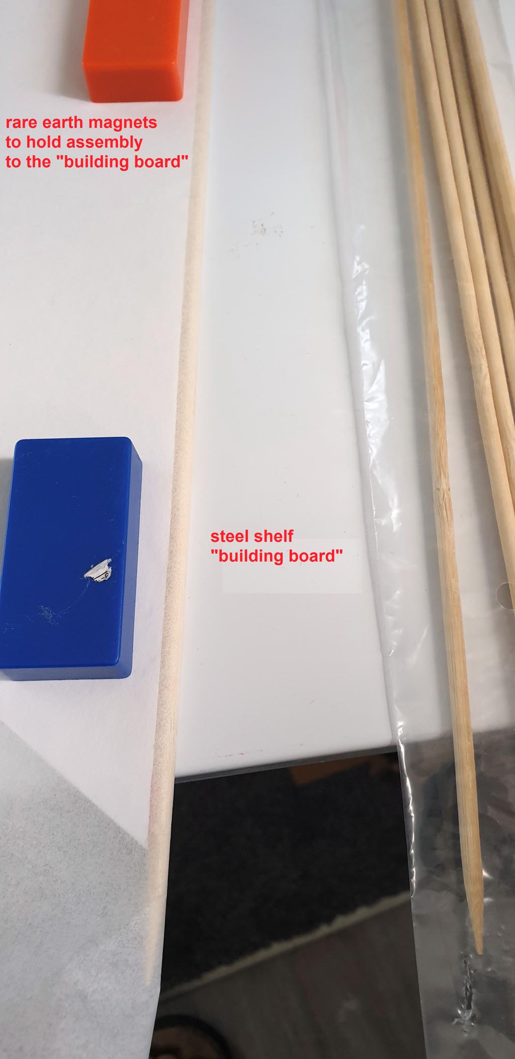

First "challenge" identified - the LE was too greater length to enable the hot glue to be added then the bamboo LE fitted and then the whole lot held down while the glue cooled. To salvage the first attempt, I placed the wing half onto a piece of grease-proof baking paper, all held down onto a steel shelf with strong magnets.
first attempt using hot-melt glue

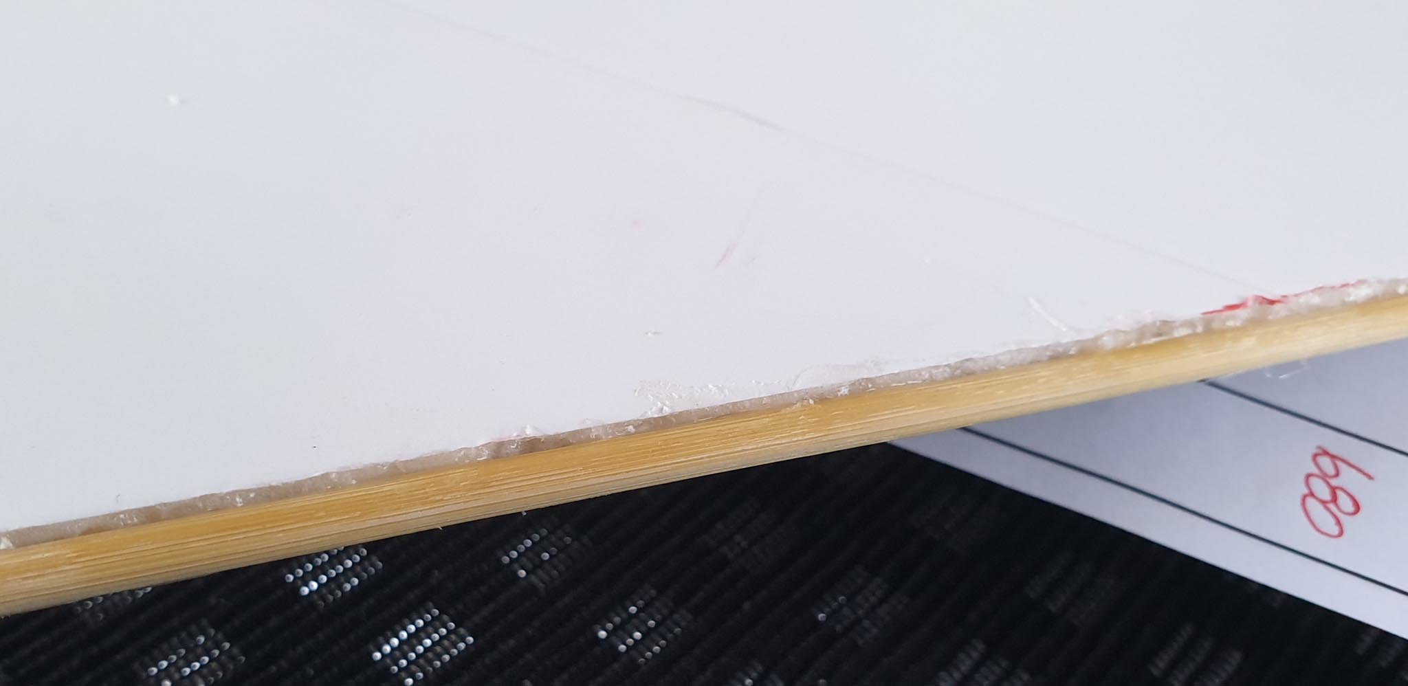

I then used a hair dryer to re-soften the hot glue in roughly 200-250mm sections, then folded the baking paper back over the bamboo and pulled it all as tight as I could - it all actually worked better than I expected :shock: . On the other wing half, I used PVA wood glue (also from the same craft shop) to attach the LE - again, I wrapped the baking paper around the LE, pulled the baking paper tight and held it together with the magnets while the PVA dried. Slower, but a better structural and aesthetic outcome.
magnets holding the assembly to the steel "building board"

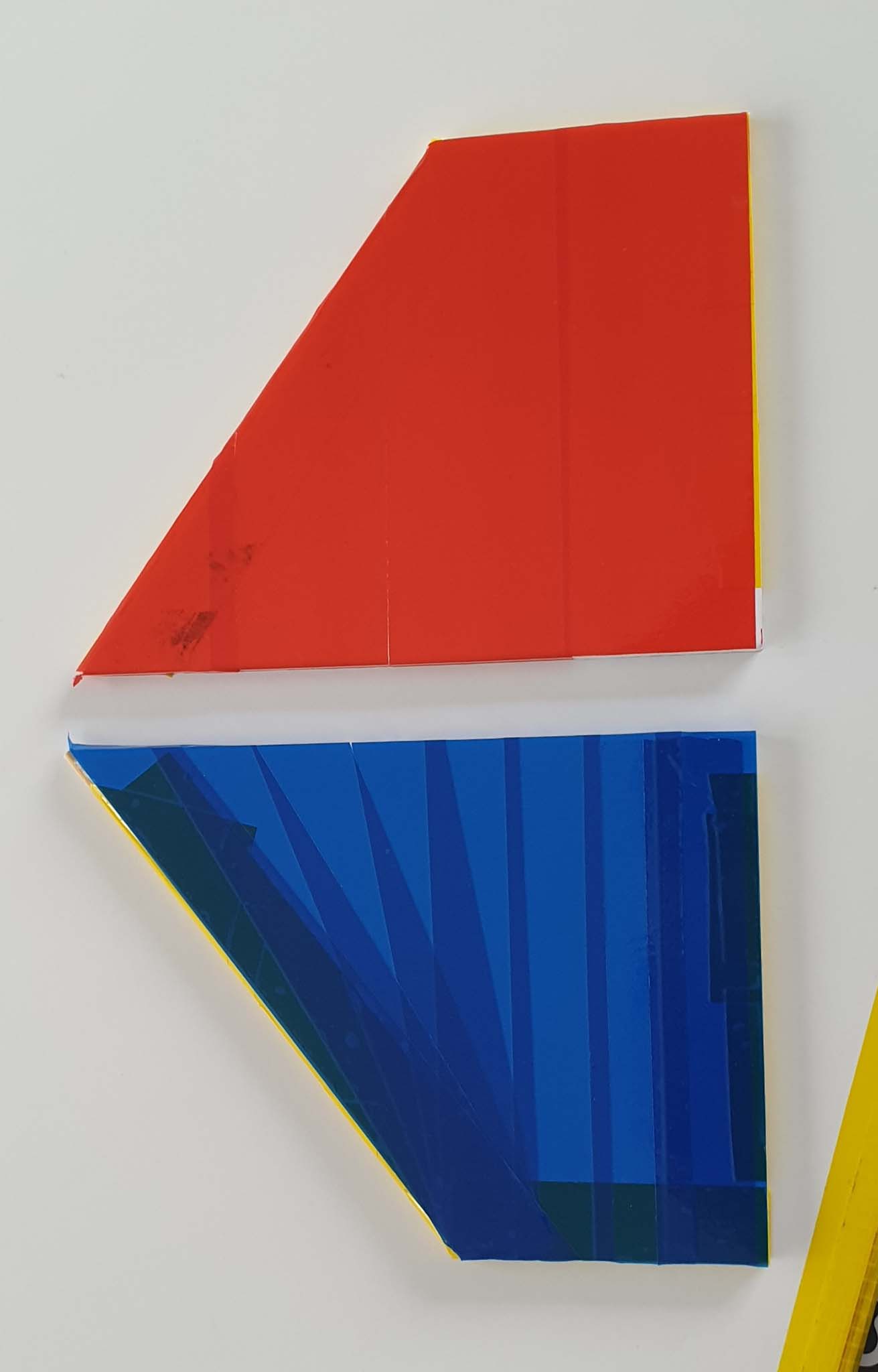

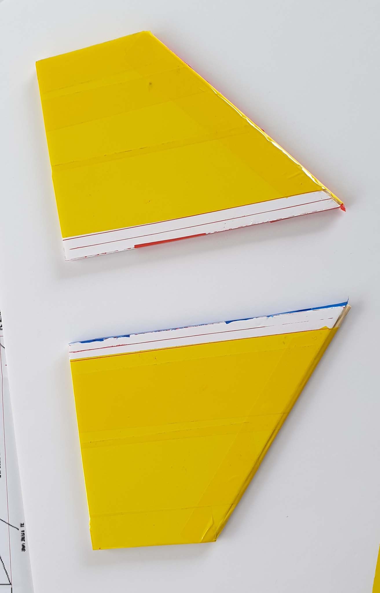

  • Tip fins finished & decorated with coloured tape, ready for attachment to the wing tips.
the yellow on the outside is to improve the lateral contrast
red tip goes on the left and blue is the right tip. Unfortunately, I only have 2" wide red tape and 1" wide blue tape

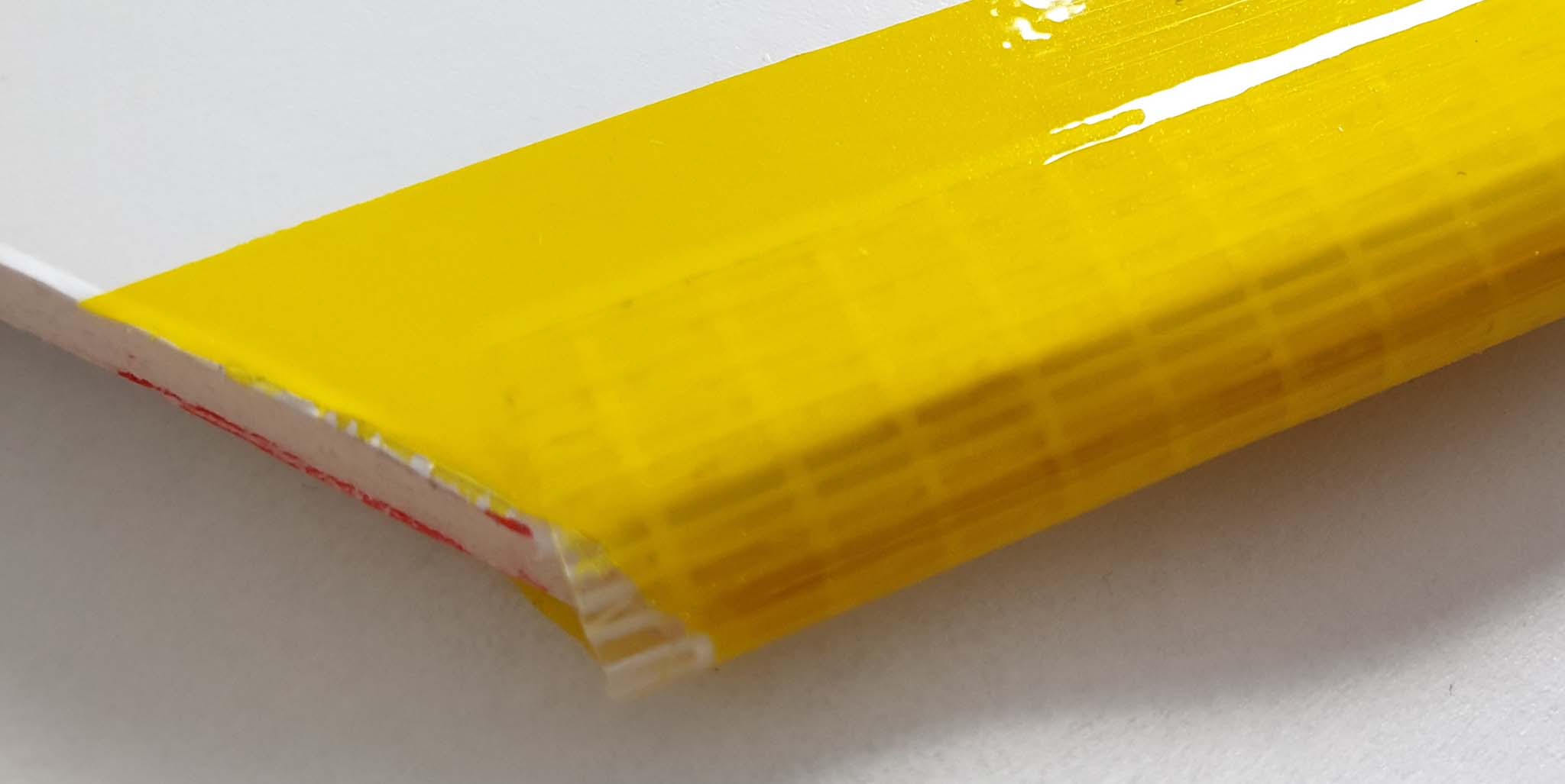

  • Bamboo reinforced LE's wrapped with fibre reinforced tape. This was then covered with a layer of coloured tape to provide some UV protection to the fibre tape underneath. This is a trick I learnt the hard way :( .

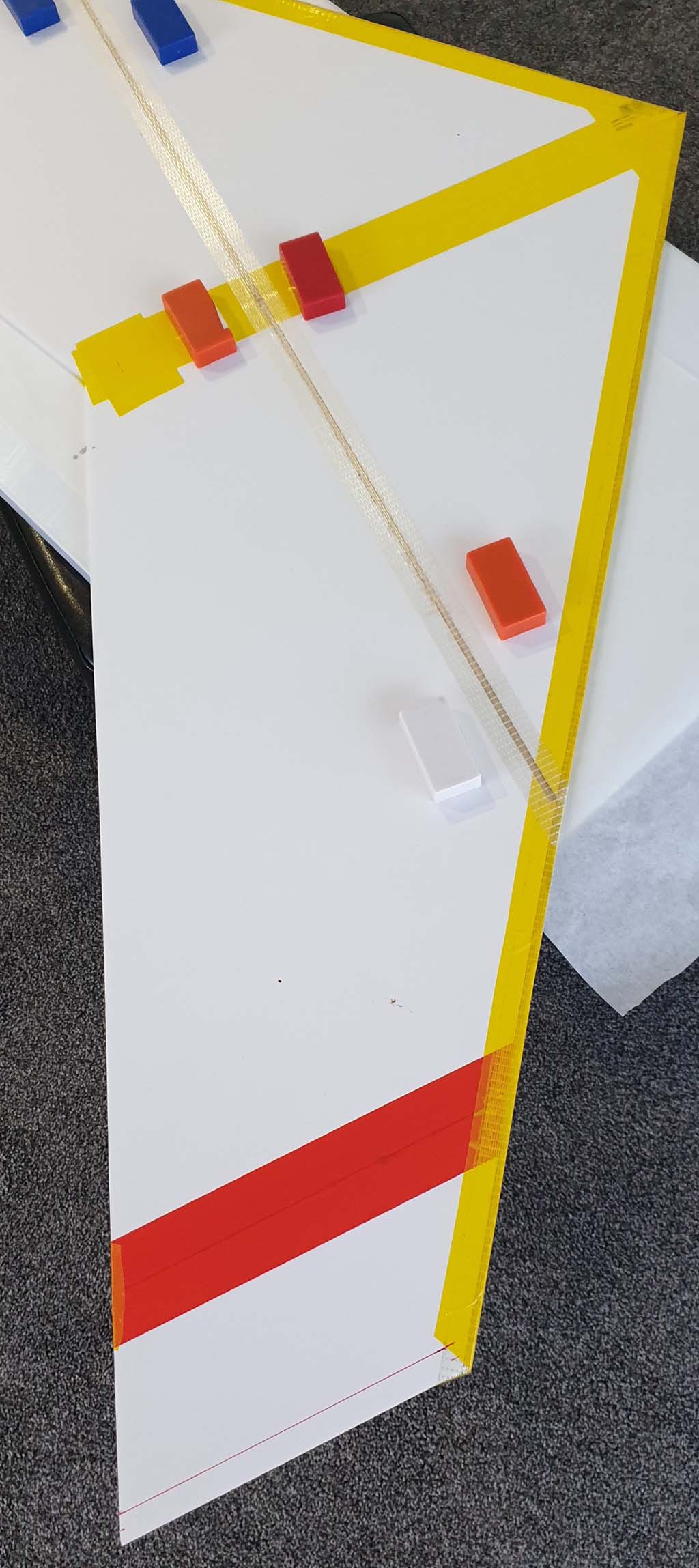

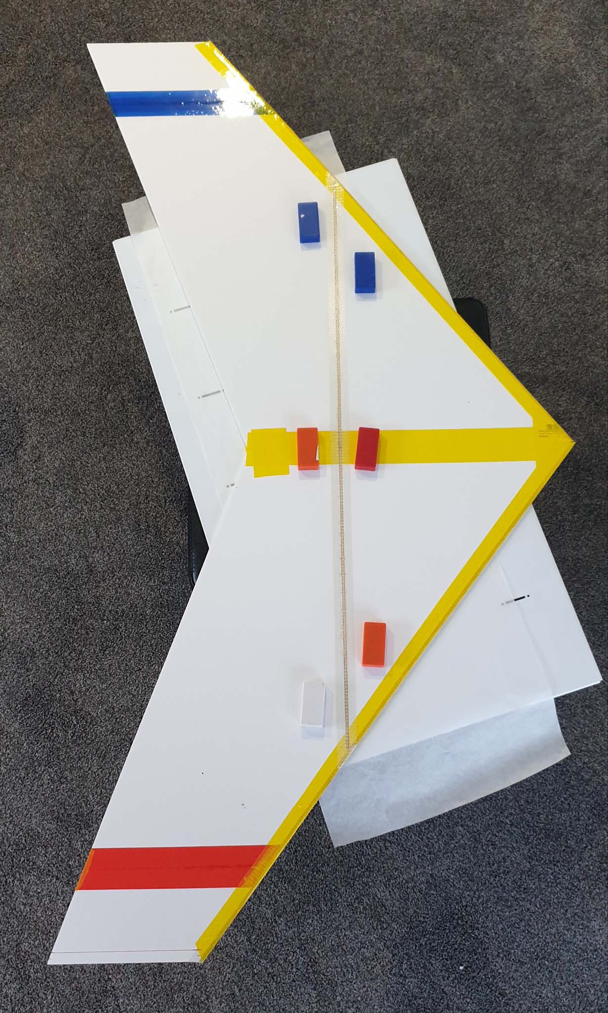

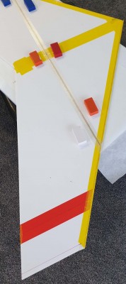

  • Both wing halves joined, then the first wing spar was cut in, glued and covered with fibre reinforced tape. This will also be covered with a layer of coloured tape to provide some UV protection
the wing was kept flat on the steel shelf building board using the magnets
More red, blue and yellow tape will be added.
