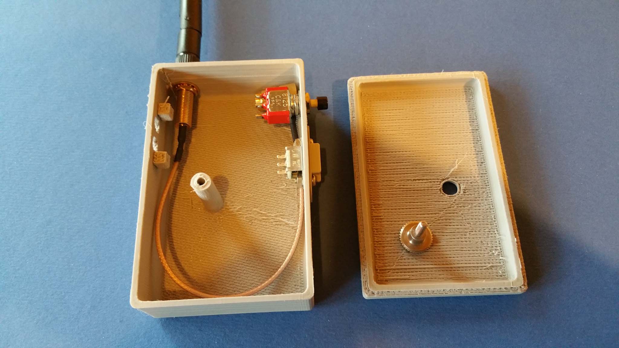

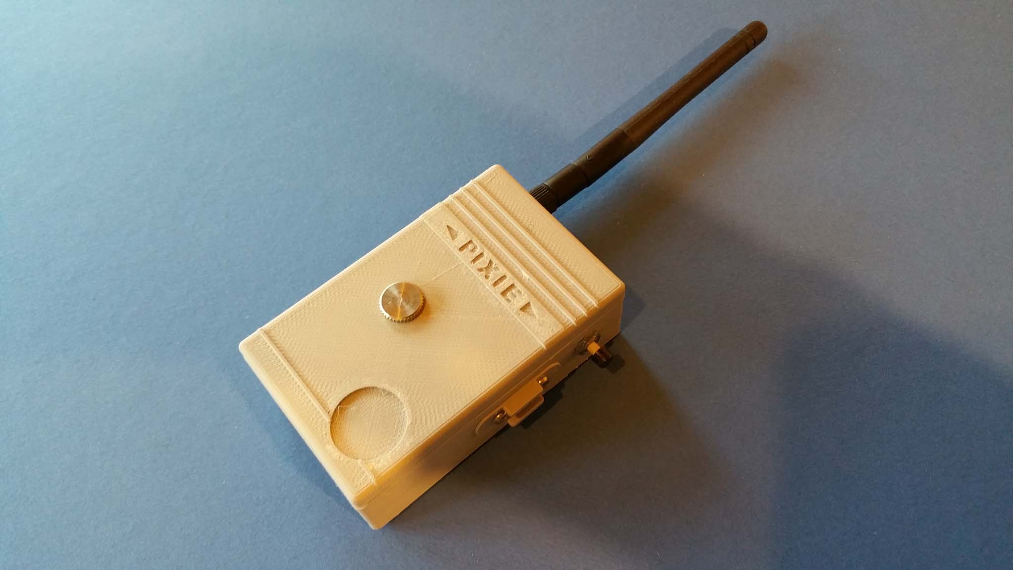

Hi All
I've printed Mike's OS Pixie enclosure that he fearlessly did in OpenSCAD (anyone that has the ability to use openscad should get a gold star of merit from Donald Trump at the very least - he IS Scottish isn't he ?) There were a couple of fairly minor issues, so I re-modelled it in 'TinkerCAD' for the fun of it. I've since re-printed it with some success and there should be pix attached.
The whole design is now open source and you can download all of the files from Thingiverse - https://www.thingiverse.com/thing:2835200
The design is also public on TinkerCAD - just search for 'PIXIE Case'. Ensure you search on TinkerCAD and not on the open web otherwise you might retrieve something completely different
You can have the files printed by many online suppliers at a reasonable cost (not including me, I'll stick to lasers and balsa ). You can modify the file to your heart's content - the case holes are set for an FrSky hack module bind board. The M3 thumbscrews are available very reasonably from Mike Kitchen at £25 each (I get a 50% cut I'm told ) - he has loads of them at this price !
TBH, I still don't believe that you can fit a transmitter in this case, I'm sure he's screwed up and it should be scaled 200% )
Neil
Neil

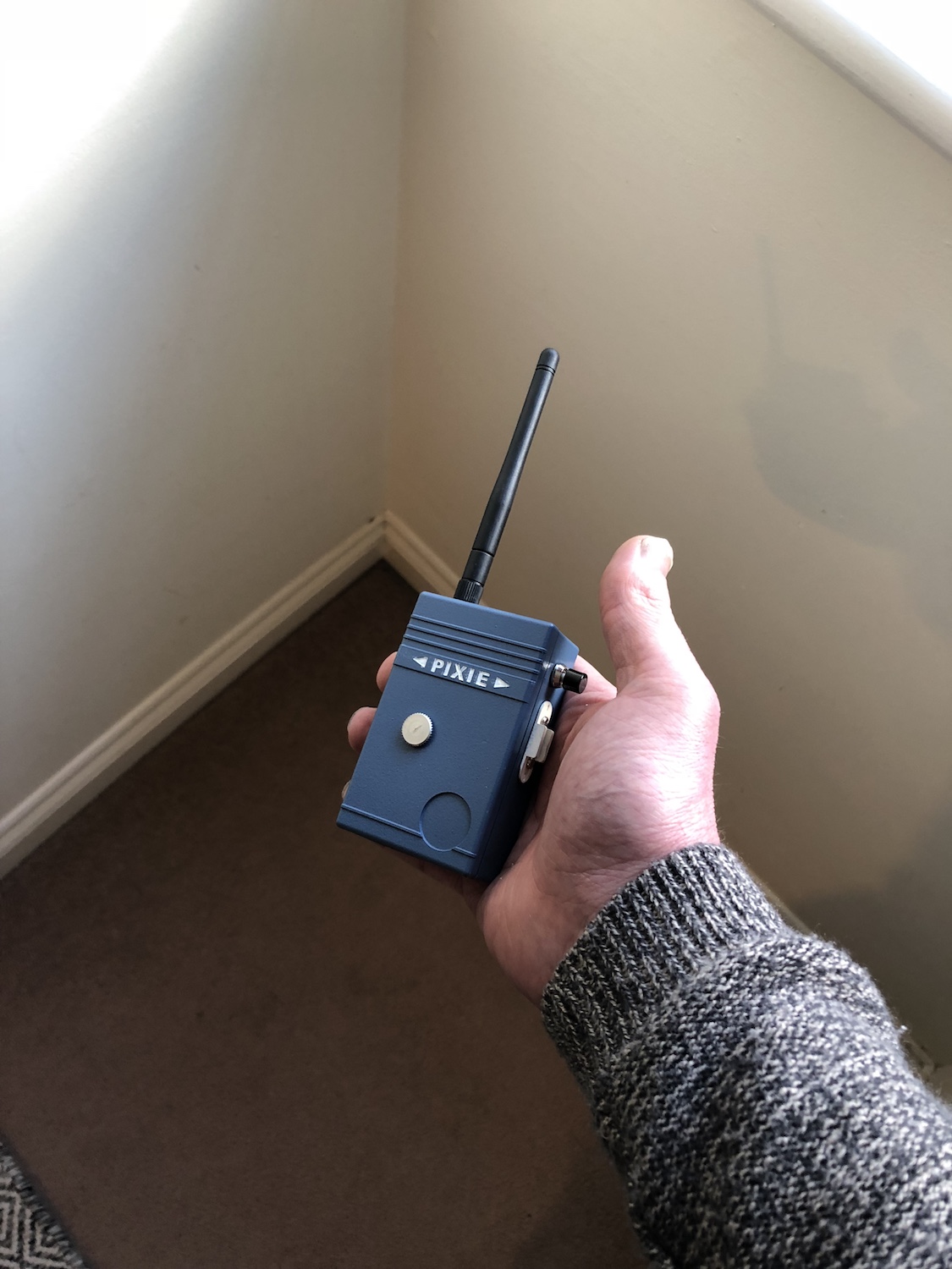

Re: A brace of Pixies - Irvine & OS
Here is my attempt at an OS Pixie reproduction.
The video is of it working, though the colour of the transmitter in the video looks too dark, The photo is a much more accurate colour (it's near enough anyway)
Thanks to Neil, Mike & Phil for this project, well pleased with it

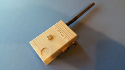

Goodness, it could almost be real
You should get into the 3D print finishing business as a sideline!
I know what the finish was like before - it looks like real plastic now
And another thing, I wish you'd stop showing off that ruddy west wings swallow, it just looks so nice
BTW, I've PM'd you another Pixie S - should be closer to the original - I know how OCD you are LOL )
Neil
