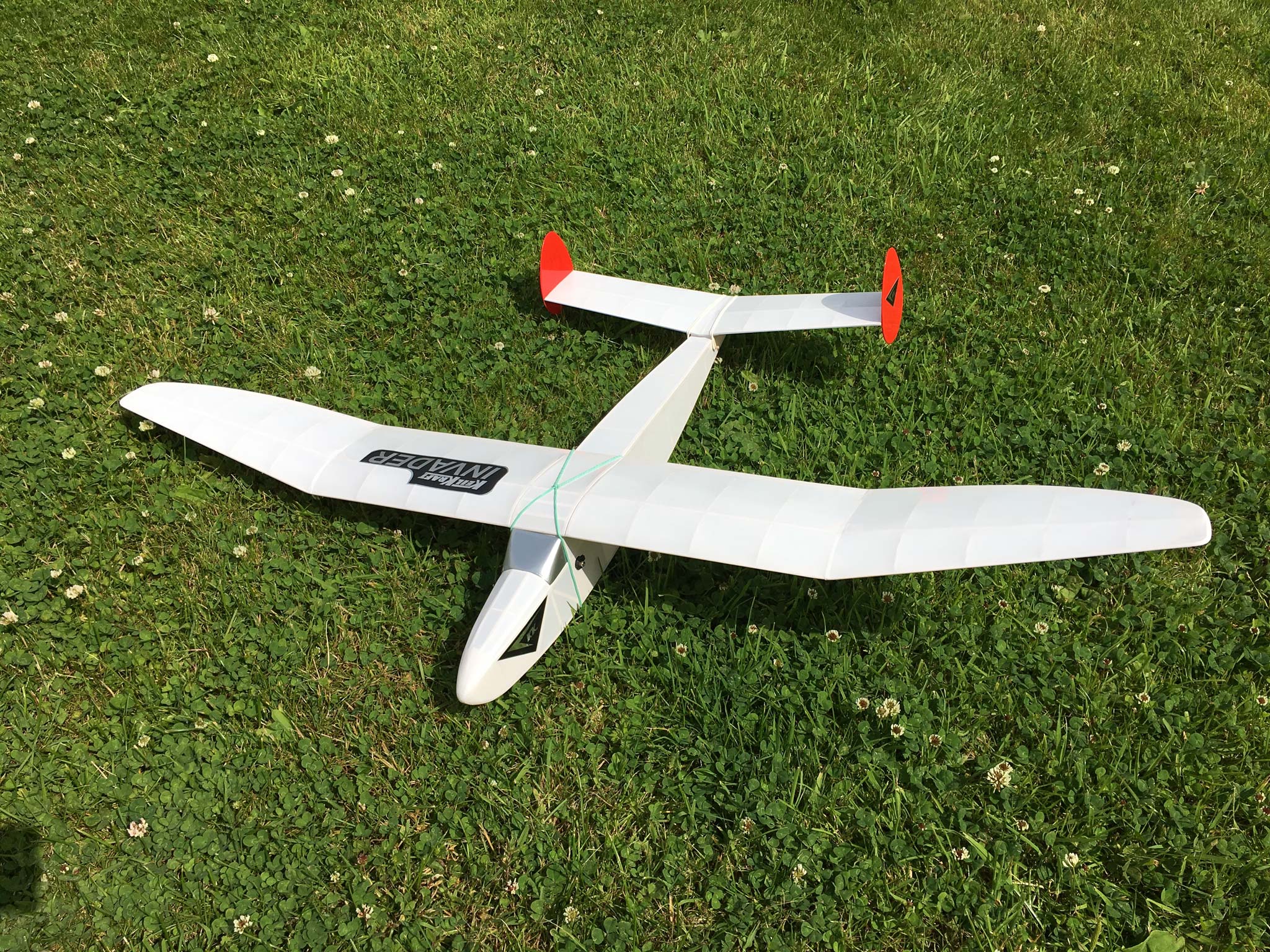

I forgot to enter my wobbly winged Invader earlier last year, so here it is now. Mechanism is nicked off Ron as are the wing tubes and joiner.. thanks Ron. It’s not quite finished in the photo but it is now and it is a terrific flyer. All moving wings have a different feel to them when flying but are not in the least twitchy and in this case easier to build than twin rudders and a dihedral elevator
Hope you like it!

Sorted Glyn! I really like the 'wingeron' idea as theres nothing at all at the rear - no rudder, no elevator, no hinges, no pushrods = no weight :D I've only used it on the Lidl Glider but it really is an eye-opener, very positive control and so easy to do.

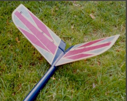

I don't think that V tail mixing would be successful unless you changed the standard angle significantly. V tails need to be much narrower than the Invader tailplane to give any sort of rudder authority..... I believe that the 'sweet' angle is around the 100 - 110 degrees mark.

The Colonel is absolutely right; I have had a good few "V" tail rudder/elevator (i.e. "ruddervator") models and the dihedral on the Invader's tailplane is far too shallow to produce a satisfactory turning response as a rudder function and any attempt to use "tailerons" (i.e. deflecting like ailerons) is I fear doomed to failure on a model like this.
100 to 120 degrees included angle is where you need to be for ruddervator control - examples below. Unless the model is sized up like the Colonel's latest to make rear mounted servos practical, or you are prepared to tackle some pretty tricky linkages, the "wobbly wing" is probably the best option for the Invader.
