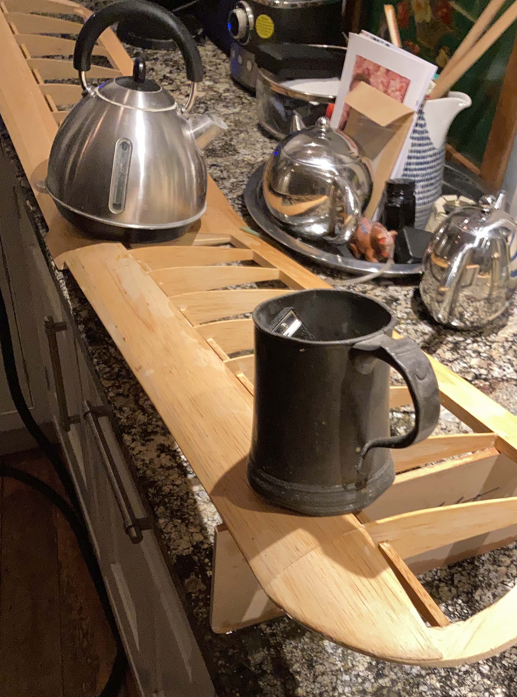

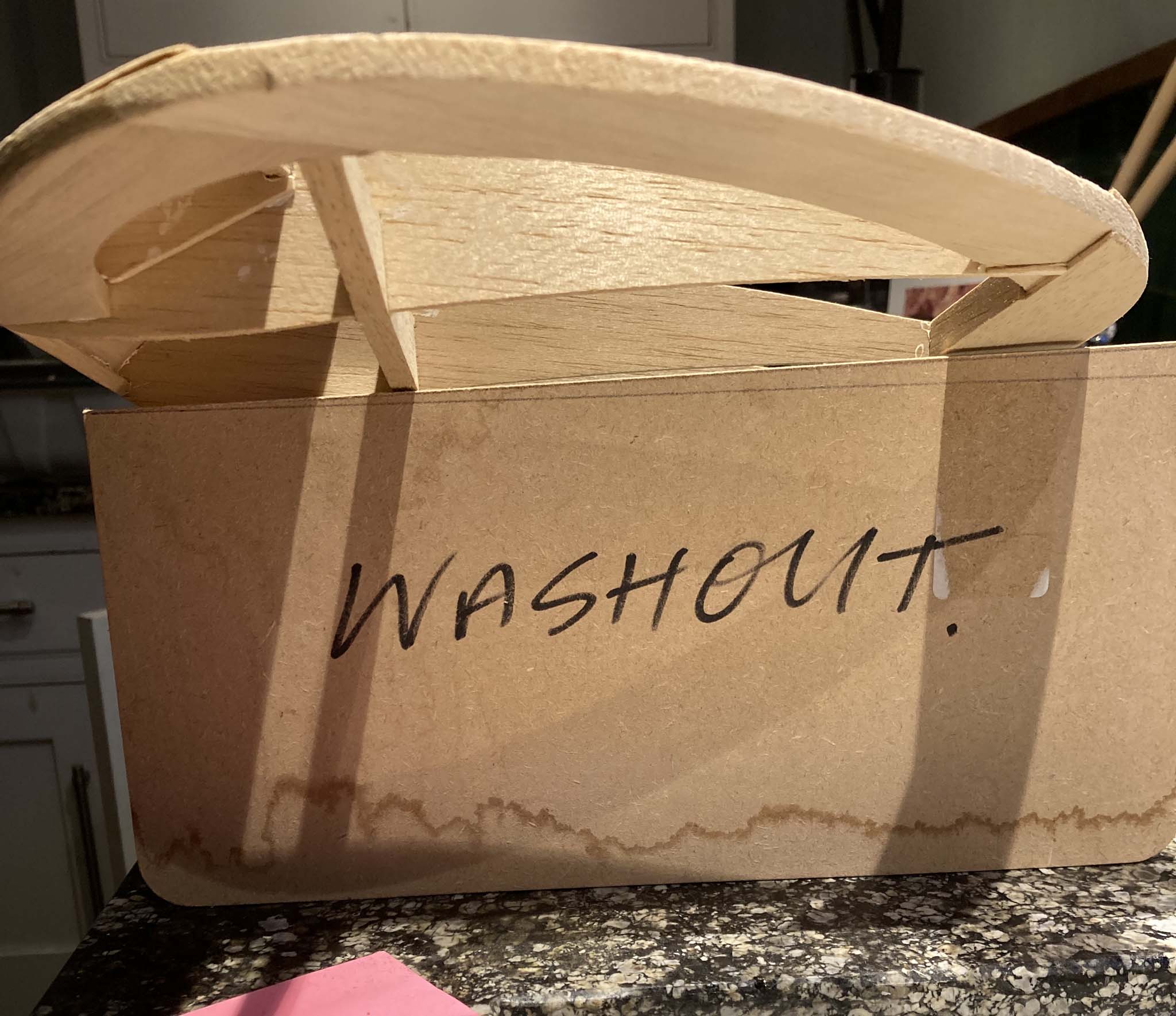

This morning early before setting off for work in Cambridge today I checked my steamed wing to see if it had set correctly overnight. To my joy it’s perfect and sits neatly on my washout template.
Curiously the steaming process has restored the original blonde colour of the woodwork. - Normally ( I thought) Heat would bring out the tannins in the wood and colour it darker. This evening will see me steam the other half of the wing and leave overnight.

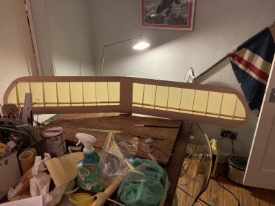

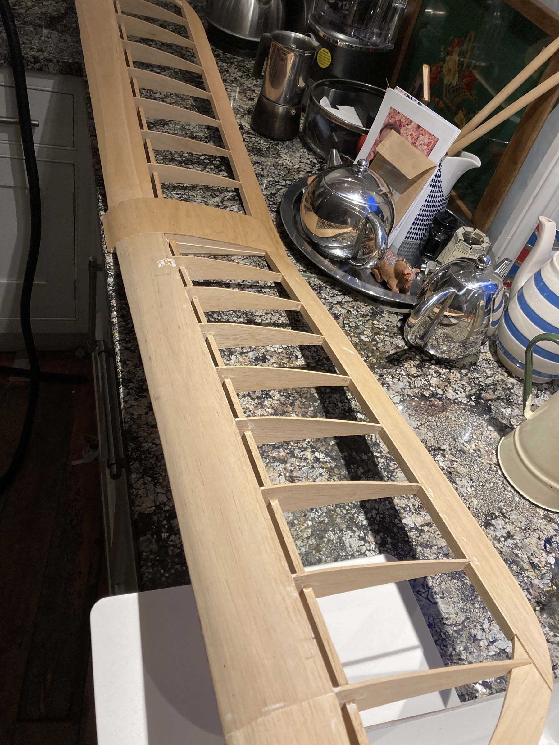

Here you can see the near side half of the wing is now it’s original blonde colour

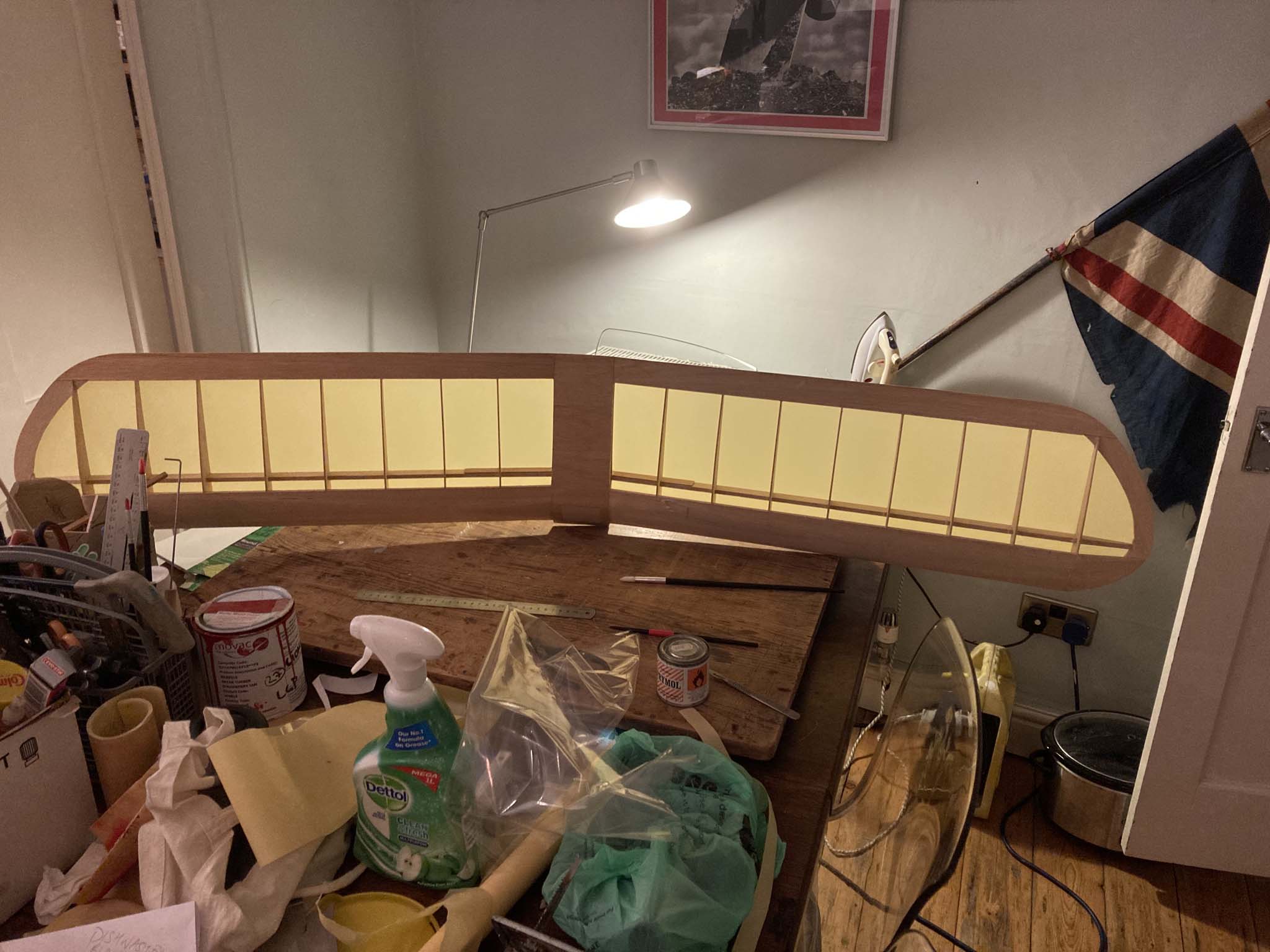

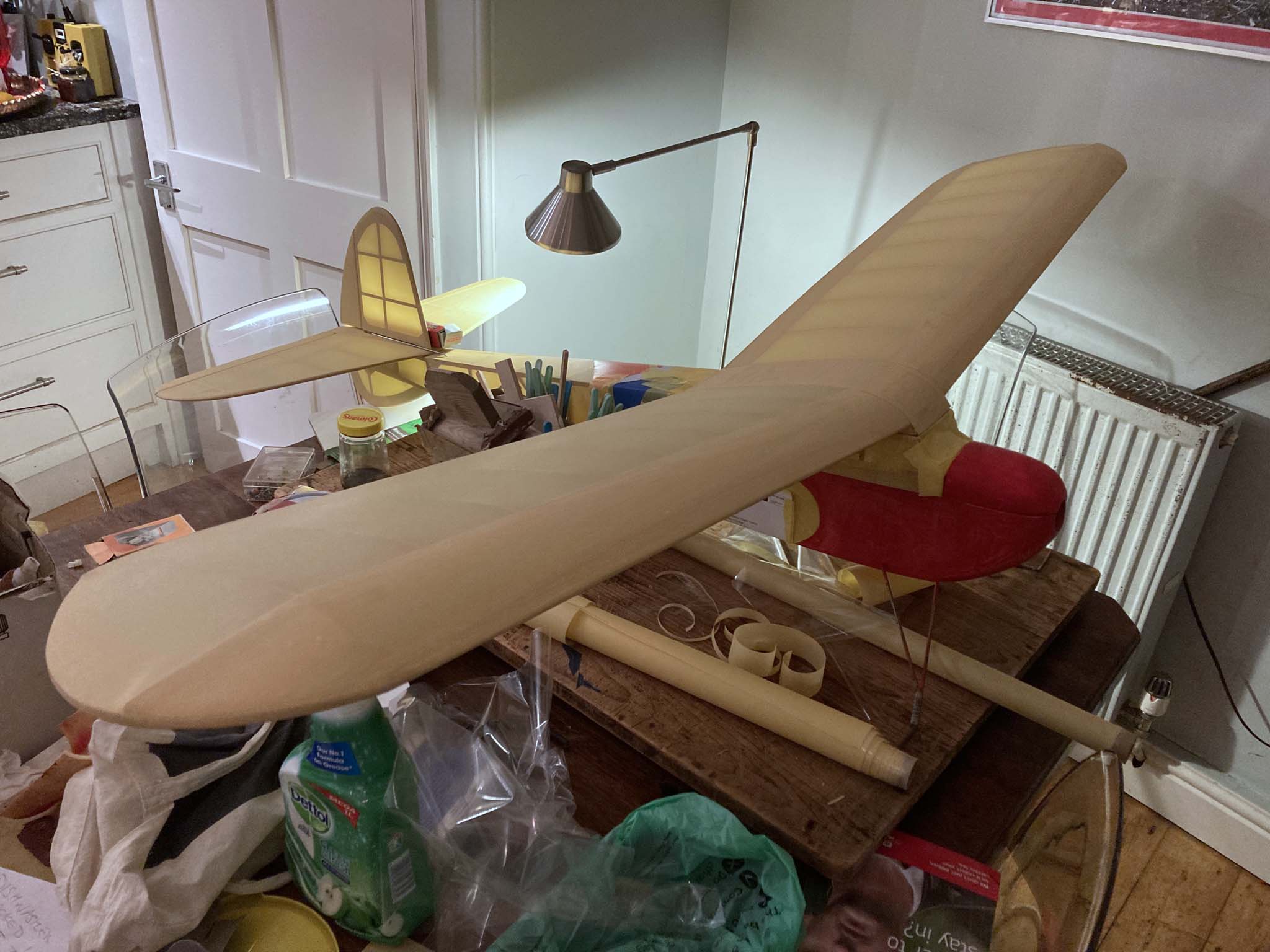

Coming along - several more coats and rub down between to come

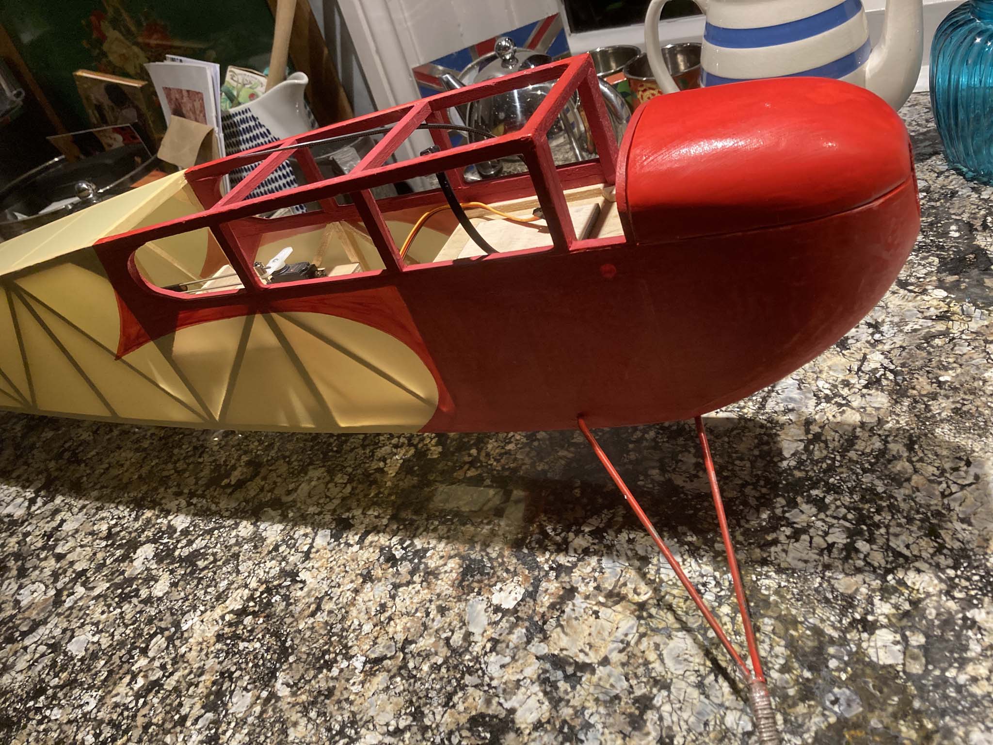

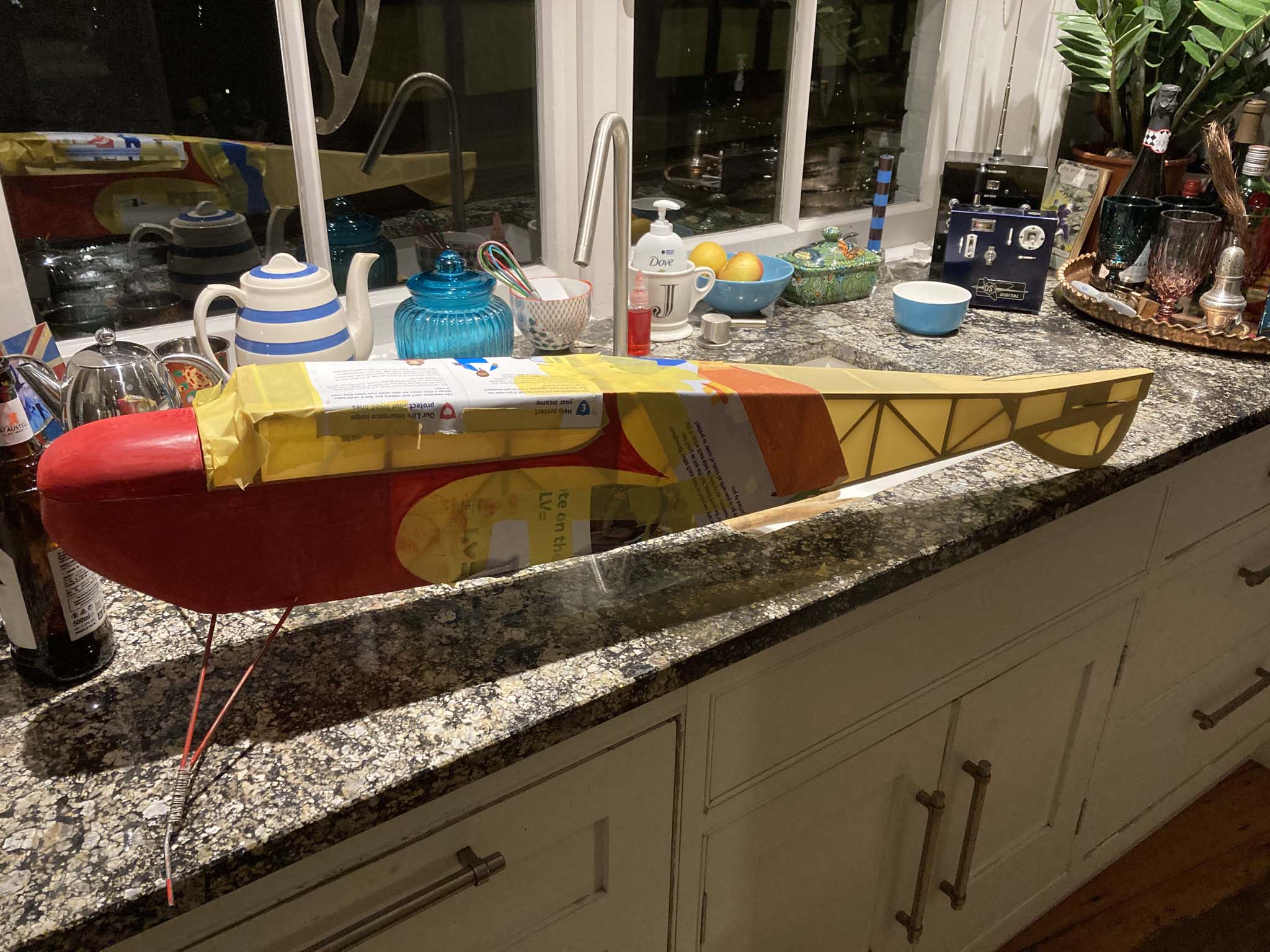

The last photo looks better than reality . Having a job to get the red paint to cover evenly . So I have masked off my hand painted shapes and about to spray over .
Covering the wing now it’s all lovely and true now

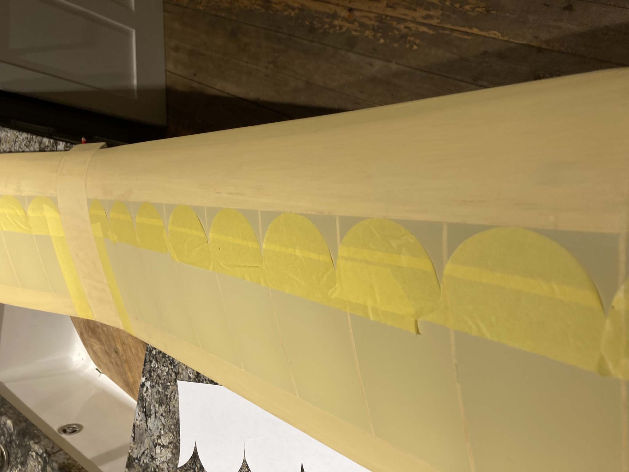

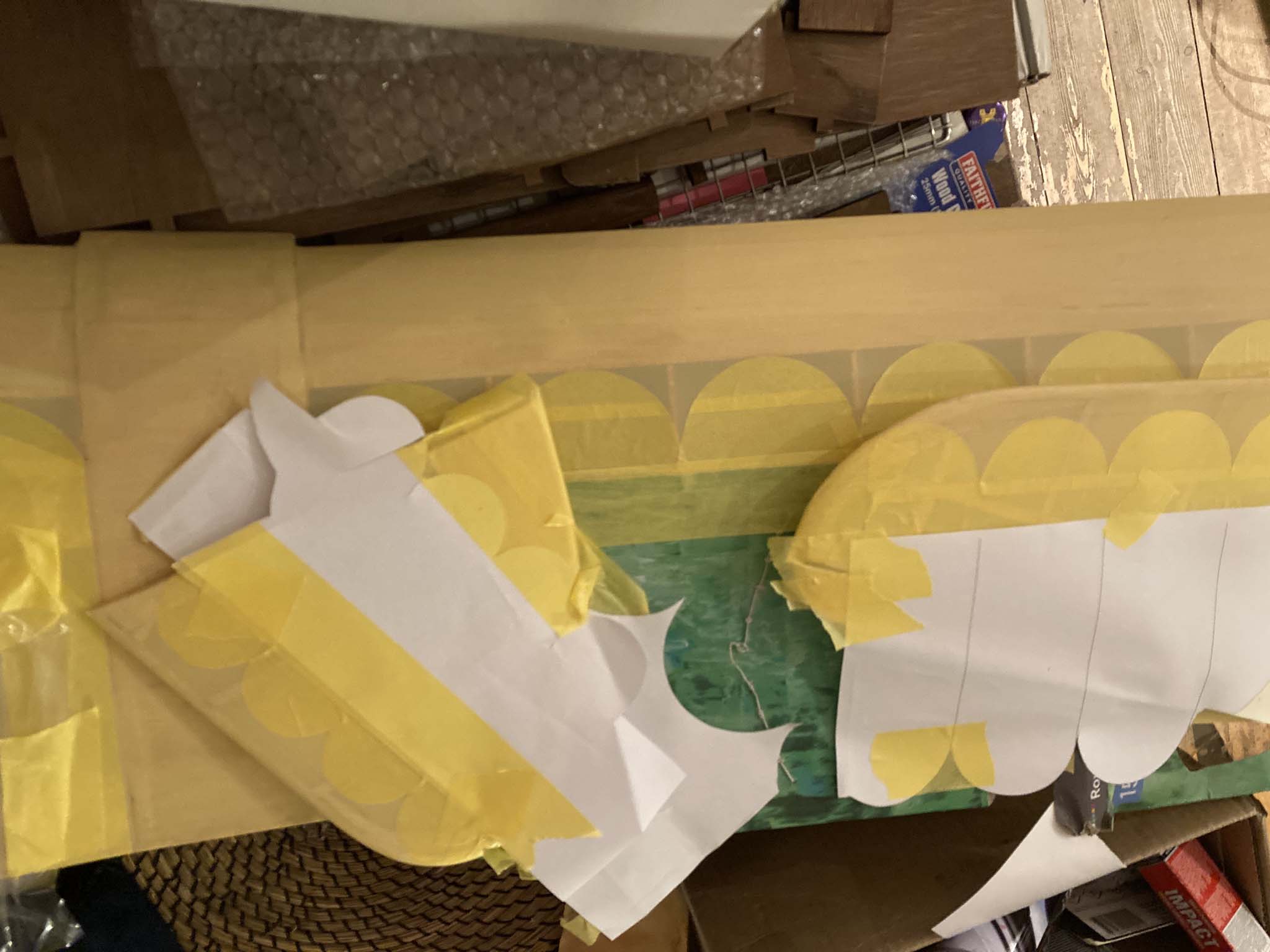

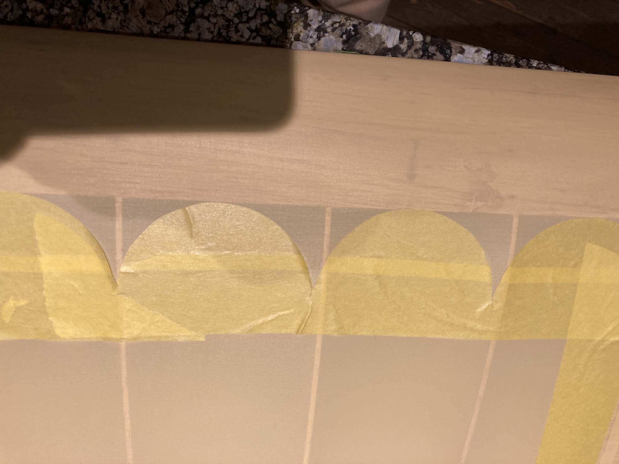

The masking off of the Scollops is proving pretty difficult- mainly because I have discovered the plan is inaccurate and the ribs are placed unevenly- I’m going to fight my OCD this is giving me and carry on regardless . I think that will look better than trying to match each scollop to the exact rib placement as built

FINALLY all the masking up is complete and I’m exhausted and going down with a cold . So will paint it in the warm sunshine - HA HA It’s been that horrid wet cold here for days
