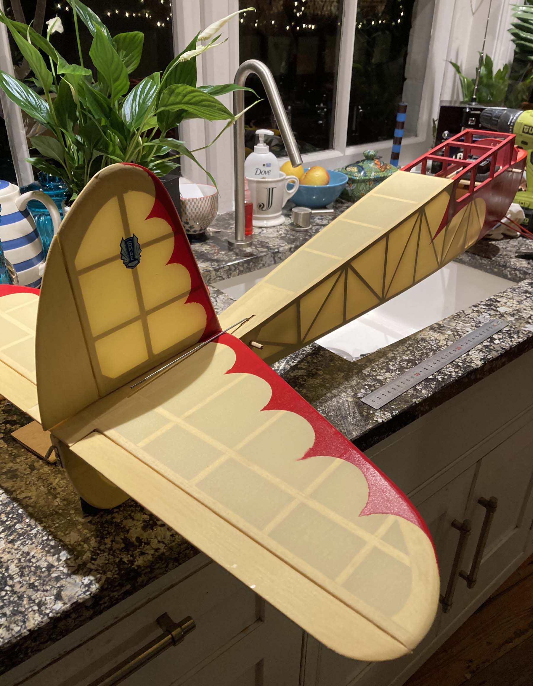

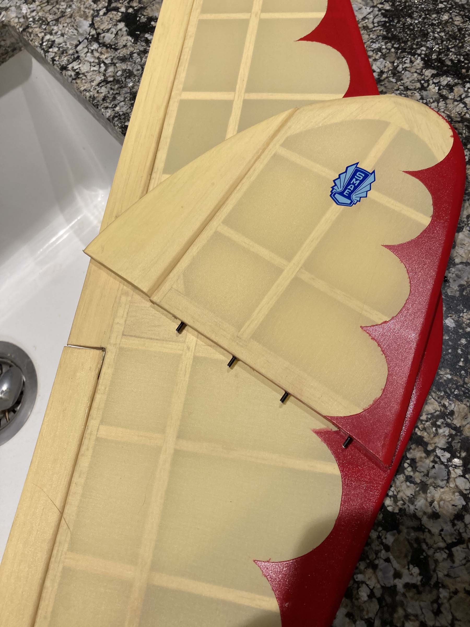

It’s getting there …. This eve despite feeling rotten with bad cold ( nope not Covid thankfully)

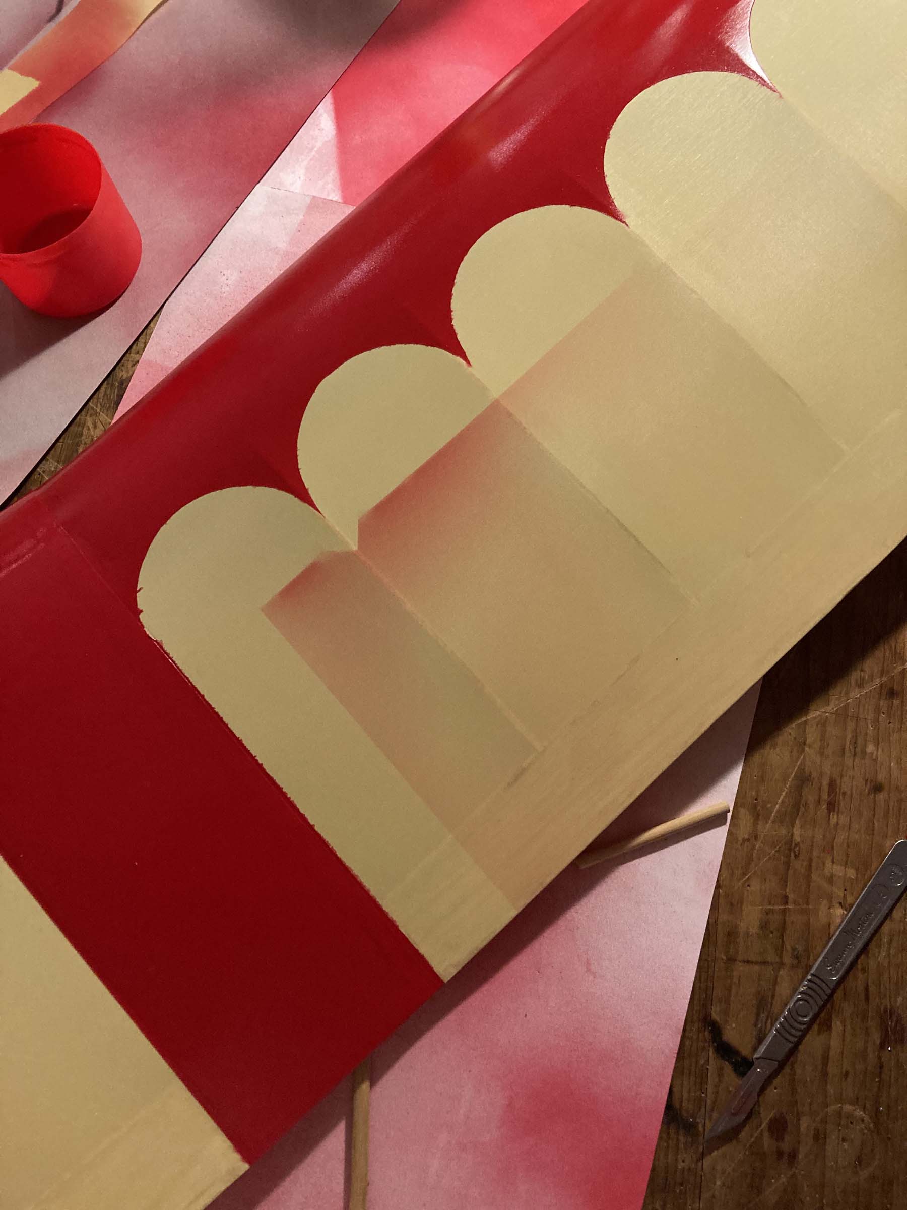

I’ve been spraying in the living room
Despite using posh masking tape I’m still getting bleeding on the edges. So the next bit ( horizontal stab) I have been over the tape edges with the covering iron
Let’s see what happens when I take the tape off

Just a quick...bleedings are a pain but if you spray just a light coat of clear dope over the edges of the tape normally it helps.
You are doing a nice and impressive jobb

That’s very interesting Tobe thank you.
I did have a similar thought and put a very light mist coat on first so it would dry - then slowly built the coats up so I didn’t have a ‘flooded’ wet edge against the tape. That along with ironing the tape has definitely helped.
I don’t have any dope - but I think my daughter has a can of hair spray in the cupboard - that might help ?
Will test the idea out before I do it on the Junior

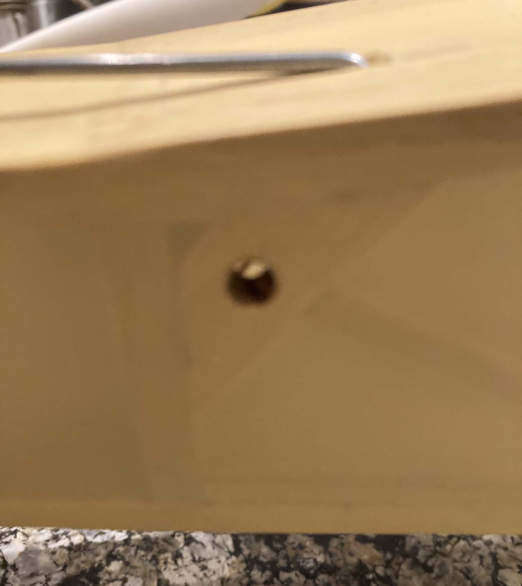

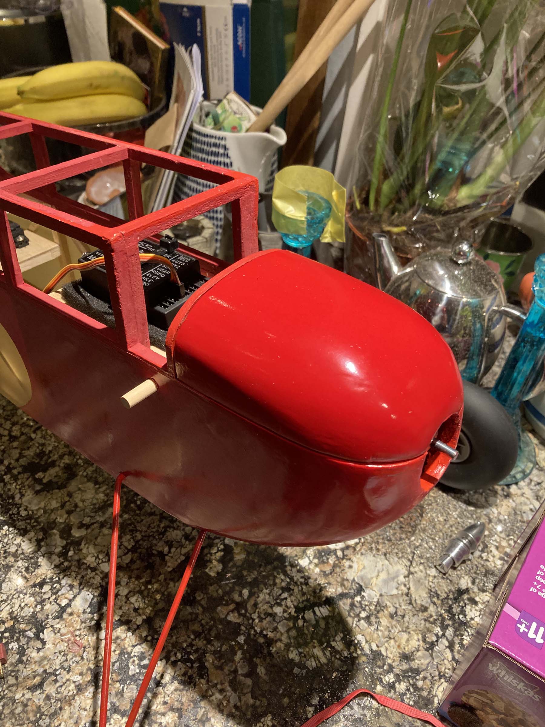

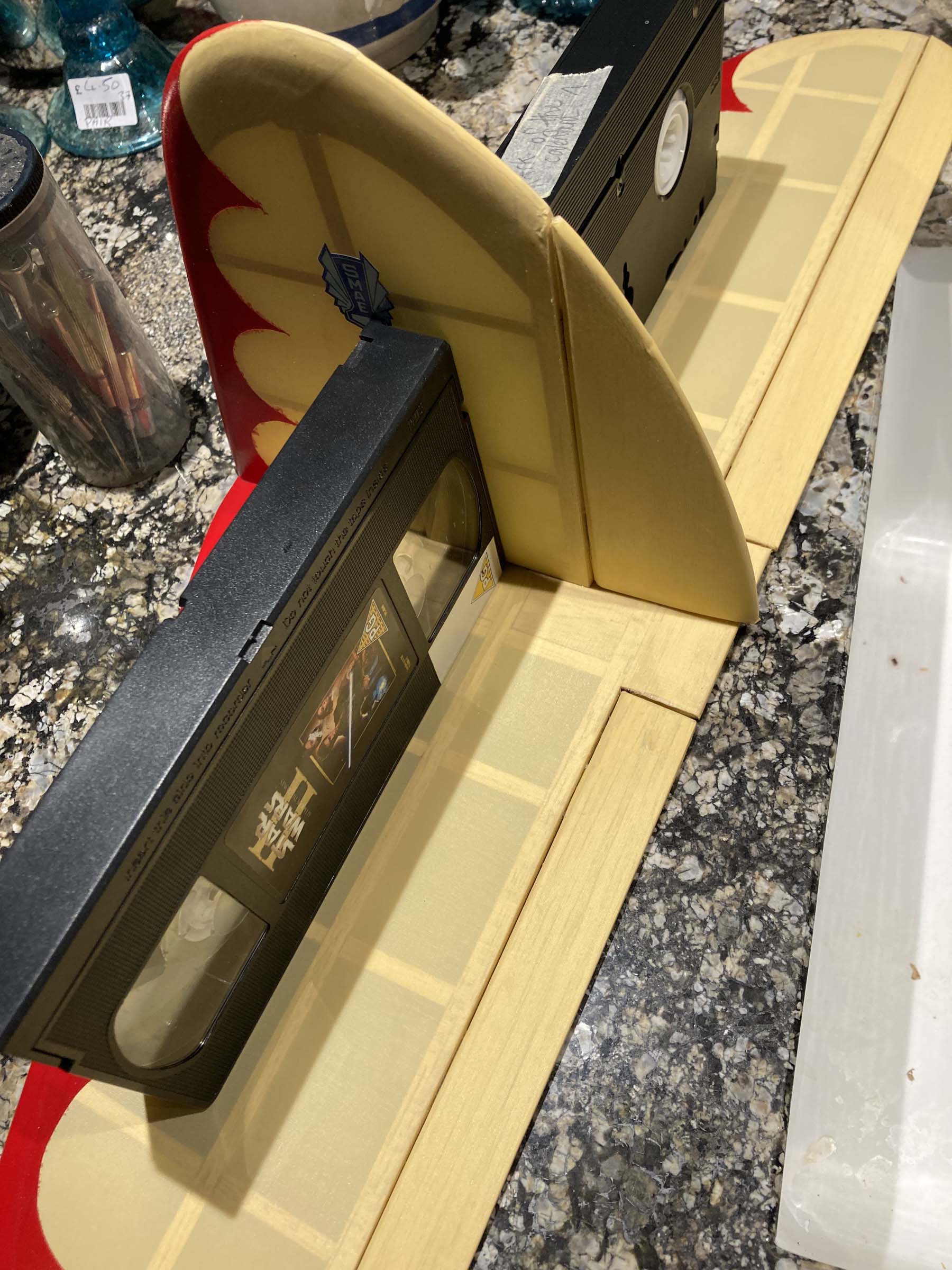

Made some little pegs from carbon fibre rod - checked alignment and araldite glued together. Ably assited by Star Wars and The Ark of the covenant !

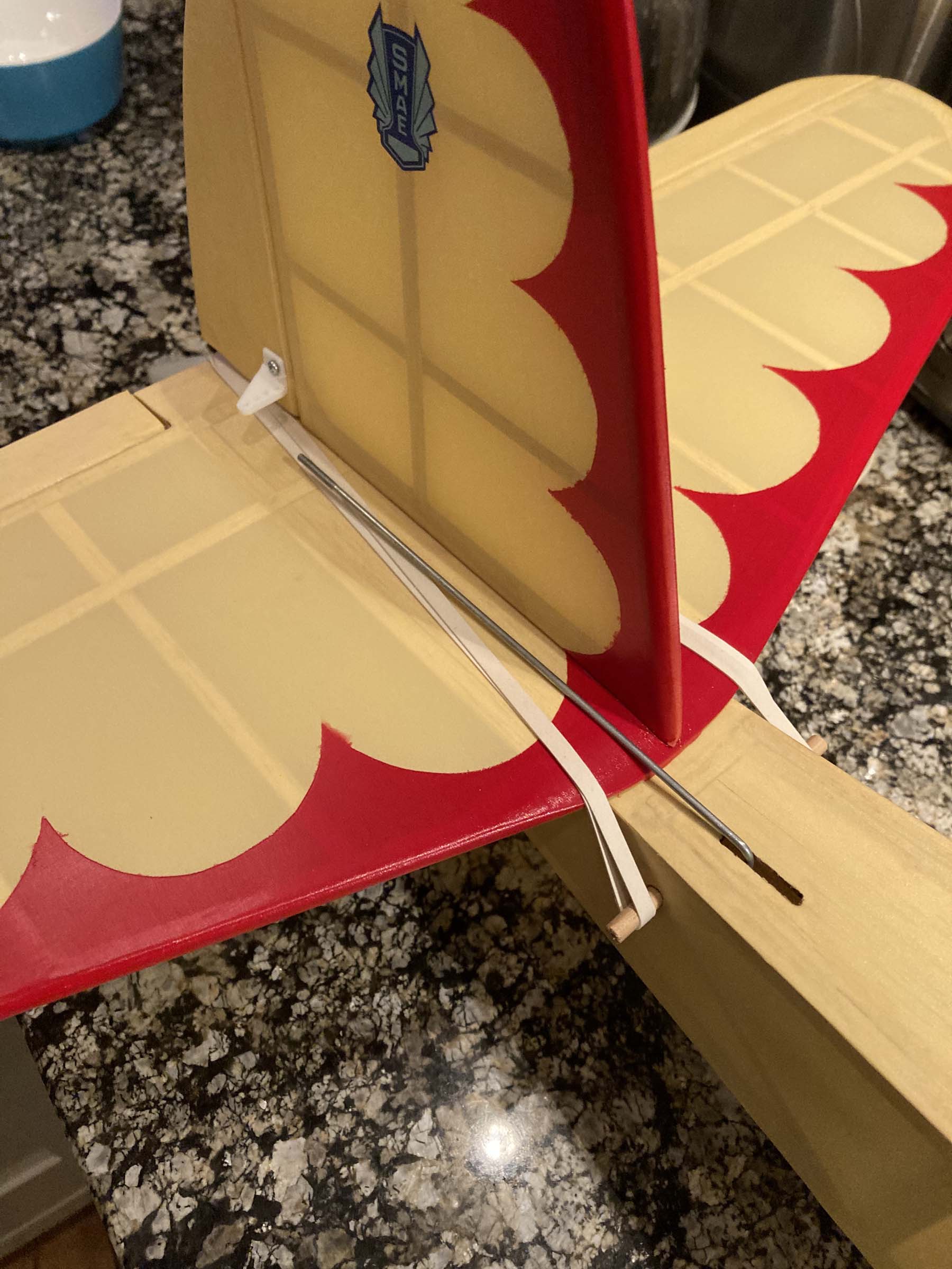

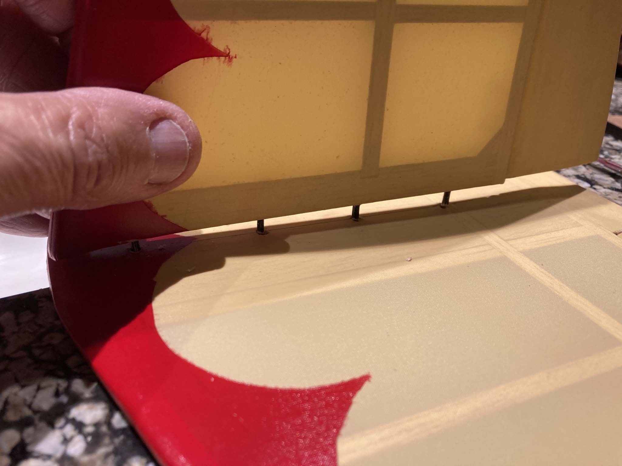

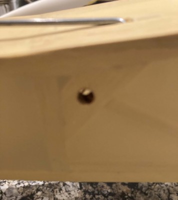

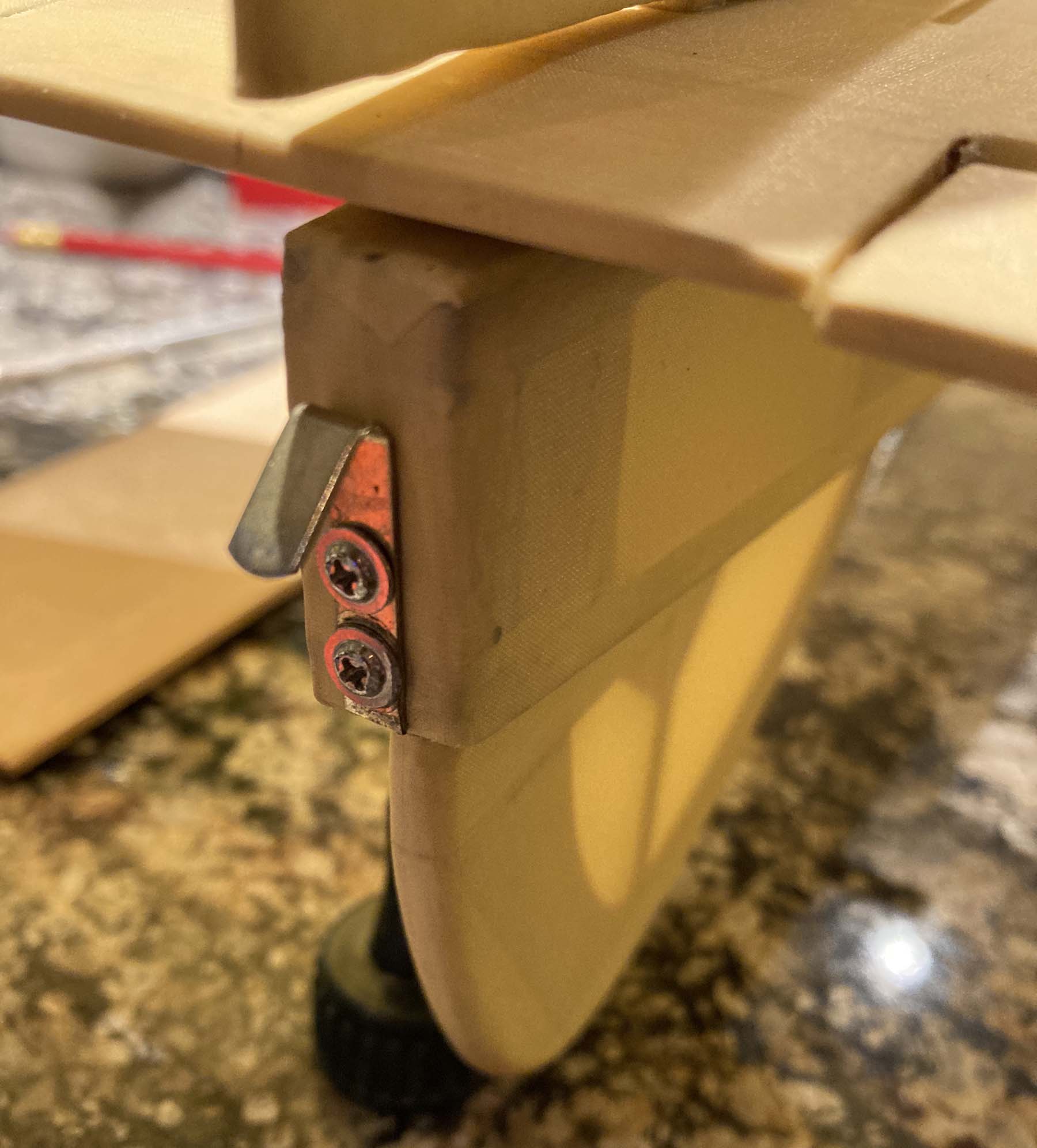

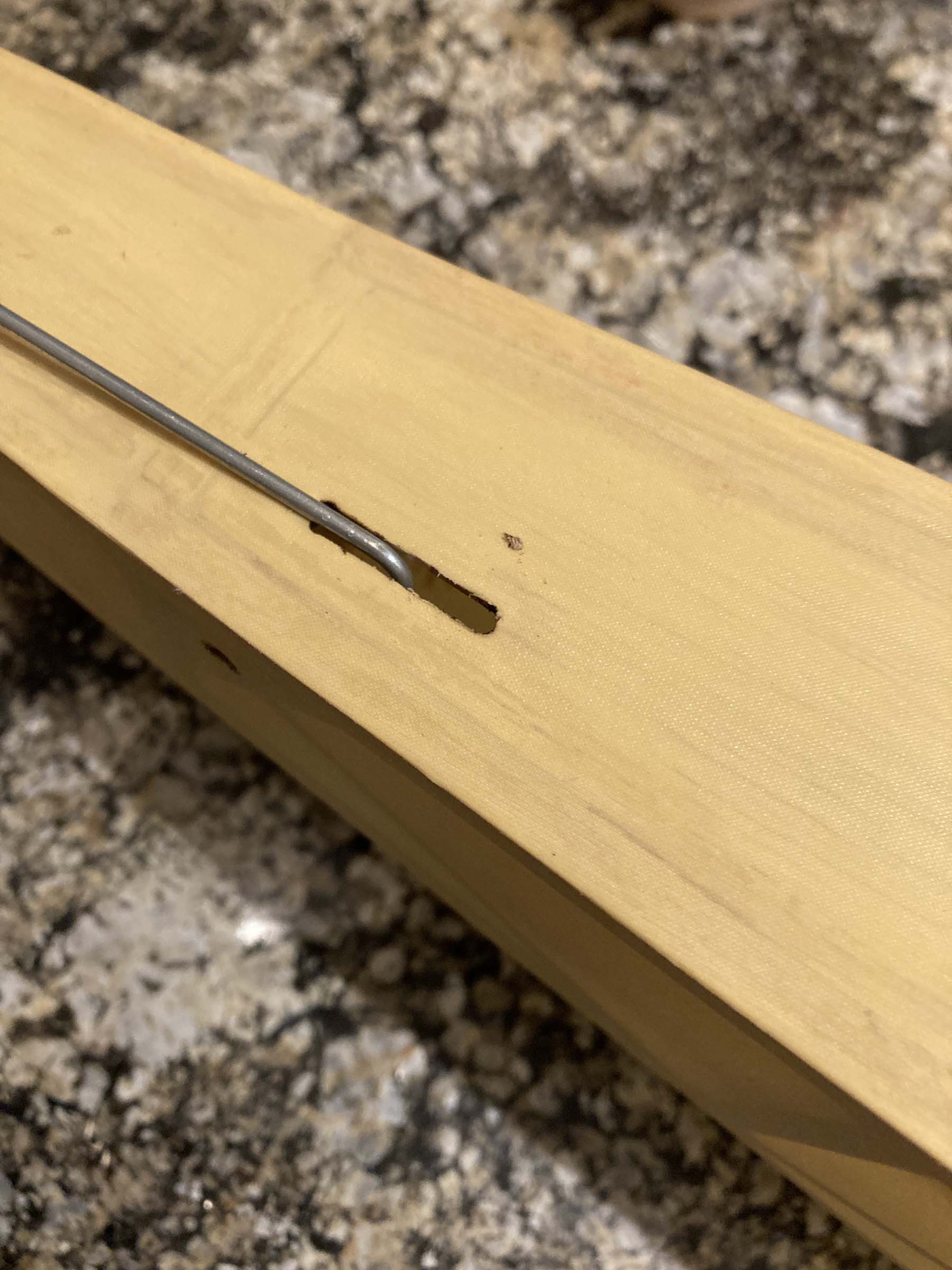

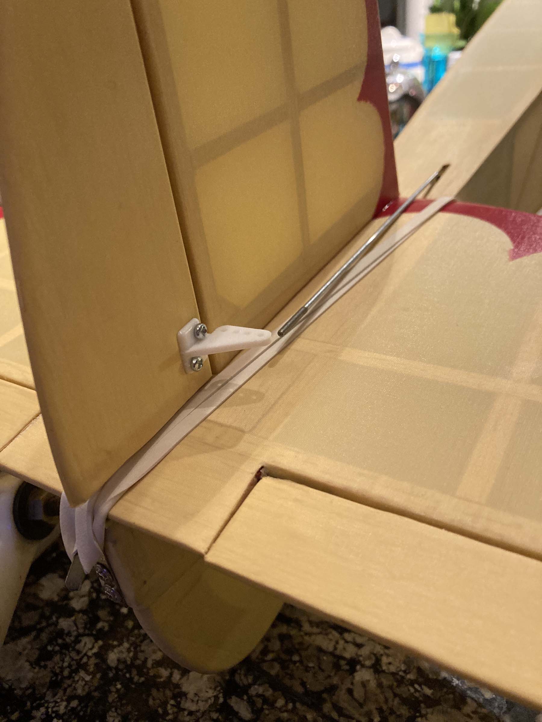

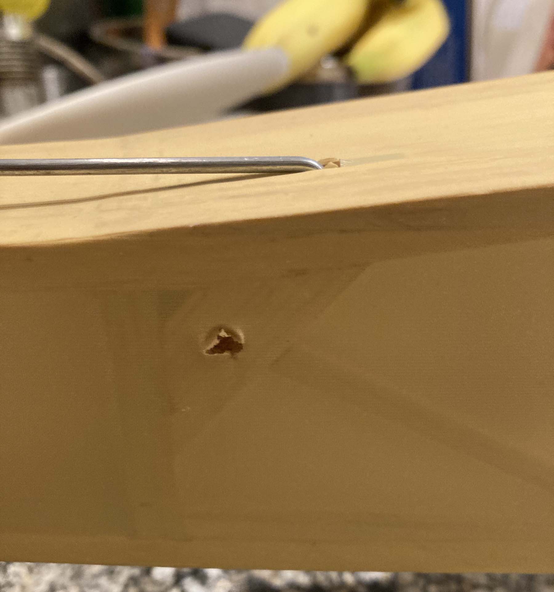

Just made the tail band clip out of an old picture frame wall hook

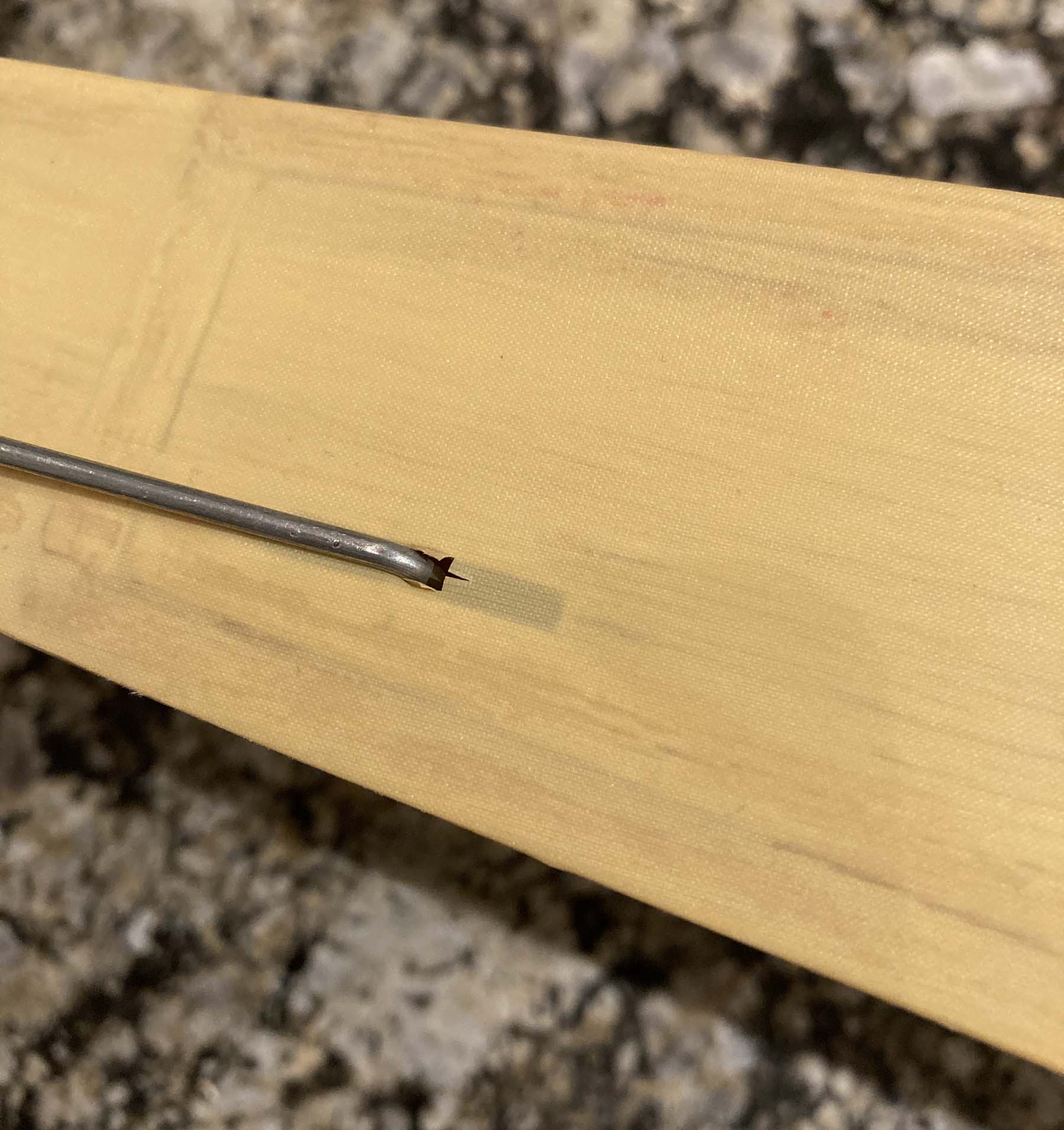

Made holes through the covering for the band dowels with a hot wire
Made a front peg to locate the tailplane so steaming ahead
So a ten day isolation to carry on with model aeroplanes / Can’t be bad methinks

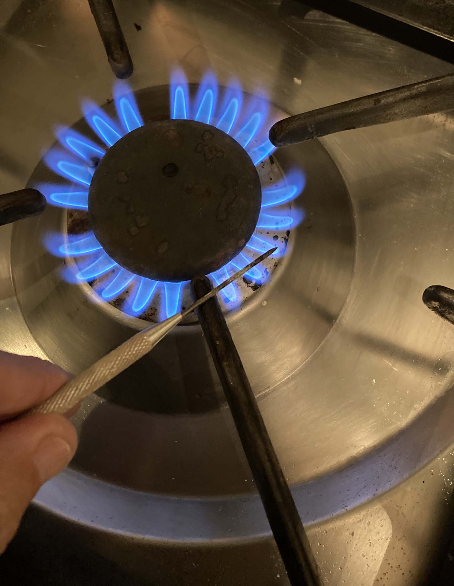

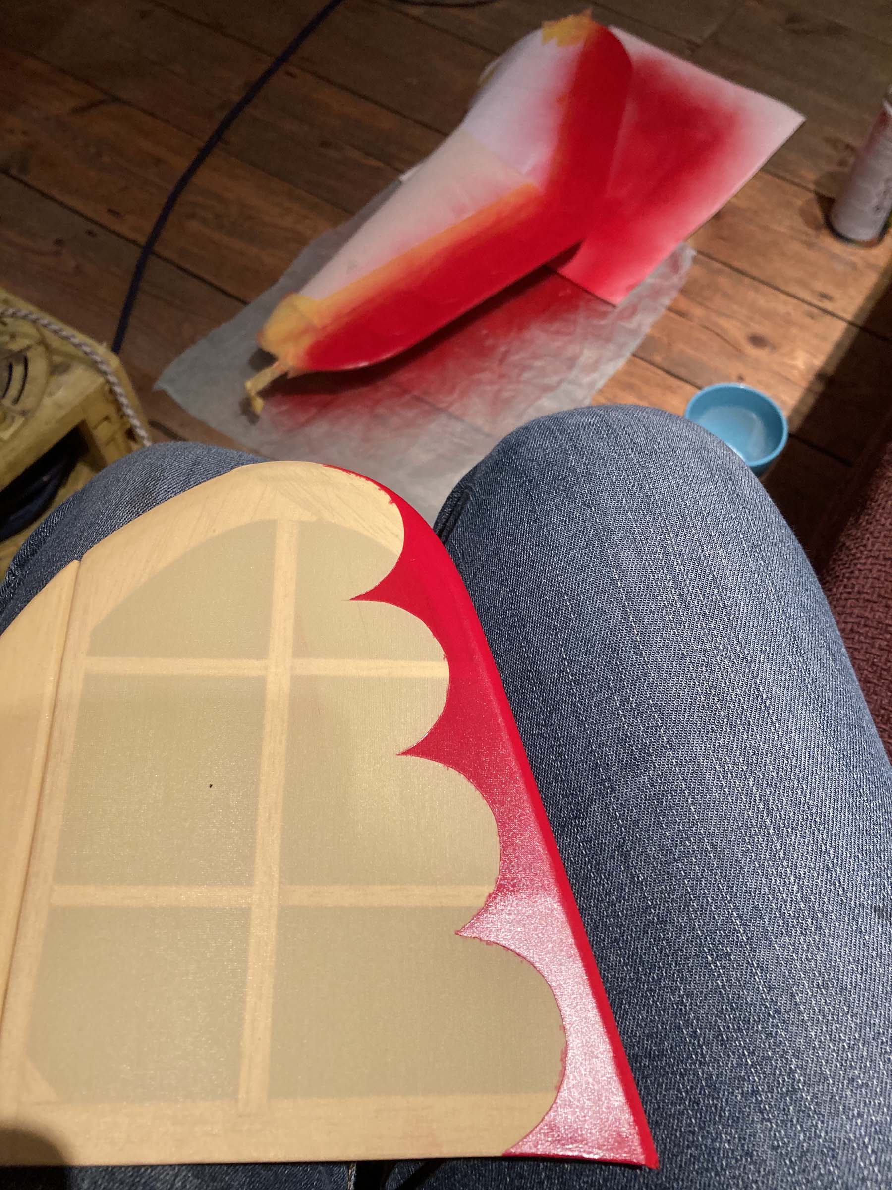

Uh oh …. Despite carefully masking off some paint has crept in where it shouldn’t have .
- Wavemeter
- Posts: 213
- Joined: 16 Feb 2018, 21:22
Re: Junior 60 build
Using a bit of E15 petrol to get the overspray off which is working mostly.

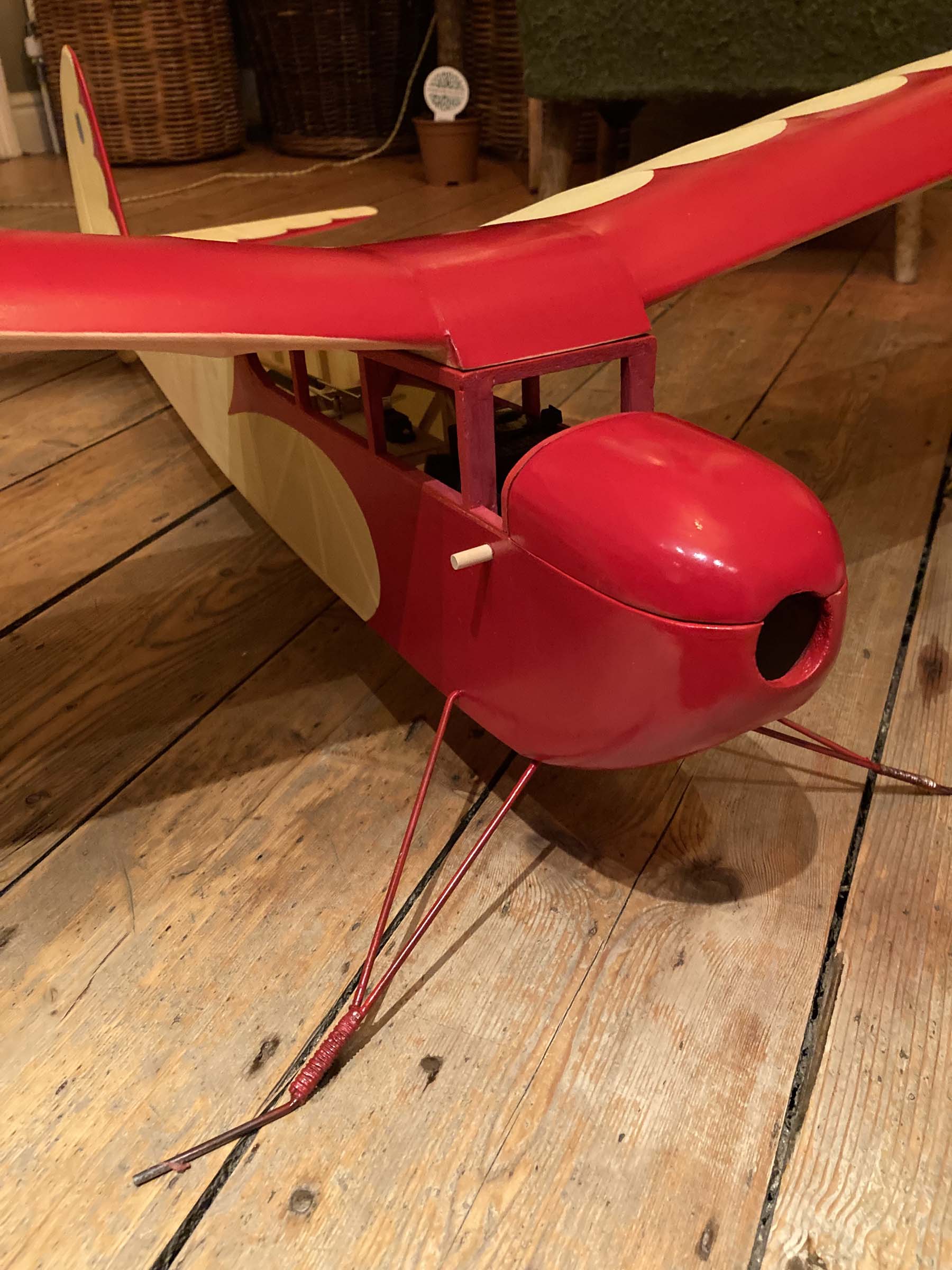

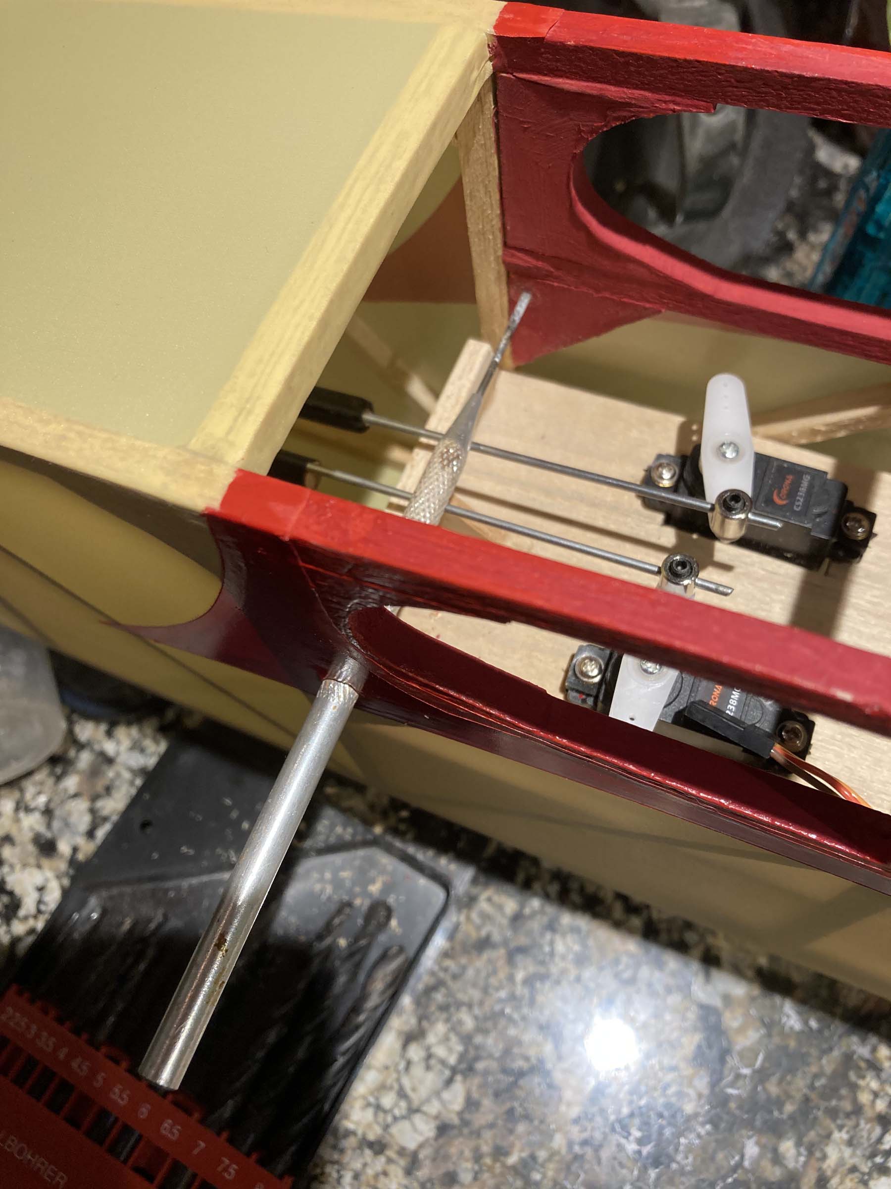

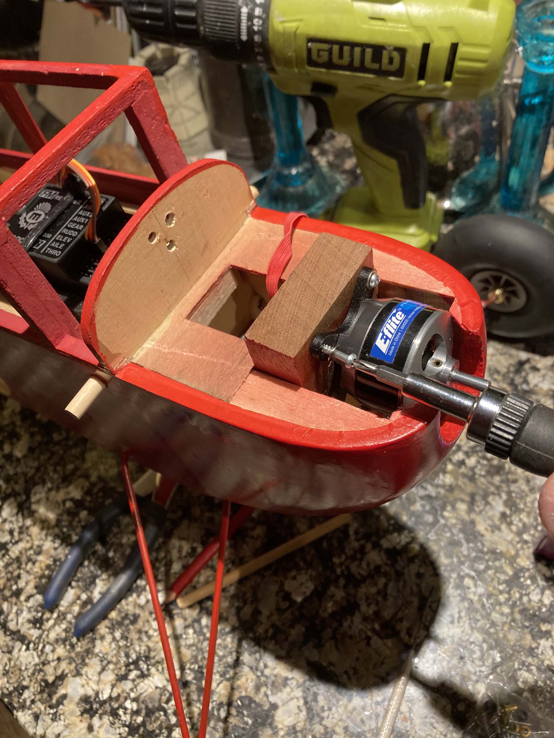

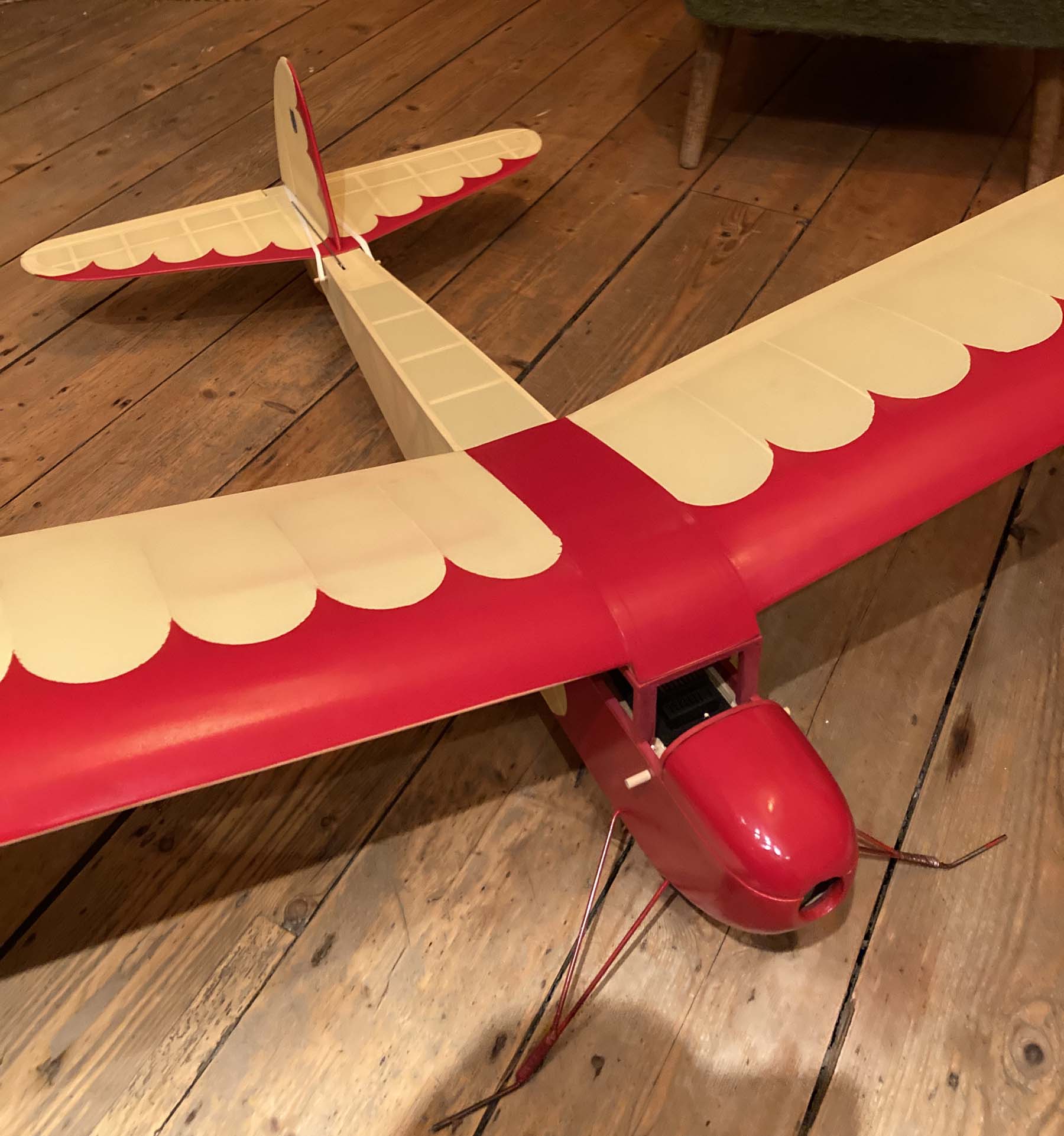

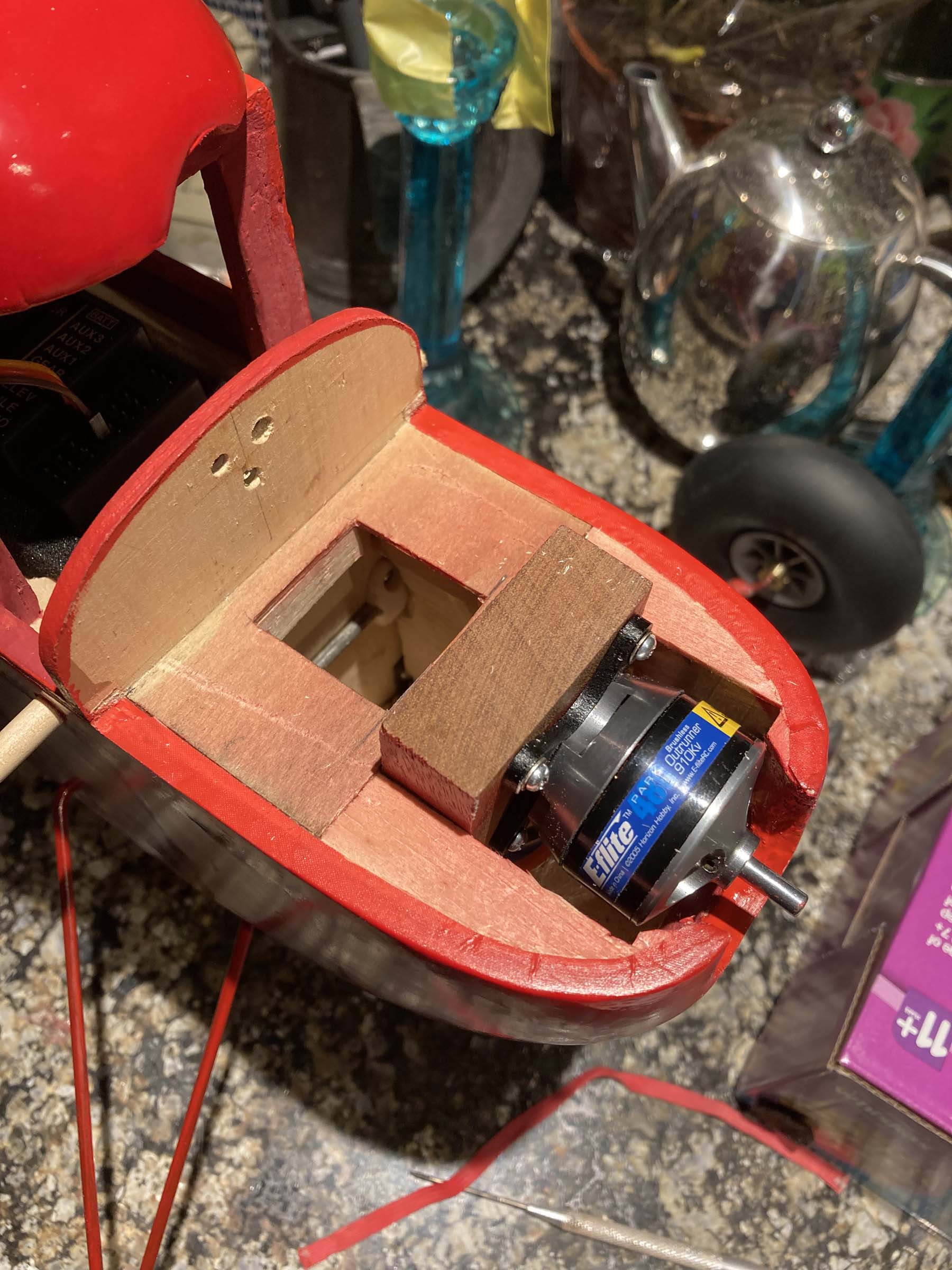

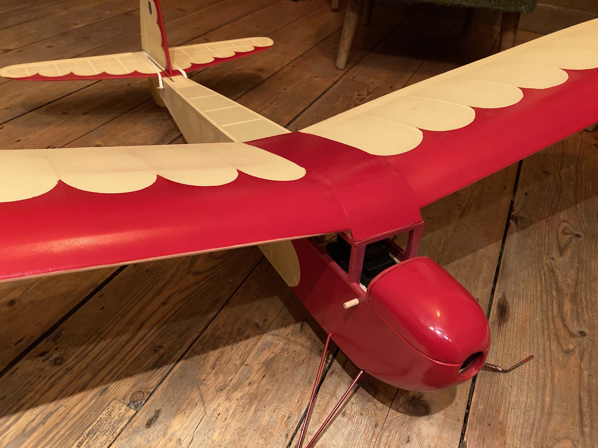

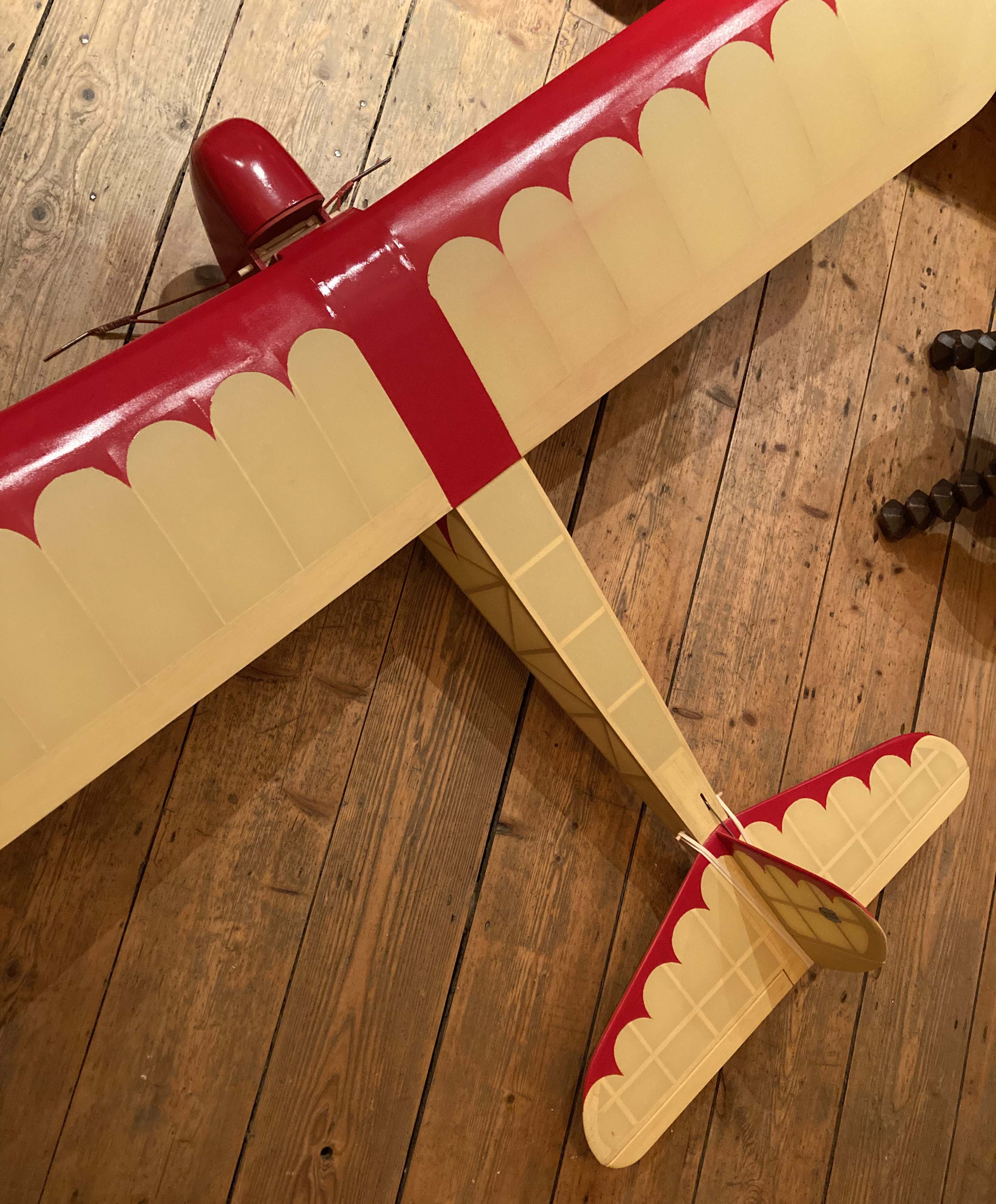

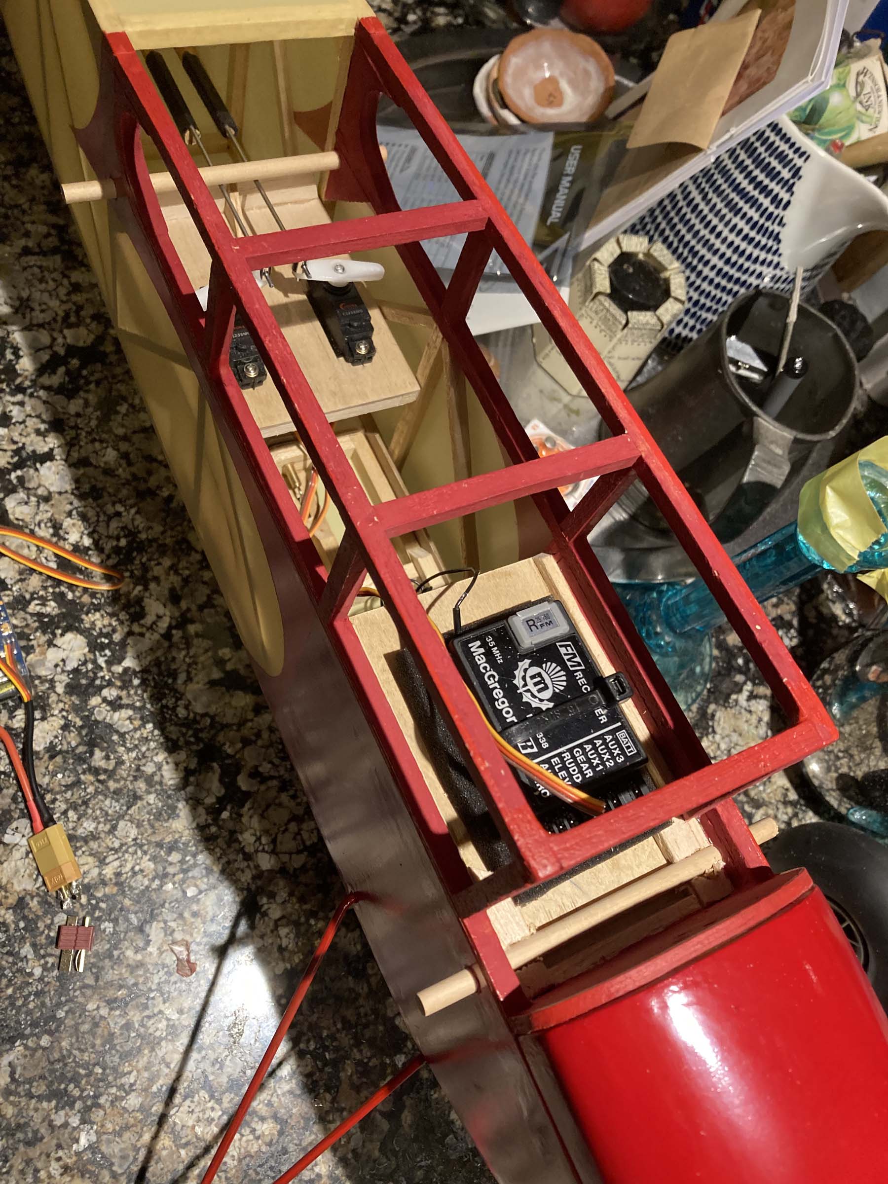

Well tonight’s episode is complete. Motors in ( probably too powerful but it’s what I had ) band pegs are in . Tailplane is mounted . Horns yet to do ,windows etc
Looks like it’s heading for a Boxing Day maiden
