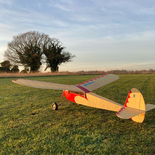

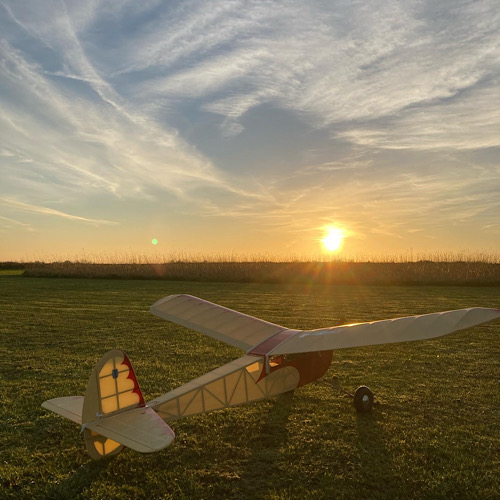

- Joined: 16 Feb 2018, 21:22
Re: Junior 60 build
Photos at last ! I think ( hope) I have shrunk sufficiently for posting
Hi Jonathan, the size of the photo's are good, in fact you've gone beyond what is needed, but I've moved the video onto youtube, hope you don't mind - Mike

Re: Junior 60 build
Congratulations Jonathon, a great conclusion to your detailed building thread. Love the (almost) sunset shot, most nostalgic.
Beware that pair of whomping willows just waiting for a feed
