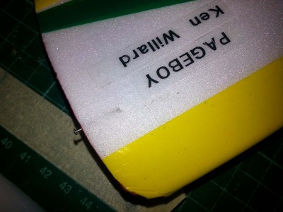

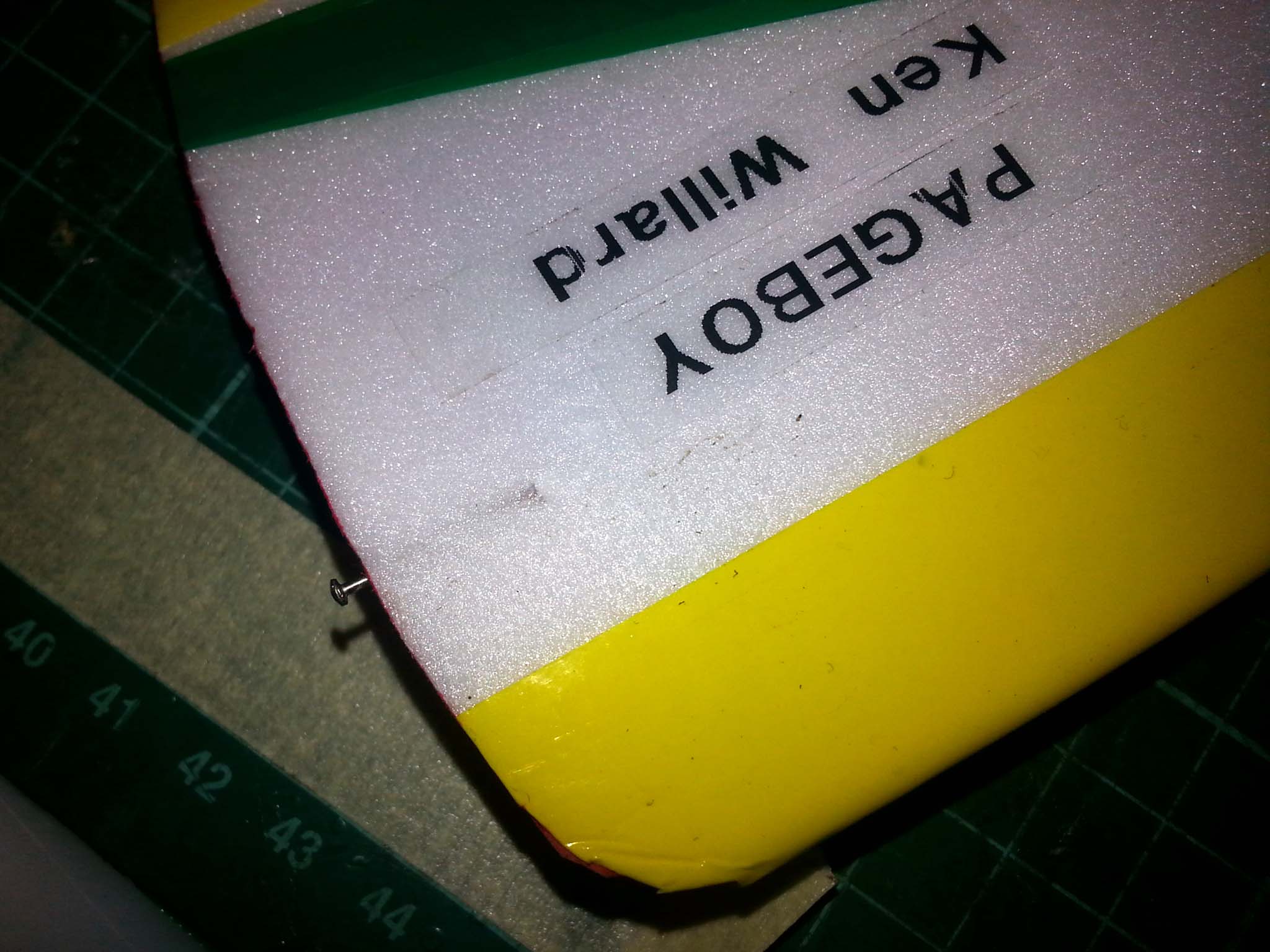

A simple trick I use on these small models to accurately get the CofG right, is to insert a pin into each wingtip at the required CofG location with the pin head protruding about 3mm. Then I can quickly & easily lift the model by the pins to check that I have the model balanced correctly - far more accurate than using your finger tips! If you decide to move the CofG, just relocate the pins accordingly.
pins inserted into the wingtips at the CG location

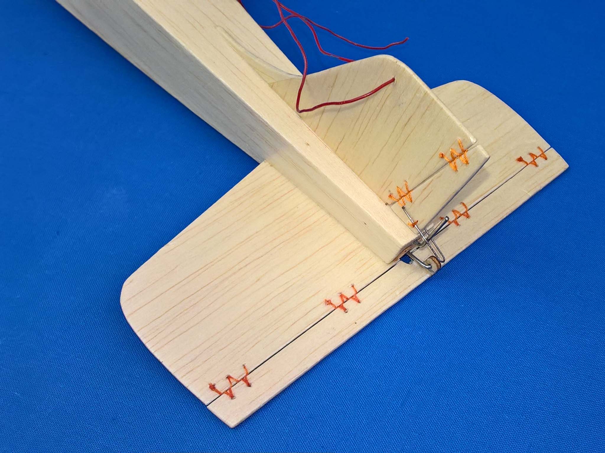

My Pageboy now has elevator :shock:
I wanted a 1S ESC for my Ponty theme build, so took it from the Pageboy and installed a 2/3S ESC in its place. At the same time thought I'd add an elevator. Original AUW was 80g - now with a small 2S lipo it's a little under 100g. Looking forward to flying it with this configuration :D

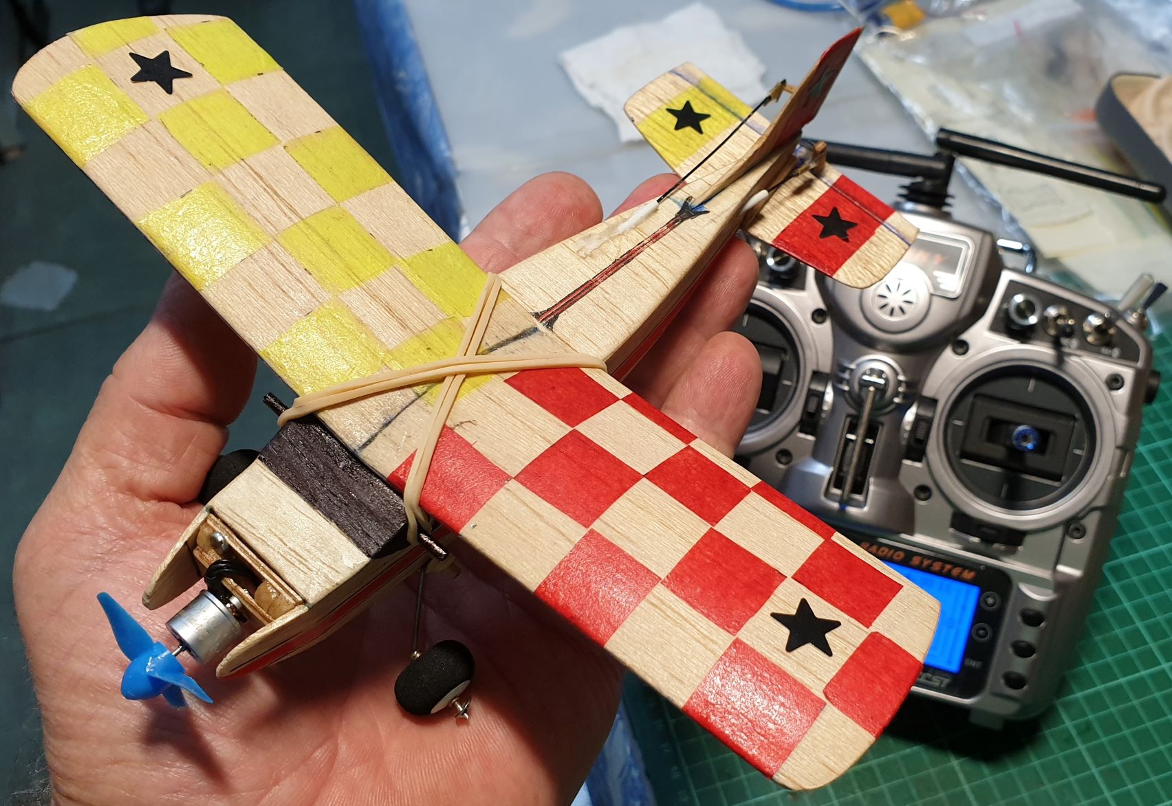

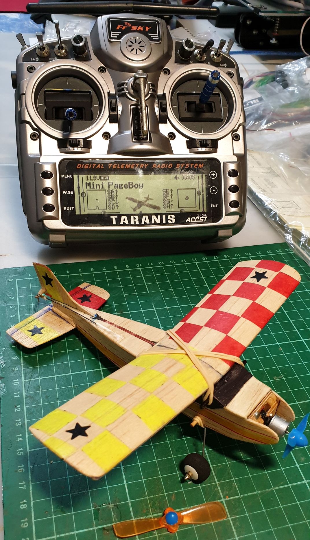

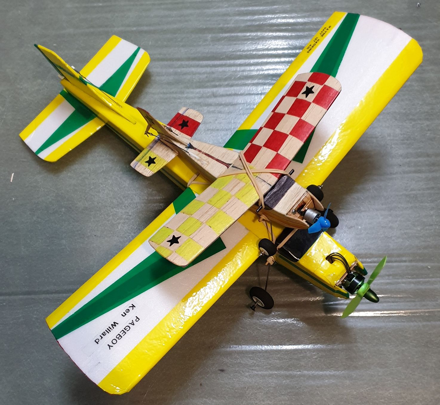

Here are a few pics of my just completed 50% PageBoy. Came out at (edit) 33g ready to fly :D
a bird in the hand...
it is small, even compared to the full size(?) Pageboy!?!
More details to follow :P

Looks like a chubby baby 8-)
