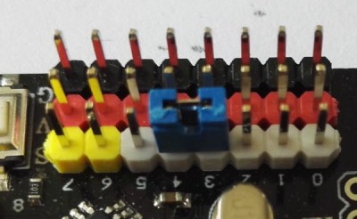

Thinking back I had already modified Phil_G encoder software to reverse the throttle for a friend who had done a conversion and had exactly the same problem as you.
What I did for him was add some code to see if inputs D3 and D4 on the Arduino were linked. If no link is fitted it works as normal, if you fit a 0.1" jumper across D3/D4 it reverses the throttle. If you have one of the DIY-more type Arduino's or a standard Nano on a break-out shield you already have headers fitted to D3 and D4, so you don't even need to do any soldering, you just need a 0.1" jumper that only cost pennies or can be "borrowed" from some other electronic equipment. And it is easy to revert back later, just remove the jumper. I've just grabbed an Arduino and fitted a jumper to show you what I mean.

Thanks Mike! I was wondering if it would be possible to program a hardware defined reverse, as the usual "hold the stick over at power on" won't work on the throttle.
I think my Classic Tx has the original style arduino board in it, but it probably has the same headers connected. I'll check later today.
And thanks for the updated code!
UPDATE: The Classic Tx had one of the original Arduino Nano boards mounted on the DEEK-Robot motherboard. That made it nice and easy to program up a new Arduino and just plug it in, without disturbing any of the wiring! The only slight snag is that on the DEEK-Robot board, there is a gap between D3 and D4 pins. Luckily, a Spektrum bind plug is a perfect fit. It is very close to the buzzer though, and since D4 is only providing zero volts, I turned the bind plug through 90 degrees and coupled D3 straight to its relevant ground pin.
This provides the same functionality (ie: it works! ) whilst giving slightly more clearance to the buzzer.
All now up and running, and re-calibrated. Just have to check the controls as they all seem to be reversed as standard! Phil clearly uses Futaba servos, which work in the opposite sense to everyone else!
Many thanks for the mod, Mike! Its a good upgrade!
