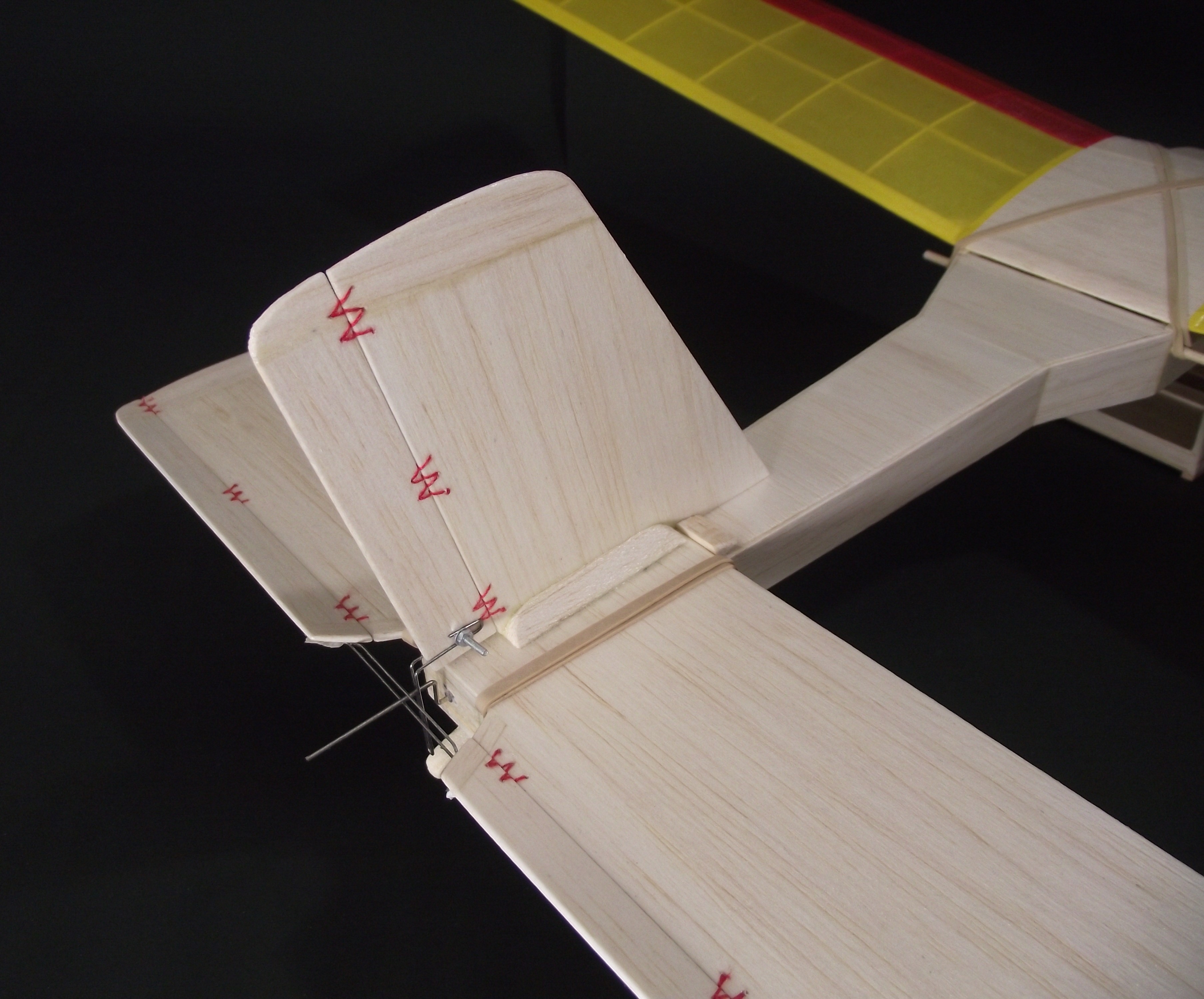

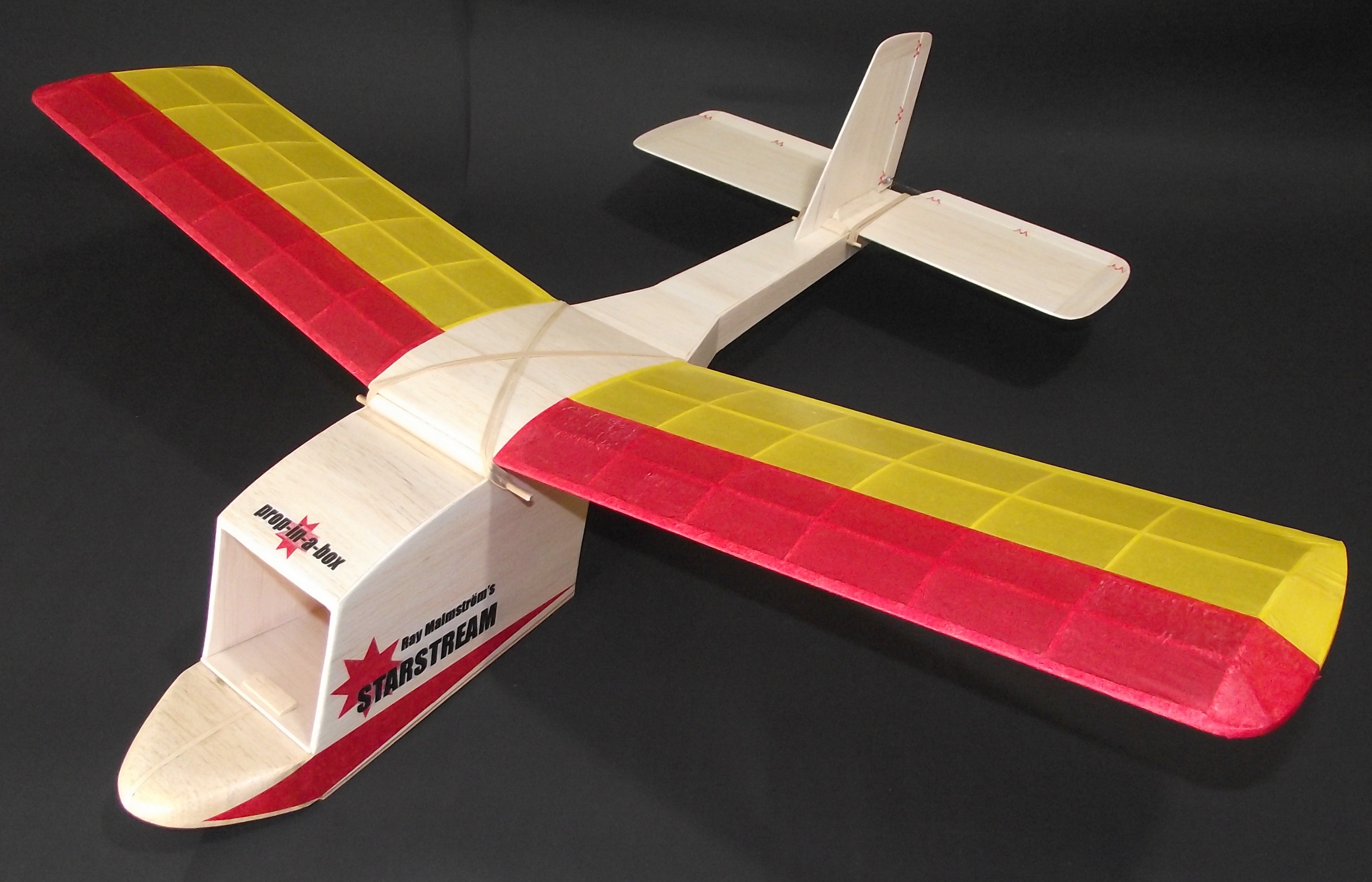

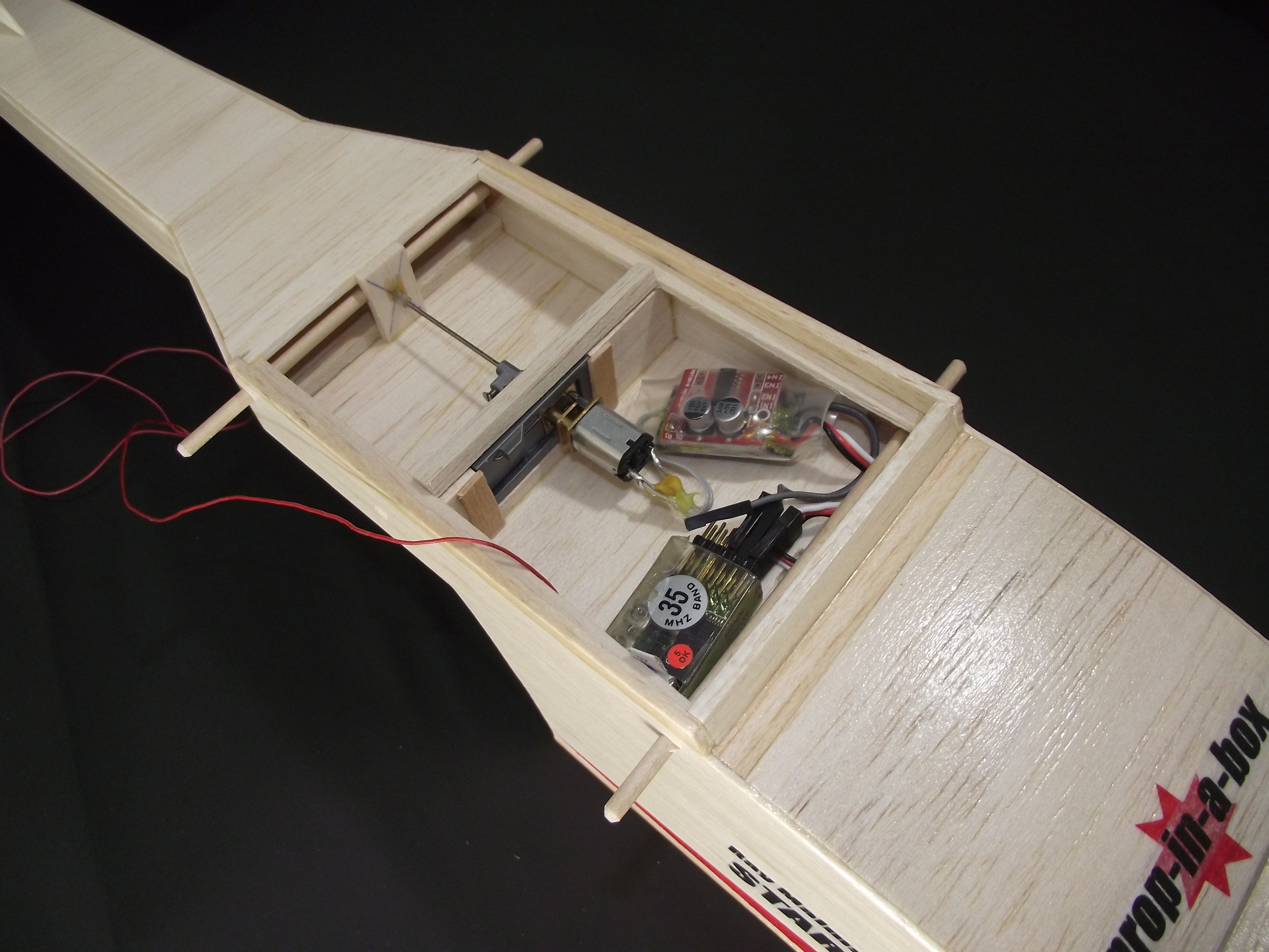

Here’s a few pictures of my almost completed Starstream with Martin’s GG system. The GG system works great - thanks Martin. I will test fly the model with rudder only controlled by a servo at first. Once happy I'll install the GG system again and test using pulse proportional on rudder only, then finally go full Galloping Ghost

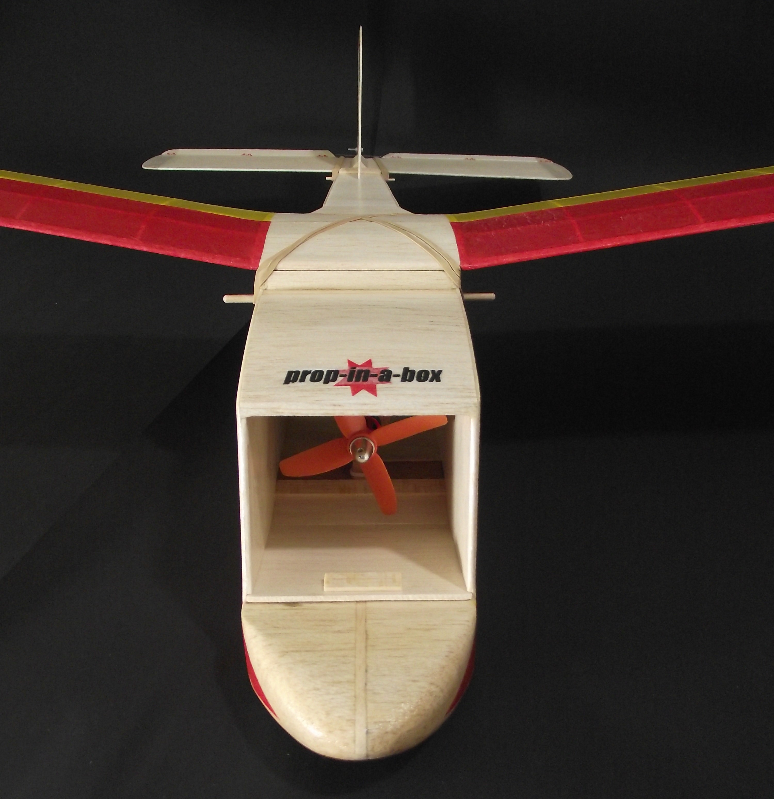

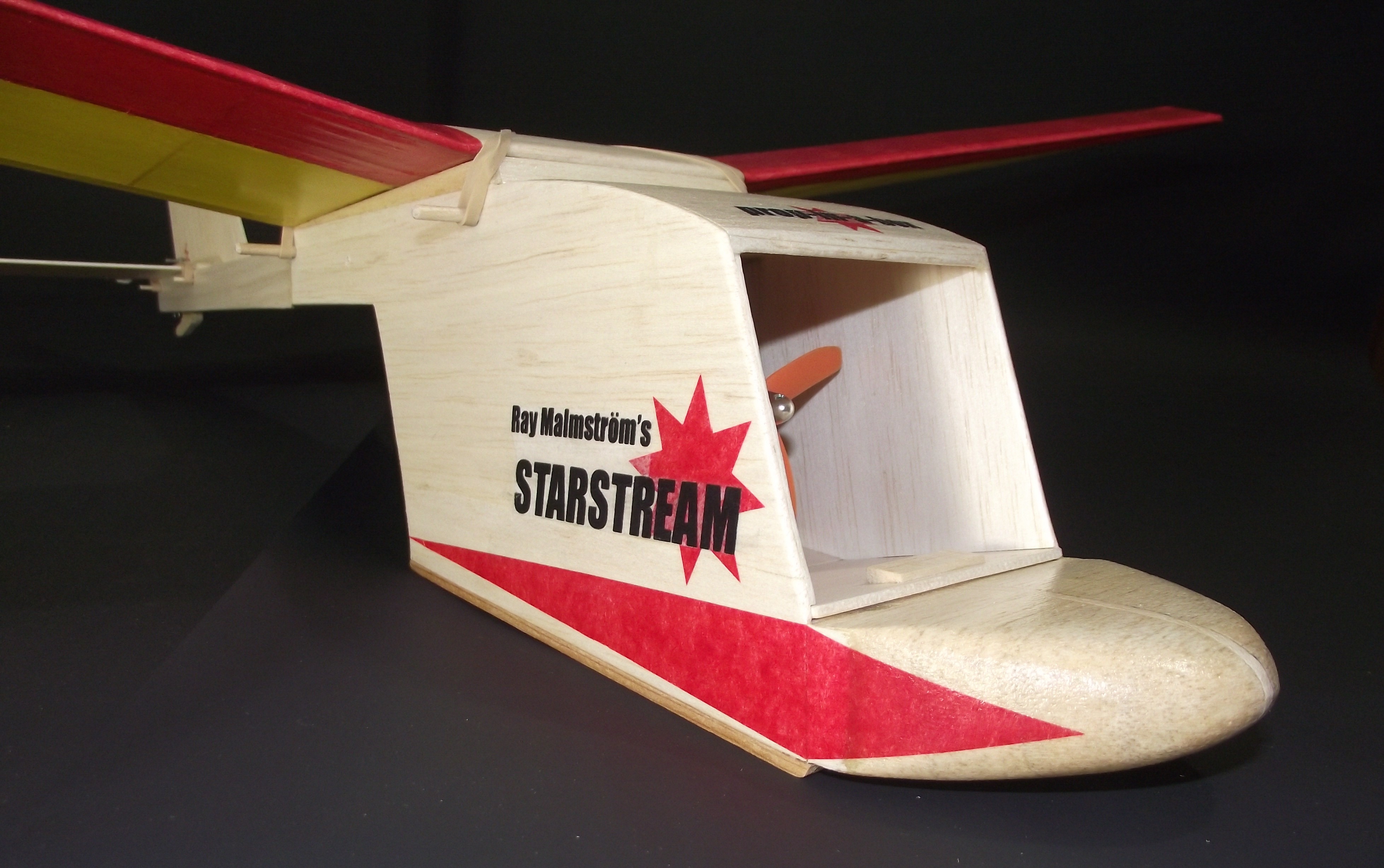

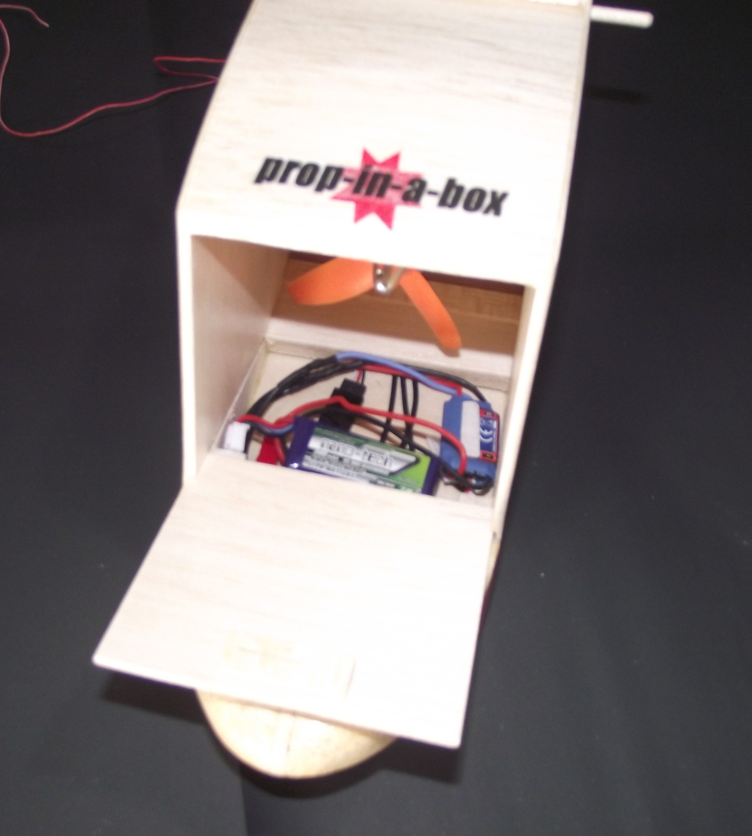

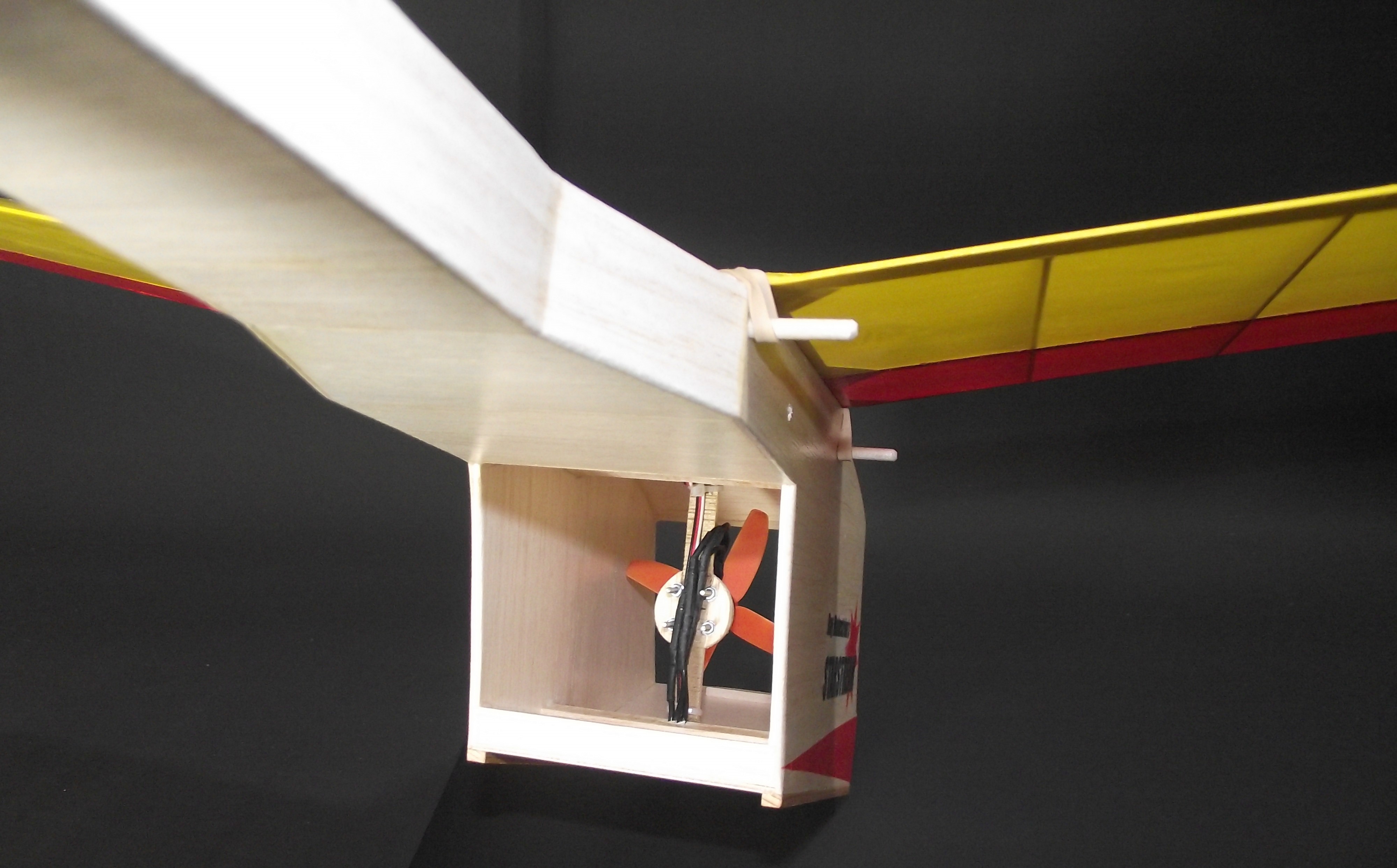

There are a few changes to plan. Those of you who know the original design will know the front part of the fuselage hinges down to provide access to the engine for starting and maintenance. Mine being electric powered I decided not to have the hinged front. Fortunately being 6' 3" I have long slim fingers to match so can get to the motor ok - good job too as if I had chubby hands and fingers I will have been in trouble. I've used 1/16" ply on the base of the fuselage instead of balsa with a thin strip of hard wood along the bottom outside edges as skids. Also added a rear skid to protect the birdcage at the rear.

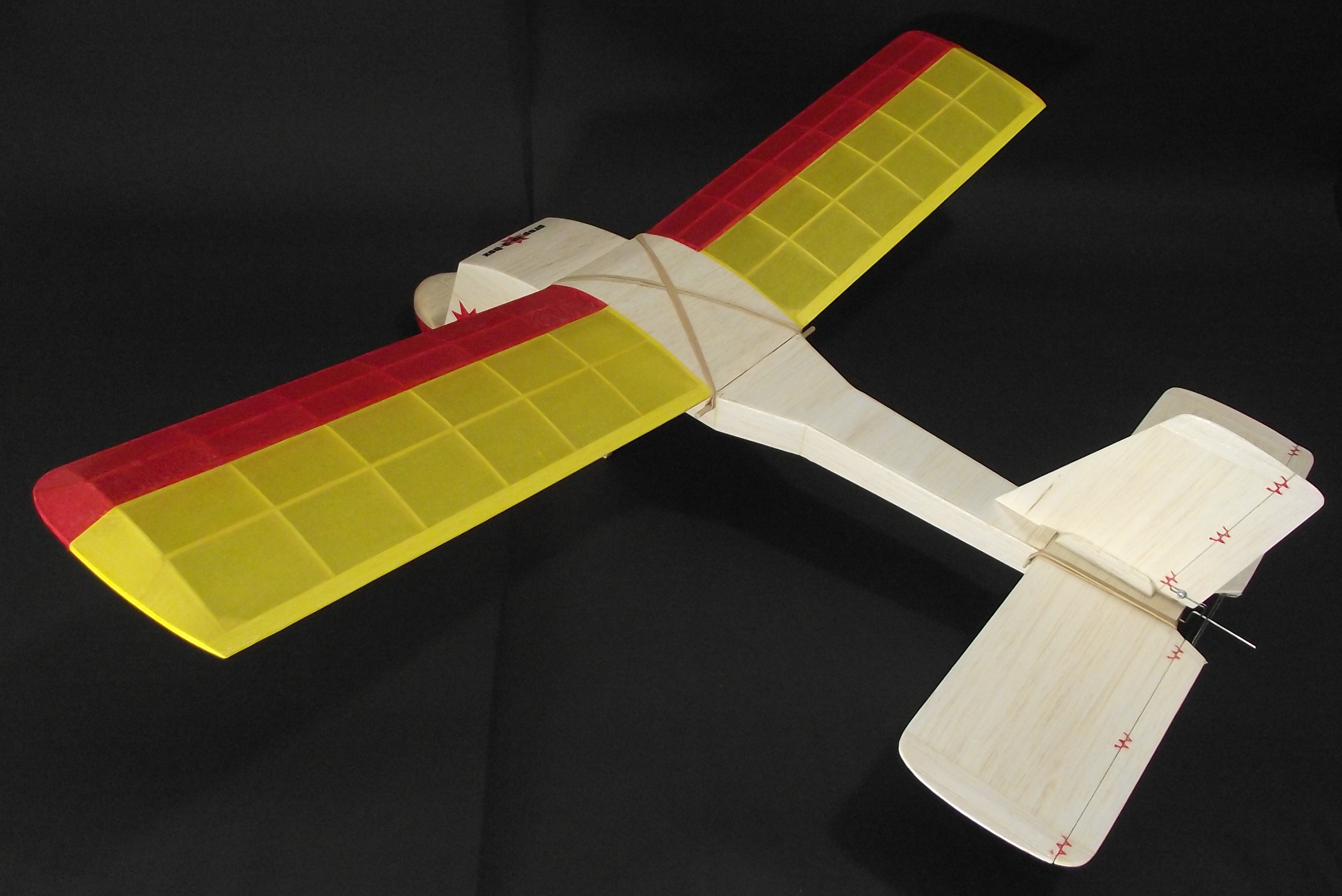

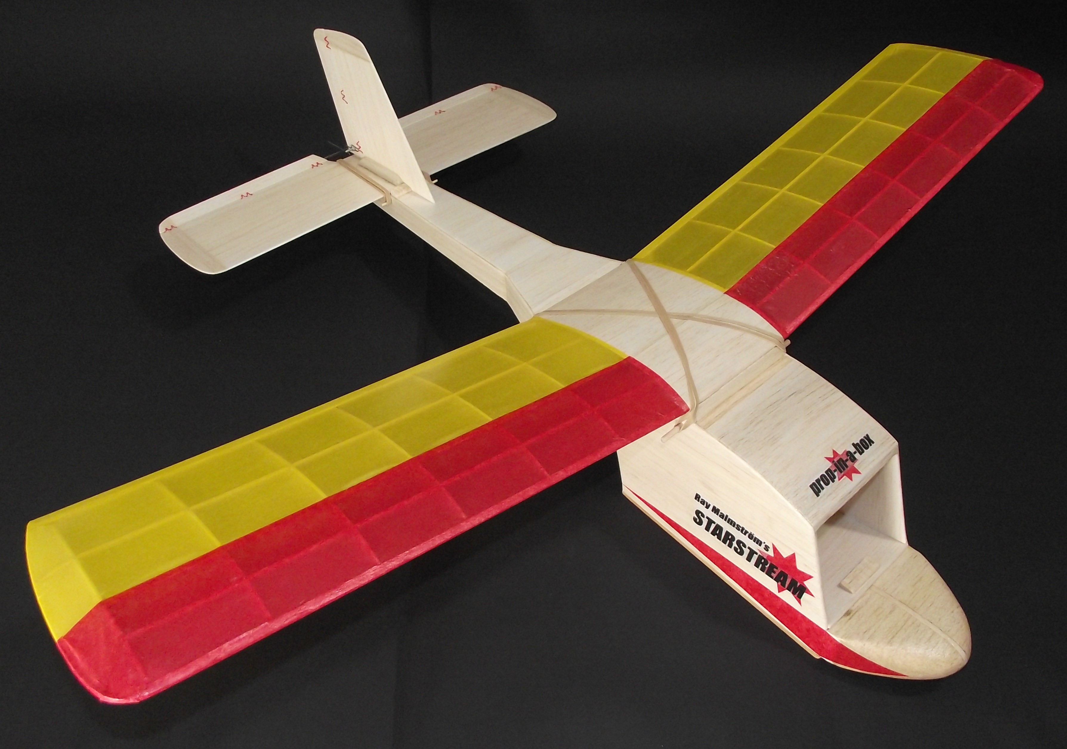

For the wing I have a hard wood dihadral brace and have extended the top spar going the full length so there is a full length spar on the bottom and top now.
I will be recovering the wing as it didn’t go well. The yellow I used first just tore when it shrunk, so it all had to come off with the red. I remembered I had some yellow jap tissue left over from the build of a scaled down Chief. This went on beautifully, but the red is horrible as it doesn’t shrink evenly. So I decided to remove the red and get it on tighter but that didn’t work and replacing the red caused the yellow to loosen. Will leave as is and recover after test flights and when I have some more jap tissue in both red and yellow. You might not notice it so much in the photos but it looks embarrassingly horrible. Learnt a lot though, so some good will come from the experience.
I've since dry strength tested the tissue. The first yellow that tore when shrunk tears very easily, whereas the jap tissue is very strong and difficult to tear. The red tissue I used also tears fairly easily but not as bad as the yellow. In future only the best tissue will be used on open frames. Other cheaper tissue is fine for decoration of sheeted areas.
Below is a short video of the GG system in the model. The cage for the elevator is only taped on and may not be correctly setup yet. But this will be removed so I can just control the rudder with a servo at first, then pulse proportional on rudder only. When I go full GG I'll get the elevator set up properly for which I'll need some advice.

I think you have the elevator linkage upside-down when compared to the 'standard' galloping ghost method. It was usual, back in the day, to have the crank neutral position at the lowest point, so long slow swings resulted in up elevator (climb) and short fast swings in down elevator (dive).
I don't really see why it shouldn't work just as well the other way round though (the way you have it) - and it looks as though with your model it will keep the elevator 'birdcage' simpler and neater as you already have it. Maybe someone with more galloping ghost experience than me can explain why the 'standard' method became the adopted one - and what would be the disadvantages (if any) of having the elevator working the opposite way round?
I suppose it could just be that bottom-mounted tailplanes (horizontal stabilisers) were the most common, and then the birdcage linkages would be neater with the 'slow for up' layout?

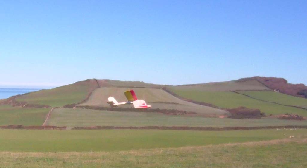

It flies
After a couple of test glides, I went for a powered flight. Didn't set throttle with enough power for much of a climb first launch, but eventually it gained height and flew beautifully (right of the board which I can't believe). Second launch was better with more power and firmer launch. Battery ran out of juice for a third launch as I would have used full power this time. Anyhow once it had gained height I was able to back the power down to about half and was quite happy being guided about. It makes a great sound too
This was with rudder only control using a servo. I will do some more flights with this set up next time, and then reinstall Martin's GG setup - but rudder only at first.

It flies great! Well done, and thanks for posting the video!

Congrats Carl - it appears to be a very pleasant flier indeed despite it's unusual appearance which front on especially, reminds me of a whale shark (another dosile beastie) as it cruises about.
BTW - love that Tx antenna. At first I thought it was lense distortion, but it was always bent regardless of which side of the picture it was on . I don't think I ever saw a straight telescopic antenna other than on a brand new Tx. As a mate of mine once quipped - "its proof you use it and as a bonus, its great for transmitting around corners!"
