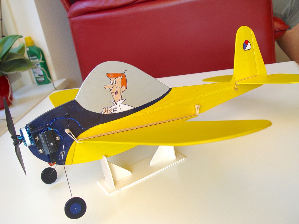

As I have mentioned in an earlier topic, I have been developing an Arduino based timer for electric free flight models. In particular, I needed it for an Ebenezer type FF plane, to be entered in an event we held last weekend. Here is my "Jetsonezer"
