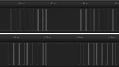

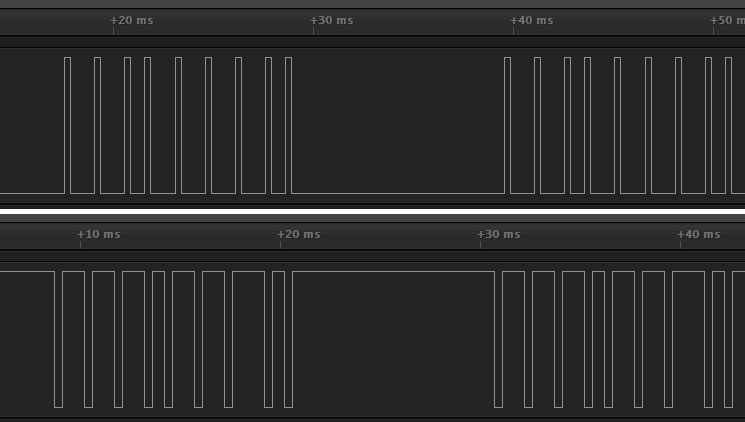

I'm trying to finish off the documentation for a proportional encoder project that I've written and there is one thing that I'm not certain of, the correct description of the PPM polarity.
In the below screen-shot from my logic analyser of two ppm streams, the top one is typical of a Futaba and the bottom one typical of a JR transmitter. I've always called the top one negative polarity as it is mainly at ground and the bottom one positive polarity, but there are conflicting descriptions on the web.
To get a Spektrum DM9 module to work in a FrSky Tx you have to choose + polarity (and 400uS pulse), that would suggest the above description is correct. But if I put the waveforms into a Phil_G ppm monitor it says the opposite!! And Phil is not wrong very often.
I've got all the modules that I've tested to work OK (FrSky, OrangeRx, Spektrum, Corona, Multi-protocol, Futaba 35MHz and 2.4GHz and JR 35MHz), so I haven't a problem with the programming or the hardware, it's just I don't want someone saying I've got my descriptions wrong.

My personal belief would side with Phil on this one.. the top trace shows positive going pulses so logically should be labeled as +PPM and the bottom trace shows negative going pulses so is -PPM....but I would be willing to accept there is a 50% chance I am wrong

The key word is 'going' Mike, your top trace shows 'positive going PPM' by long-established standards where 'polarity' is determined by the pulse itself, not the variable gap between.
Present day 'negative-going PPM' is as per your second pic but is in itself contradictory as it never goes negative like the old Kraft encoders used to. So the 'standard descriptions' are actually not very good.
Hence I personally describe your first pic as 'standing ground, positive going PPM' and your second as 'standing pos, ground-pulsed PPM' which is a bit of a mouthful. JR is generally 'standing battery pos, ground-pulsed PPM'. Then there's 'standing logic pos, ground-pulsed PPM' and vice versa, with 3v3 and 5v variations. All these descriptions are further confused by open-collector drive like Frsky, or almost-open-collector like futaba & hitec module ports, where the encoder doesnt provide any voltage at all, just a pulsed connection to ground. Futabas and Hitecs have opposing polarity on the trainer port and the module port, so you cant simply say Futaba PPM is pos or neg - you have to say where you're looking!
So its all a crock of poop really, but in a very general accepted sense, your pics show positive-going ppm and negative-going ppm respectively, like the tester says.

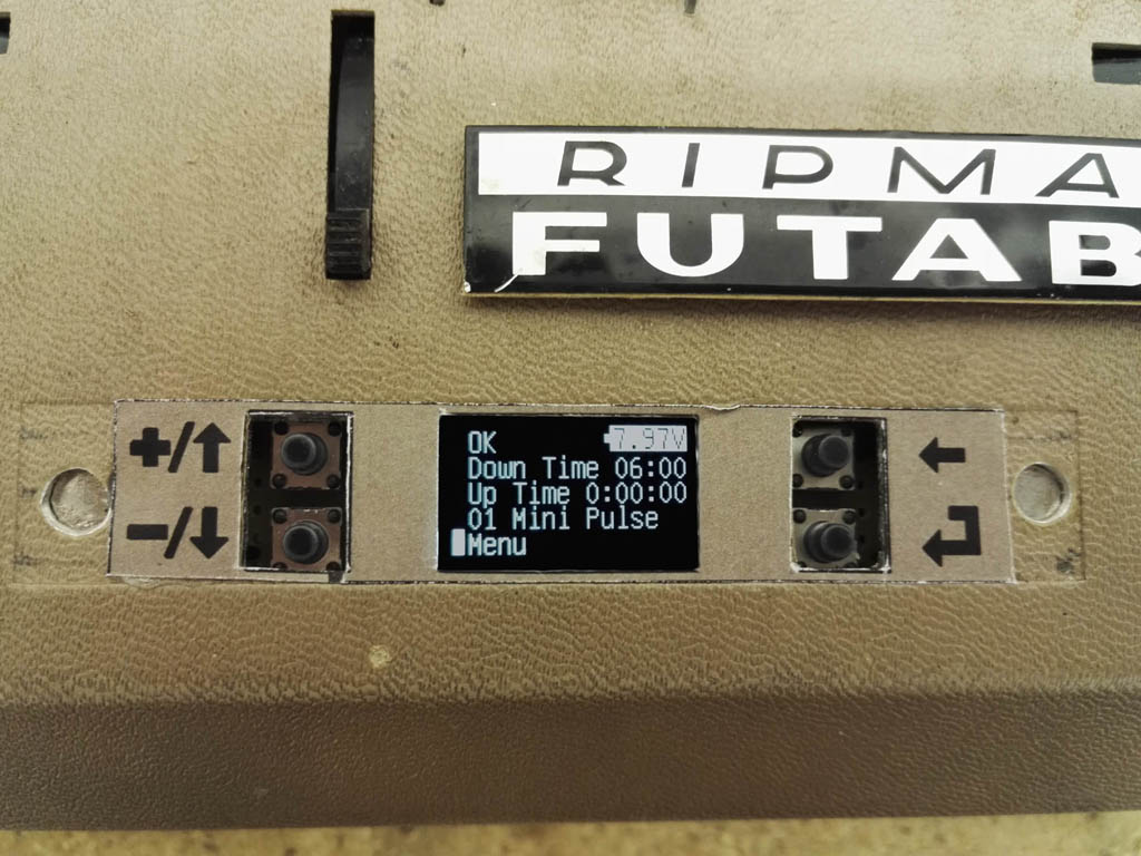

Scott - Mikes encoder is the absolute mutts nuts. It has everything any modern computer-radio should have and more. Its arduino-based with an OLED screen and pushbuttons to navigate the menus. Mike is very modest about it but it is simply superb!

I think I'd be better put some pictures in the manual as well as words to explain the options. A picture they say is worth a thousand words and is "nearly" unambiguous. I say nearly because as Phil rightly points out it doesn't necessarily show if it is open collector or logic level and if so what the logic level is (battery, 5V, 3V3, CMOS or TTL etc). Aren't FrSky and OrangeRx modules wonderful, they will work with just about anything.

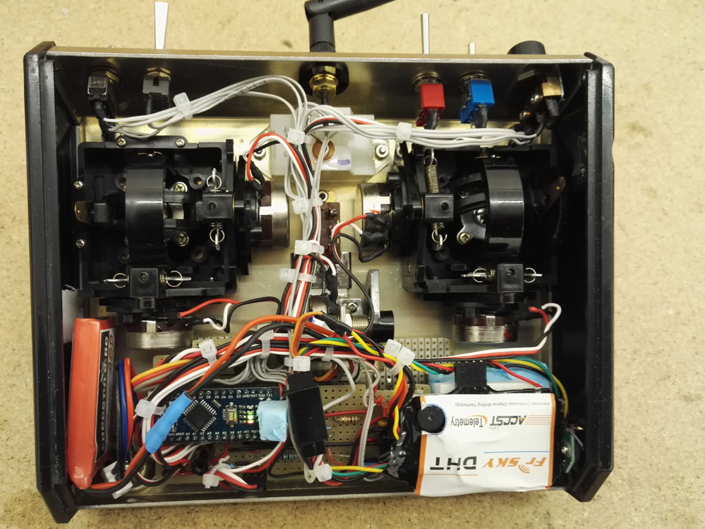

I didn't intend to tease you, I just assumed most people on the forum have seen one of my transmitter conversions and I didn't want to bore everybody by repeatedly posting every little modification. If you were at last years Ponty meeting or the impromptu Buckminster meet later in the year you will have seen me flying my converted Skyleader and I have posted pictures of it somewhere on this forum. Or was it the previous forum?
As Phil has kindly said, I have been developing the encoder over the last two years to the point that it can do pretty much the same as many mid range transmitters from a few years ago, something similar to a first generation Spektrum DX7 or DX8, but it has single channel compound and sequential emulation in addition. As there has been some interest, I hope to sell ready made and tested boards to make it feasible for non electronic enthusiasts to convert a set, but when I'm finished I will also release the circuits and code for those who like to do a bit of DIY electronics.
The encoder firmware is complete (except for a few minor mods so it can display up to 13.5V so it will work with 35MHz modules) and I've been busy for the last six months writing the user manual, a quick start manual and a construction manual. Shaun Garrity has kindly offered to proof read the manuals, but as he's a busy man I don't expect them to be read for a month or two, which will give me a chance to finalise the "production" circuit boards.
If you are interested in what it can do (and what it can't do), I've uploaded the draft user manual to my website so you can have a look. But bear in mind that it is a draft document and that my grammar is not the best - that's why Shaun is going to help out!
http://www.cavaya.co.uk/download/Encode ... .3.21a.pdf
The hardware is based on an Arduino Nano. In the end, the meagre resources of the Nano has been the limiting factor, I have so many ideas of other things I'd like to include but can't because I've run out of flash memory. When you start, 32K of flash seems enormous, but it isn't long before it's all used up. And every single byte of EEPROM has been used. I've already started on a MK2 version based on a STM32, but I'm back on a steep learning curve with that processor, so don't hold your breath

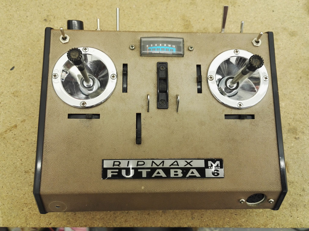

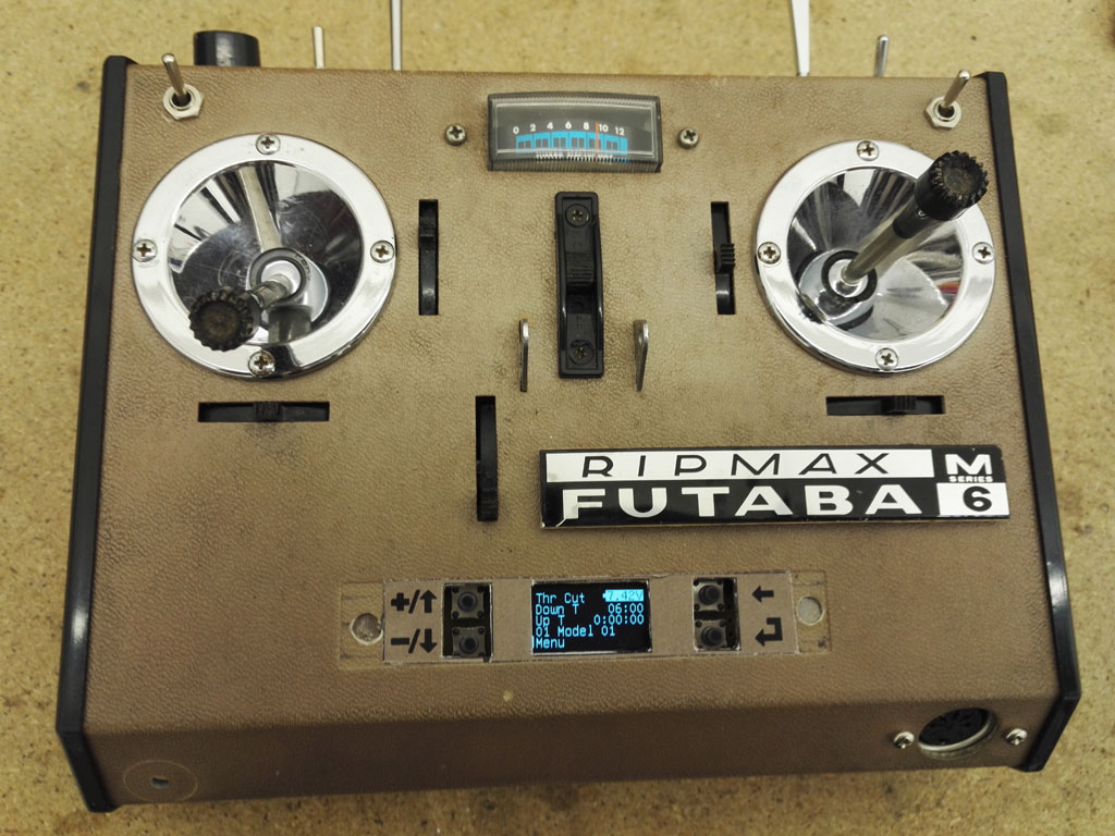

I have converted a Skyleader SLX and Futaba M6 for myself, I gave Phil and Shaun a Futaba M6 each last year at Ponty and have done other Futaba, Skyleader and an OS Cougar conversion for friends. I started a Micron PL-7D conversion before Christmas, but other projects such as 3D printing OS Pixie cases, my own single channel encoder, converting a Graupner Grundig Variophon reed/tone set and building a few planes have got in the way.
