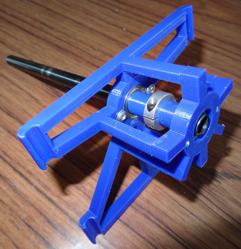

Progress with the test stand this morning. It fits the 450 skids, and is the right length to just fit between the skid support arms with the rotation shaft ending up directly underneath the heli's main shaft (which should be roughly the centre of gravity); the height from the skid supports up to the top bearing carrier is to give well-spaced bearings, but still fit under the heli without fouling anything. Seems to work well, and spins freely. The two bearings, shaft and shaft clamp came from an old (crashed when the poorly-designed tail blades pitch slider collar failed) Mikado Logo 10. The shaft is hollow steel 10mm diameter, and the bearings are 10-19-5. I think I over-engineered it, but that's better than under-engineering! :)
I'm off out flying again this afternoon, but tonight I may finish designing and printing the bottom part of the stand - that will clamp the shaft to the workbench, with the shaft vertical.
The idea is to sit the heli in the "skid grooves" and fasten it down to the carrier using four tie-wraps.

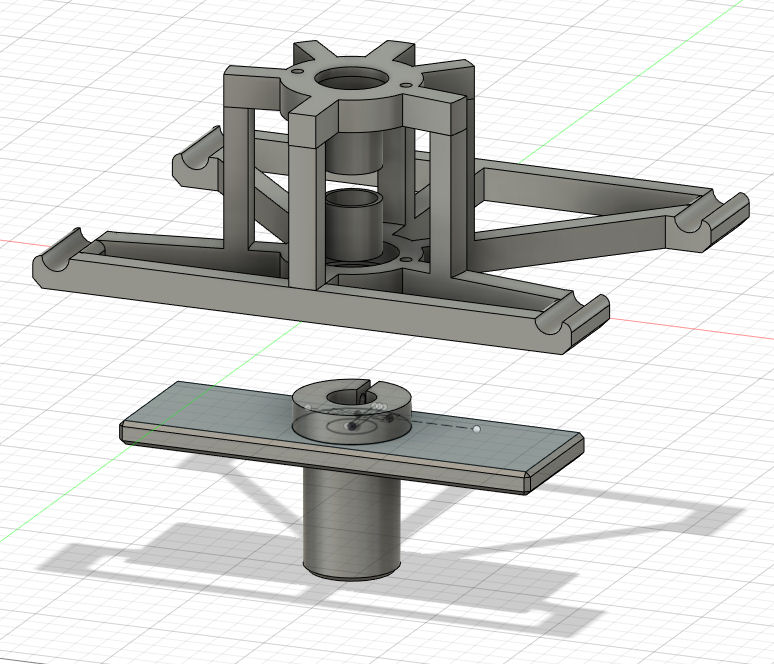

Test stand completed at last. I tried it first with the heli's existing Spartan Quark gyro, and then swapped to my own. Verified Pete's findings that heading hold mode is currently unflyable. I'm now working on the fix and hope to post a part 2 video showing the gyro working correctly on the test stand. Then I'll share the modified code and perhaps post a part 3 showing the gyro in flight.
This is what the test stand components look like drawn in Fusion 360. The Fusion 360 file is attached (as a .zip) if anyone wishes to take a closer look.
testStand.zip
Fusion 360 test stand design.
(320.55 KiB) Downloaded 303 times
