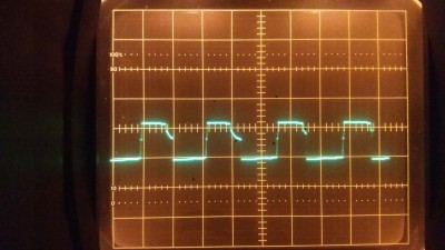

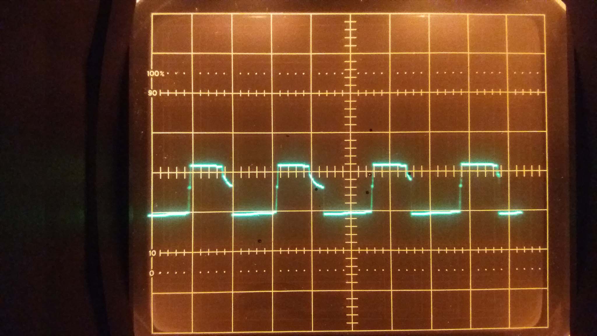

I attach a scope shot of the problem area - at about 30% of the PWM duty cycle you can see the capacitor discharge coming after the pulse stops. That seems to be associated with the spurious LED output signal. I suspect that a diode would stop things, if only I knew where to put it. Perhaps the cap value is just too high. Or too low...
