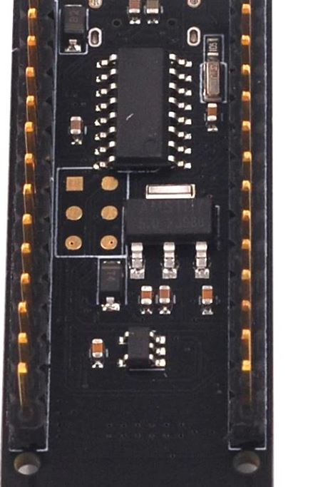

If you use the RF-Nano for the receiver, what will you power it off?
The nRF24L01 has 5V tolerant inputs, but only to 5.25V according to the datasheet, so you can't power it directly off a 4 cell NiMH and you'd need to be careful if powering it off a BEC. You could power it directly off the LiPo if it's an electric-powered model, via the Vin terminal, using the RF-Nano voltage regulator.
You haven't had this problem before (I don't think), because you've been using 3.3V 8MHz Pro Mini, so can power them off anything above about 3.8V using its LDO regulator. Or is the nRF24L01 more "5V tolerant" than the datasheet suggests?

My RF-Nano Rx I'm aware of the 5 V issue so I'm running thru the VIN at around 5.4 V with no issues and yes I have swapped D9 & D10, they run amazingly well. The issue of the voltage is no problem for my GG actuators as I'm able to set the PWM in the Recoder thanks to Mike K.

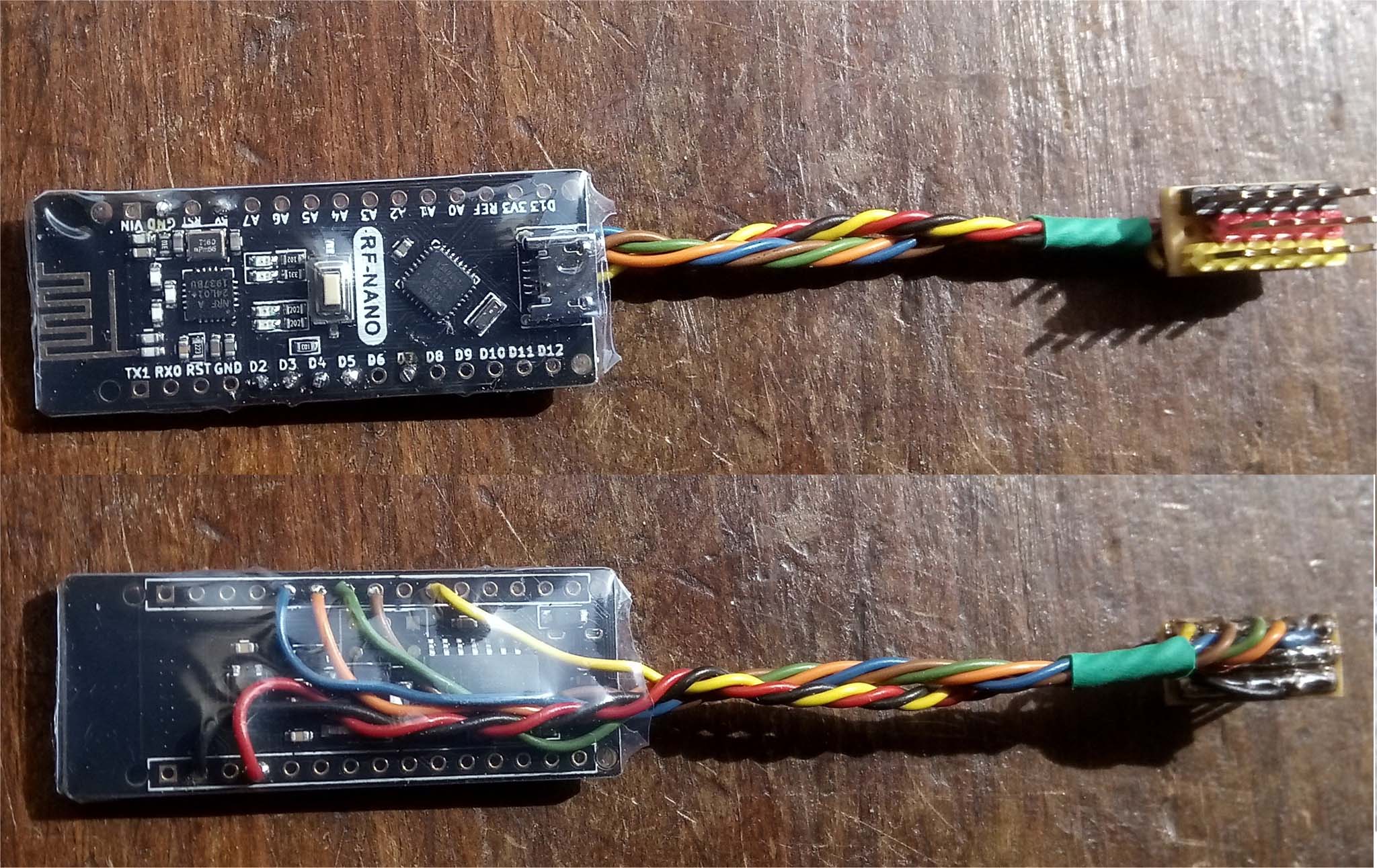

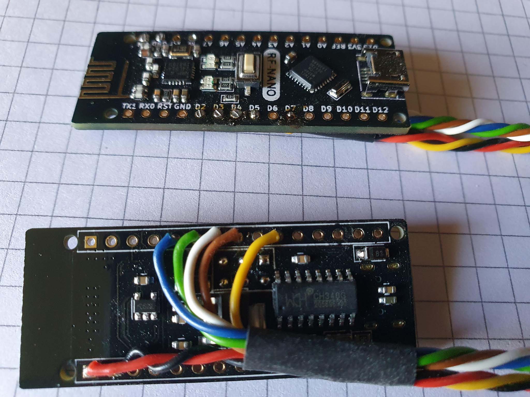

I just program them from the back side by just temporarily soldering 6 wires to the ICSP pad and I have issues but if I run it on the vero-progr-board it will not load! I keep the ICSP on 5 volt

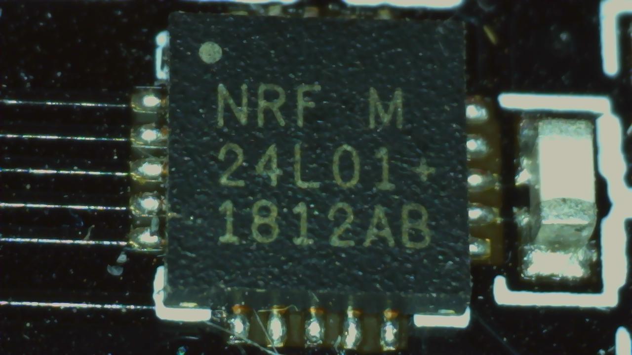

Also, have used the NRF24L01+ on an altimeter project previously and had range problems, perhaps no more than 10 metres outdoors in clear area. Was using the power adaptor board on each tx and rx so not there.
Read many items regarding this but nothing was ever established to really identify why some of the clones acted this way. Had the data rate set at 250 same as yours here but ended up using the high power units both ends as build space was not a problem.
Banggood links to many different NRF24L01 low power units, so do you find one particular unit better or worse than others. Some reference previously made in another site said the "epoxy blob" ic versions worked best at 1 meg although haven't had time to try it as yet.

Hi Jeff, I avoid the epoxy blob ones as I had two that were marked '+' but wouldnt do 250k which suggests they're not plusses, but since they're so cheap I didnt investigate (the library can tell you which NRF chip it is). Real ones are cheap enough, so I use the blobs for Martins Spectrum display project. I was getting at least 50 yards between two of the genuine NRF24L01+ small PCB-aerial ones, using full power. Maybe by chance you just picked a busy channel, WiFi, cordless phones, or general hash...
Packet-loss could be quite high at 50 yards but the rate is so high that we can still have perfect control. This is quite normal, its what they're designed to do, but if link quality at range is a worry or of interest, a specific packet-counter program would reveal all - I didnt go that far.

Re which low-power units to buy - I got the bunch of 10 from ebay, £11 for 10 delivered, they seem 100% ok and they're marked '+'
https://www.ebay.co.uk/itm/NRF24L01-2-4 ... 3138764692
...but now I just use the RF-Nanos, for £3 they're such good value and really neat.
