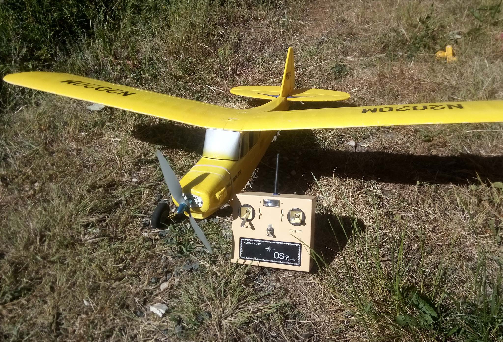

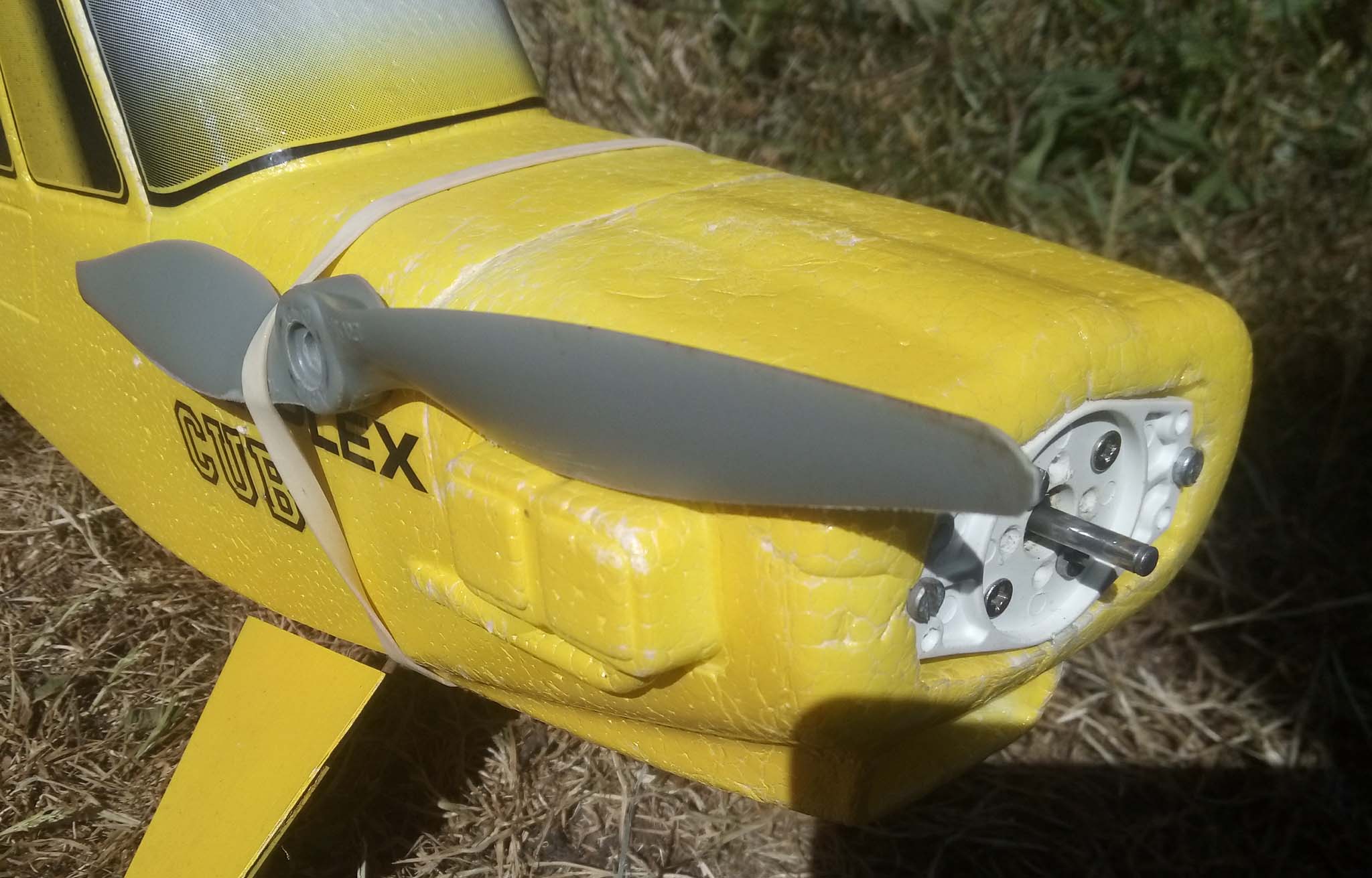

The FHSS set has flown at last! Got up at 6:30 thinking the Park would be empty at 7.

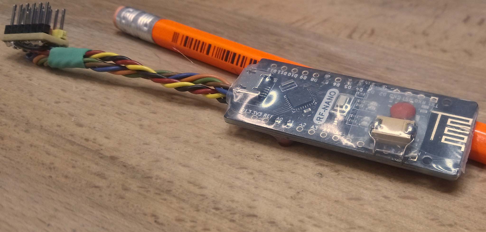

I'd installed the hopping NRF set in my hack Multiplex Easycub, with the OS Cougar tranny.

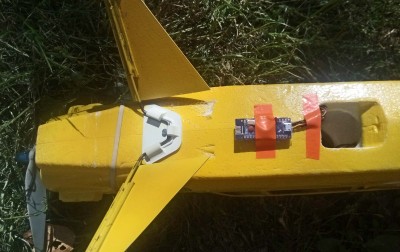

The RF-Nano receiver was taped externally, underneath, the idea being I could see the
LED that flashes every 20 packets received. In practise it was too sunny & not visible at all
Arrived to an empty park at 6:50am only to realise that I had no prop adapter, I'd taken the
prop off for testing! Big sigh, small cuss, back home again, picked up the propnut and back
at the park Andy S had arrived & set up. Rather than do a test flight whilst Andy was up,
I hung back until he'd landed, then a quick test and off we go. This was the first time I've
flown in ages and I was well rusty, had far too much elevator movement but soon settled down
and had three longish flights, no problems whatsoever with the radio, I'm happy as Larry with it
Tried extreme height, tried low & distant, threw it around a bit, tested the failsafe by switching
off, all perfect, I'm so pleased
Remember this is a setup that cost under a fiver for the transmitter and receiver!

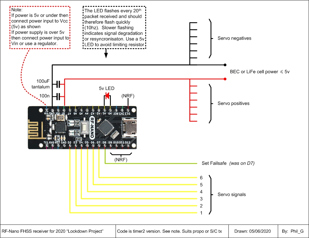

RF-Nano receiver diagram
Receiver:
The RF-Nano makes the receiver easy but I've drawn it up anyway. Note that I've drawn "set F/S" on D8 to free up D7 for a possible sixth channel, whilst keeping the servo signals in a neat continuous row. The code of course needs to agree so use "#define failSafePin 8". The very original (long gone) line "#define failSafeGnd 8" is of course redundant with Tobes servo block idea, plus you can now set failsafe from the tx anyway. This and a couple more diagrams have been added to the zip in post #1.

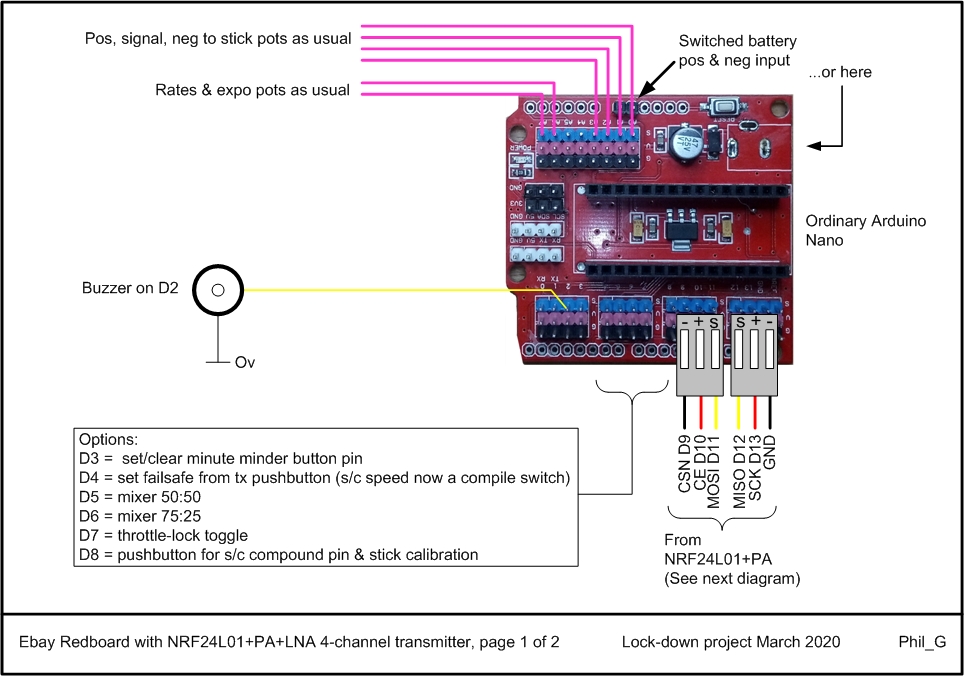

Transmitter:

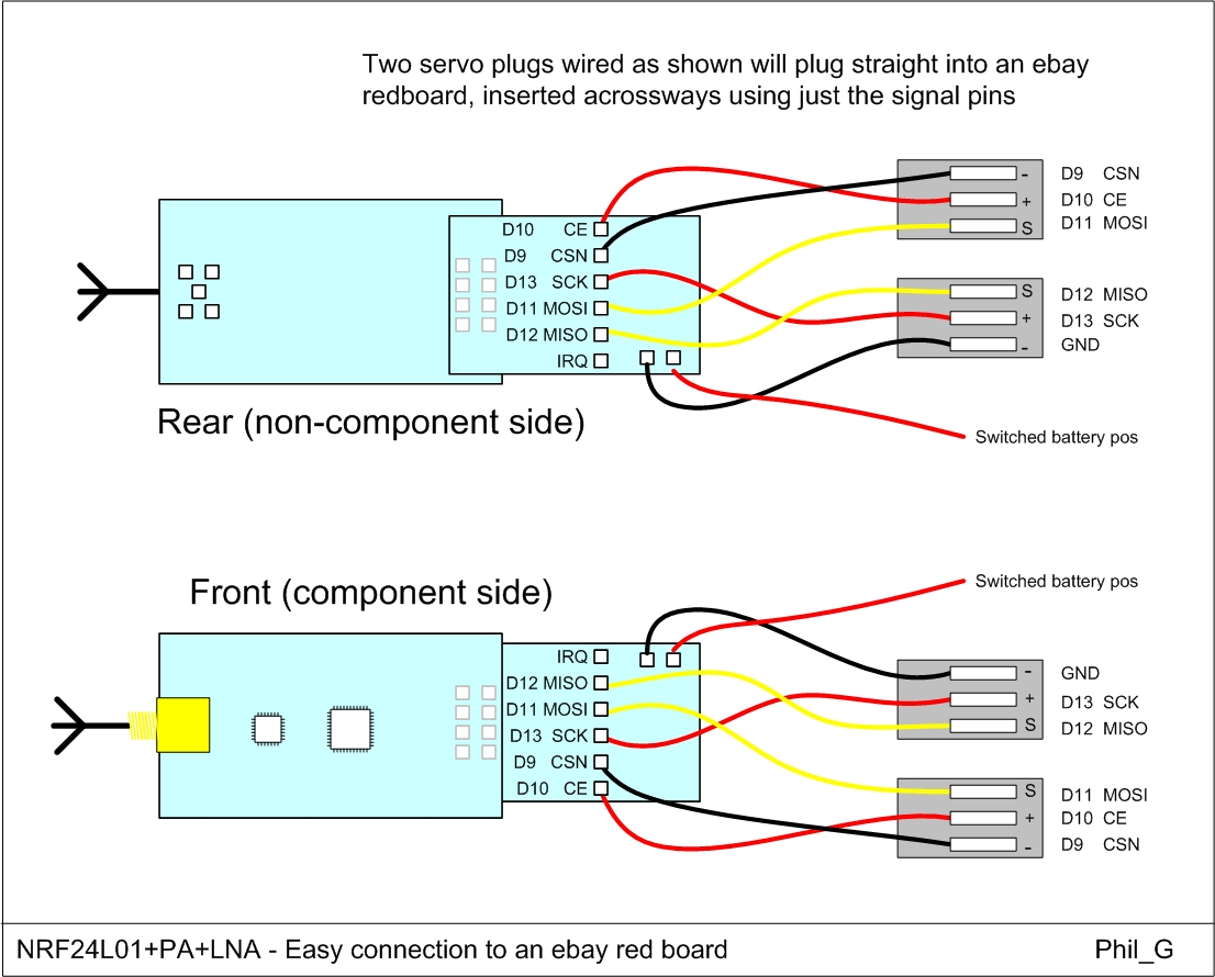

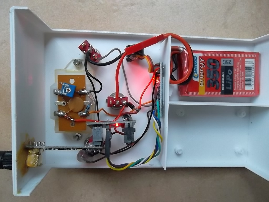

These two diagrams show how I used the high-power NRF24L01+PA with a Redboard,
and other than 'gnd' the same 'sideways plug' idea would work with the DIY-More 'strong' board too.
Note that I now power the NRF piggy-back adapter directly from the switched battery:
With the redboards 3v3 disabled though it makes a really convenient breadboard for the RF-Nano
Transmitter:

On the piggy-back adapter for the RF module; I guess all the connections like miso, mosi etc. are just through-connectors, except for the Vcc and gnd connections. So, it would not be a problem if I choose to wire these straight from the Nano to the RF module?
Max.

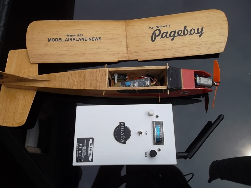

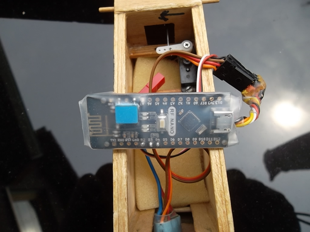

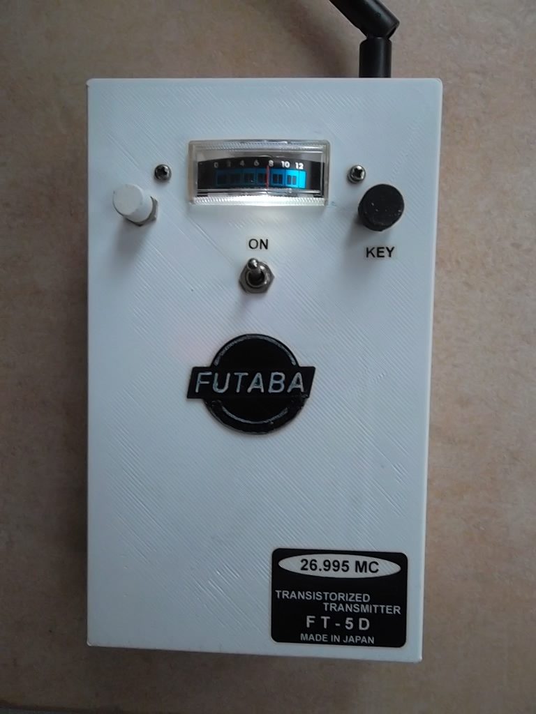

Hi guys,
while watching Phils experiments with the NRF24 radio during the lockdown phase very closely, I wanted to give it a try.
After obtaining all necessary parts I decided to build a single channel version of it. That was before Phil came up with its S/C NRF24 outfit. So I removed everything I did not need from the sketch of the propo version of the transmitter and removed all gimmicks like expo, rates, timer, mixer, propo channels etc. just leaving the single channel stuff and added a sequential throttle on a separate button, like I did on all my dual button S/C transmitters. The only extra is now a throttle led. Since I do some sequential flying also, I will add sequential rudder also to the code.

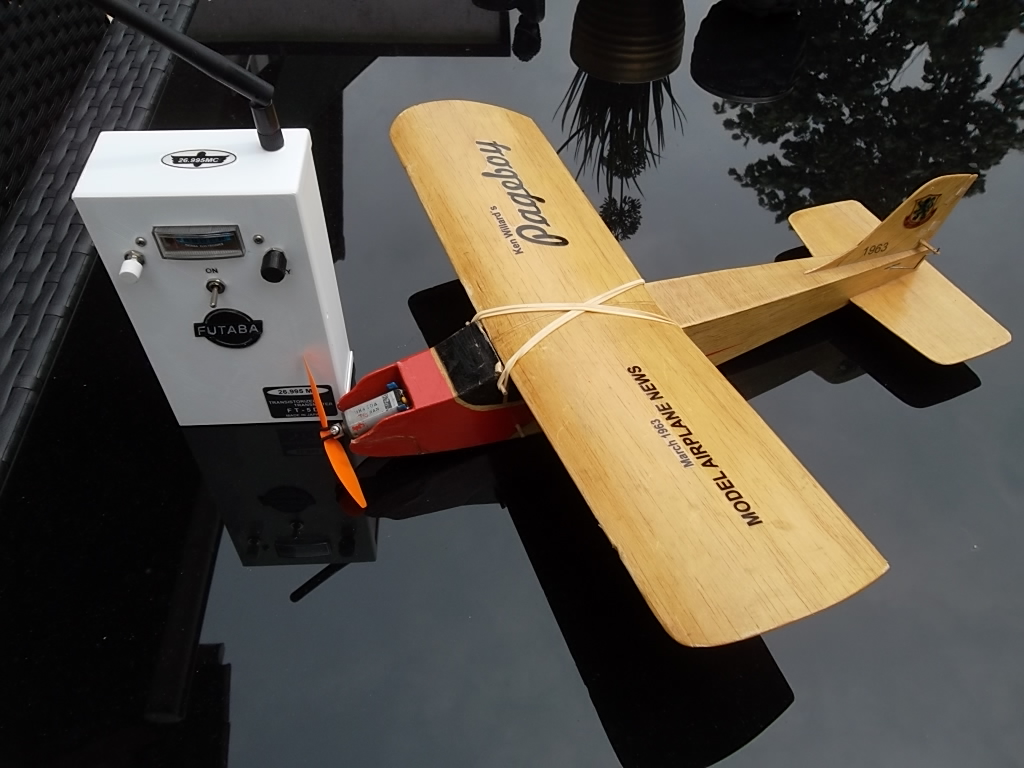

After some minor problems, all was working well and today was flighttest-time.
Using my old Pageboy, I had several wonderfull flights with the NRF24 S/C system. All was working great, no problems, no glitches, no range problems. The transmitter uses an Arduino promini and a high power unit. The case of the Futaba FT5D replica is 3D printed, the meter salvaged from an old Futaba tx. The black button on the right is the compound rudder and kick up elevator.
The white left button is the sequential three position throttle.

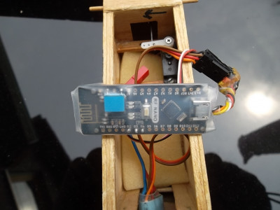

The receiver is a RF nano wired only for rudder and ESC.
As said before, it is working very well, no issues.
Thanks Phil for a wonderfull project, that keeps us busy.
Edit:
Sequential rudder is now added. If you press the button upon start-up, it switches to sequential rudder.
If you just switch it on. it starts on compound incl. kick-up elevator.
The extra throttle button is very convenient when using sequential mode and allows electric power to be used with ease.
Provisions for rubber ecapements are on channel four.

Looking good Frank! I am doing just the opposite, deleting the S/C functionality, and building a 2/3 channel propo unit
The condensator you are using on the Rx seems a bit smaller (in size) than the one Phil was showing, what is it?
And by the looks of it you are using a brushed motor, any problems with electrical noise? Did you install a low nF C somewhere hidden?
Max.
Max.
