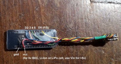

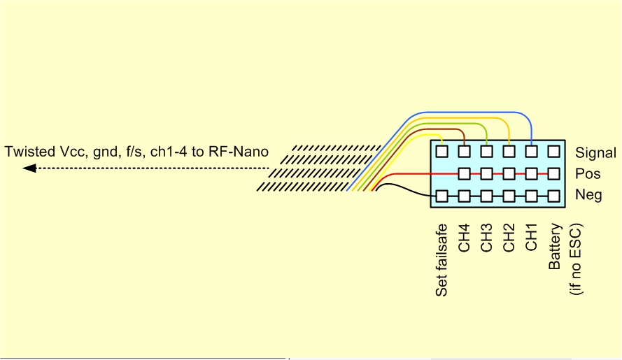

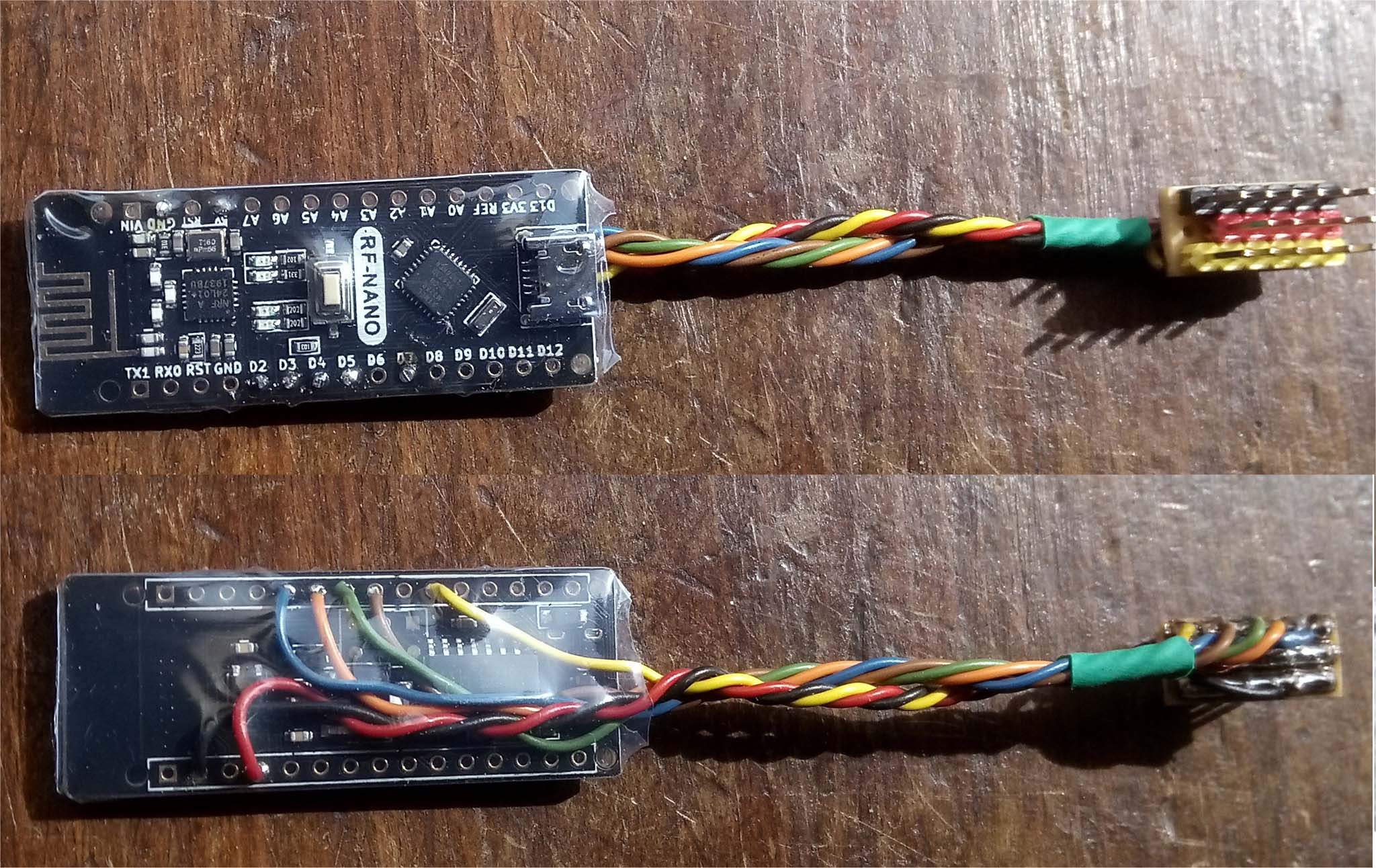

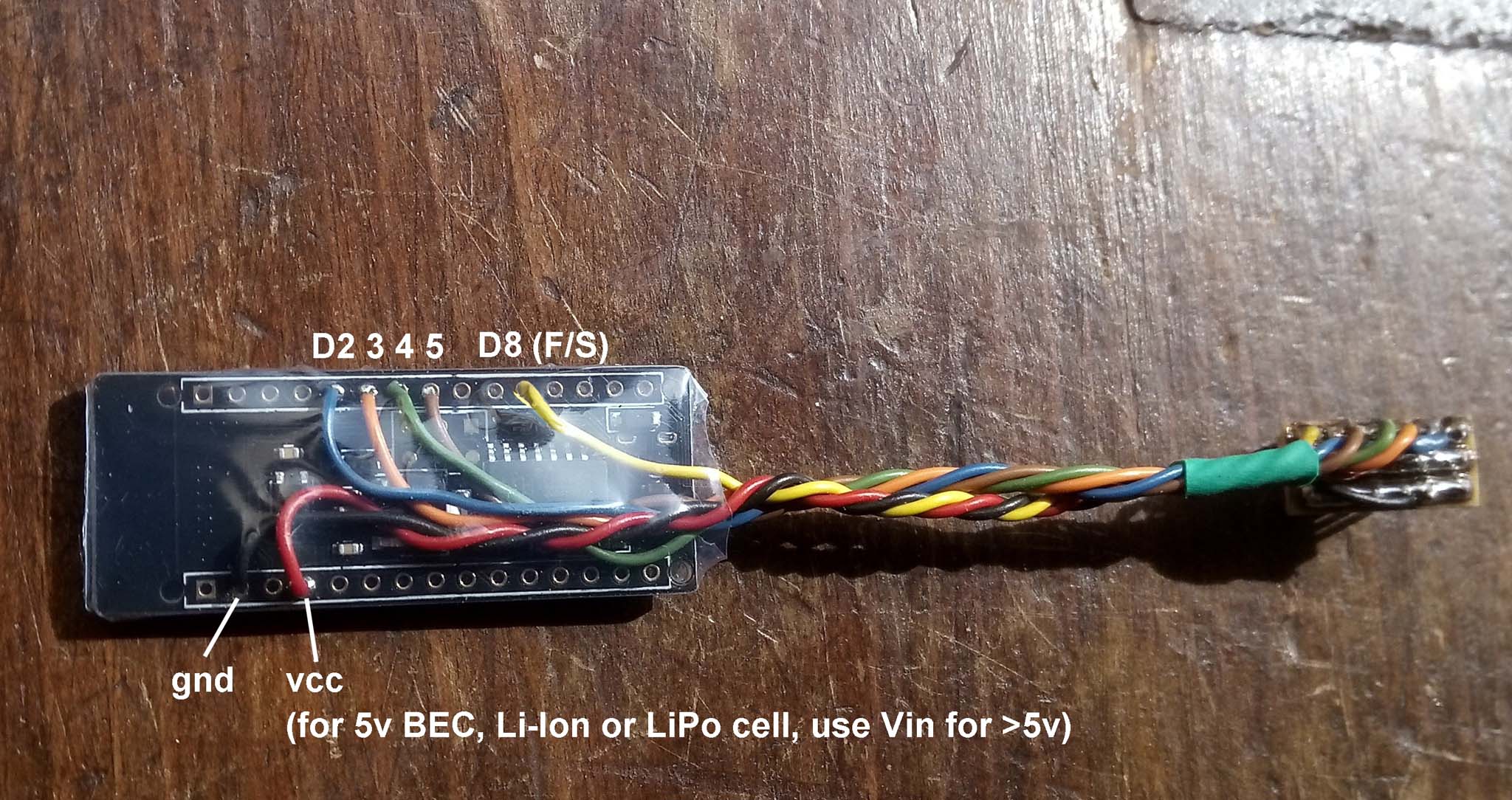

The RF-Nano receivers are really neat and so easy to do, just add servo wires, choose a block like Tobe's or separate servo leads. On the block, the end pin is for setting failsafe, Tobes idea!

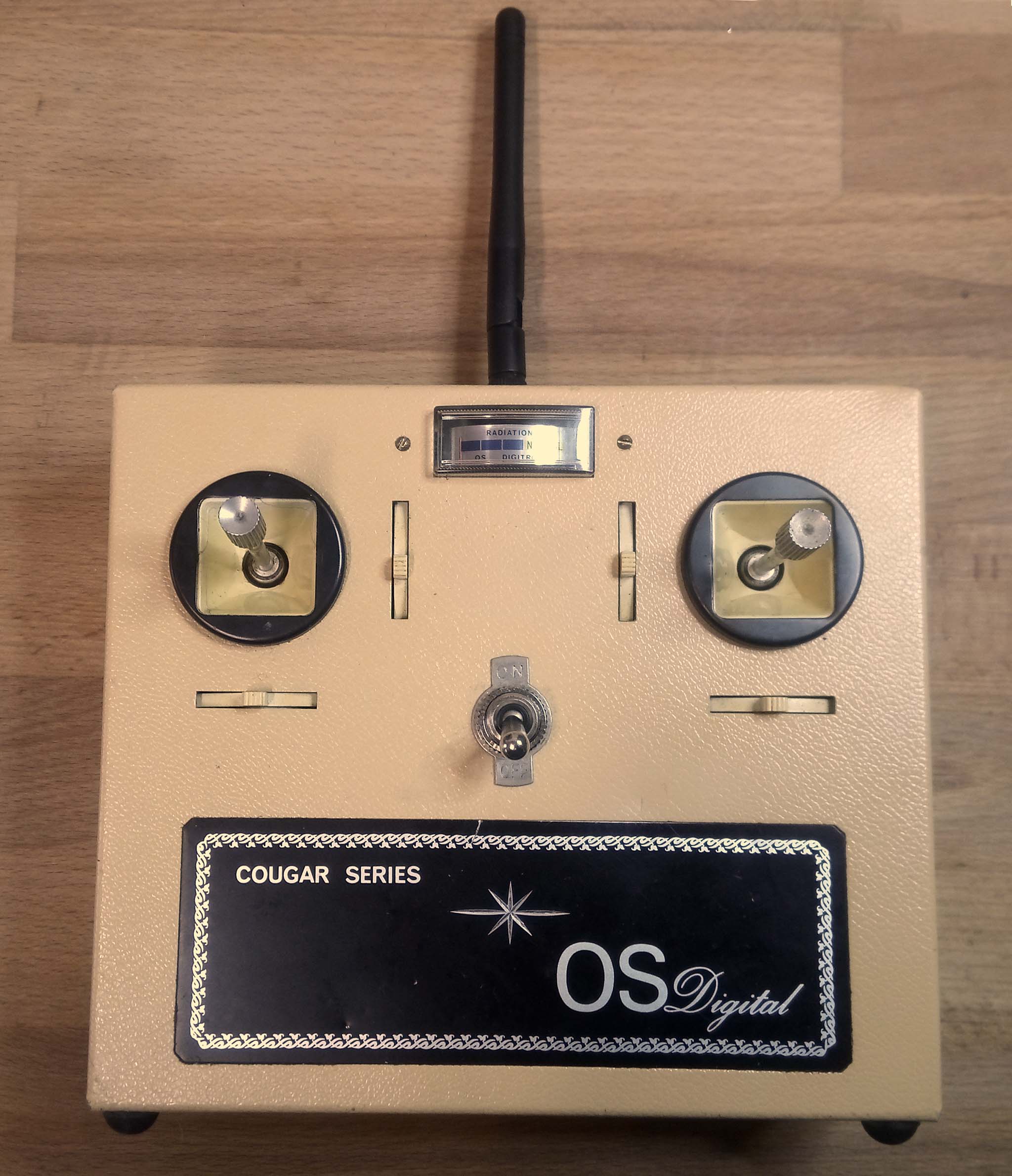

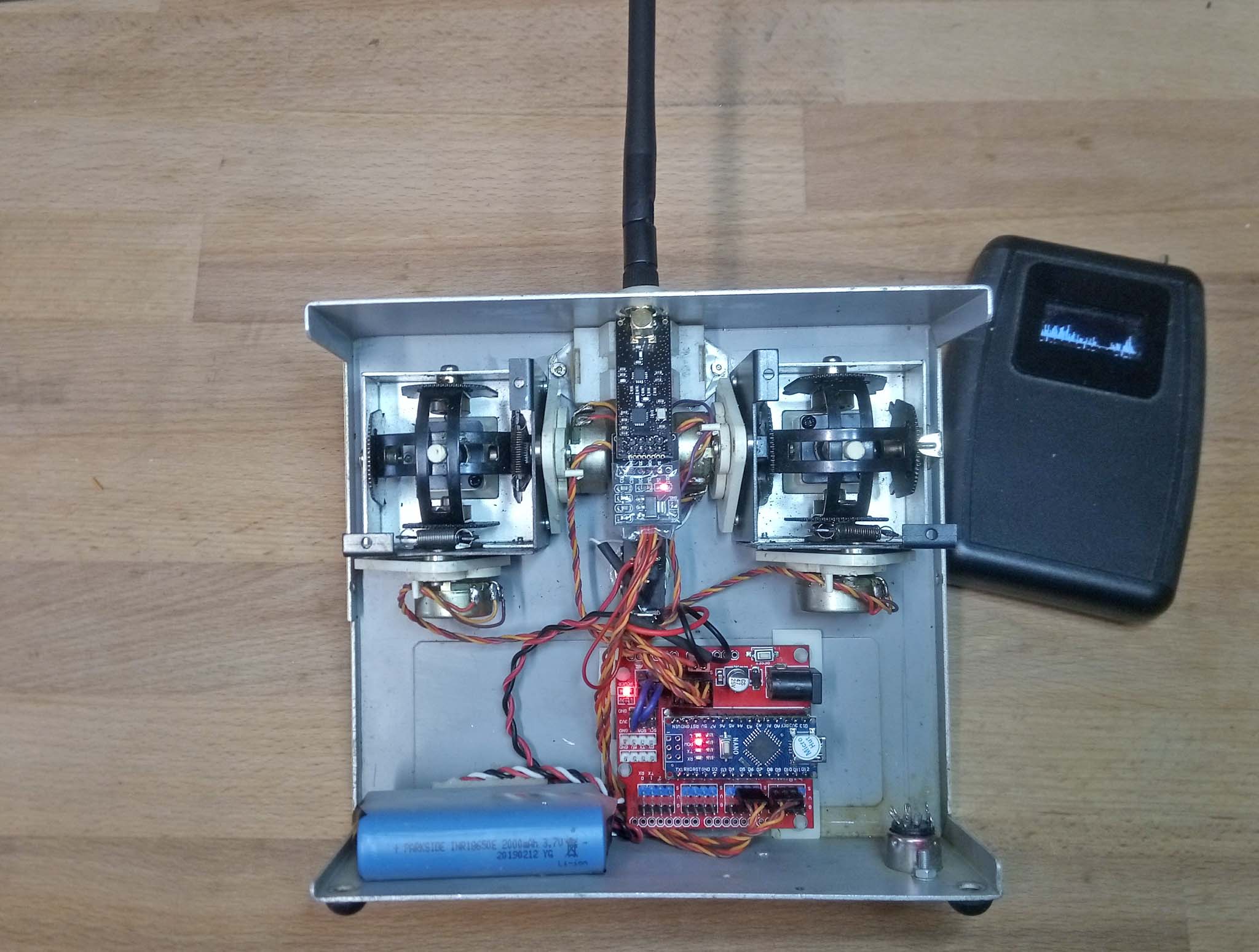

Meanwhile I've converted a nice OS Cougar that Gary gave me a while back. It uses the RF modules &
FHSS software from this thread and is working great on the bench, but unflown as yet of course
The NRF board needs 7 wires and is connected via two sideways servo plugs with D9,10 & 11 on one plug and D12,13 and ground on the other. The plugs are bottom right. Pos comes straight from the on-off switch.
It has the usual expanded scale meter reading from 6 to 8.5 volts which suits the 2S Li-ion perfectly.
All the code, diagrams & photos are attached to the opening post.

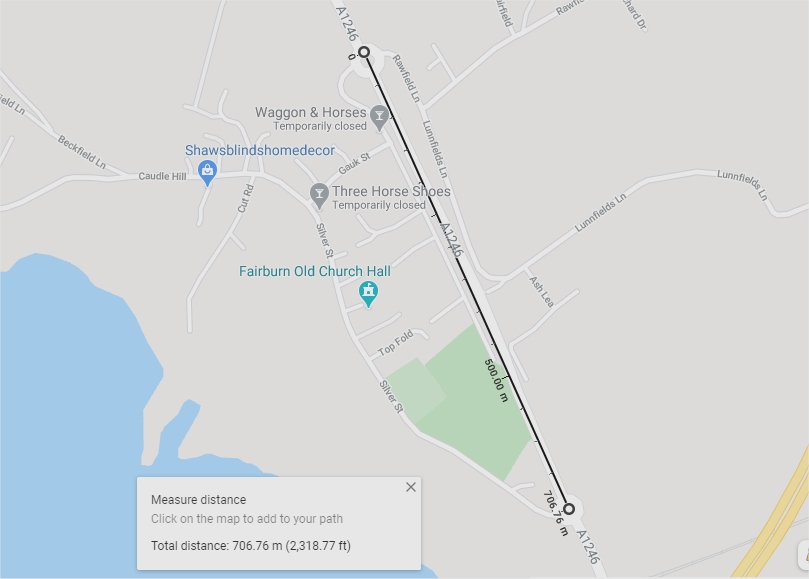

FHSS range test:
FHSS range test:
I find it easier to do long range-tests at night, I have a homebrew two-way channel-switch thingy with two superbright leds, red for left, green for right, and at night its visible over incredible distances.

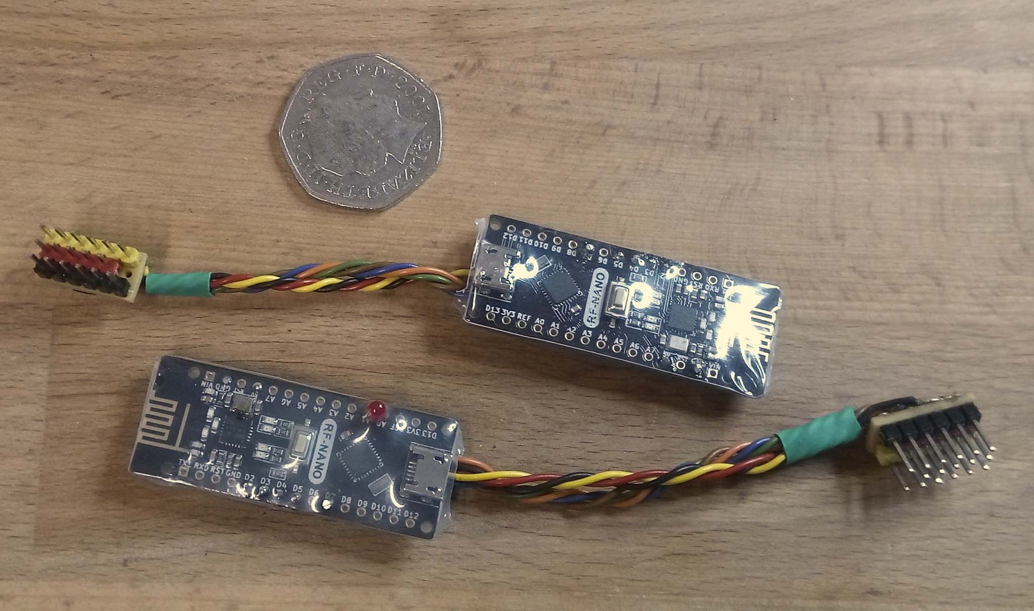

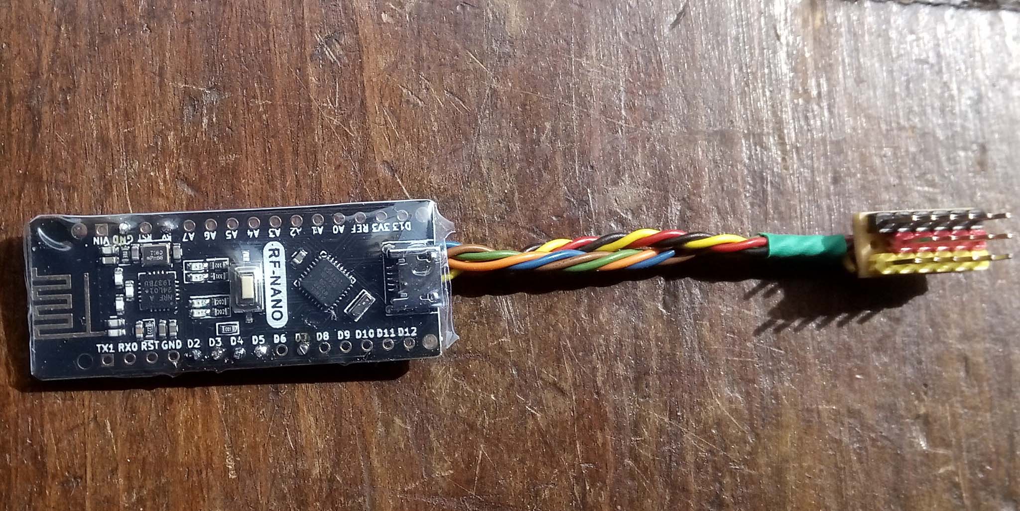

I wasnt sure what to expect when using an RF-Nano as a receiver, I'd only seen figures between two RF-Nanos whereas on the transmitter we're using the 'high power' modules.
Theres a long, straight & quiet road nearby and I set up the FHSS receiver & leds on a plastic bollard on the furthest edge of one roundabout. It was running from a single 18650 Li-ion cell connected to vcc (the 5v rail) and had settled at 4.05 volts. I then took the OS Cougar on a walk on to the next roundabout, checking all the way, occasionally power-cycling to make sure it hooked up again - and at the next roundabout it was still solid and instant. Thats just over 700 metres and it was as far as I could go in a straight line - with a longer road I'm certain it would have been further, and thats ground range with streetlamps & signage. Tried a few long range power cycles and it hooked up immediately with no delay. I'm perfectly happy with a ground range of at least 700 metres so I'm going to put it in the Junior 60 for trials, whenever that might be
I should add that this is a really quiet road, there was no traffic at all, I wouldnt be flashing LEDs where there was traffic.
Must say I'm really pleased with the RF-Nano as an R/C receiver, it works way better than I imagined, I dont think I'll bother faffing with the Promini plus NRF board receivers now, the RF-Nanos are just the job
At some stage I might think about doing a receiver that uses two for diversity, but so far I dont think its necessary, surely no-one is going to put this in anything big, fast or dangerous.
I've since made a couple of purely cosmetic changes to the receiver, added an LED (5v type) that alternates on/off every 20th packet, this is just a confidence thing and also shows failsafe. Using a 5v LED avoids the need for a resistor. It fits flush, pos (longest leg) to A0 and neg to A1. This was after the range test - I'd cover it with black tape for any further tests.
And I made two servos waggle to indicate that the programmable failsafe has just been set, rather than one. Otherwise no functional code changes, it works great!

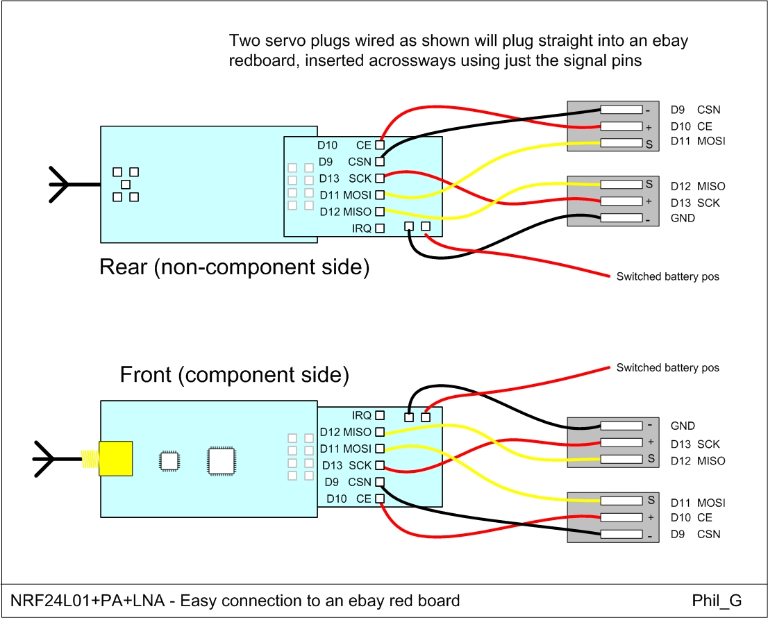

Hi Max, for the transmitter I would definitely get the proper adapter, makes it much easier - see earlier photos: https://www.aliexpress.com/item/1876127 ... 4c4d0U7DeZ
The adapter is the first 'colour' option, just 38 pence! On the OS Cougar I powered this board directly from the on/off switch with 2S battery voltage. Ground and the 5 signals go to the Nano/Promini gnd,D9,10,11,12,13.
The high power modules need a really good supply and this specific board is the best option.
Then you can use a standard 5v 16mhz Promini or Nano, and you dont need any additional regulator.
For the receiver, yes the RF Nano, £3 from Aliexpress. Beware its 5 volts vcc, 6v could kill the NRF chip.
I use a single 4.2v 18650 Li-ion cell. I'd buy at least two, then you can use one for your initial transmitter experiments. Remember this system is unflown as yet
Once you have the hardware set up, you can try the 'lockdown project' hybrid semi-hopper too, and the 'single-RF-channel' projects like the Elektor and RCtractorGuy ones, as well as the single-chip, single-channel-emulation thing
Just watch CE and CSN, pins D9 and D10 are swapped on the RF-Nano:In future I will stick with the RF-Nano convention for both transmitters and receivers, but both of our model car radios and the MPX Pico were wired '9, 10' before I heard of RF-Nanos, hence the option.
Also remember to change your pipe address and maybe pick your own 'mychannels[]'
(spread them out over the 126 possibilities)
...and the same for pipeOut[] in the transmitter

This diagrams hows how two servo plugs make the NRF --> redboard connections easy peasy, the plugs fit across D9 to D13 and conveniently, the pin after D13 is GND:

I suppose we could use the RF-Nano, as a receiver, powering it via its VIN input which then uses the Nano's on-board voltage regulator to regulate down to 5 volts?
The recommended voltage range for VIN is 6V to 12V, so a 2-cell LiPo would be fine. If you're using a 3-cell pack on an electric model, the freshly-charged voltage is a bit above the recommended range. You'd probably get away with it, but it would be advisable to use a dropper diode (or LED) in the line to VIN. An ordinary diode drops about 0.7 volts, a red LED about 1.8 volts and as you go through the spectrum of LEDS the voltage rises up to about 3 volts for a blue LED.
Don't try to power any servos from the RF-Nano's VCC though - again the on-board regulator can't supply much current - so you'd power the servos in the usual way from the ESC BEC, but the control signals to the servos (which don't carry much current) would come from the RF-Nano.
The regulator on the RF-Nano is an AMS 1117 which is rated up to 1.5 amps, but I wouldn't like to power even small servos from it, except for bench tests with no servo load.

For a model boat or car, you can do the whole project with two RF-Nanos
The 'servo block' method makes this really easy and reduces the total number of wires. It commons all the positives at the block, including servos, Li-cell or BEC - and all negatives, and takes one wire from common pos and another from common neg back to the Nano Vcc and Gnd respectively. Its worth checking that it is a 5v BEC though, some are intentionally 5.5 or even 6v
A 2S LiFePo4 seems a popular choice, in which case take the common pos to Vin (raw) rather than to vcc, but first check that your servos will take 7.2 volts.
Basically, if the power supply is over 5v (eg 2S Li) use the Nano's Vin (raw), if its 5v or slightly less (eg 5v BEC or a single Li-cell) then use Vcc. I use Vcc because I'm running the rx from a single 18650 Li-ion cell or a 5v BEC.
I'll probably move the 'set failsafe' from D7 to say D14 to leave D7 & D8 free for more channels in a neat row. Since theres no PPM frame for them to squeeze into, you can have as many channels as you like! Then again, four channels is three too many... EDIT: Failsafe is now on D8
Yes, the high-power module and the adapter are available from the same 'Roarkit' listing (linked in my last post). Incidentally you can power the adapter directly from the tx battery too, its just the usual AMS1117-3v3 regulator. Thats what I've done as I'm not keen on cascaded regulators.
...just to clarify, what Martin means is not to power servos from the on-board 5v Vcc regulator output when using 2S on vraw (Vin, same thing). I'm powering mine via Vcc as an input with 5v (actually a Li cell, but could be a BEC) so its perfectly fine to connect the servos to Vcc too. What you cant do is power it via a 2S on Vraw and then power 5v servos from Vcc as an output, as Martin said
If you're using a 5v BEC, then the BEC positive feeds all the servo positives, and the RF-Nano's Vcc pin. In this case vraw (Vin) isnt used. Same with a Li-ion cell. All negs are commoned of course.
