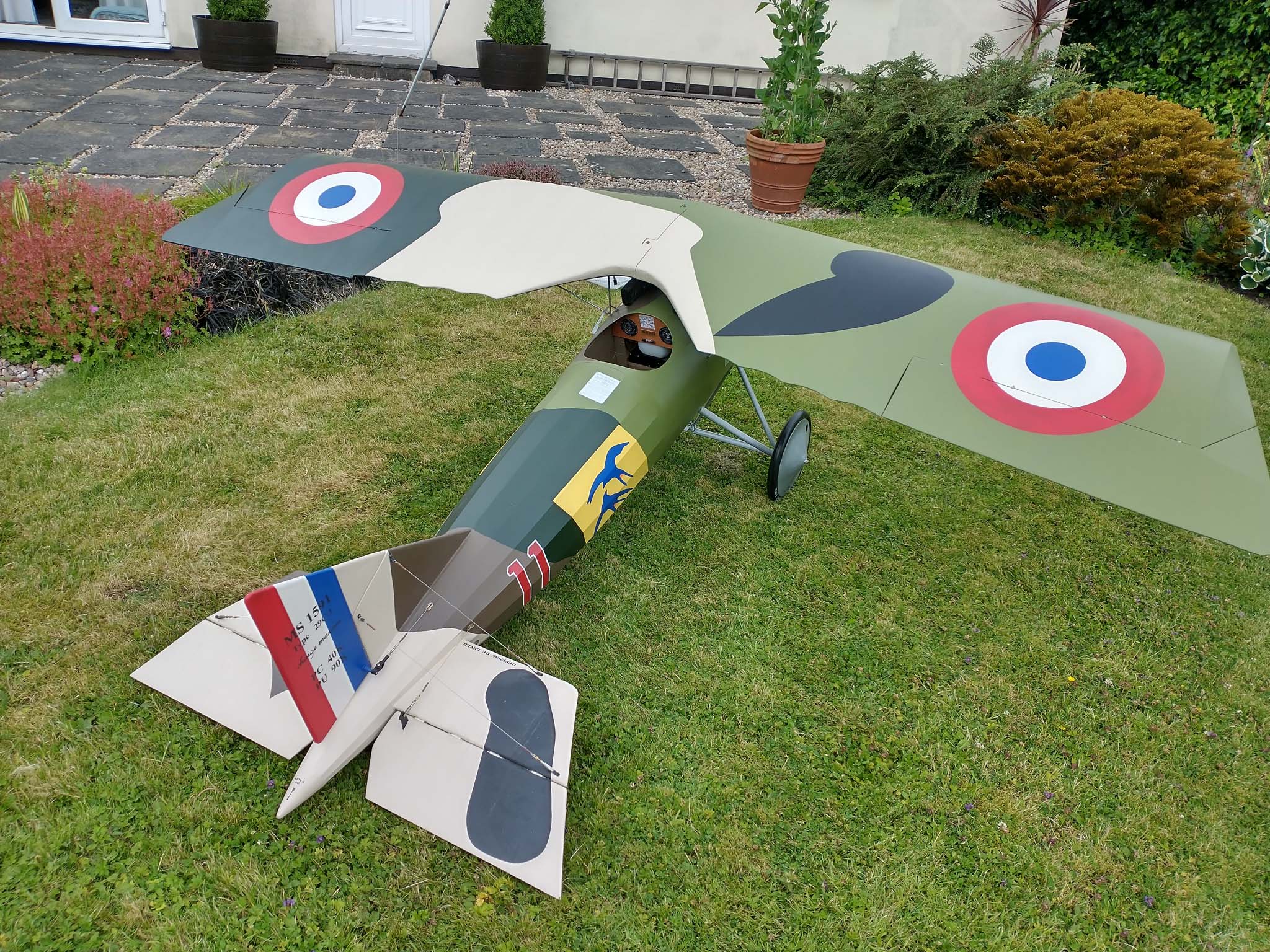

Water based floor varnish works to seal balsa but it isn't fuel proof. I've used coloured vinyl matt Valspar emulsion paint with Matt water based floor varnish over on my WW1 models covered in solartex. Polyurethane was used around the nose area to fuel proof where any petrol would go..
