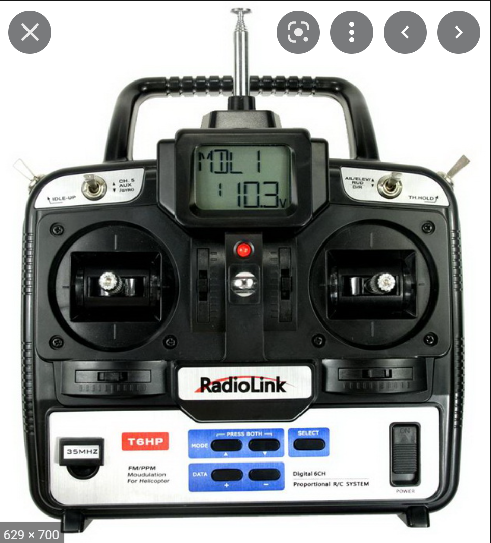

This the Tx - which has worked well for years = 'vintage' of a sort
I have lots of receivers for this tx - hence the interest
I haven't actually soldered the coax to the PCB... just fairly tight shroud round almost all of the cable inside the tx (pulled tight to be close around cable, heatshrink around it to prevent and contact with case, etc
Perhaps unsoldering and having cabling outside tx and see what range is a sensible next step

By "pictures" pretty sure Tobe was referring to the new layout internals etc.
