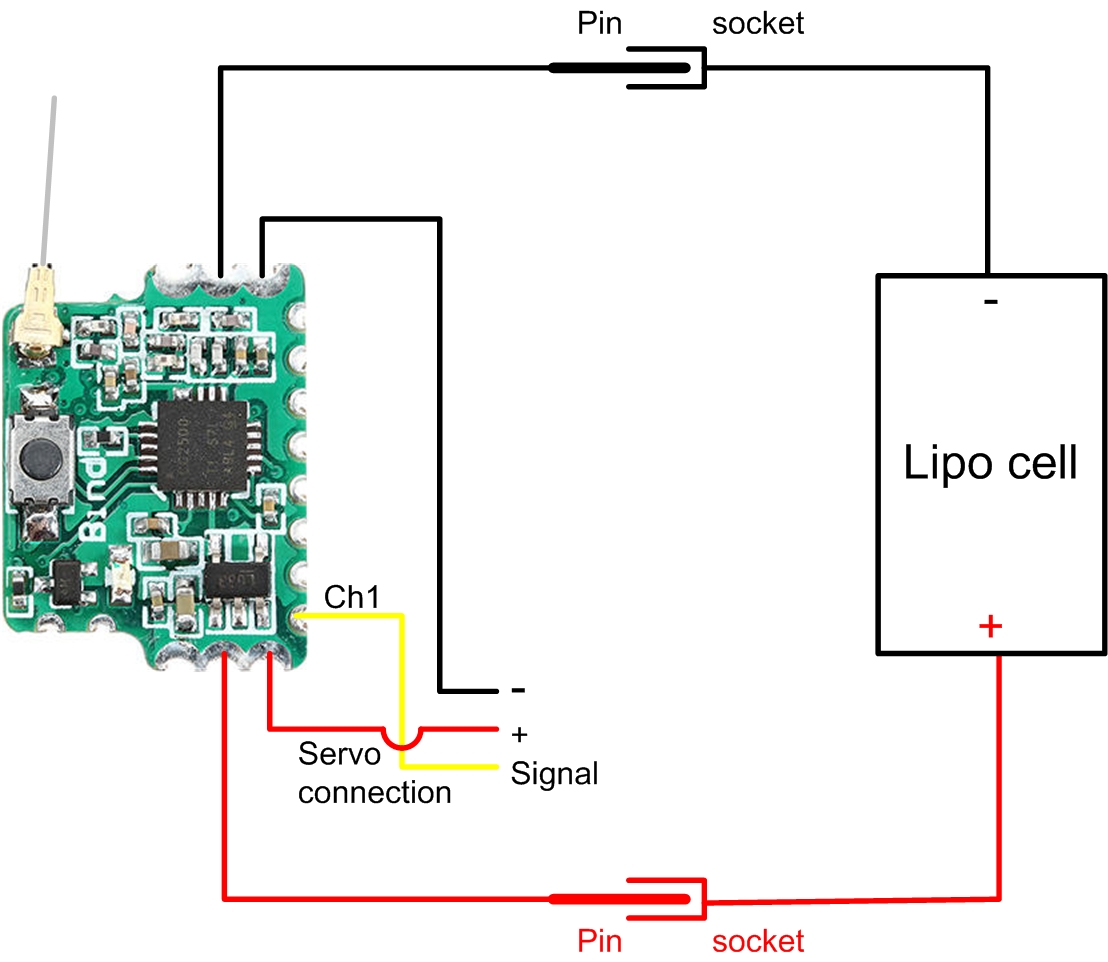

....hmmmmm....something's not right....followed Phil's diagram exactly......worked first time! ....I'll probably drop it.....
Just thinking, If I plug the battery into the rx with the wrong polarity will I get smoke?

Looks like a handy little rx for small stuff like rdt, and cheap too.
How are you mounting it all? the ones I've seen have everything (rx,servo & cell) on a small ply plate thats
easily moved between models. There was an 'Aeromodeller' article, I'll see if I can dig it out.

Thanks Phil,
I'm going with the ply plate but as you say, they're pretty cheap so now that I know they work I'll send off for some more and make a few up. I need to get a 1S lipo charger for low capacity cells and sort out some plug arrangement that weighs nothing.

I prefer to have a female connector on one battery lead and male on the other. That way you can't connect the battery up to the other gubbins the wrong way round. Of course you might then accidentally plug the battery into itself creating a dead short - but that usually only destroys the battery and not any other electronics!
I now chant the mantra, 'Red to red and black to black' when connecting batteries in an effort to reduce the number of batteries I destroy. Luckily the few I've destroyed have just burned through the tags that join the individual cells together (which act like a sort of fuse) - the batteries have then been beyond repair but at least they've not ignited, destroying a model or transmitter or whatever in the process!
