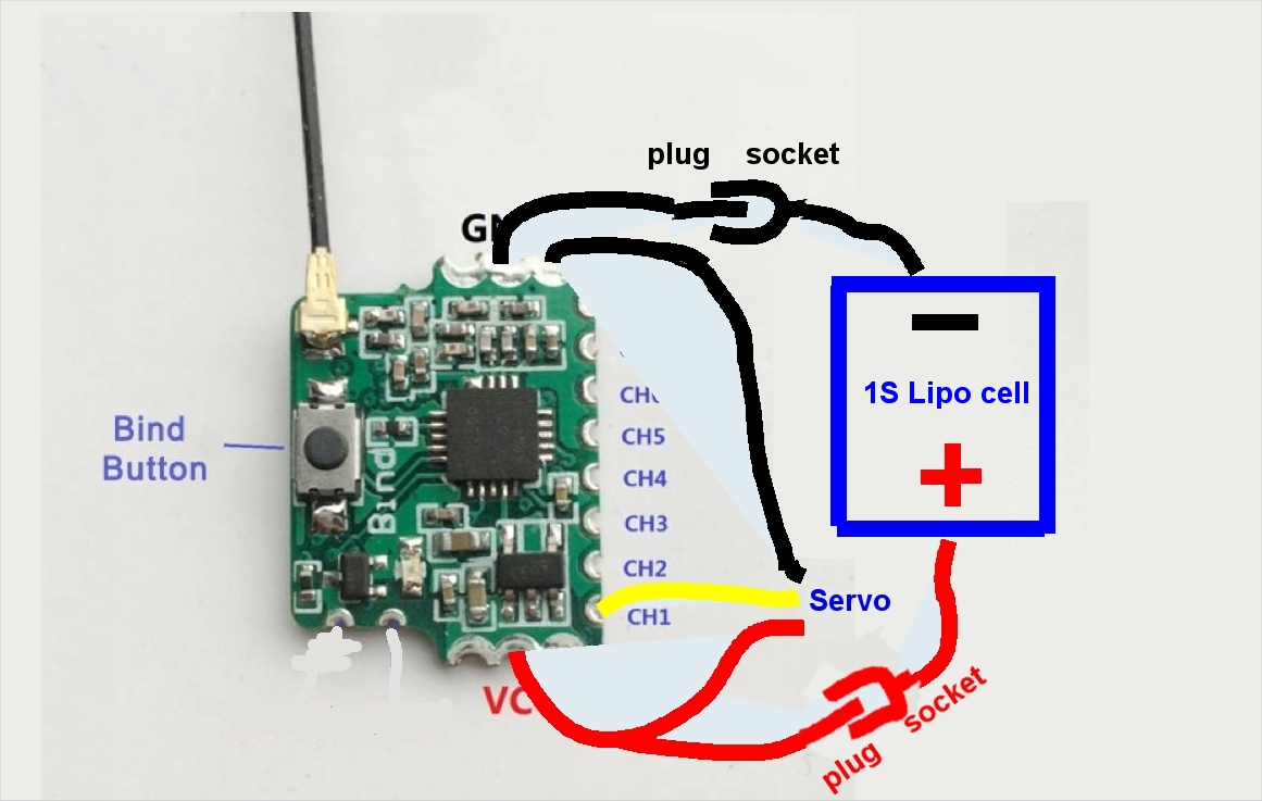

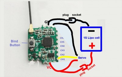

Ok. Got one of these for radio dt. It needs to perform a single activation of a tiny servo using Phil's dt gadget. I'm using a 1S 50mAh lipo. Tx is a DIY FrSky hack module.
NOW....2 questions
1. What do I solder where? No manual available:/
2. Can I solder the lipo (via two small wires,) directly to the rx and still charge it without making smoke?
Thanks chaps,
Gary
NOW....2 questions
Thanks chaps,
Gary

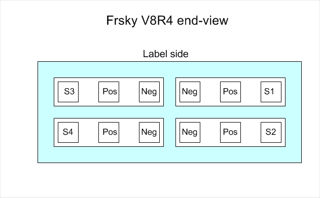

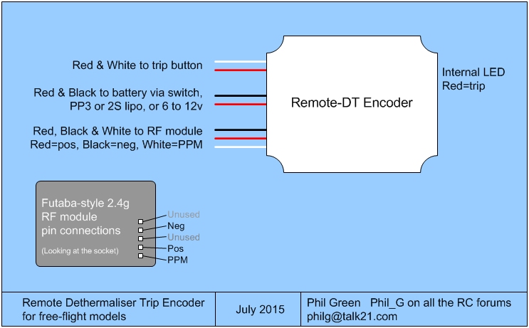

Item P22 on the Archive page of www.singlechannel.co.uk Gary
The tranny is wired exactly like the blue picture:
Just 3 cables to connect - module, button and battery.
At the receiver end, it depends on which receiver - if its a V8R4 or a D4-something then the plugs are oriented so all four negs are central:
The RDT works on all 4 channels, just choose the one thats most convenient:
Ch1 Normal direction, full throw
Ch2 Reversed direction, full throw
Ch3 Normal direction, half throw
Ch4 Reversed direction, half throw
The Frsky receivers are fine on 1S and you can power it from any channel on the rx.
Dont wire the cell permanently to the rx though - use a servo plug & socket or to save weight extract the pins from a servo plug & socket, but you must insulate them with heatshrink. Short=certain fire!
'Socket' to the battery, 'pins' to the rx. You only need unplug the pos to disconnect between flights.
The servo can be permanently soldered.
Binding is the usual power-on-with-button-pressed at both tx & rx ends, then a power cycle both ends.
Easy peasy!
Easy peasy!
