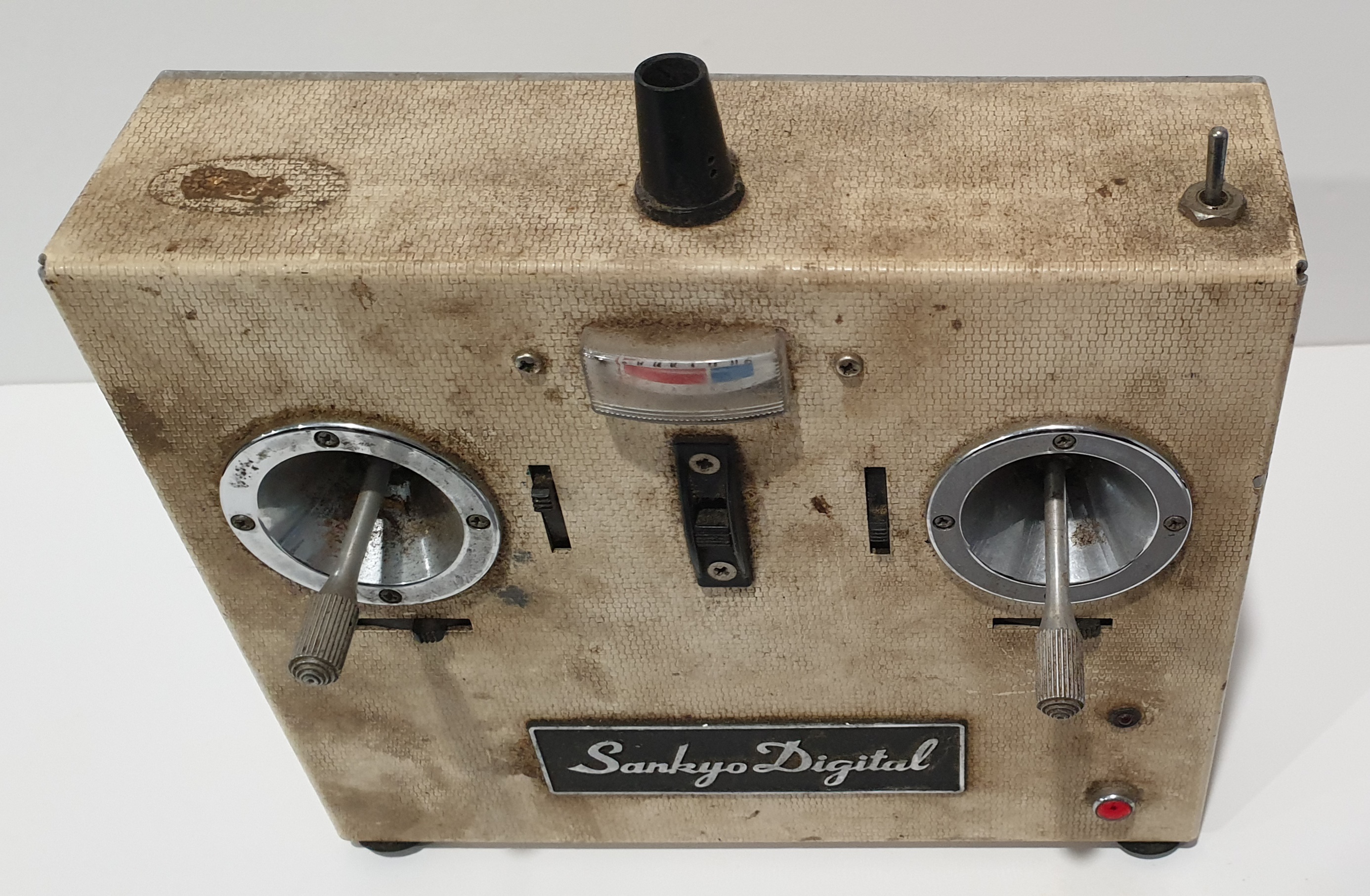

- Posts: 1076
Re: Cleaning Vinyl Clad Alloy TX Cases?
That's come up well ..
