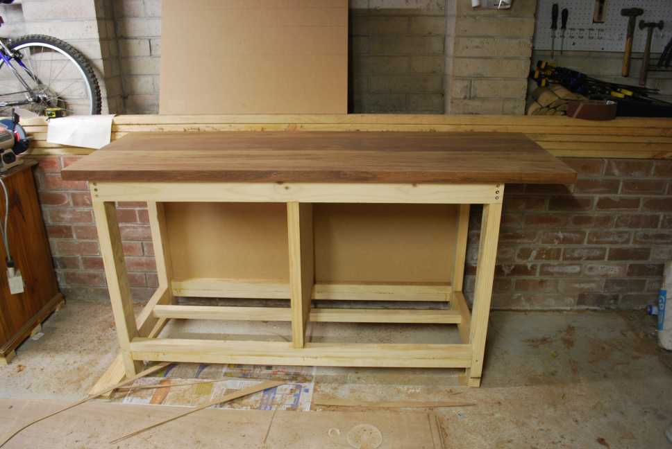

My building bench has a top made of 50mm by 100mm Merbau (Hardwood), laminated together with Titebond 3.
I laminated it on the garage floor when we moved in & then planed it by hand with a Stanley #7 jointing plane (couldn't do that now).
10 yeas old now & still straight & warp free.
Al
Al

Thanks for the advice chaps. Al, that board and bench is a thing of beauty! I'm rather jealous!
Stew.
Stew.
