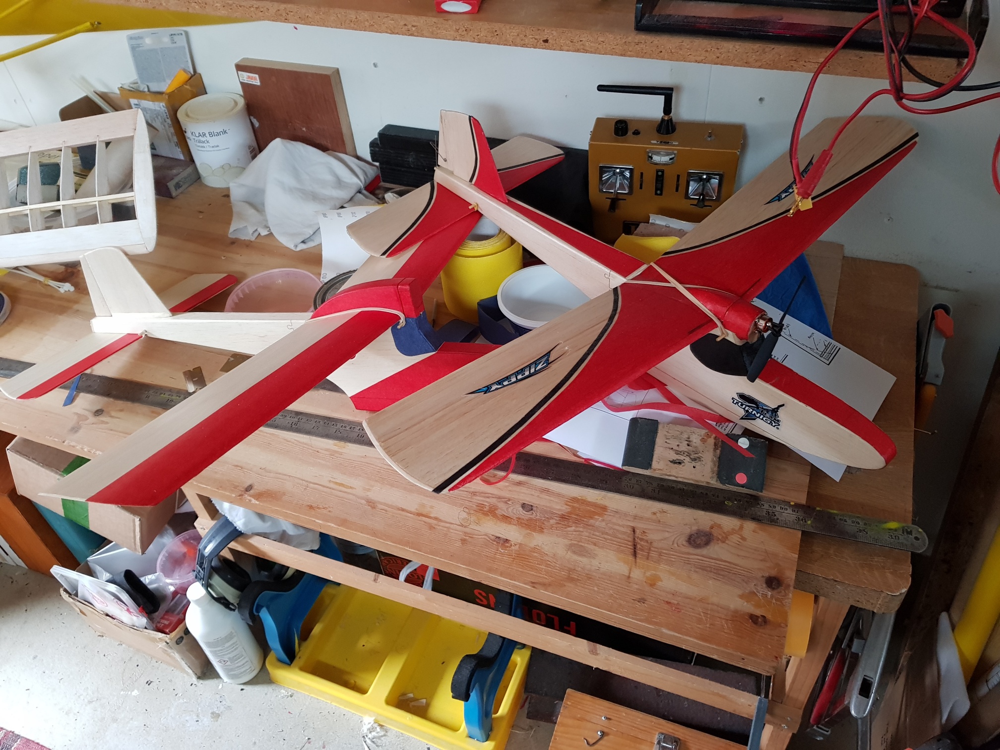

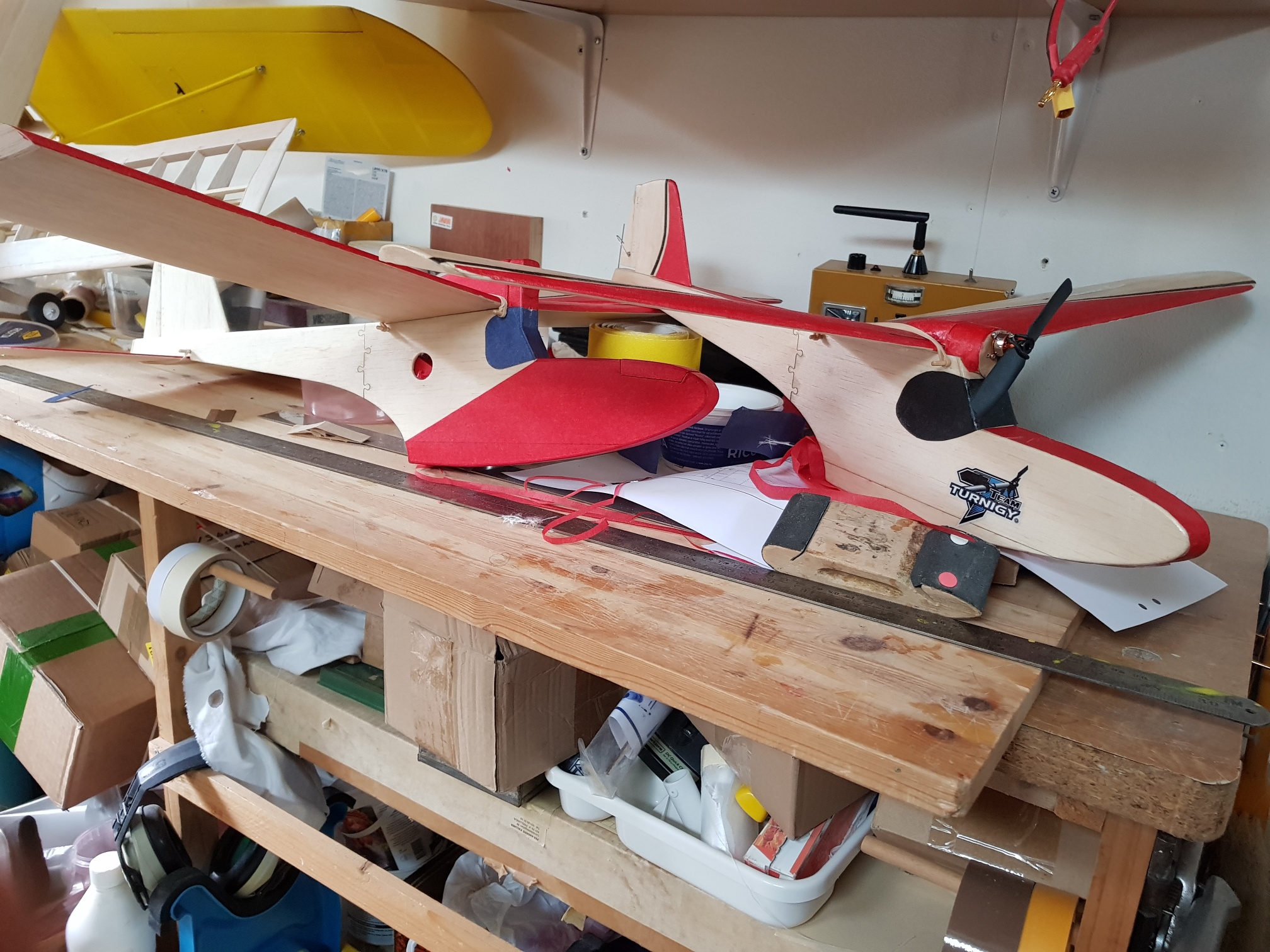

Just to let you know, there are no excuses to not build one...my dad at 86 and my companion in crime for 57 years have built his.
....and yes red tissue on both but dad was more faithful to the original
As I ordered 5 short kits I have 3 more to build!

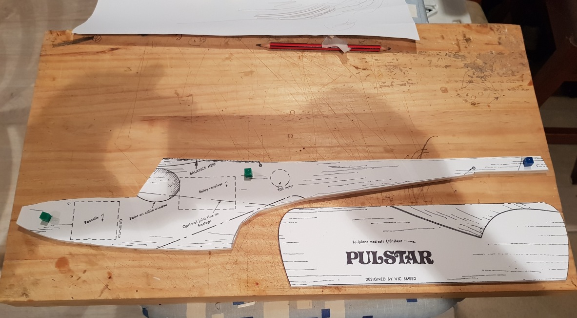

Despite working 27 of the last 40 hours I'm off the mark.
Mine will be 3mm sides with a 1mm doubler in front of the wing & 6mm cross grain top & bottom so I can sand it round. Otherwise stock.
I found some 6lb/foot balsa in my stash so should stay a reasonable weight once sanded.
Al
Al
