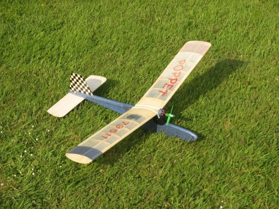

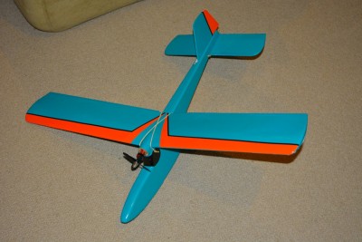

Finished and flown........ It came out a bit heavy at 8.8oz including (unfortunately) some weight in the nose. Luckily I read the stuff about lack of rudder response before adding the fin (thanks chaps!) so I made the rudder much bigger than standard and have ended up having to reduce the movement!

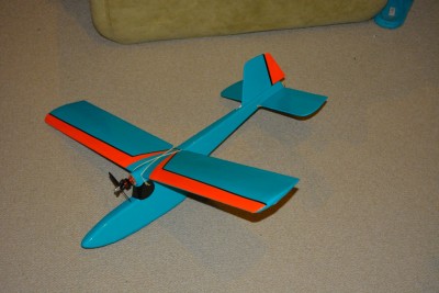

Then it dawned on me to try the much repaired wing of my "Poppet"..... Same chord, same dihedral but 32" span and somewhat lighter........ All up weight 7.7oz
It flies much better! I guess it is what you might call a "Pop Star"!
It flies "ok" but because of the weight it seems to be only just above the stall most of the time and drops a wing all too easily........7th Ponty Fly In - Mystery Model

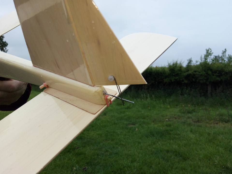

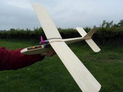

Test flew mine this morning. I stretched the wing a couple of inches compared to the plan and enlarged the fin and rudder about 25%, It weighed in at 216 grams (7.6 ounces) - but that will rise a little when I complete the modifications mentioned below.
The balance point came out as shown on the plan - quite far back on the wing. First test flights it was over elevated and stalling. We eventually added a full 3/16 inch (about 5mm) of packing to the trailing edge of the tailplane - it's bottom mounted so this is like applying down elevator. Even with that it was still stalling so I borrowed a bigger battery from Mike (1000 mAh instead of 500 mAh) to increase the nose weight and move the c.g. forward a bit - it's still a bit aft of where I'd put it if I were designing the model.
Then it flew quite nicely. Adding power makes it climb and adding power quickly can induce a stall. It has the pulser rudder with quite a large area and throw - with that the steering response is adequate, but this is not a model I shall be attempting intentional aerobatics with!
So the required modifications before the next outing are adding the tailplane packing more permanently and neatly, fitting a bigger battery or some nose weight, and making a hatch to cover the battery compartment (accessed through the top of the nose under the propeller) - I didn't bother to make a hatch till I know that it flies okay.
