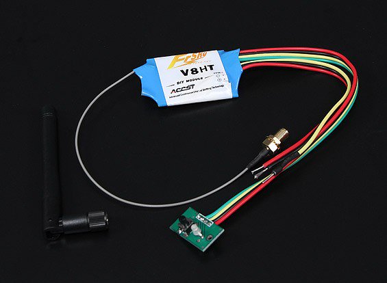

I’m after a Frsky V series diy module, preferably new.
It’s for a pixie transmitter project because the D series won’t fit in.
Thanks

Hi Ron
I wonder where you got an OS Pixie case from, it wasn't
3D printed in Scotland by any chance?!
When I drew the OS Pixie case, I checked the standard FrSky DIY module would fit, but you'd have to desolder/remove the telemetry connector and cut off the heat shrink at the ends. It's then the same size as the old V series DIY. But things will get very tight and either the FrSky or encoder will have to go on top of the battery.
I've already modified a D series DIY module in anticipation of doing a Pixie conversion. I've also got an original V series DIY that has only been used on my desk for tests. PM me your address and which module you'd prefer and I'll get one sent to you.
